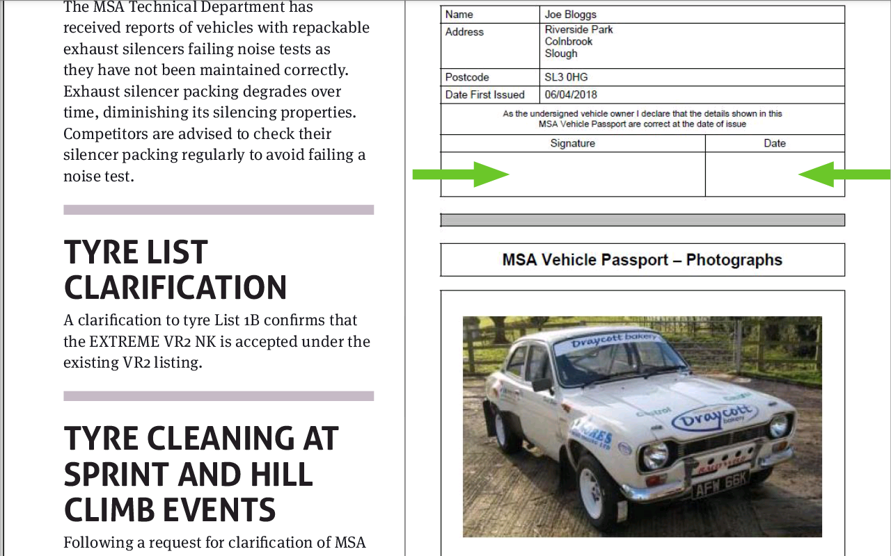

I don't think NK are 1b listed though, just the retread
No - the NK version are also List 1B .... Extreme tyres published a letter of confirmation from the MSA on Facebook.
But I agree that its rather strange as they don't carry an EU tyre label .... you know the sort of label that grades rolling resistance, wet weather performance and noise levels.

They must of done a U turn Graham, this is reply I got in December
From: Technical <Technical@msauk.org>
Date: 19 December 2017 at 11:23:16 GMT
To: **************
Subject: RE: Extreme VR2 tyre clarification
Dear ***********
Only the VR2 retread has met the criteria to be included on List 1B. The other tyre you refer to is I understand the NK series, this is a different tyre and is not currently listed and thus not permitted where there is a regulatory requirement to use a listed tyre.
I hope this clarifies.

To give a bit of clarification the NK's are still a remould tyre as they just use brand new tyres remove the tread and then apply their own reinforced sidewalls and tread.
