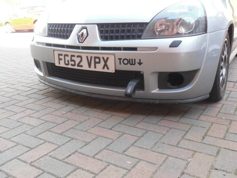

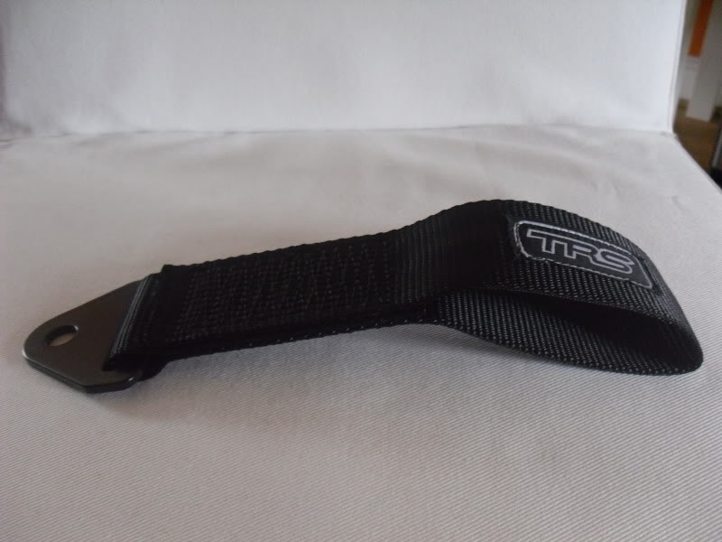

Another tow strap to go on the rear:

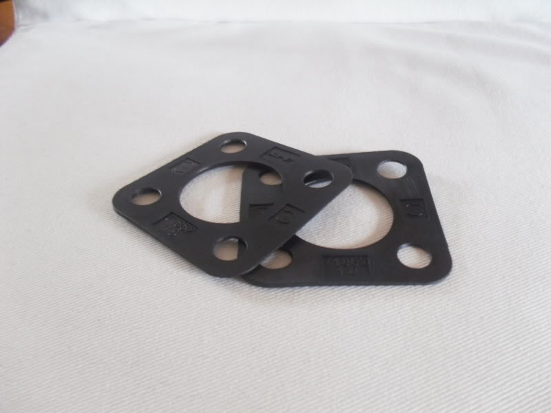

More camber shims, so that'll give me 2 degrees when they're put on with the other set I already have:

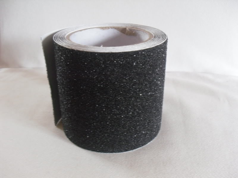

And some anti slip tape for the floor, think there will be enough to do both footwells. Might not have too though ;)

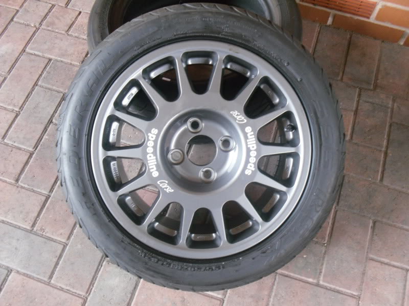

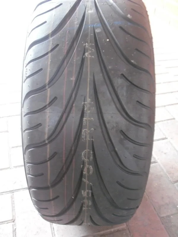

More of a necessity this one.......tyres :(
Plumped for a set of 5 tyres and a new 2118 wheel after struggling to find one spare one anywhere.
Thanks to Speedline for the super duper discount for the wheel, and also from a trade contact for the tyres ;)

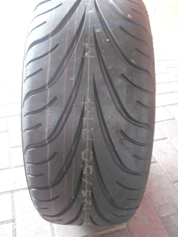

The tyres I went for are the Federal 595 RSR's after hearing great things about them, I thought for the price I got all 5 for, it's worth more then a punt!
Quick pics earlier:

We have them on our track car, plenty of grip and hold well over long stints. PM me what price and where you got them from ;)

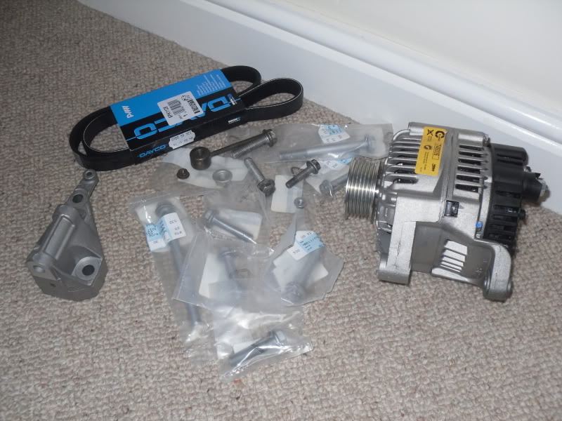

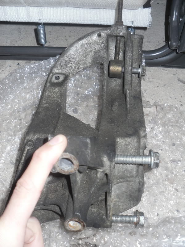

...I now have everything I need for the Cup air con set up now.
New alternator sourced from Valeo through work ;)
And a new belt, all associated mounting bolts and mounts.

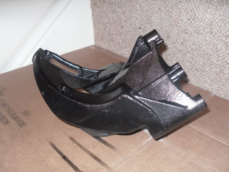

Only thing used to go on this set up is the main alternator bracket and tensioning bolt.

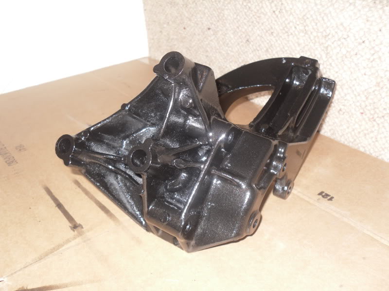

Started off like this:
Lick of paint and now looks like this:
And a quick picture of the alternator and other bits:

The tyres now they're set at the right pressures - 29psi front, 26psi rear at cold, are pretty good I must say, really sticky in the dry and the greasy damp stuff. So far so good.

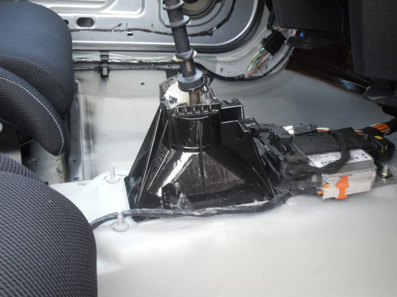

More productive work gone in over the weekend :)
First off, gave the the gear stick surround a new lick of paint - masked it all up, used primer first and then renault black spray paint:

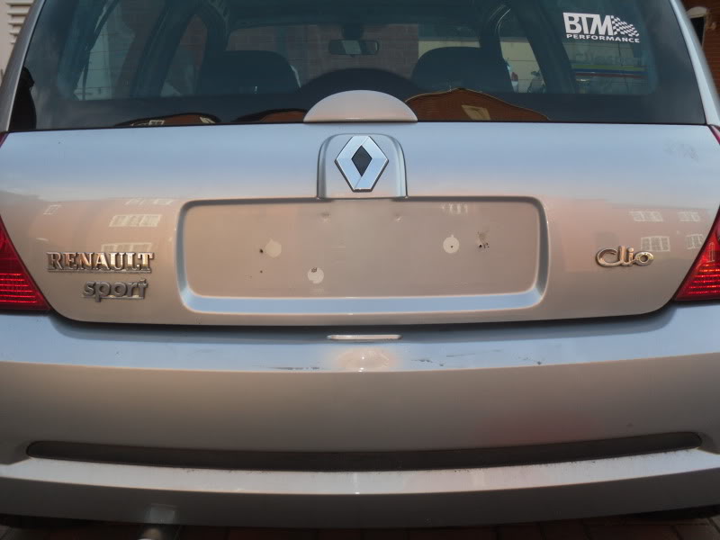

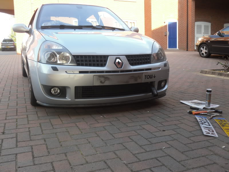

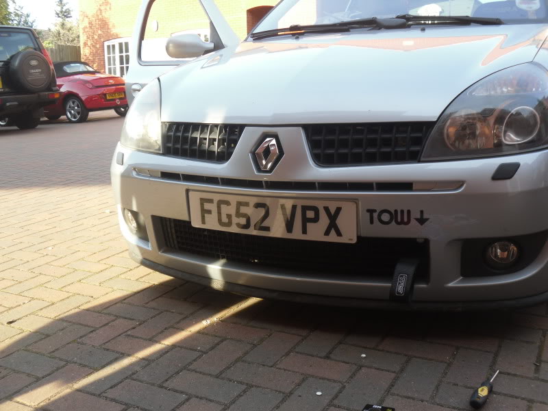

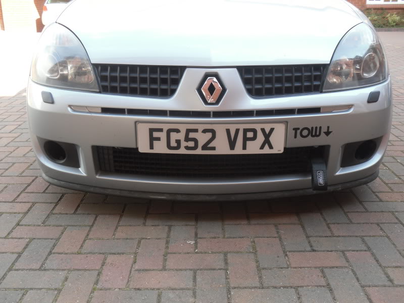

Removed my old 'GB' number plates and replaced them for some nice new plain one's:
Courtersty of a mate in the trade, free number plates FTW! They look much better now :)

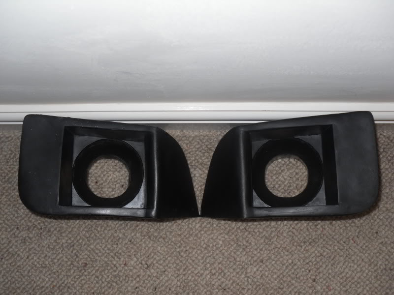

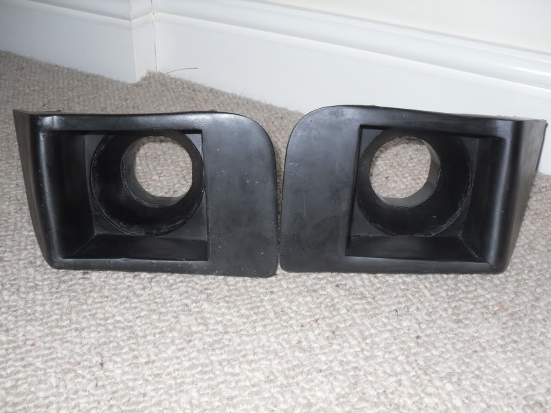

Removed the fog lights to whilst I was at it, proper ball ache with the reaching one of the screws, then found out Renault hadn't bothered to use a torx screw like the other one's. They bloody used a hex shape screw - and to top it off it was a 3.5mm I needed to remove which I didn't have. :mad:. Ended up whacking the back of the screw from the front with a hammer and allen key and broke the fog light bracket - never mind it's off now!
Gives it a much meaner looking front end now I reckon ;)

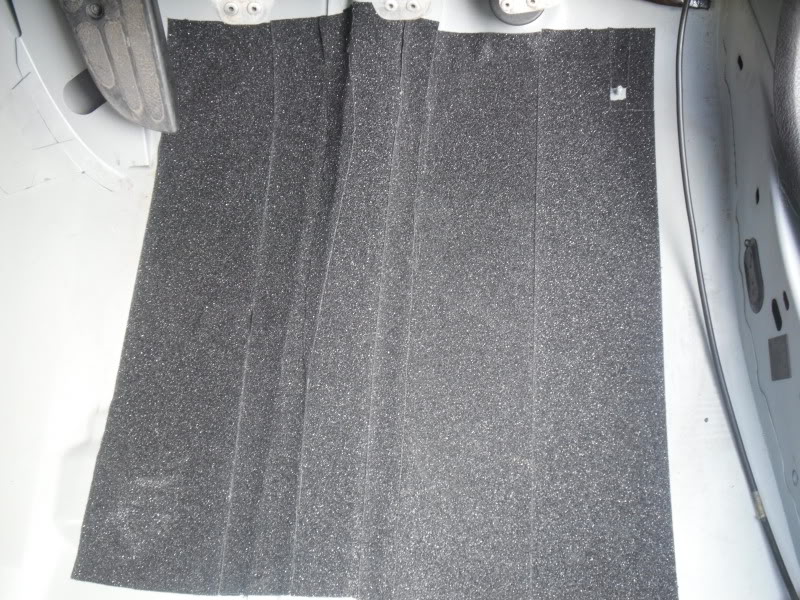

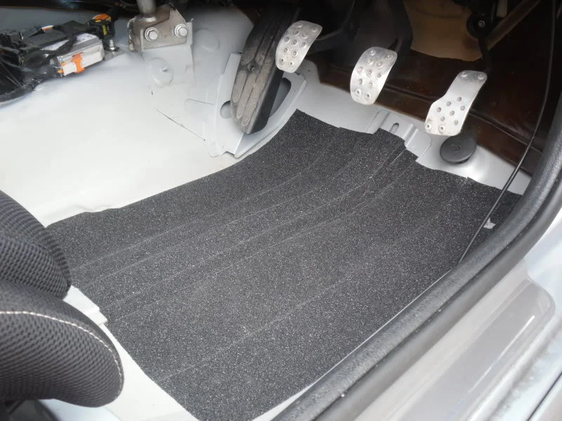

And to finish off....cleaned the bare metal floor (vacuum) and cut to shape and stuck down the grip tape I'd had for a while:
Quite smart if I must say myself!

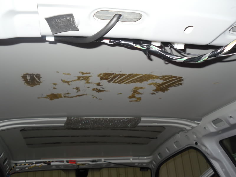

what did you find to be the best way of removing the stuff from the roof. i need to do this. cars looking great btw.
maynard
  ph2 172 track car
Aerosol can of brake cleaner and razor blade.
Then a bit of interior/tar remover to tidy the rest up.

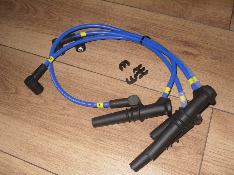

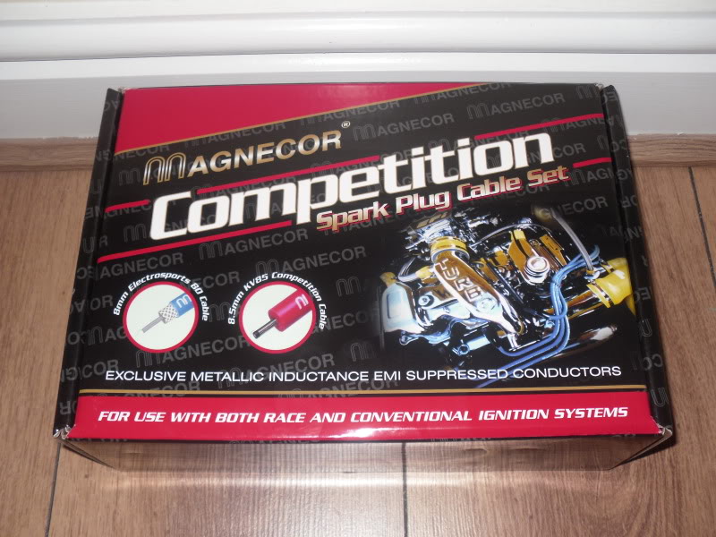

Another new part arrived today in preperation for a bit of a overhaul:
Magnecor 8mm Blue leads.
