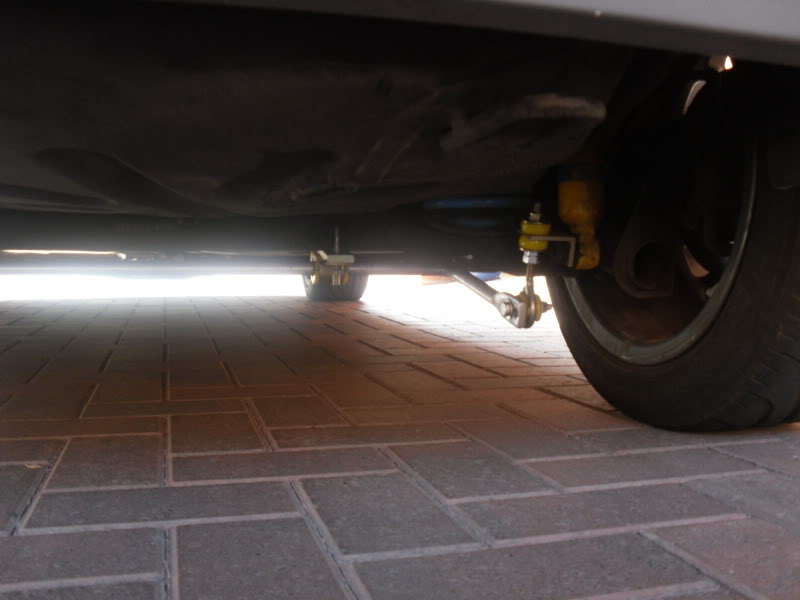

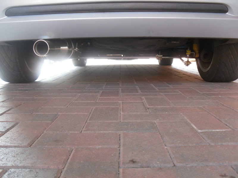

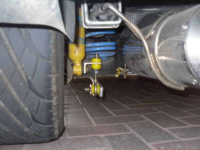

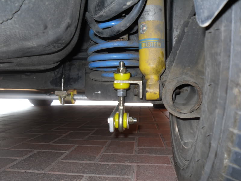

Finally got around to fitting the Whiteline ARB I've had sat here for ages today.
Had a bit of an issue with getting the one rear shock to line back up properly, and also with putting the u bolt clamps, bloody awkard things!
All in all an easy job really.
What an epic drive home that was!
Went for a spin around the roundabouts by mine and it feels 10x quicker into the corners and the holding around the roundabout is unreal - i got a bit too much tyre squeal too :eek:

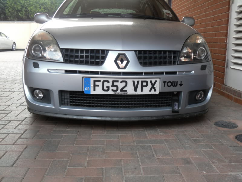

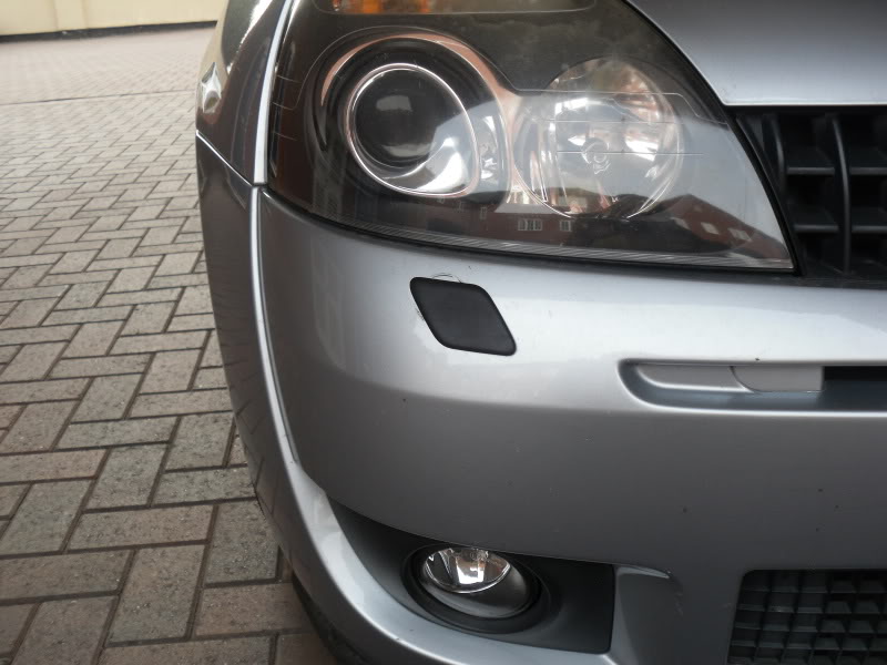

Fitted my Cup washer blanks yesterday:
Really smartens the front end up, worth paying all that money :eek:

Try and find some who works at Renault and use there staff discount, I ended getting them for about 35 quid less then retail.
  Golf GTD Mk7
Looks good. What's the retail on those? Is it not a legal thing when running xenons to keep the washers?
maynard
  ph2 172 track car
About 95 quid + vat when I bought them, bloody scandalous.
No apparently not. They are a legal requirement at point of manufacture, but not part of the MOT checks.

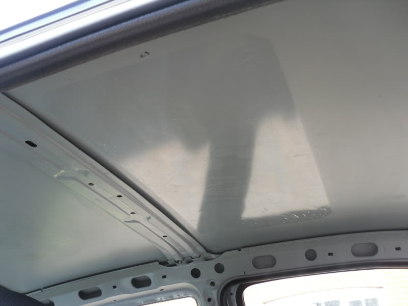

Finished off the roof glue today, pain in the arse of a job but looks so much better now it's finished.
Brake cleaner is the stuff you want to use for doing this job, I used one rattle can of the stuff.
All ready for painting when I decide to do it.

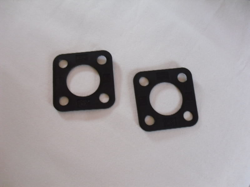

These turned up today courtest of andywiddss1 :)
I'll fit them when I put some new rear discs and pads on in a few weeks.
Might have to get another set, I'm not sure that's going to be enough!

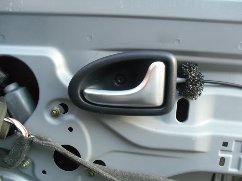

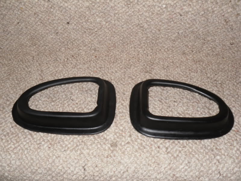

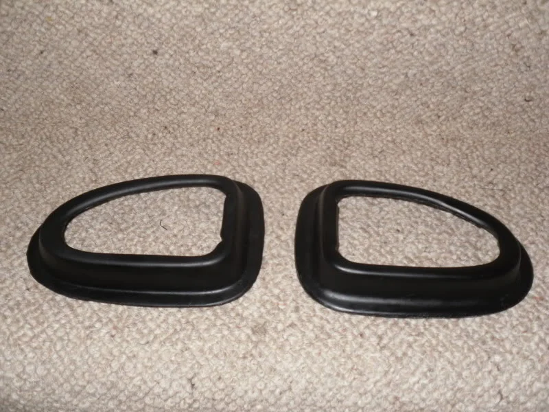

Had these turn up today:
They're the replica cup racer handle spacers that M4D M4X has been making.
Just need to work out how to get the handle to sit in the spacer correctly now!
maynard

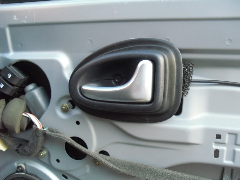

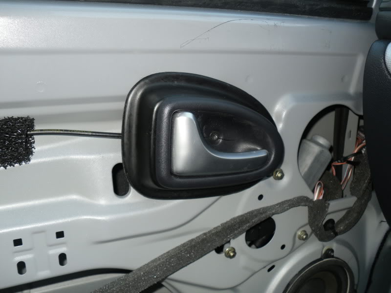

  ph2 172 track car
Just fitted the spacers. Took about an hour or so to file out enough on both spacers to make the handles sit flush. I knew I was going to have to do that anyways.
Before:
After:
Much better!

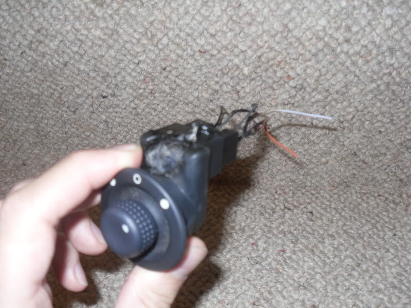

Little update....I've fallen out of love with the car a little bit last few months, partly because of this:
For some reason it seems the window switch got stuck and burnt itself out and as you can see from the photo it started to go up the loom...oops :eek:

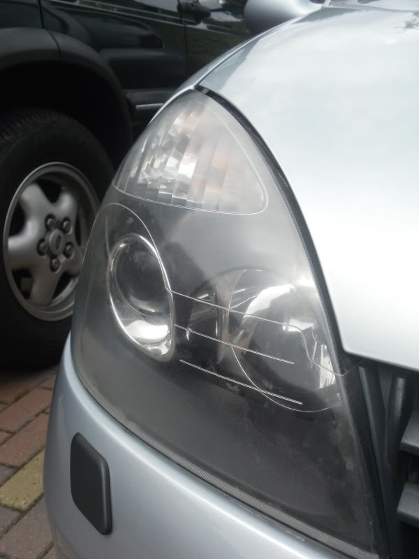

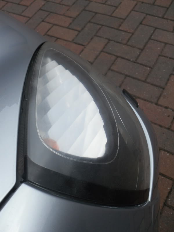

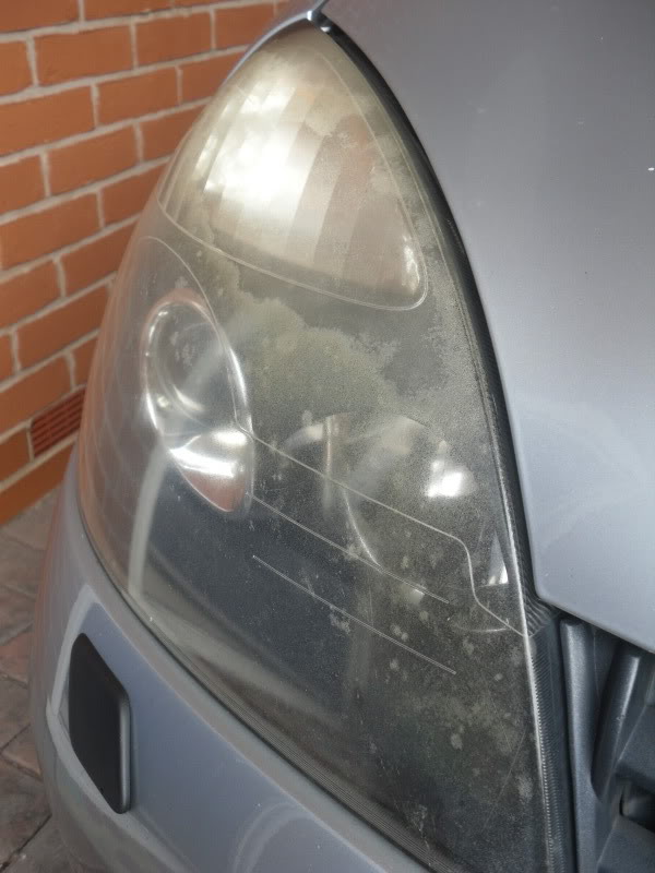

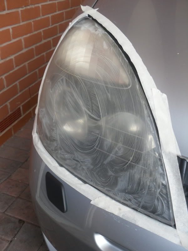

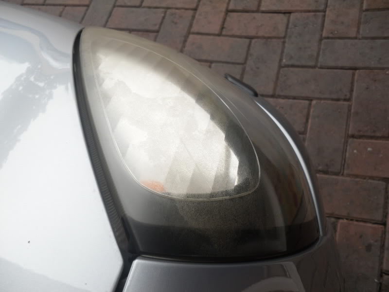

Today.... I had a go at the headlight's as they have needed a good going over for quite a while.
Had a go at this using 1200/1500 wet and dry, Scratch X and SRP. All by hand too.
Results aren't perfect but a lot better then they was before. Will need another going over I think.
Before:
During:
After:
I'm just about to order some more goodies too :)

Cheers mate, get them spacers fitted!
Make sure you file down the inside's though as you won't be able to get the handle through them.
On the headlights...did you get all of the stains off? I was thinking trying the next harder grade up to see if that was any better?
Fletcher
Pretty much. They need going over again now though :(

Top tip for the roof glue, is brake cleaner in an aerosol can and a stanley blade. Just hold the blade with your fingers and push at the glue - dont use it whilst in the knife though!
