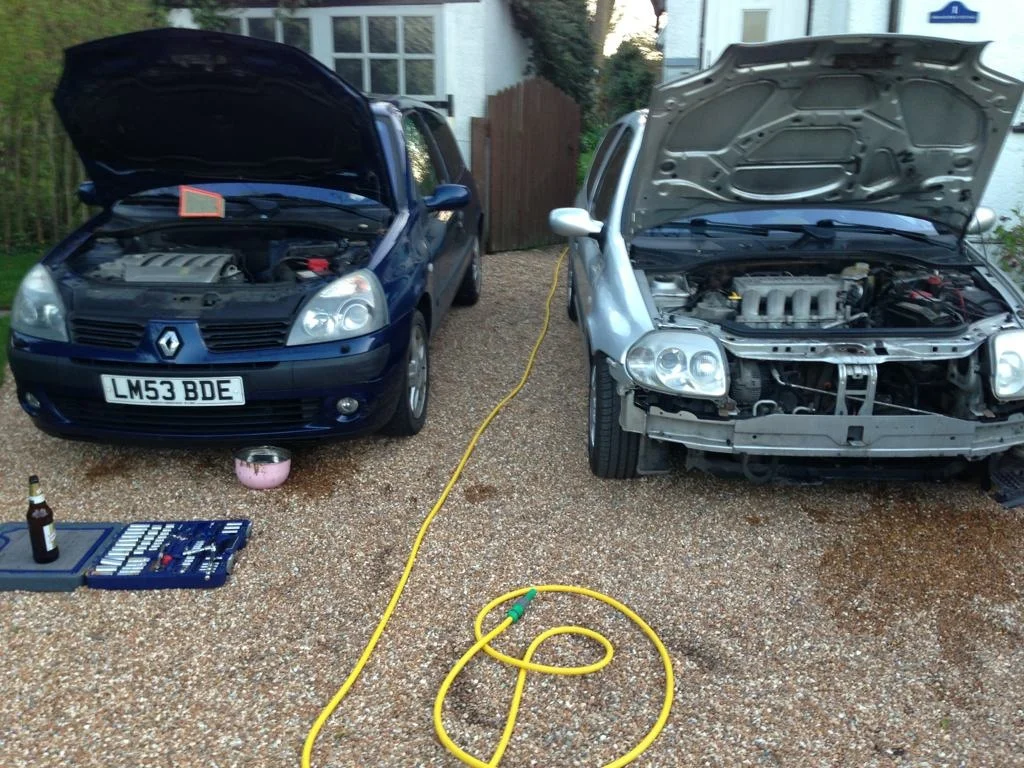

Quick Update. I've been down the dealers and picked up a case of coolant. Thought I'd fix the small leak in my radiator at the same time. The wife's is all done and dusted now. Ordered a new expansion tank to fit later but all good for now ImageUploadedByTapatalk1367270599.967072.jpg
  CLS320 with a D6
Similar process on both cars just had to take the front off mine for better access.
Remove lower hose to radiator and catch coolant in a bowl. I found using a pair of needle nose molegrips easier than regular ones.
When no more comes out, removed bleed screw on n/s of thermostat housing and catch remaining coolant that flows out.
Replace bleed screw and flush system with hose from expansion bottle til water runs clear out of bottom hose.
Remove top hose and repeat flush until clear.
Connect all hoses back up and remove bleed nipple again.
Slowly pour Type D coolant into expansion bottle until it runs in a constant stream out of the bleed nipple.
Replace bleed nipple.
Top up coolant to max level on tank.
Fire up the car and run at fast idle for about 20 mins or take a drive around the block.
Once thermostat opens and fan kicks in, keep an eye on the expansion tank and top up as necessary.
That's pretty much it. Quite an easy thing to do with basic tools and a little bit of time
