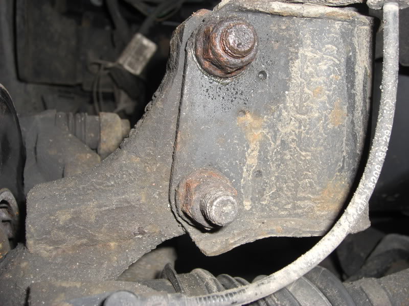

F Firas Car Charged Superleggera Feb 20, 2009 #3 centre of bolt to centre of other bolt. yours should be 58mm mate
F Firas Car Charged Superleggera Feb 20, 2009 #5 yeh it is mate. most of mk2 clio's are 58mm but some of the earlier ph2's had odd 52mm bolt spacing
jesus Feb 20, 2009 #6 Mine's a 2003 52 plate, I'm sure it was 58 though. Hard to get the tape measure dead in the centre bu tit was pretty close to 60 I think (hope!)

I iimushroomzii Toilet roll king Car Transit Connect. Feb 20, 2009 #7 Centers are measured, Easier to just measure top to top or bottom to bottom though lol
F Firas Car Charged Superleggera Feb 20, 2009 #8 it will be abovious whether its 58 or 52 mate but if not sure then get it to a tyre fitter and he will check it for you and shouldnt charge you for it

colossuss Car BMW 330ci Clubsport Feb 21, 2009 #10 iimushroomzii said: Centers are measured, Easier to just measure top to top or bottom to bottom though lol Click to expand... Or top of one bolt to the bottom of the other, that way you should get the same measurement as center to center

I iimushroomzii Toilet roll king Car Transit Connect. Feb 21, 2009 #11 No mate....... Top to top or bottom to bottom.......... Dumbass.
