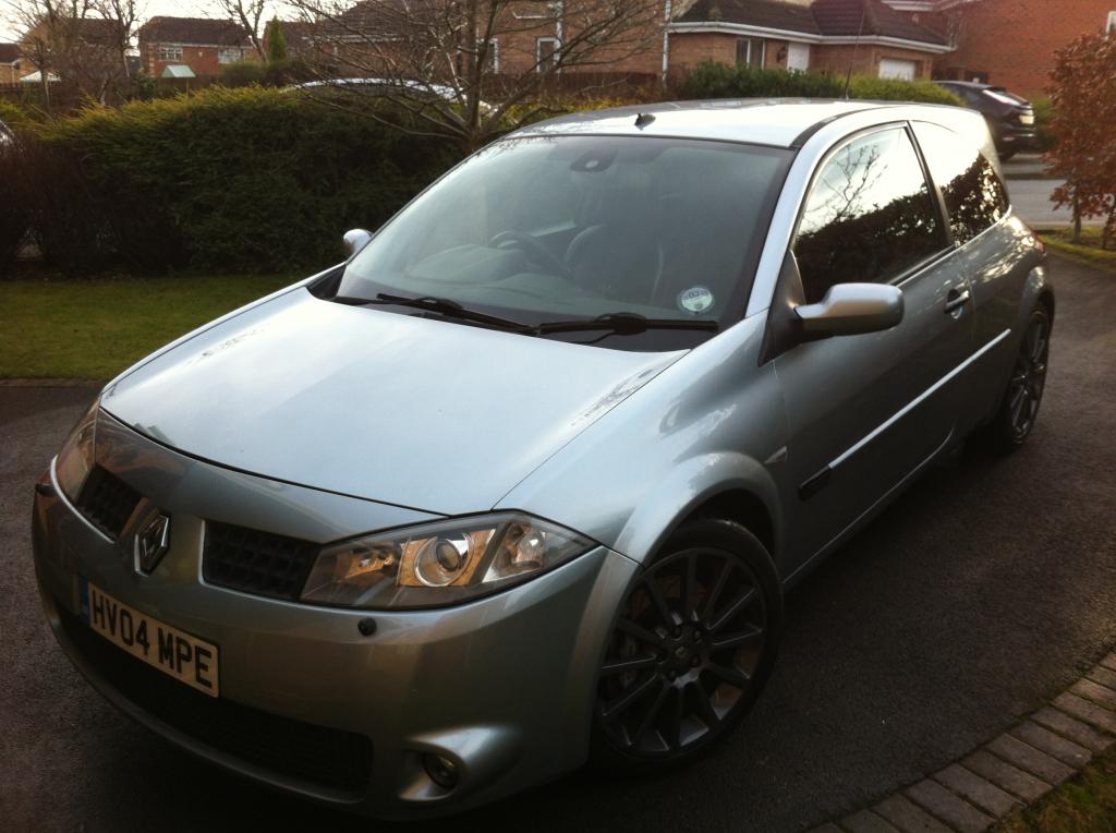

looking at getting a megane 225 cup. Have found a 2004 model that claims to have the cup chassis and lux pack but it has silver brake callipers. It has the cup wheels but is there any more obvious things to also look for to confirm if it has the cup chassis or not. cheers.
All ph1 225 had silver calipers. Got a link to the car your looking at?
It's got xenons which are quite rare mate. Afaik the anthracite wheels are the only give away of a cup/cup packed on a ph1. I'm sure someone with more knowledge than me will come along.
If the ESP goes back on at 30 it's not cup packed, if you can keep it switched off above that then it's got the cup pack.

is there any other ways just that the car is miles away. i think ill ask the owner about the esp though,
cheers guys for the uber fast replys
Yeah there are, like checking the springs but the ESP is the easiest way by far. A non cup can be mapped to keep it switch off but if the car hasn't been mapped its pretty unlikely to have been done.
Won't be a cup as it didn't come out till 05 as the trophy introduced the cup chassis.
this is what i also thought but read on various different sites that it was an option on early cars.
