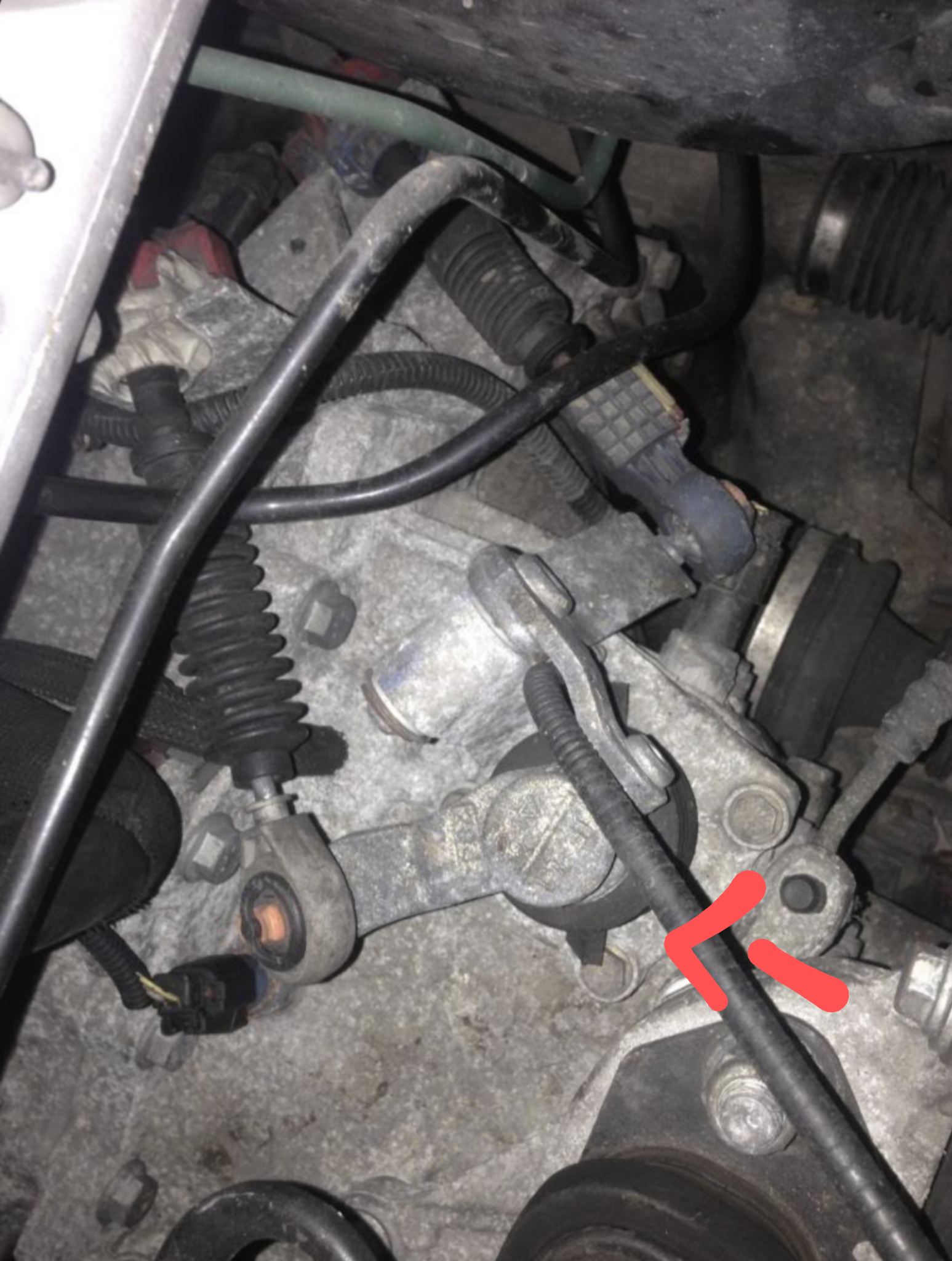

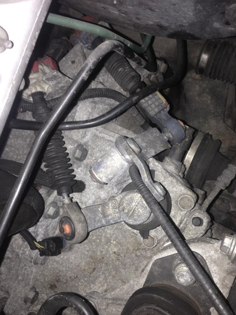

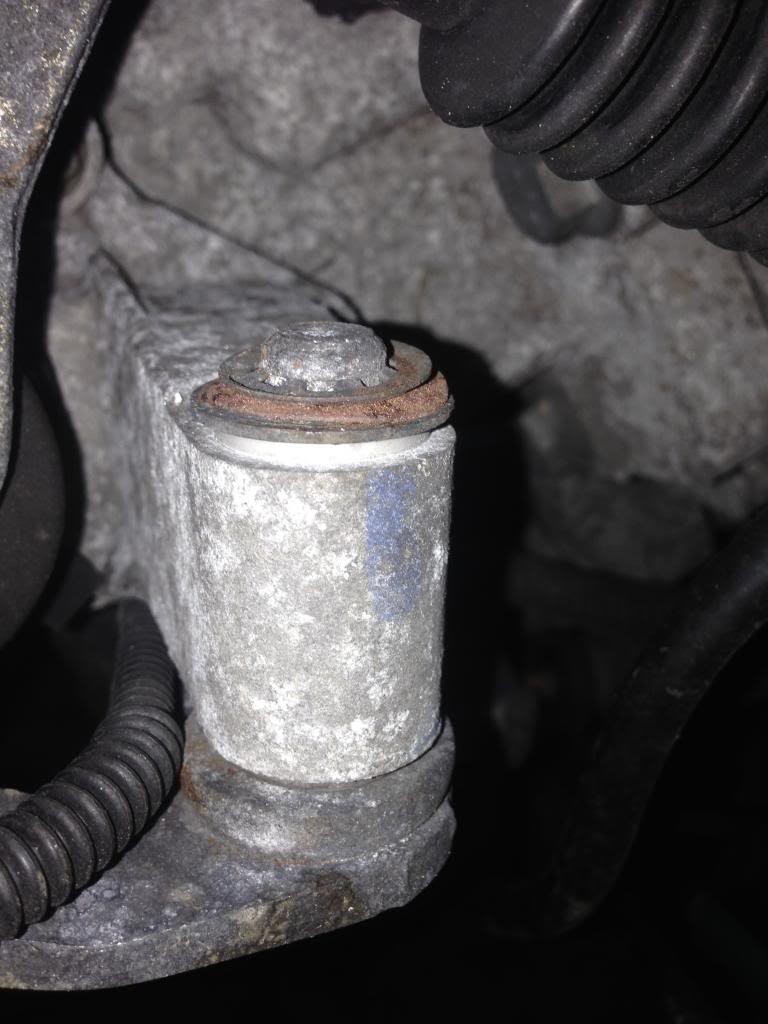

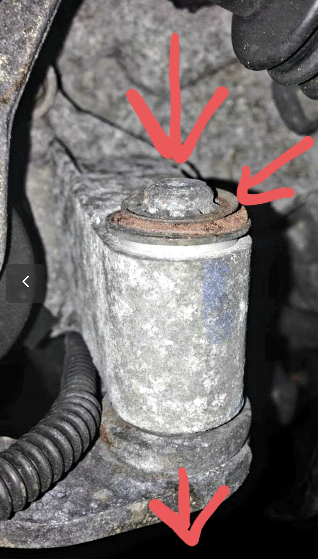

Can see the white sleeve here

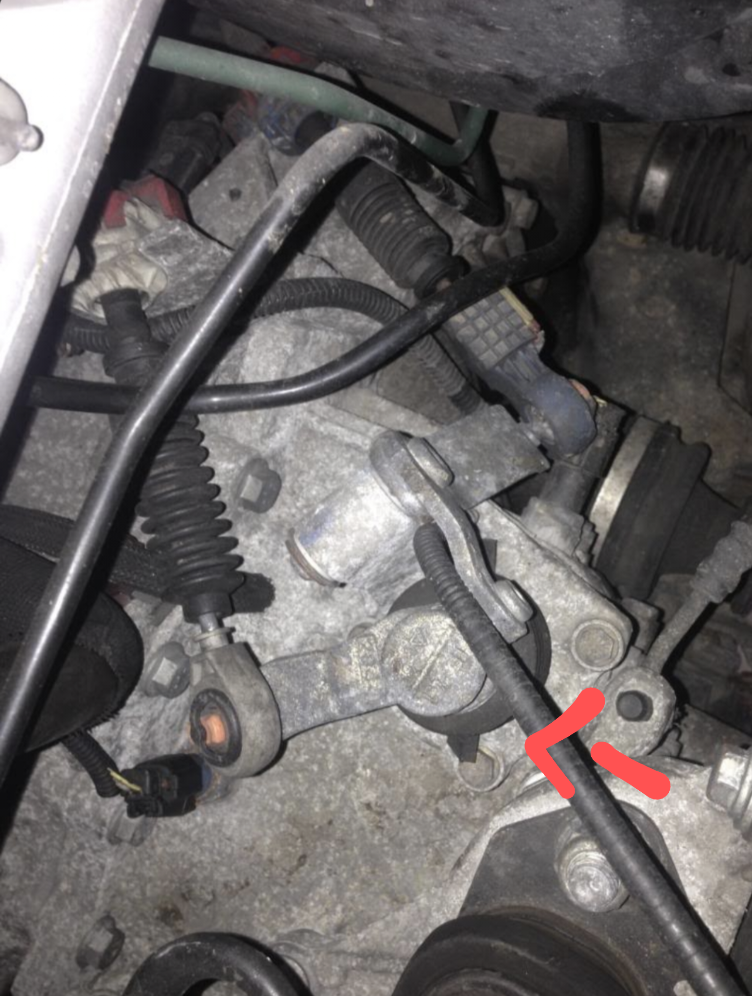

There's a 13mm bolt that is in the side of the box which pins the selector in. It's sort of under the gearbox mount area, if you have a feel around should find it. You'll need a ratchet spanner to do it.

So remove this circlip thing, push the pin through and clean up the inside of the bush and refit? Is that correct?

Had to this on my R26 box I put into my clio. Made it much nicer. Mine wouldn't centre properly, would just stay to the left. 3rd gear was the worst to select.

Yeah haha guess how I found out? Definitely nothing to do with my first post hahahahaha.... 😁🤣🤣🤣
Been years since I've done one, but could have sworn it was a 13mm.
14mm is such an odd size on them, can usually do the whole car with 10, 13, 17, 19mm 😂
Hamburglar
Exactly why it threw me off too. 150% a 14mm on them all as I've removed about 6 of them now 😂
Must have something to do with it being a spring ball on the end of the bolt as it's not a standard bolt.
