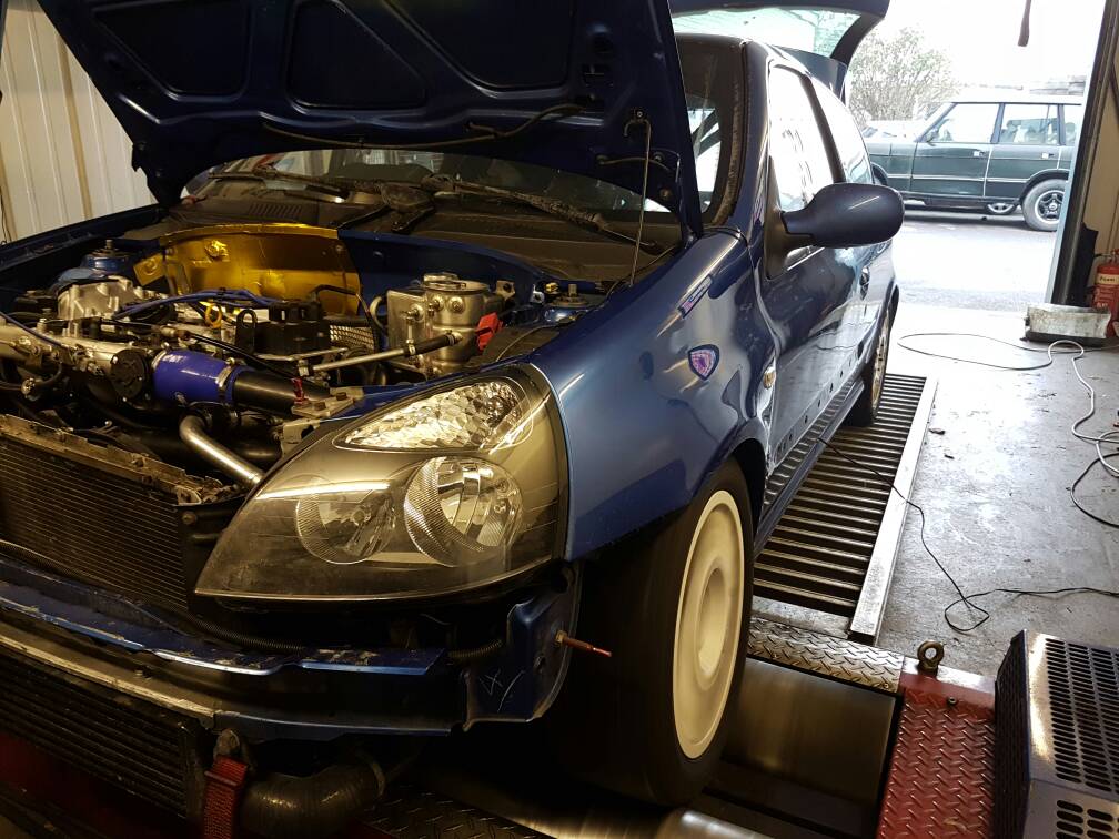

So last monday had big troubles with it overheating, so much so the hg was thought to have gone, but was only a scare.
Caused by a didgy t stat. So yeah wasted day that was, got it sorted by changing coolant lines around a bit so all coolant was going through rad, also removed stat which seemed to work.

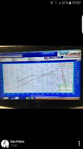

Went on the dyno today, came away with a f**king brilliant driveable clio at 260bhp @0.7bar. Also on none harsh rollers, dan @ sjm said would make 280 elsewhere haha.
So yeah reason we couldnt push it to 1 bar was again down to overheating issues unfortunately, so new radiator time. Gonna see how Snetterton goes on the 8th with standard rad, as it gets much better and cooler air flow on track.

Anyway good result mate, not far out with my 270bhp/290ftlb guess!!?
I commented on a post on tracktime that you put up but when I went to see if it was done the post had gone!?
Unfortunately no where near the torque though.
Really strugglinf with torque (it doesnt feel it) but only "made" 210lb ft
Unfortunately the gt2871 turbo Im using only really gets going at 1bar, and me not currently running 1 bar makes it run quite low torque.
But the best thing about this is the torque curve, it puts the power down so good! Which i think will be really good for track work!

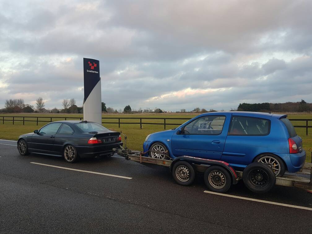

Think I saw you when I was on the way home from work in the van, well your car on the trailer lol....A350 on the way out of Chippenham

That will be me mate haha so many clios in chippenham on a unrelated note.
