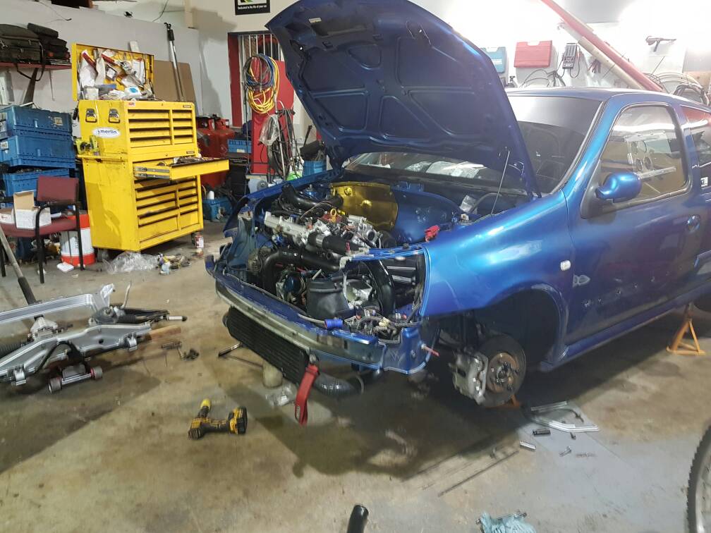

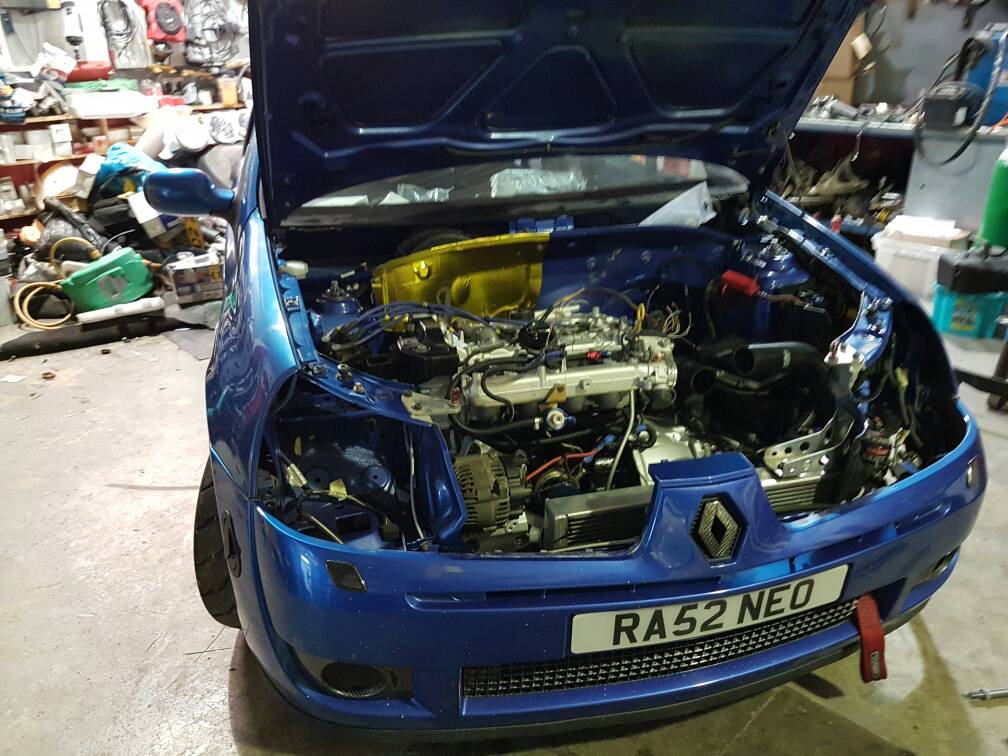

Not sure if ive got any brush paint left, cant really be bothered to strip it down so I can paint the casing... hahabsort that alternator out as well, it's minging!!!!!

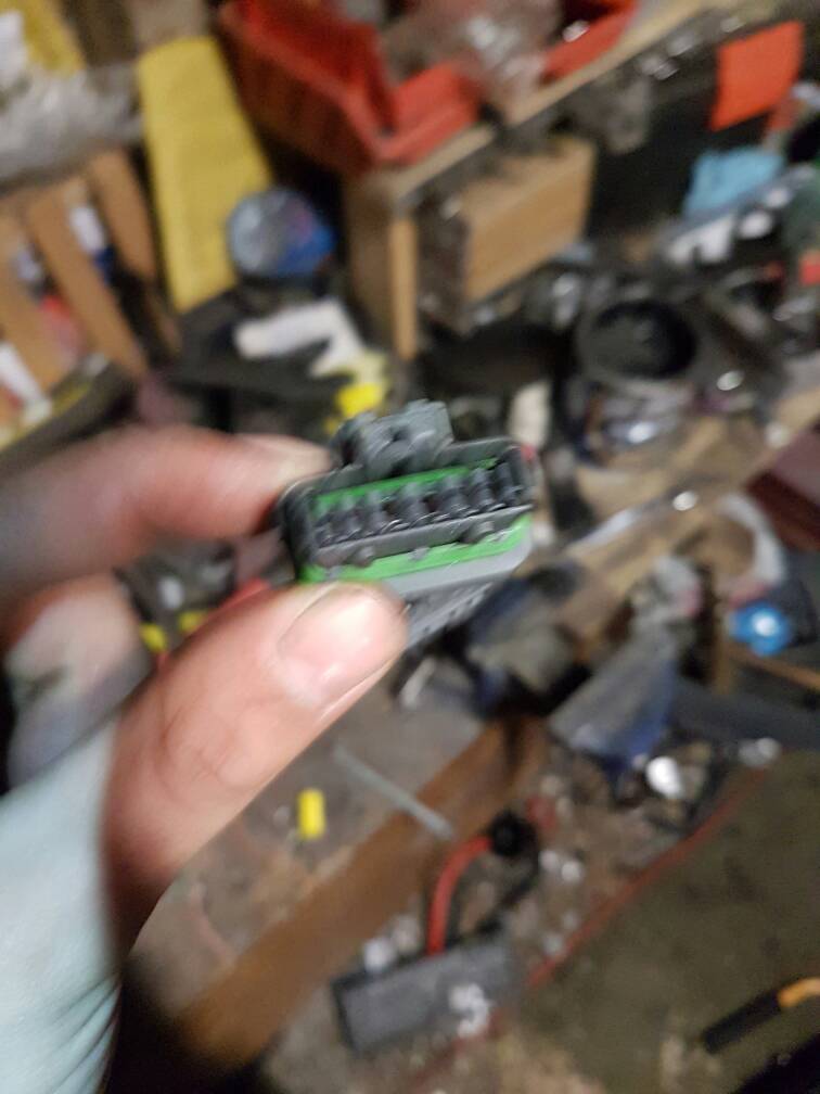

Got the crank sensor loom extended and wired In... thanks to Jason Barnes on here! For all his wiring help so far.

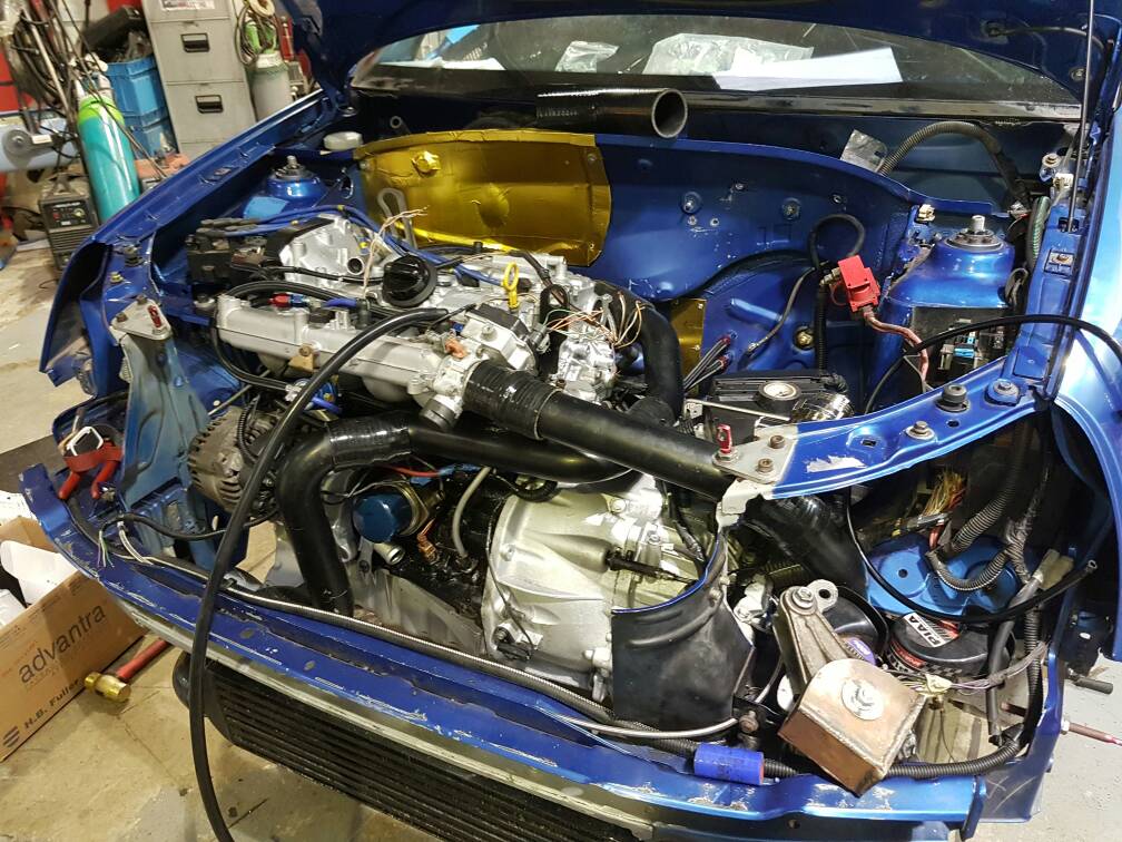

I dont know mate, I need to speak to mike about coming round to get a base map/sync sensors etcHappy to help @Mash.

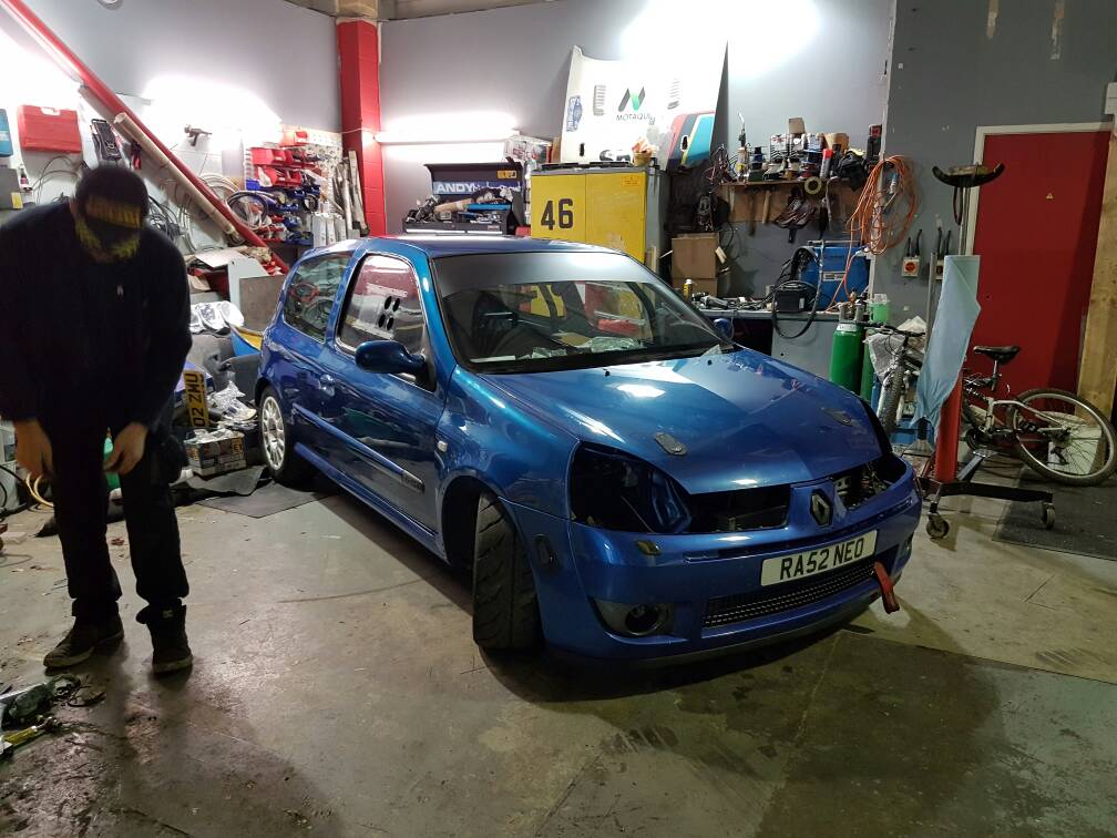

When do you recon it'll get its first fire up ?

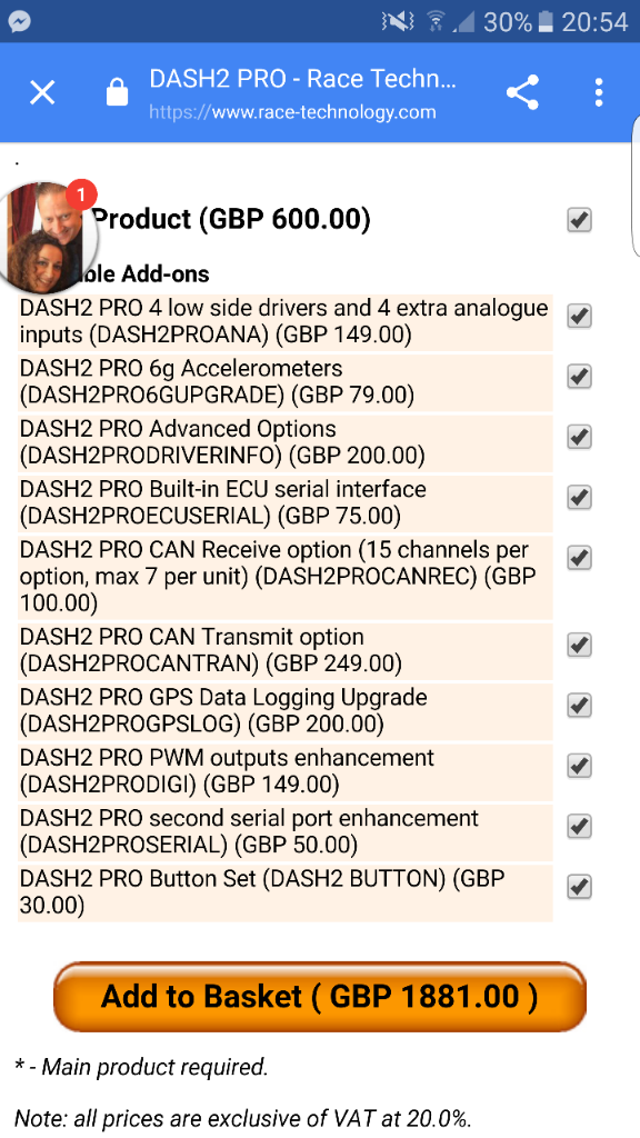

Pricey, but very nice.
I'll message you MattI looked at these when I couldn't get the Megane cluster to work but was put off by the price. What set off discount can you get on these?
Yeah as this guy said above, gen90 for the moment.Been reading through but can't work out what ECU you're using to run the car?

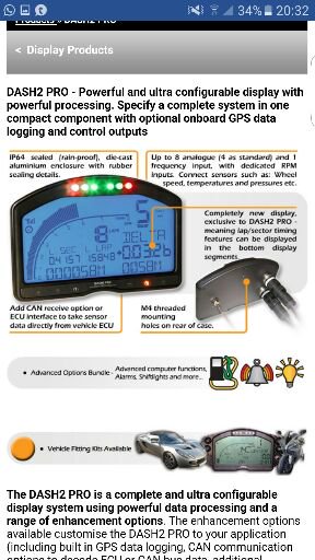

Also have a look at the dash options through people like Plex - they're used in some of the more advanced builds/cars I've been involved with and IMO are built 100x better than the Race Technology stuff is...

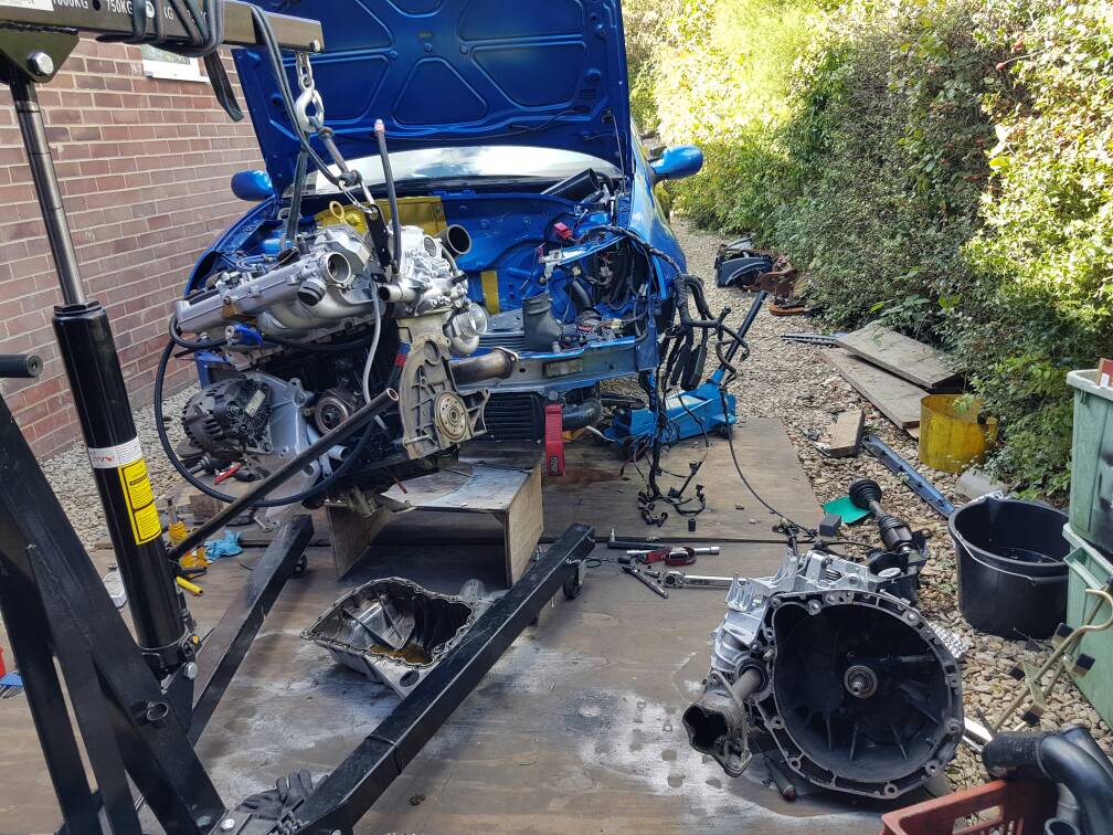

I've got the same weep, it's pretty annoying but with a winter build on the cards I'm happy to leave it. Pretty sure it's the crank seal or the crank seal insert needs resealing. Reno have a special tool for inserting the crank seal but I'm sure it's around £150Engines coming back out tomorrow, got a leak coming down the gearbox to engine join - smells like engine oil, so think it possible could be crank seal... will have a ganders tomorrow
Sent from my SM-G935F using Tapatalk
Yeah mine was the sump in the end, crank seal was completely dry [emoji42]I've got the same weep, it's pretty annoying but with a winter build on the cards I'm happy to leave it. Pretty sure it's the crank seal or the crank seal insert needs resealing. Reno have a special tool for inserting the crank seal but I'm sure it's around £150

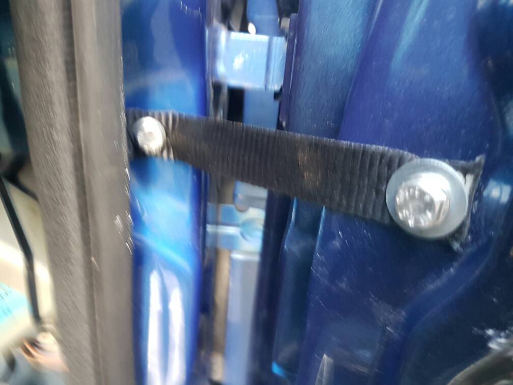

Check strap for fiberglass doors, check..

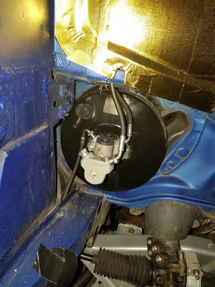

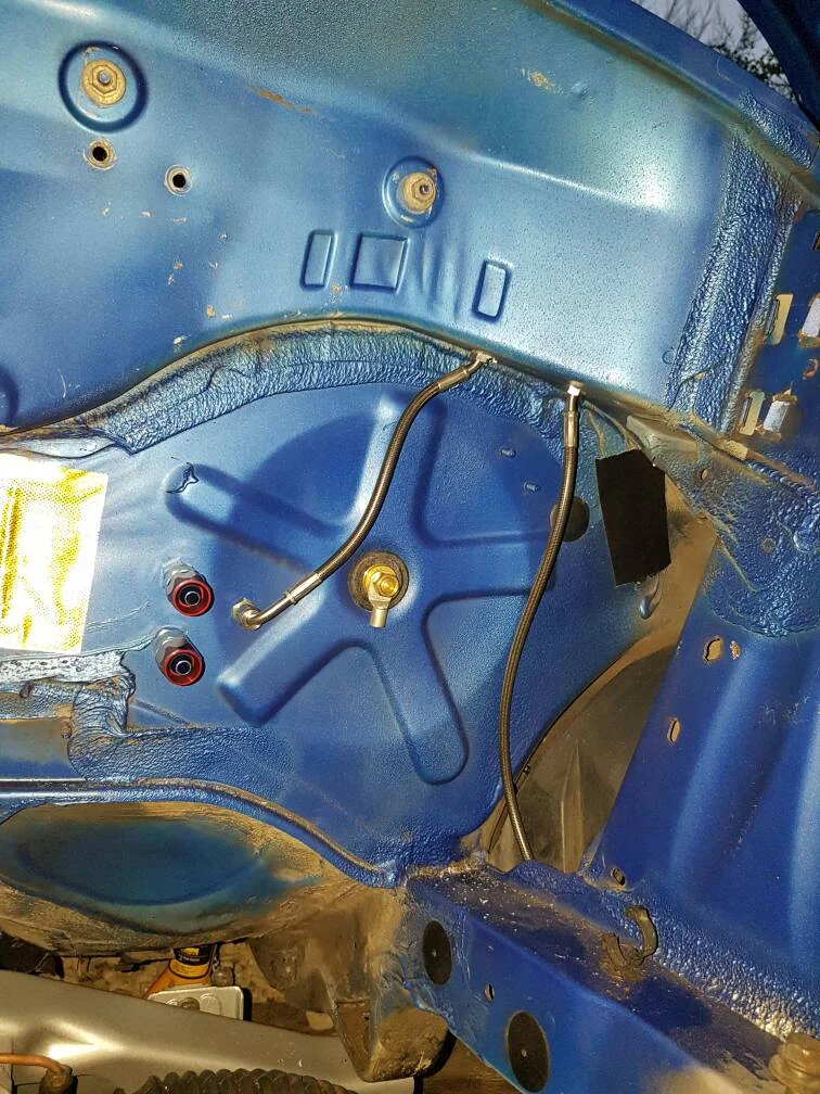

Custom brake lines, check

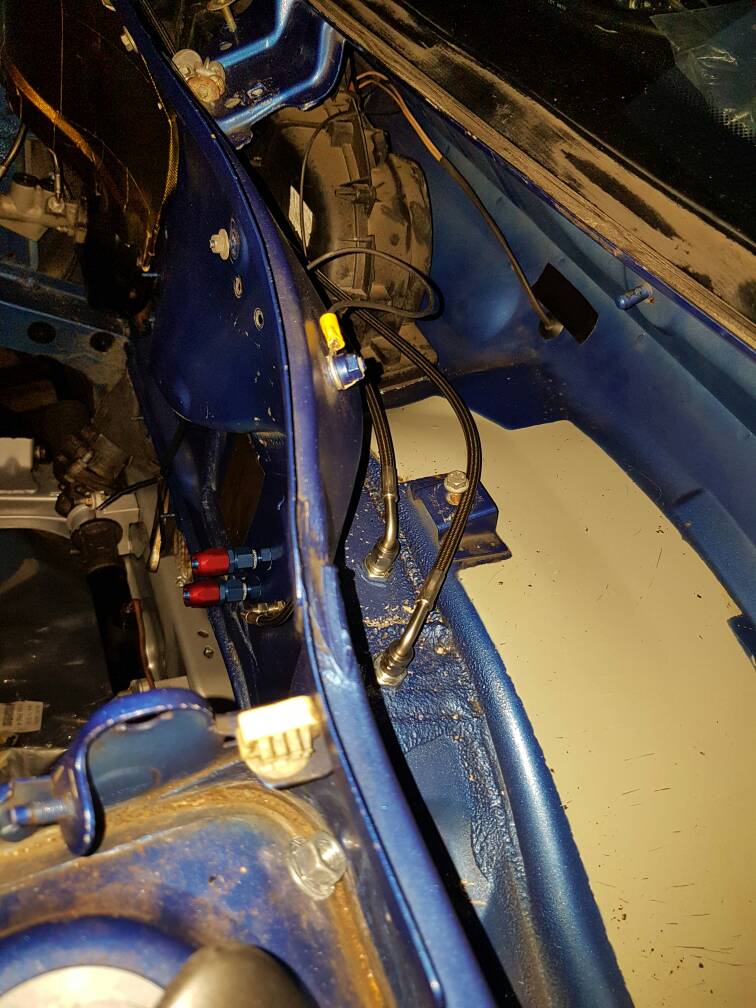

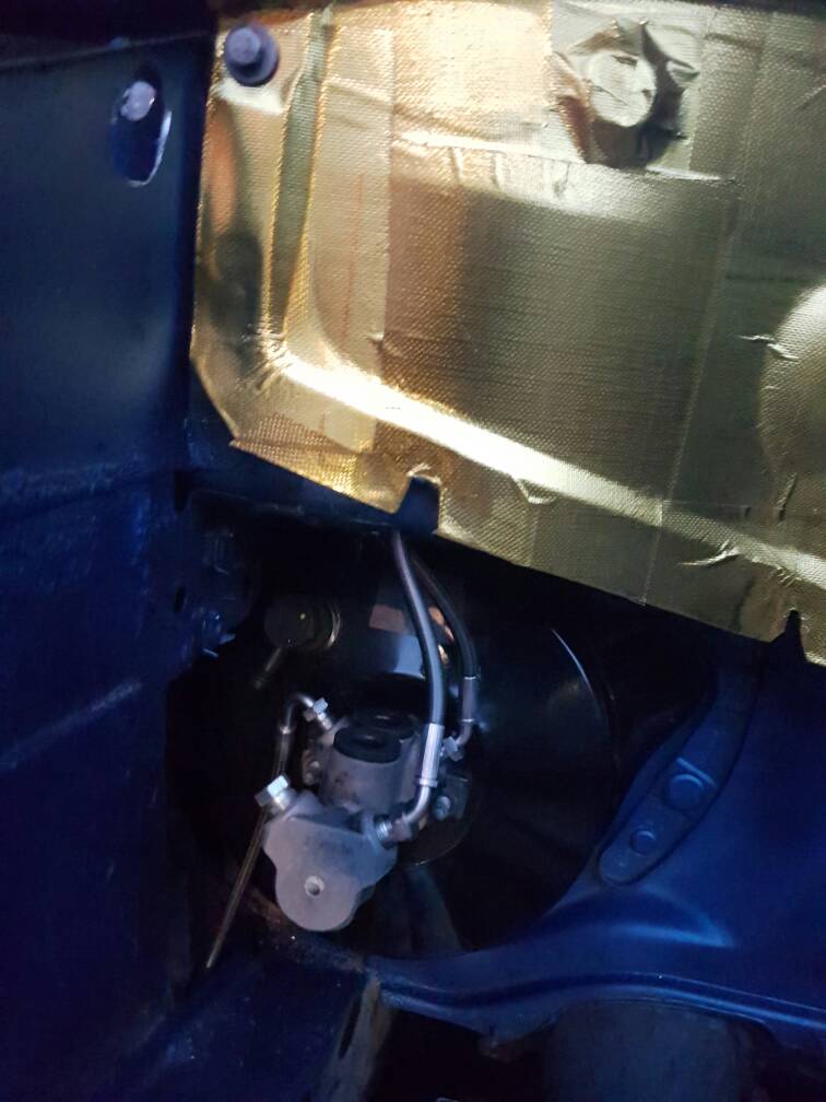

What configuration are you using for the master cylinder? looking at the photo obviously left side top - drivers front, im assuming Left side front is a blanked rear port. But on the right hand side of the MC have you run top right to rears and front right to the passenger side front?

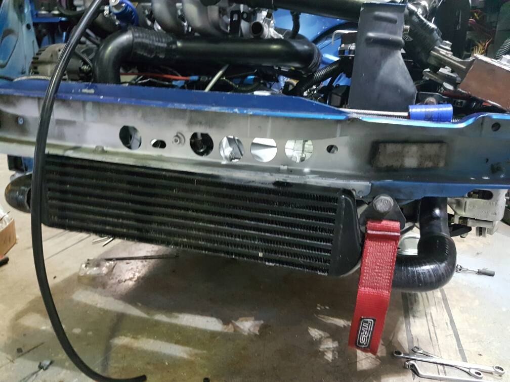

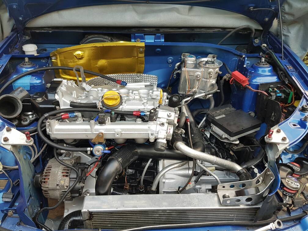

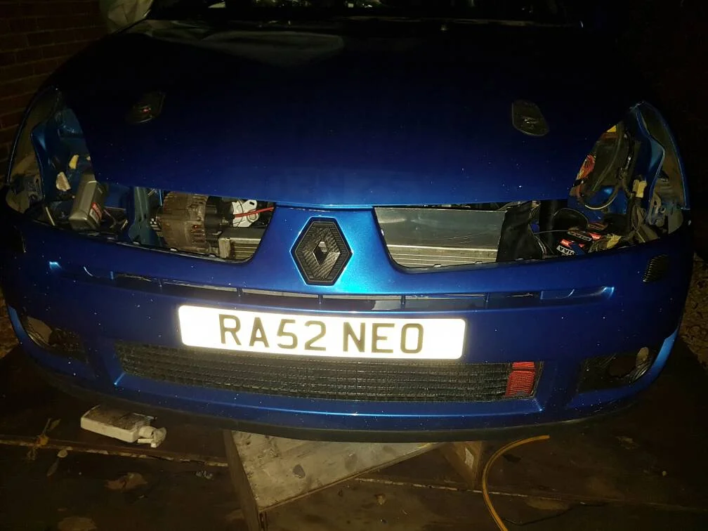

You want to put a frame around the rad to catch the air rather than allow it to spill over the sides. Air is like a lazy human - takes the path of least resistance.
And you may also need to stump up the cash and have a proper motorsport spec fabricated rad. They really are worth the money.
Ah yeah sorry I forgot who's car this was originally. AH fabrication are s**t hot, so that rad should be man enough tbf. I'd throw in a 197 stat for good measure too.Yeah good point, if I deflect it from above not all of it will be forced through
The whole system is much better than a standard clio one, all alloy pipes, self bleading etc just the size thats annoying. It was done by AH fab, so not backstreet
Only one way to find out really...
Yeah exactly that haha.Ah yeah sorry I forgot who's car this was originally. AH fabrication are s**t hot, so that rad should be man enough tbf. I'd throw in a 197 stat for good measure too.
As in no thermostat?? Please tell me you haven't done this!Yeah exactly that haha.
Ive actually removed the stat completely :smile:

Left the ring in with the o ring, but internals removed.As in no thermostat?? Please tell me you haven't done this!
