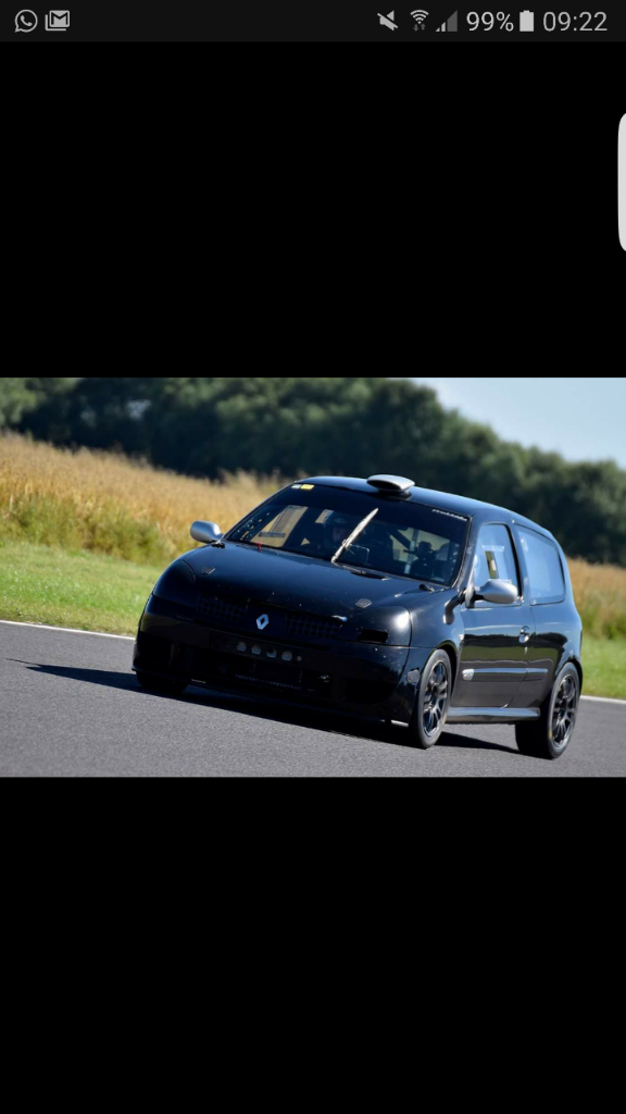

Hey guys, so moving on from my last track project - "track phase 182" Ive decided to do something Ive always wanted to do, which is put a 225 engine into a 1*2. This oportunity came about last weekend at Castle combe i took some chap out in my clio below, and he enjoyed it that much he made me an offer I couldnt refuse, so its sold and hopefully this weekend he is picking it up

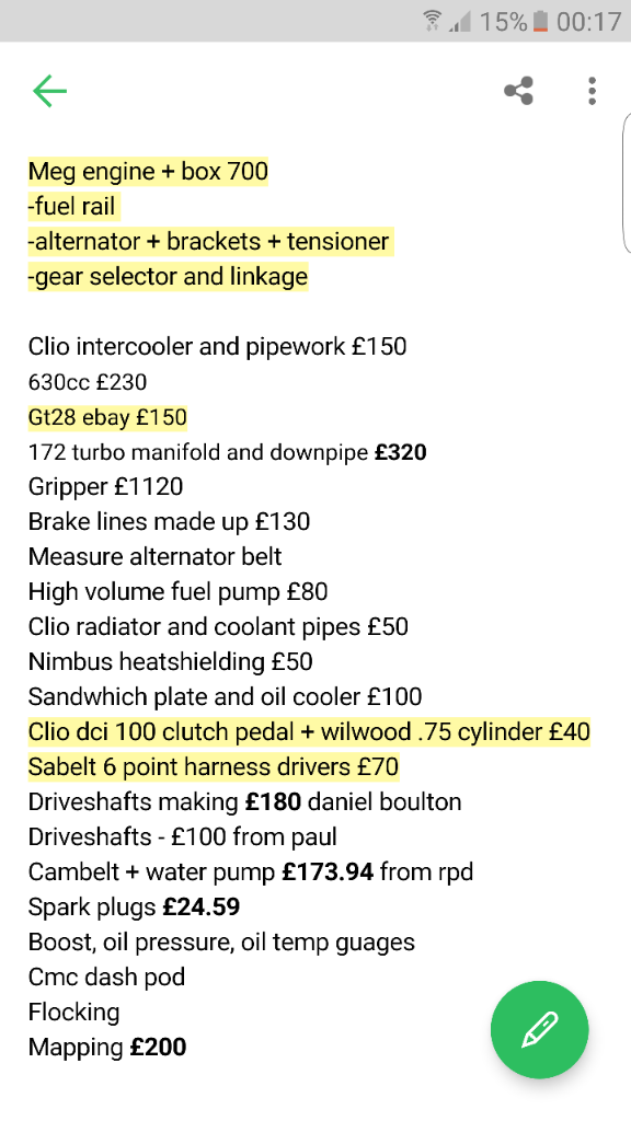

So this is the list I've been working on, pretty sure Ive covered everything I need to buy, few engine mount things that arnt listed as they will be made.
But yeah thats something like 3.5k there and thats without the standalone ecu [emoji22]
With a meg donor car you could quite easily see the conversion under 1.5k - but thats not really where I wanted the car, and obviously had to get a gripper didnt I [emoji14]

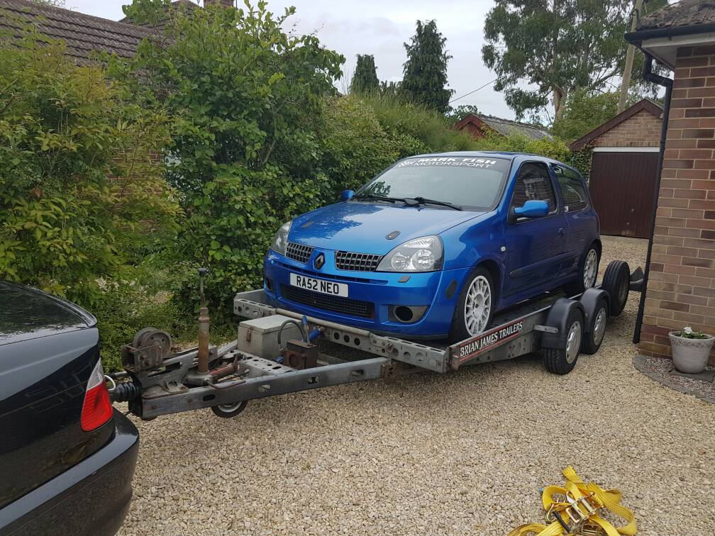

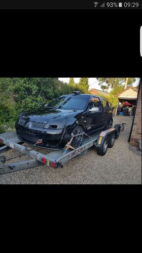

So yeah this sunday morning the BG will be taken away, and then I will set off down to devon trailer in tow to pick up the cup, I need a catchy name for this project and #turbocup has already been taken... anyone?
"Goodbye my lovaaar"

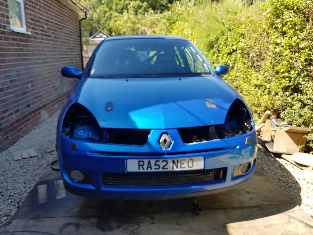

Shes home, went out for a quick spin before i started removing the engine it was good fun tbh the noise of the bodies Is very moorish!
The driving position is horrendous compared to my other car, which can be sorted with some column movement and hopefully theres some slack in the megane shifter cables so the shifter can be moved back when its in!
In the 182 the exhaust tunnel was welded 8cm futher back which was much better so we can see what we can do!
Anyway there we go, didnt get very far today due to weather but engine should be out tomorrow afternoon!

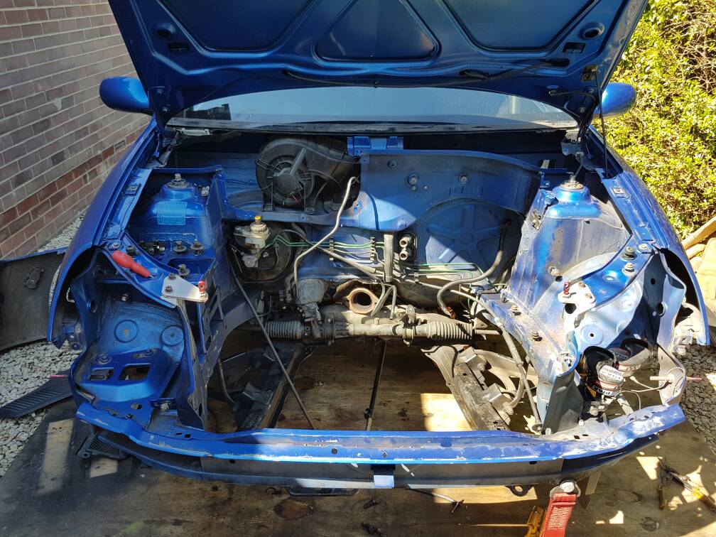

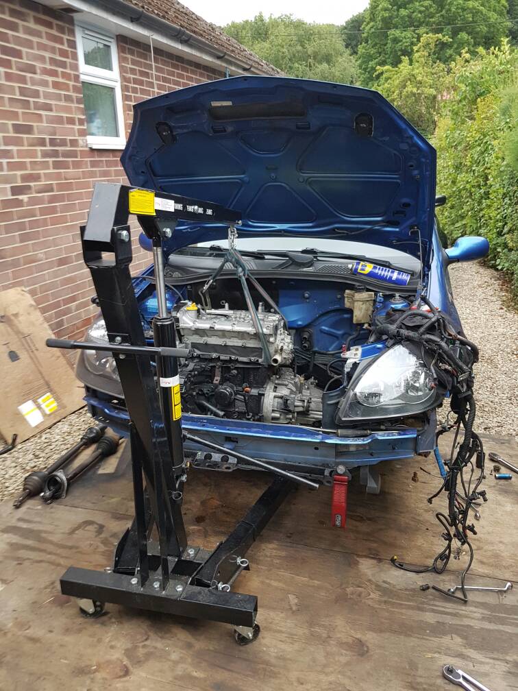

Engines out!

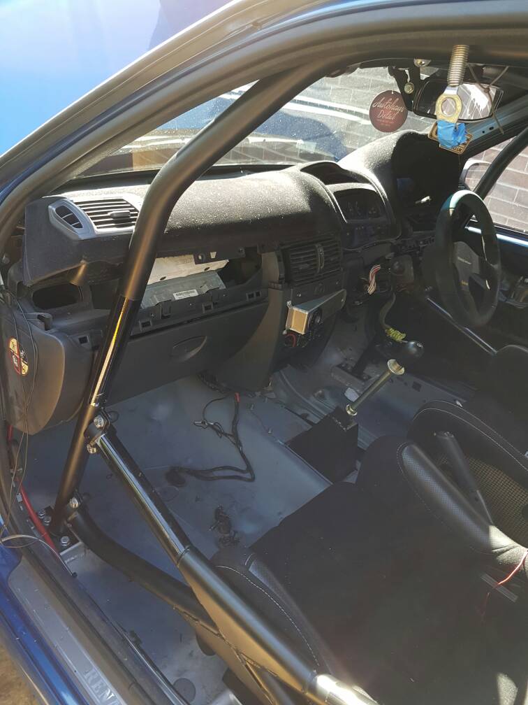

Interior has been stripped, came across a problem with the dash dodger, its actually no good to get the dash out...
So I ended up cutting it in half... hopefully to be hidden by a fiberglass dash pod which will join the two pieces together..

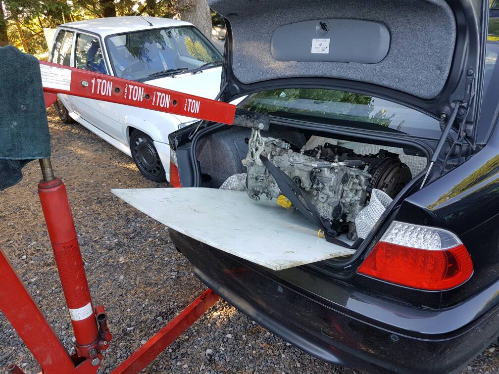

Picked up the 225 engine and other bits, measured it up to check it would fit in a coupe, it did...
Tomorrow will involve getting the meg engine in and brackets made up, and picking up my driveshafts also, saweeet

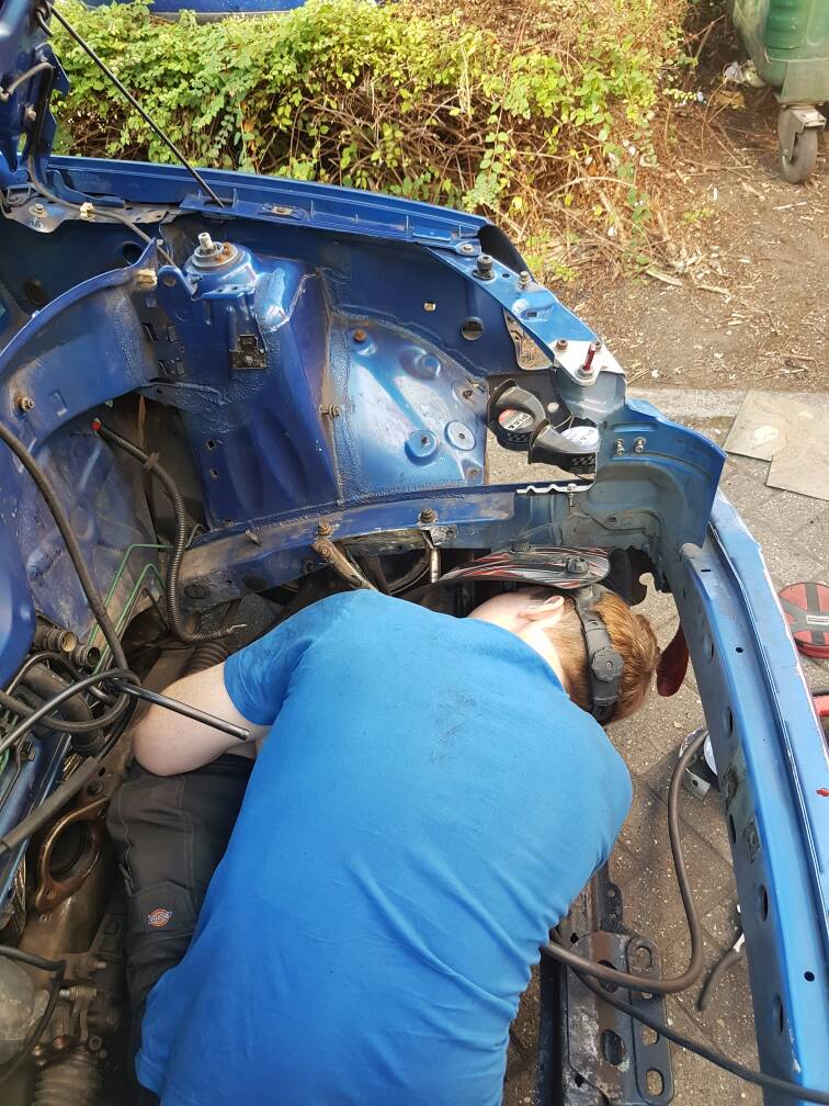

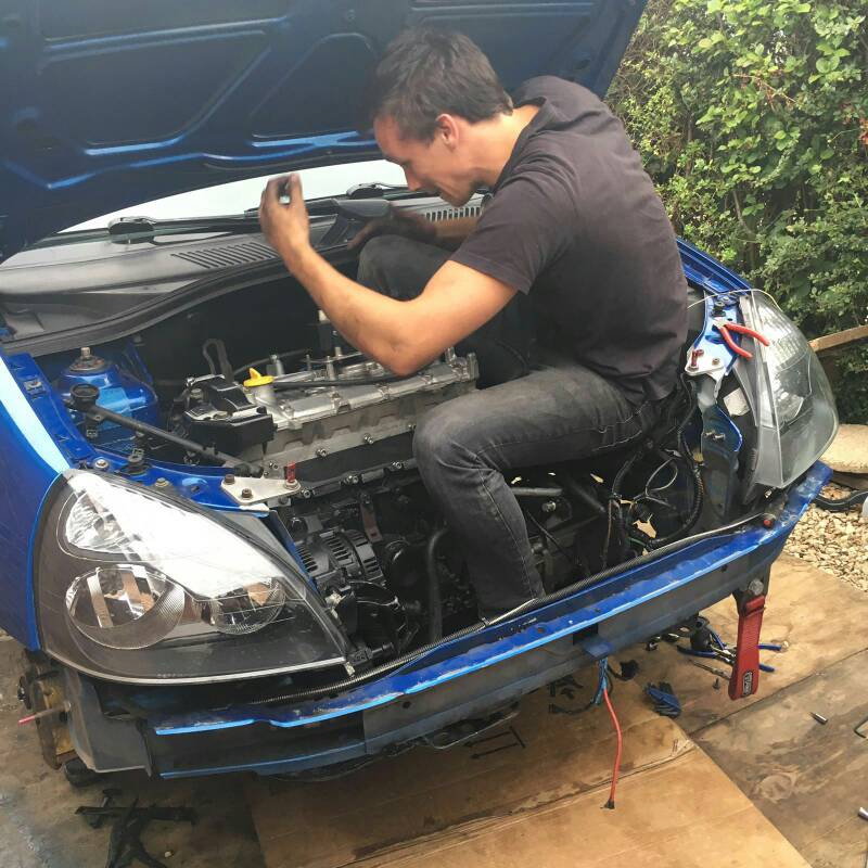

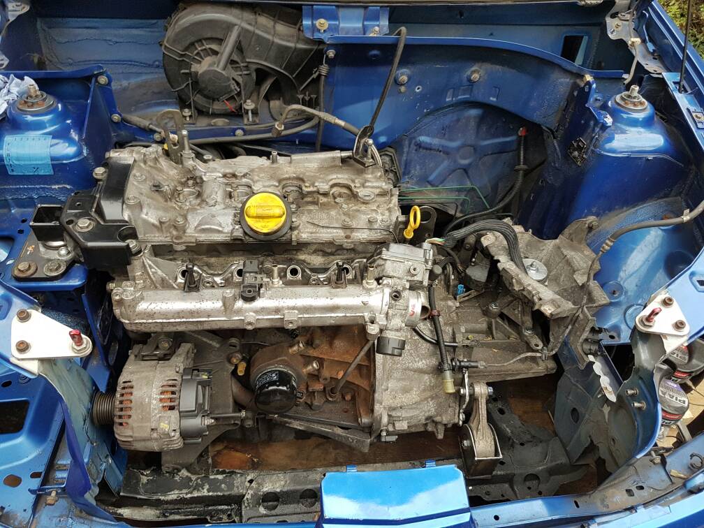

Anyway good day today, wasnt a good day to choose to be in a small space cutting and welding but a big thanks to a mate Alex who sorted out the welding for me.
Ran out of time In the end to finish the dogbone mount, but we got the engine in and sat on the gearbox mount and original engine mount..
Were it all started...

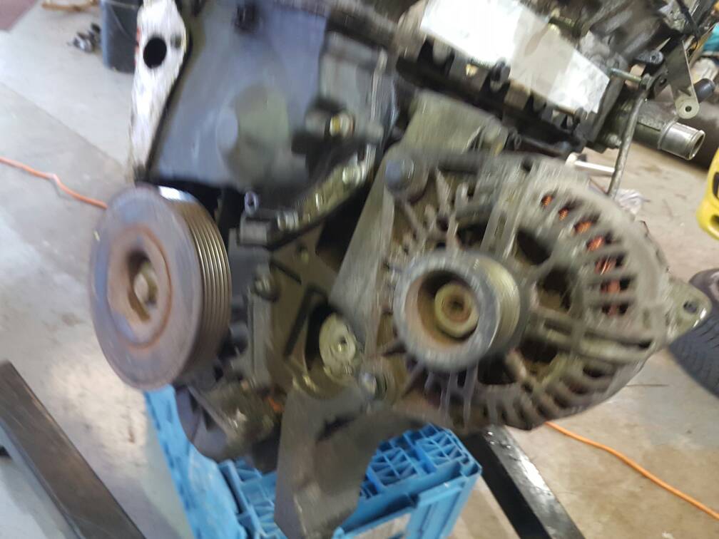

First problem I faced was the aux belt routing, so Ive seen how people have done it with the rose joints and a tie rod to lower the pulley down so it runs with the tensioner.
Instead I have cut the cam belt cover so I can run the aux belt straight through from crank pulley and aux, yes this leaves a bit of the gap showing the cambelt, but ill see if I can sort another cover, if not no biggy. No tensioner part should work fine, itll just be more of a pain finding a belt the right size, but its only sprinning the alternator so shouldnt neeed to be to tight.

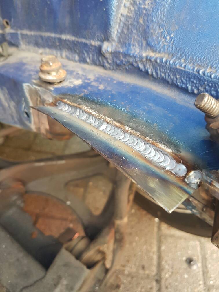

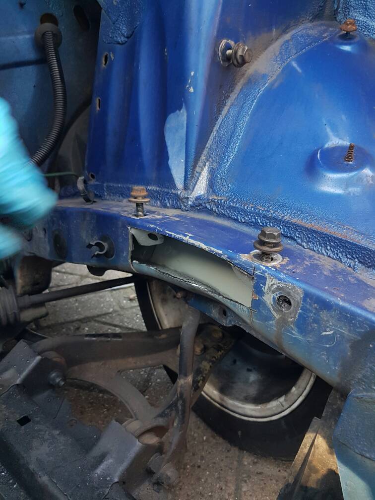

Anyway while I was stripping the engine, alex was busy welding...

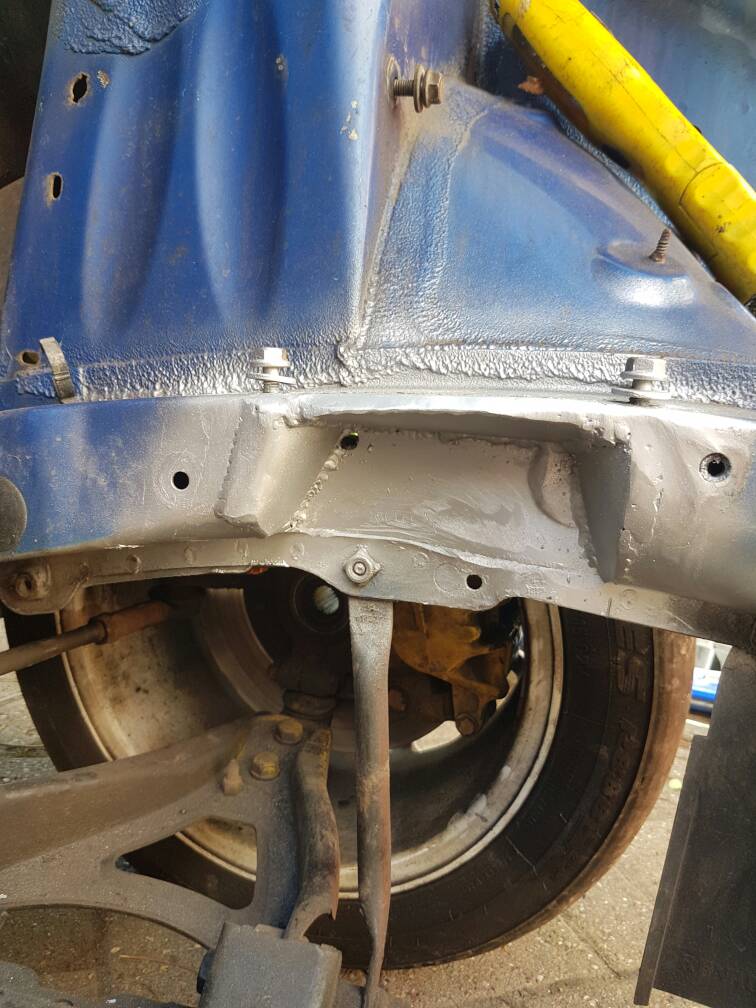

Anyway there we go, the finished chassis notch, when we fitted the engine/box it didnt actually need to be as wide as this, reference the bolts for size.

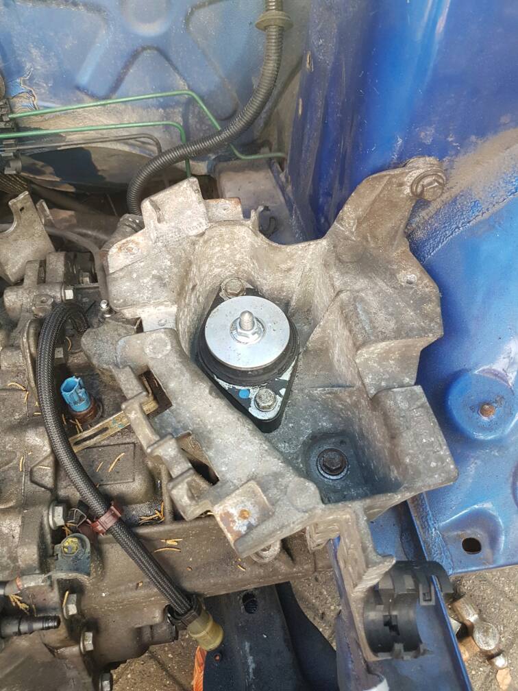

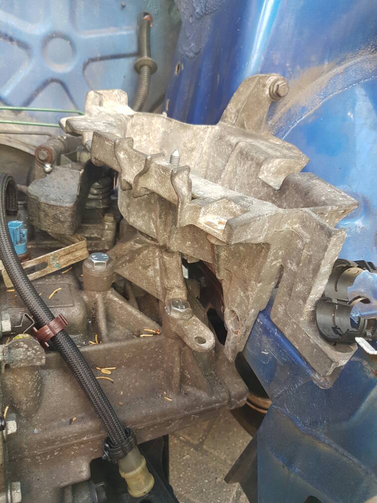

Moving on, the box mount - this is a hybrid of using the meg lower spider mount and the clio upper battery tray and bush.
Nice and easy on that side.

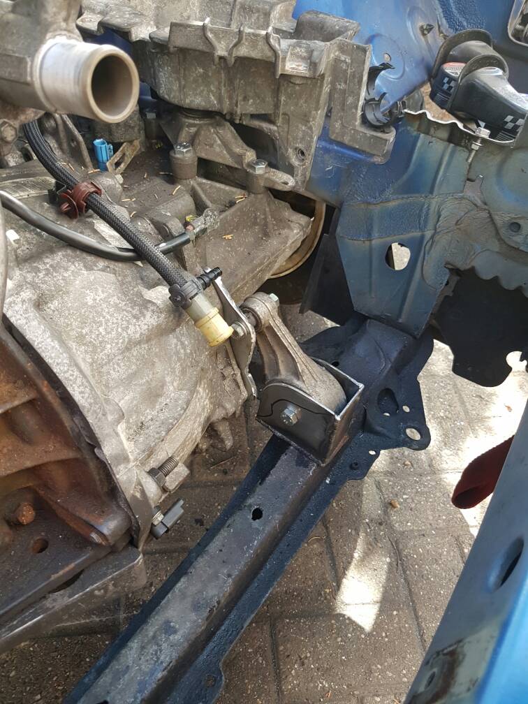

Anyway it needs another 2 more engine mounts made.. ideally one for the dogbone and another torque mount infront of the gearbox.

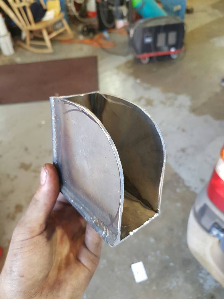

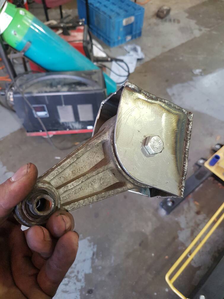

So we started on the front torque mount. Alex made me a box section, and I cut it to shape
Using a ph1 dogbone to keep is as "off the shelf as possible
And made an adaptor from the box to the to ph1 dogbone
So yeah ran out of time to make the dogbone mount, but half of it is made up just to weld it all together.
Voila.

For the chassis rail I just applied some heat and used a ball pein hammer to create the required space. TBH it didn't need very much manipulation. I'm also using clio top mounts but opted for vibratechnics fast road mounts. Race ones were horrendous.
