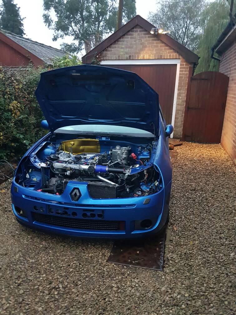

Well deciding im taking it a slightly different route, meaning progress has been pushed back.

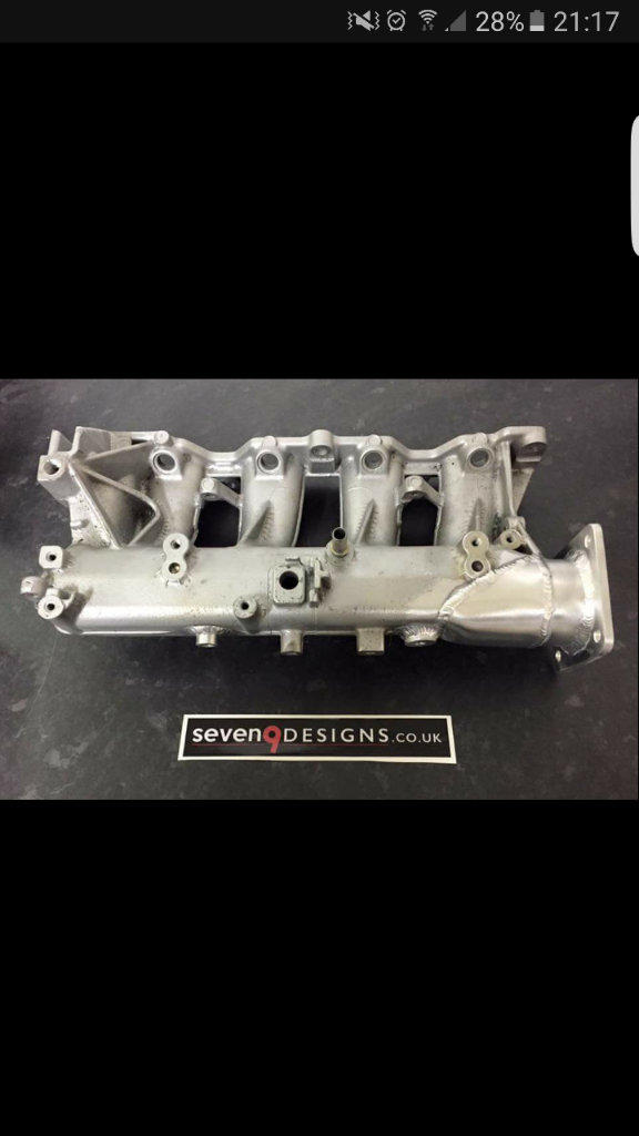

So instead of using the megane throttle body (which is broken anyway) im going to have the inlet modified for a clio tb.
This means, easier replacements, less air restriction, easier to wire.
I am also going to a cable throttle, i like cable throttle, its just nicer.

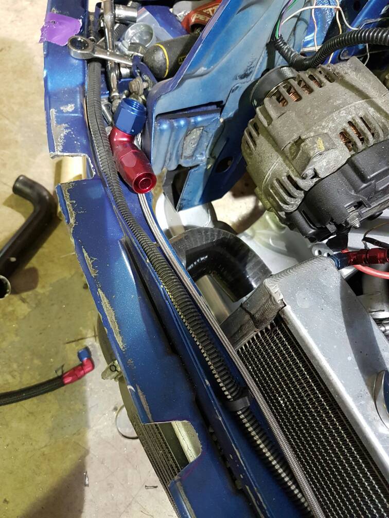

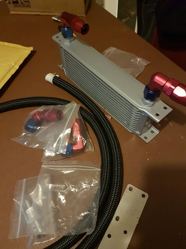

Oil cooler bits are here also, so will get that mounted tomorrow
Sent from my SM-G935F using Tapatalk

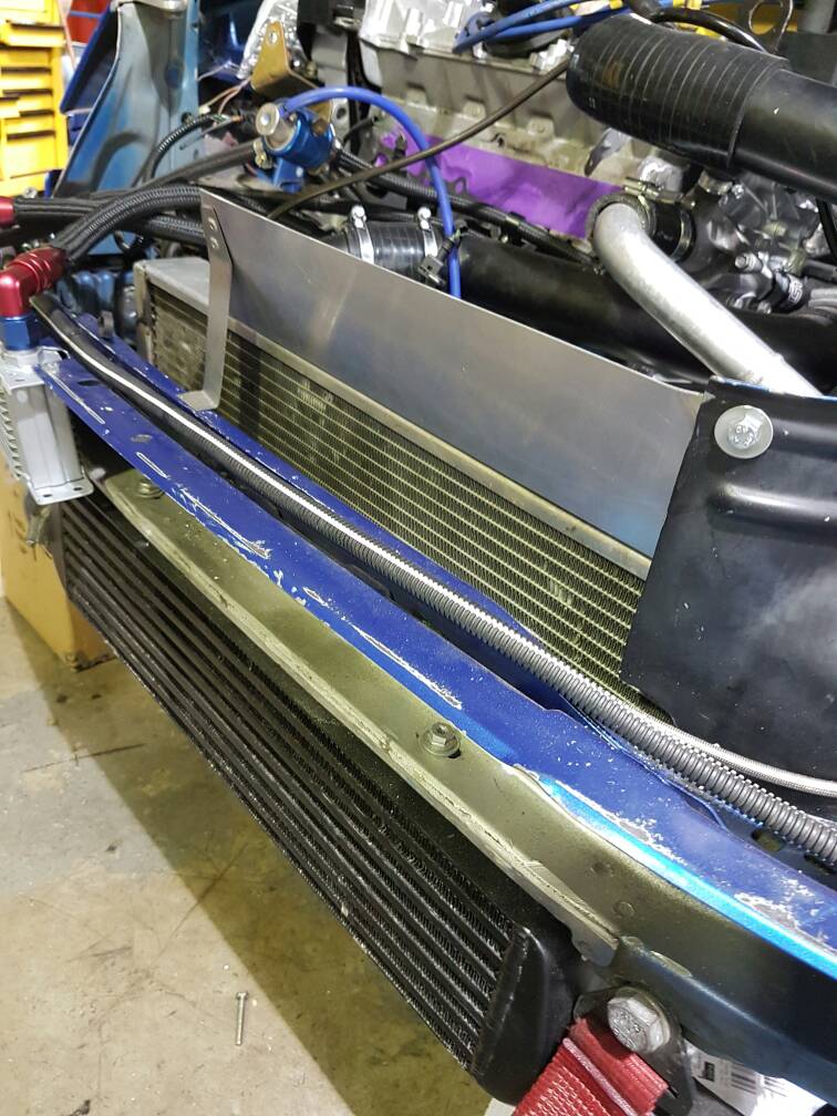

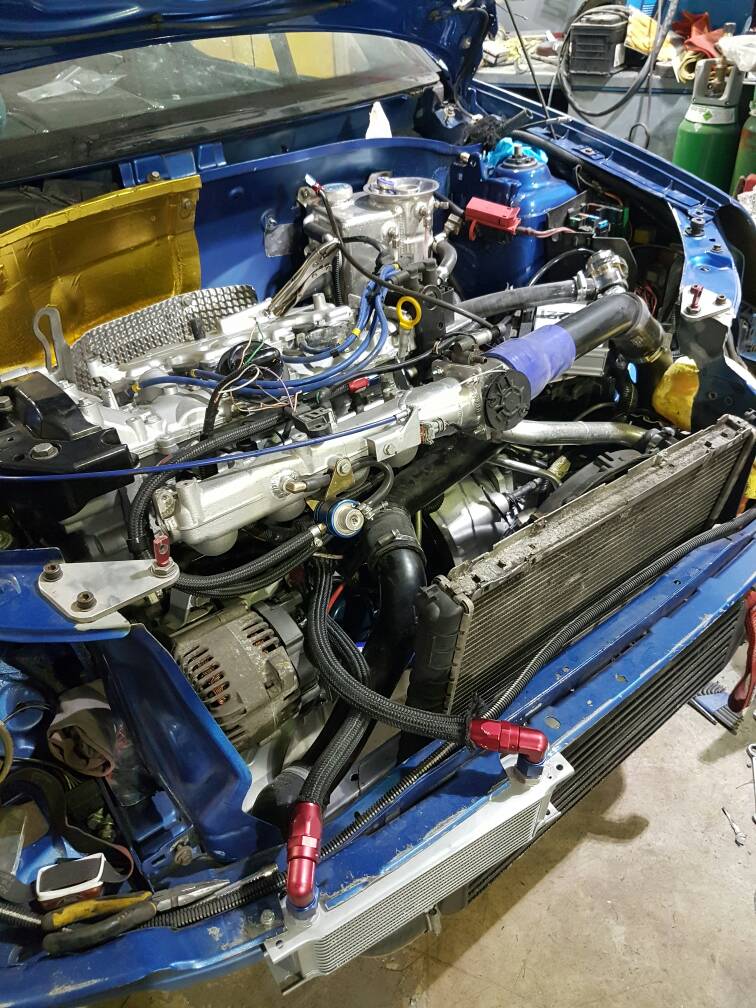

Cut a few more holes in the car, weight saving and all that...
Oil cooler is mounted, but no pics of that. Just got sort half the lines out.

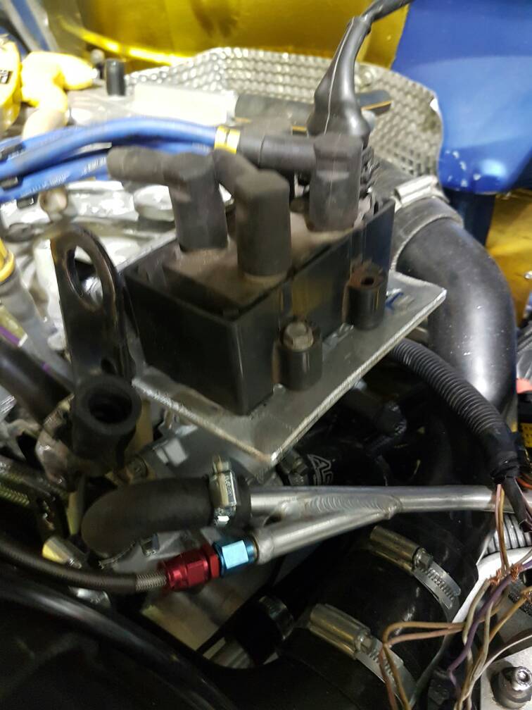

And a little coilpack bracket
Both jobs Ive been putting off for a while but finally got done.

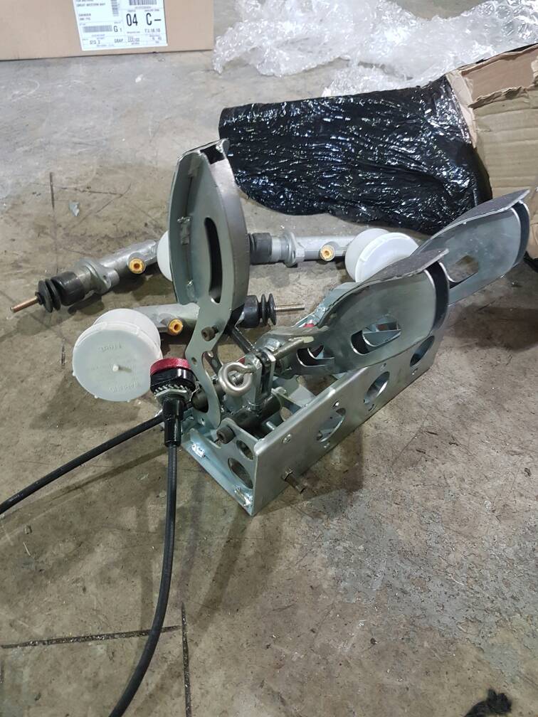

So clutch issue hasnt got any further forward.

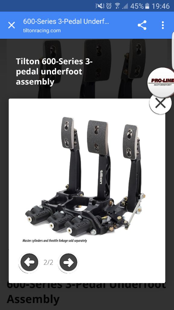

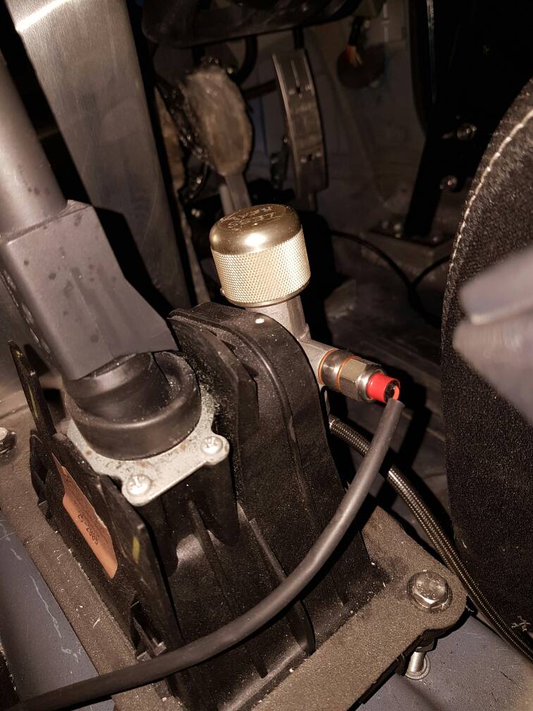

Bought a bias pedal box with mcs mounted behind but that aint gonna work as it pushes the pedal to far forward and I cant move the seat back to far. Like this...
So Im gonna stretch then endless budget to get a pedal box that has the master cylinders forward facing under your heels with a flat floor over the top, this should hopefully give me the leg room, and get around the hydr clutch issue.

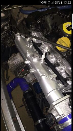

Oh inlet is hopefully arriving tomorrow so will get that fitted ont lunch break! Picking up new ecu friday too, with hopefully base map already installed.
Gettting there

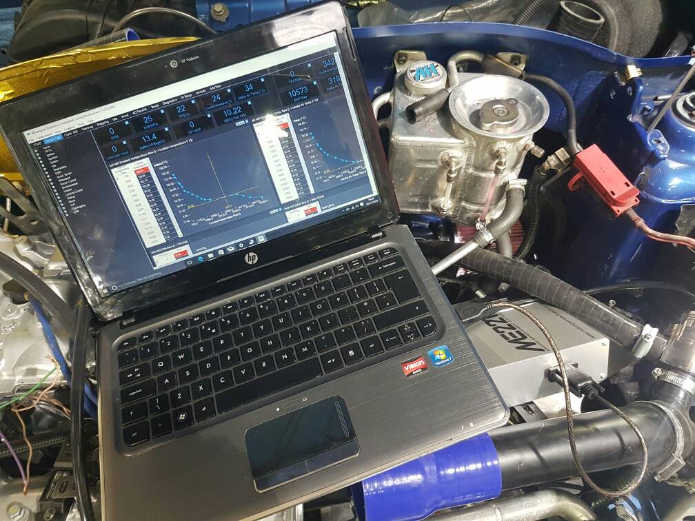

Small jobs done today, got the new ecu so decided to have a little play around.

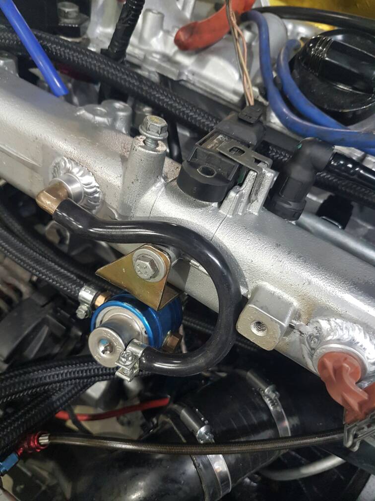

Few things needed tweaking like the fuel pressure and injector size, its not running at the moment which i think could be due to not having a tps plugged in. Which is saying telling then ecu not to fire injectors.

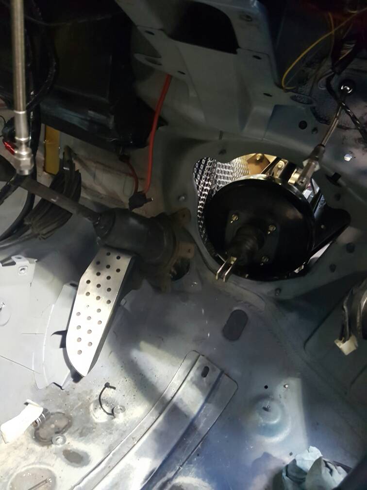

Removed servo, and tried to see what other brakes lines I needed now there was extra lines.

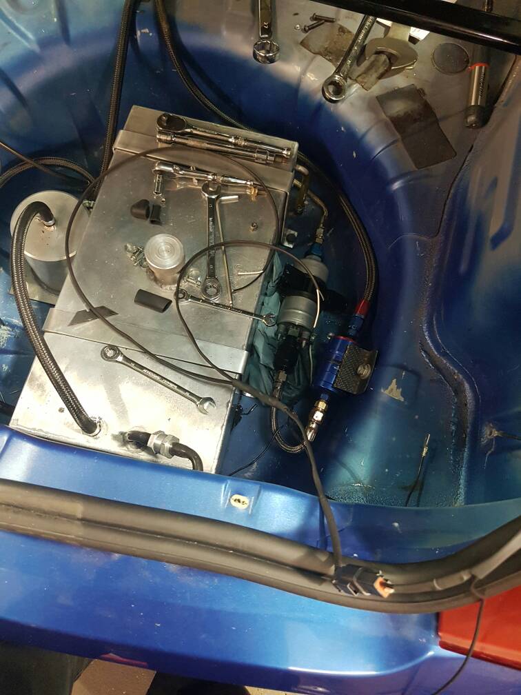

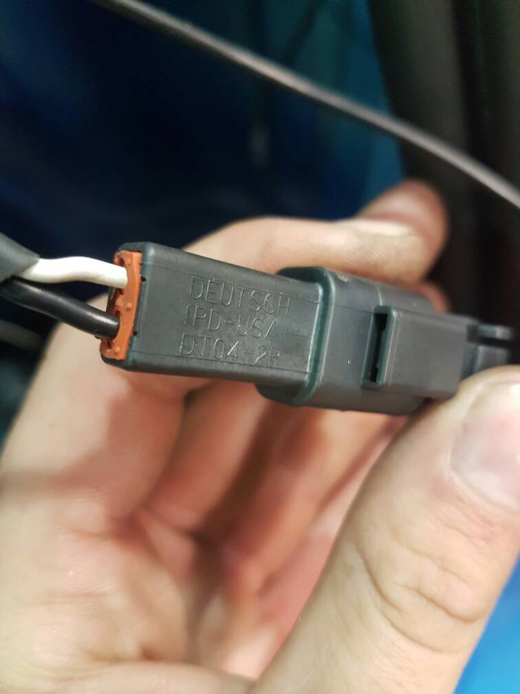

Fuel pump loom needed some attention
Got there in the end.

First job was to change the bottom coolant lines over, to allow for the standard rad with the other alloy lines.

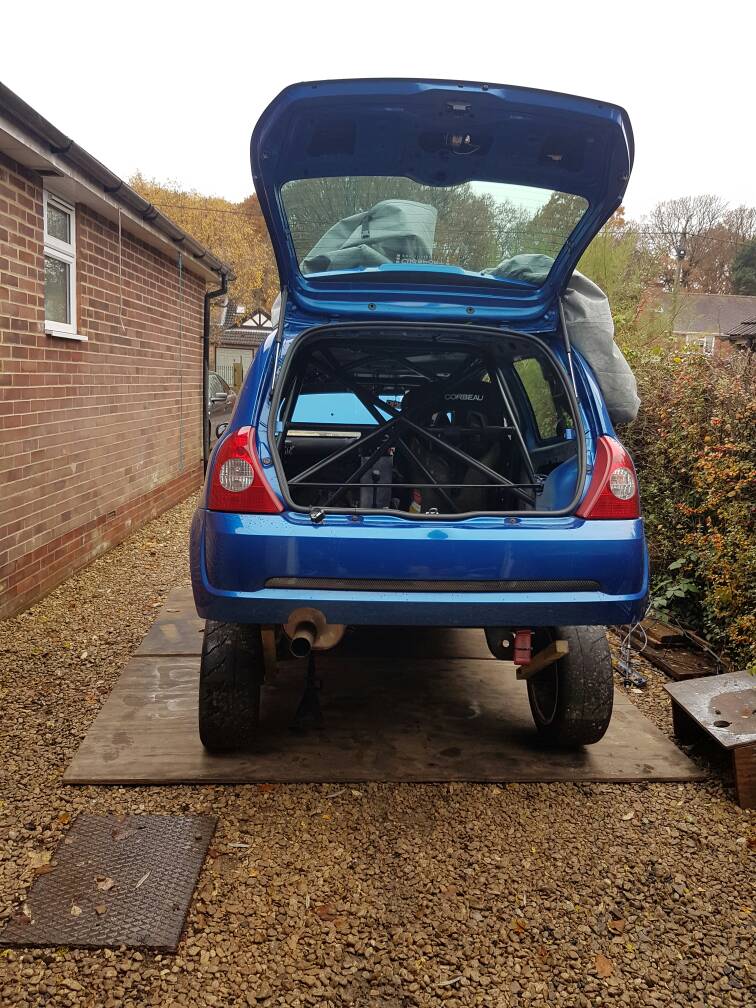

Secondly got the exhaust sorted which just needed a few brackets adjusting, then I made an alloy exhaust trim with a bit of left over gold heat foil, not sure how it looks in the daylight as it was dark... haha

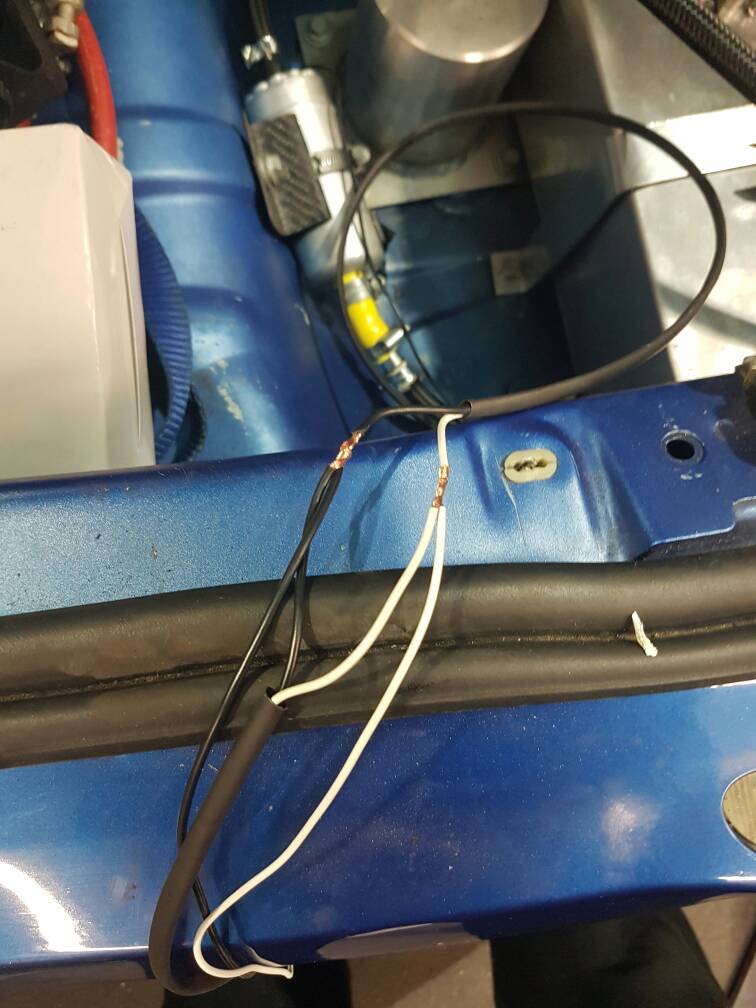

Brake lights have been sorted, fitted a little stealth switch for the lights aswell to make people work for their braking points when following me... haha

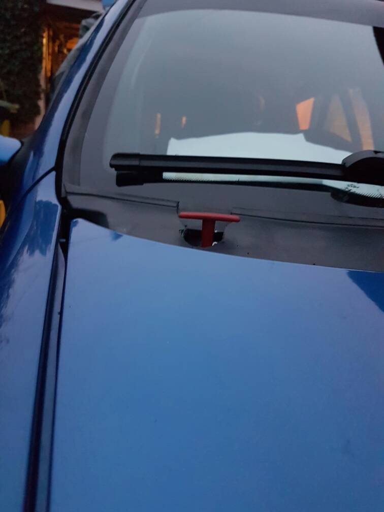

And external elec isolater has been fitted.

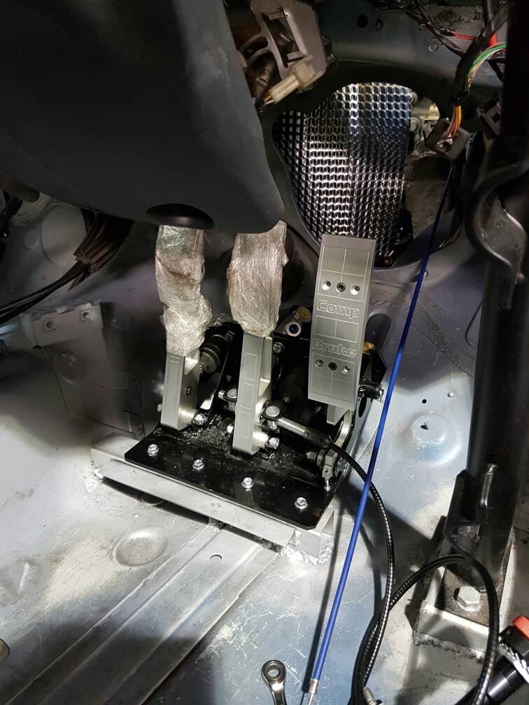

Did you get a pedal box in the end?
I did mate,
Went for an angled one, as my seat is already far back as possible so needed the leg room!
I reckon if i ever do another one ill go for a pedal box with forward facing MCs. As that allows even more adjustment and a bit of recline aswell as with this pedal box its tilted quite far forward.
Feels good though

Looks good. Cable adjuster for bias? I need to get one...
Cable adjuster and i kept the bias valve in there also as i had my lines made for it...
So i should be fine with the rear braking effort haha

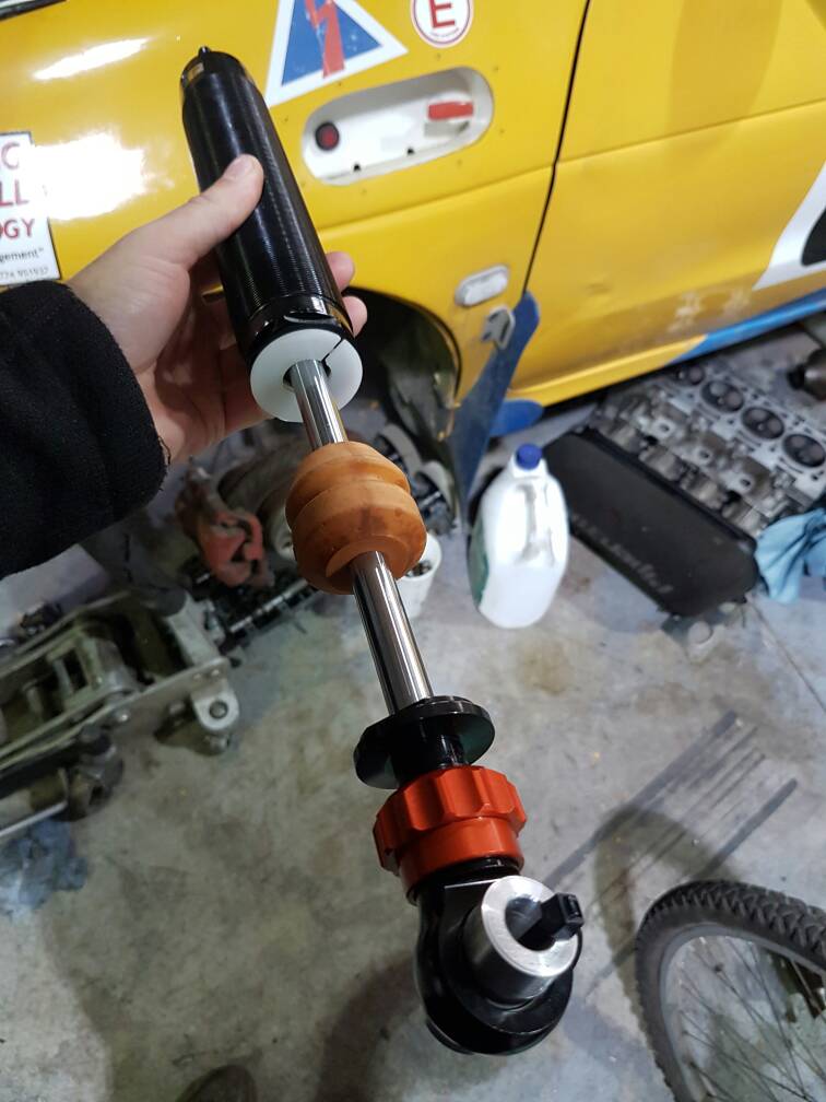

Got my rear suspension back from AST just had spherical bearings fitted which looks pimp.
