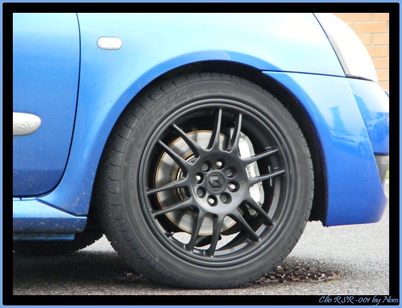

Edit: added a pic of my Cup with R26 brake, it is not only performing, it 's also looke Fxxxing good!

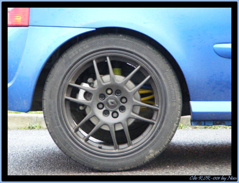

Here comes the bonus ... Rear R26 Big brake set up...(also keeping the original disk size)

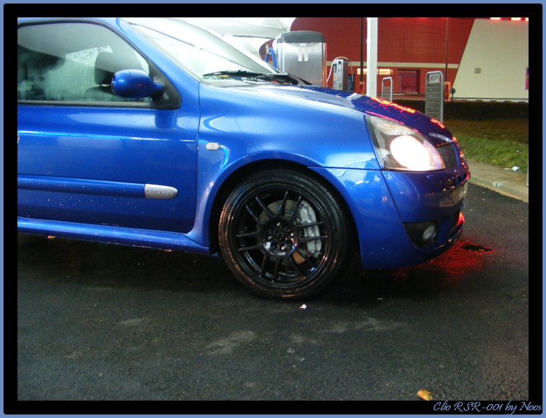

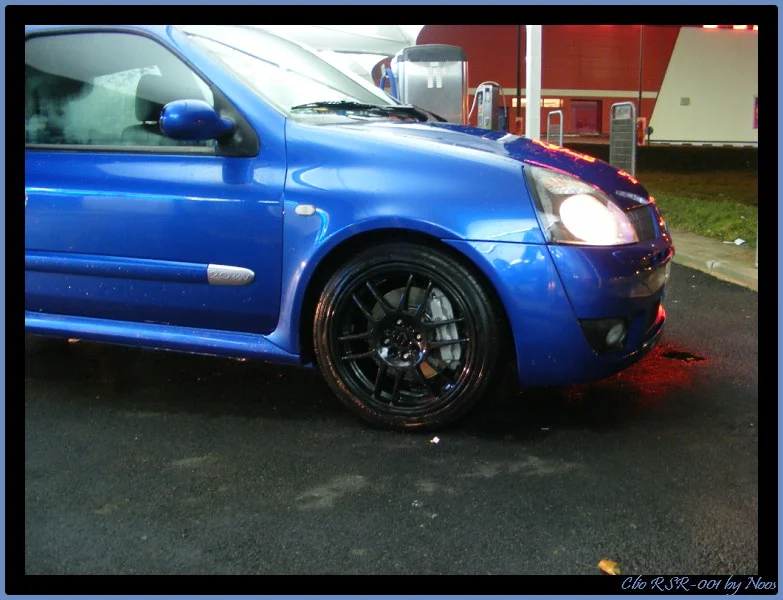

A last one :evil:
