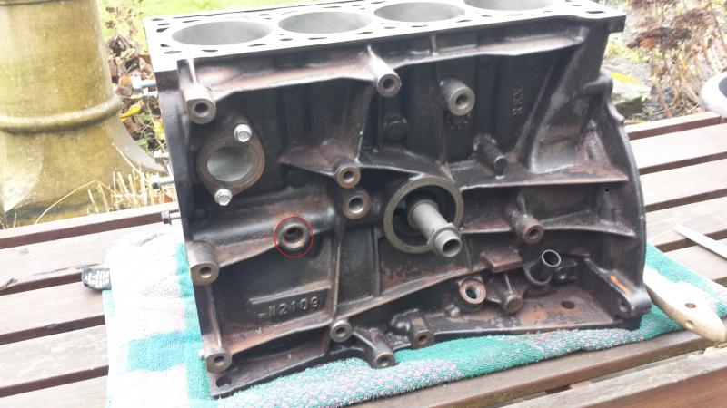

I am in the process of building my r26 engine back up, but there appears to be a part missing, any ideas what goes in the red circled hole?
It must be press fit as the hole is not threaded? Any ideas?
  PH1 loads of boost!
Does the hole go though to the water ways, because doesn't the water pump outlet run in front of where the hole is?
  340i
Does the hole go though to the water ways, because doesn't the water pump outlet run in front of where the hole is?[/QUOTE ]
Yeah this hole sits behind the coolant pipe, that bolts in just above it
Maybe a locating / support lug for the alt bracket
Does not not look to be anything that bolts in ect there
I'll have to double check but pretty sure it goes into a water / oil way.
