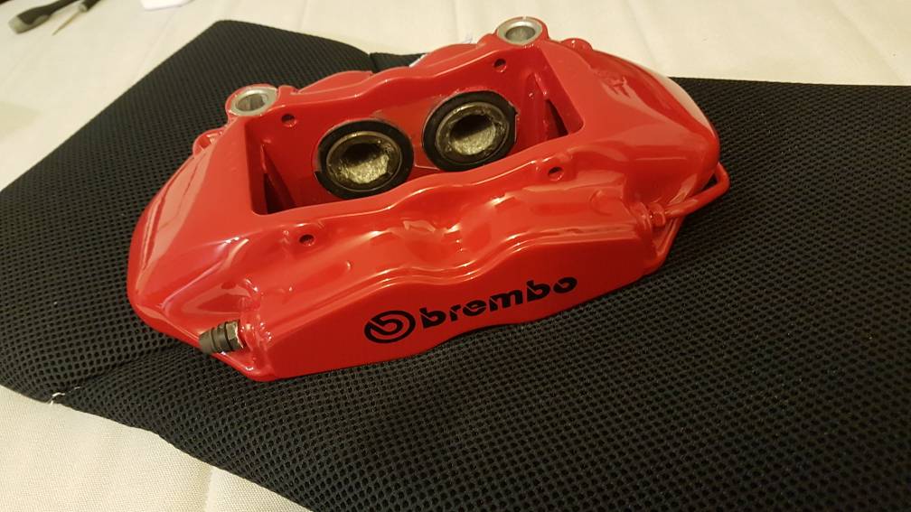

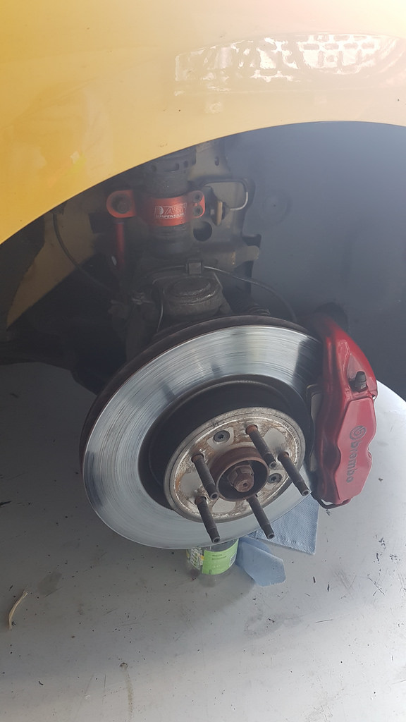

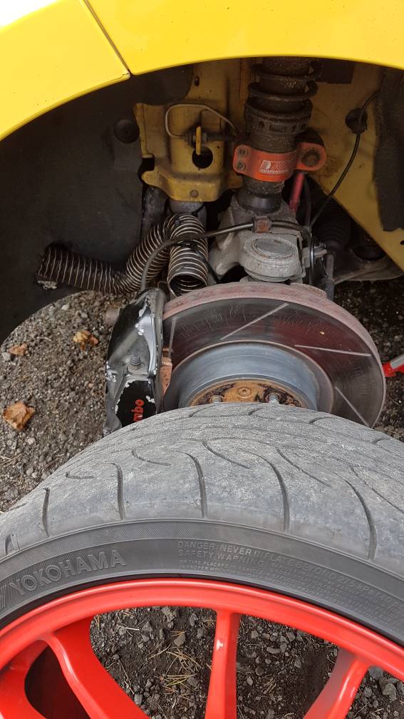

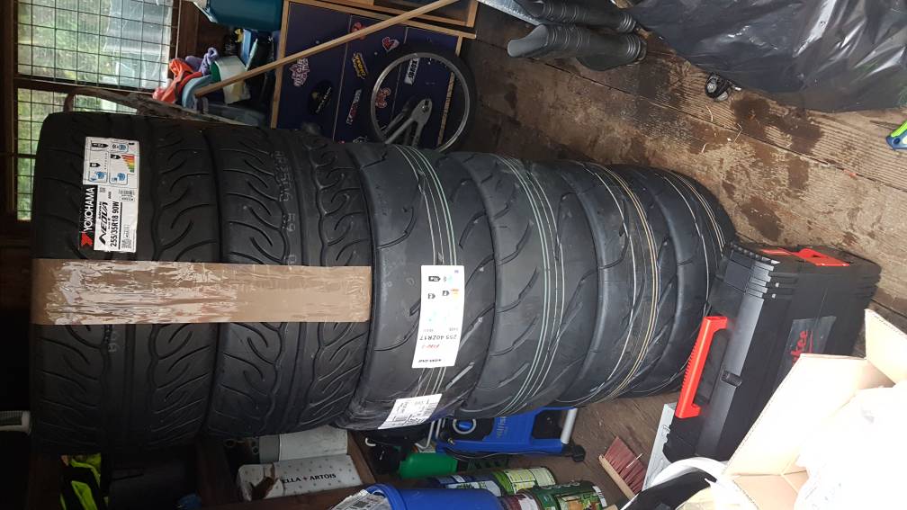

No massive updates for now, got fresh calipers to go on all round along with discs and some RST3 pads up front.

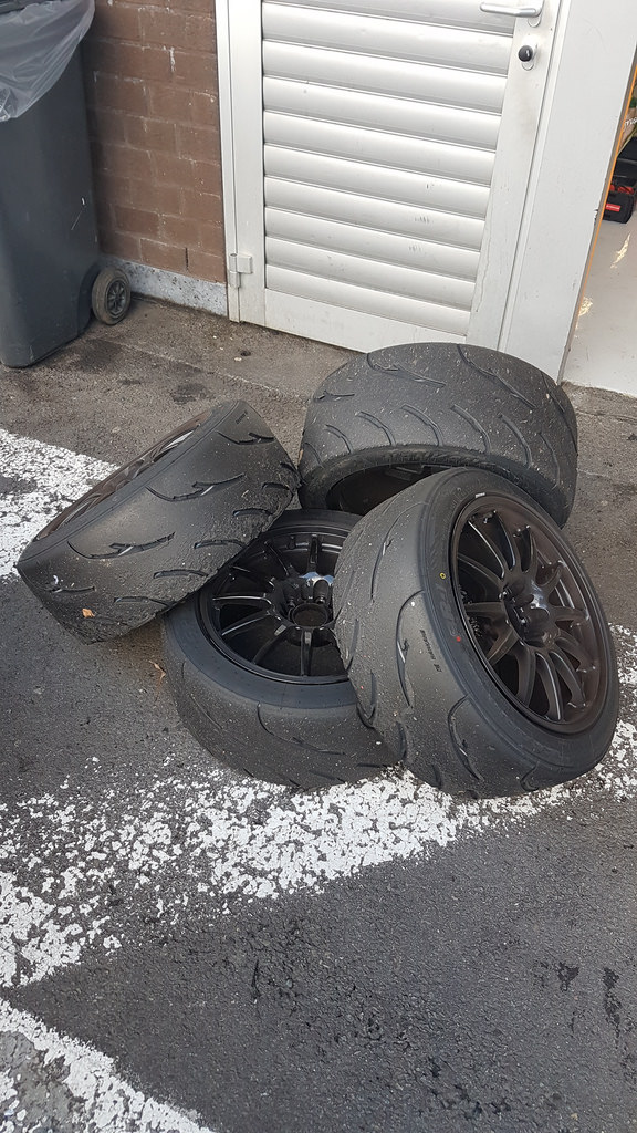

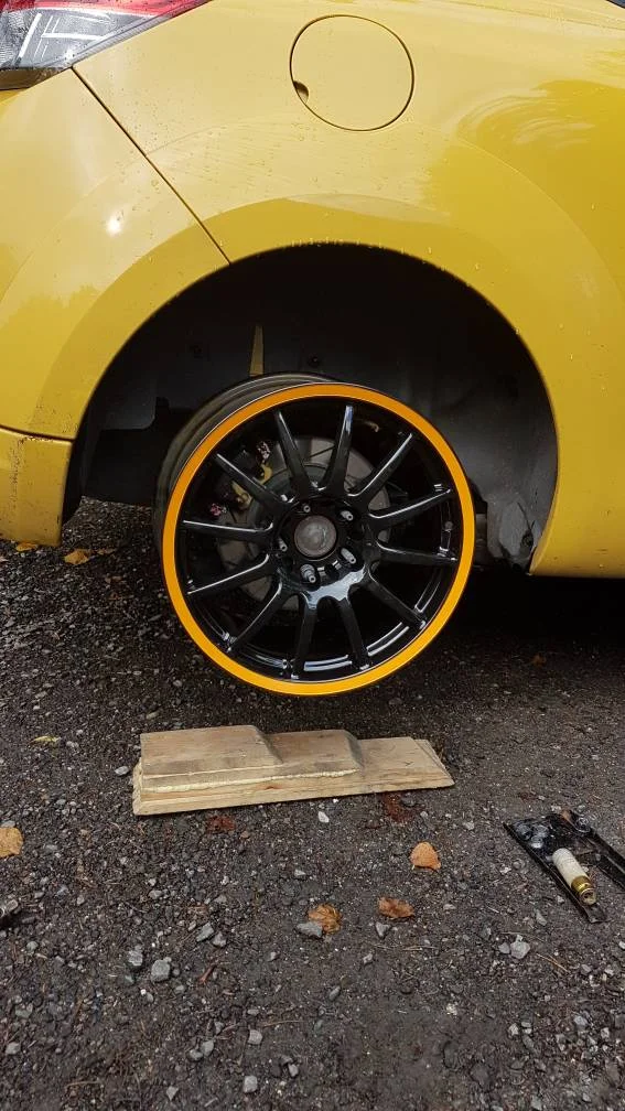

Sold my 1.2 track wheels and bought another set, this time 17x9s and shall be shod with 255 AR1s up front and 225s on the rear. Should be pretty decent. Only issue is they were meant to be fully black and 1.2s, turned up with a gash orange lip and are actually 1.5s but they seem to be the same weight minus the writing on the rim from what I can gather.

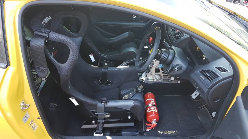

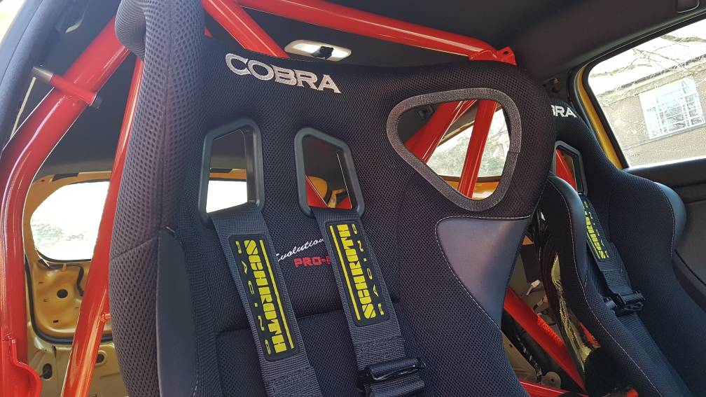

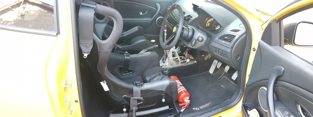

Have a rear Trophy-R style bar and cargo net to go in, mainly to stop wheels and other stuff rolling about and got a set of Cup racer sidemounts to run to get my drivers seat another inch or two lower than it is.

Meant to add, wheels are getting painted next week to get rid of the chav spec lip and have some 265 DRLs and blade to fit as mine are broken, also have all the bits need to add some much needed brake ducting which will be done whole bumper is off

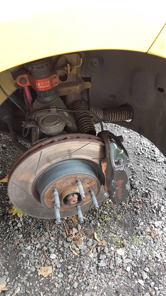

Had new front calipers fitted along with some plain Brembo discs and some RST3 up front with some RS44s on the back, couple with Ti shims and Endless fluid im properly chuffed with how great the brakes are now, Zero issues with fade or heat so the ducting definitely seems to be helping.

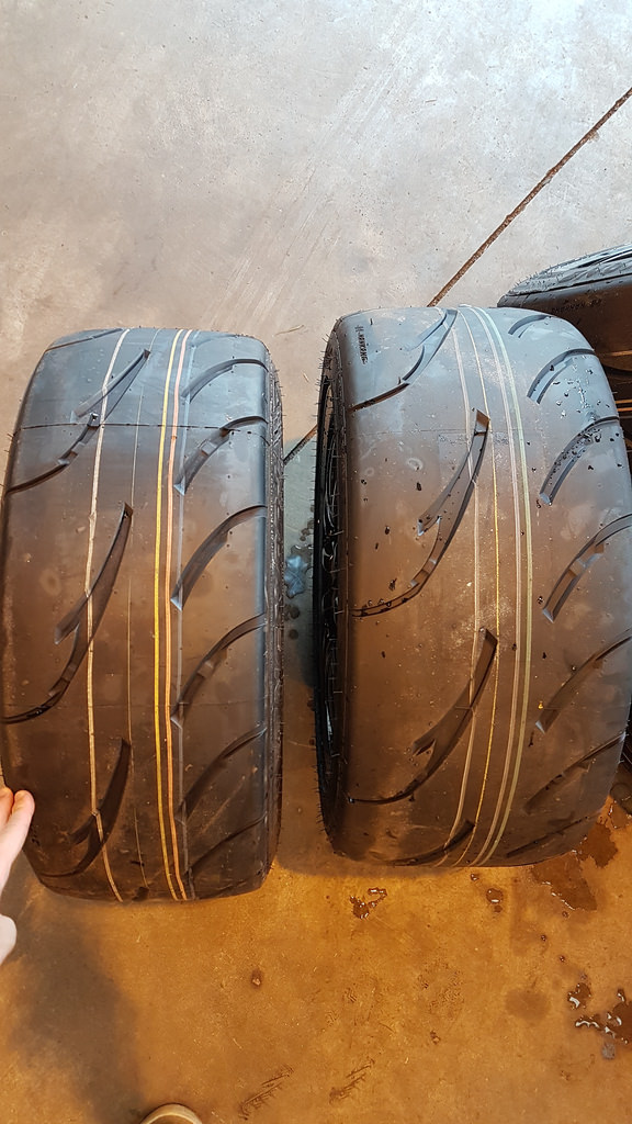

Also had some AR1s fitted onto my 17x9 track wheels, 255 front and 225 rear, very impressed with how good the tyres are. Near enough a DZ03 for half the cost. Just a bit pants in the cold and damp as I found out early at Spa, particularly under brakes.

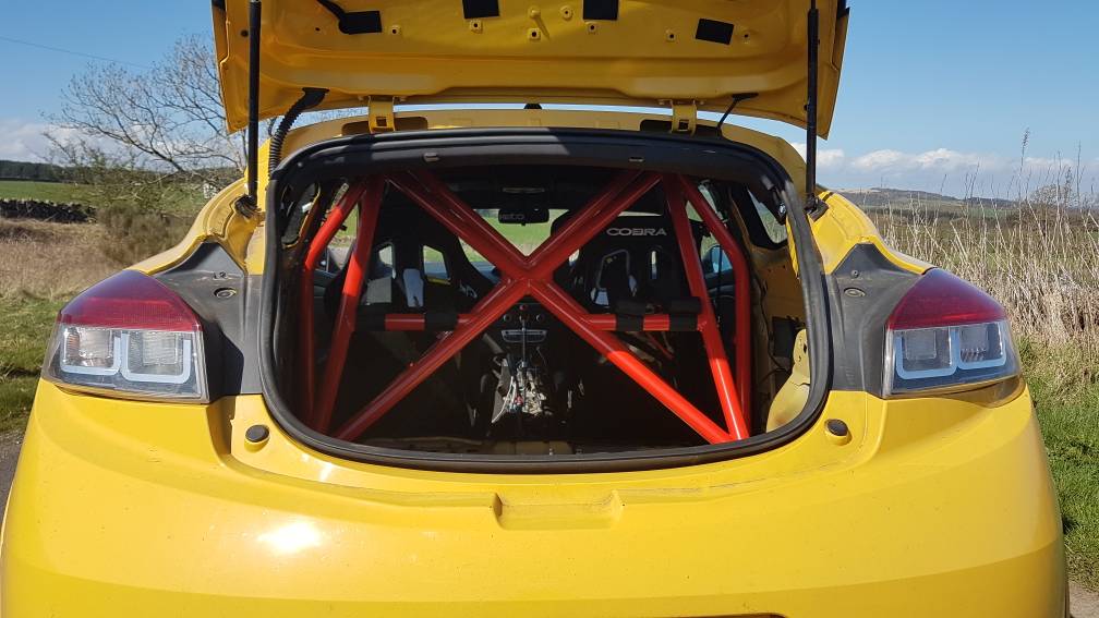

That's about it really, few small plans for the winter but not much. Cage, Xenons, lightweight battery and possibly Abs removal then get a full seasons worth of trackdays out it next year.

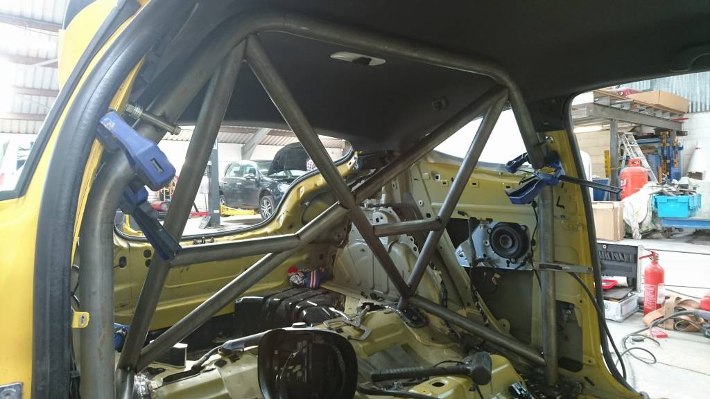

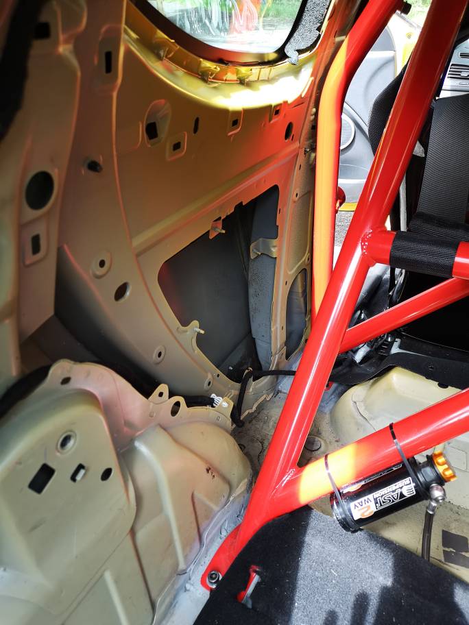

Was back out at KH the other month, Lack of seat time this year so far definitely came in to play and i was no where near where i was hoping.needign to be in terms of laps times for SLS, Cage has definently changed the balance of the car and i spent the day struggling with temperatures running hotter than they ever had before even though it was a cool day, So thats still needing sorted.
its away getting new swivels all round, Wheel bearings as pax had collapsed and a new CGR downpipes as my Scorpion one sheared completely on the turbo flange, Common issue with them by all means.
Oh yeah, I also bought a set of 2 way AST's which have been fitted to the car, Not got the car back yet to see how it drives but ive went up from 8/8 to 10/10 rates ont the springs, hopefully makes the rear a bit more lively as ive been struggling with too much rear grip, Even with 225 AR1's on the back with a 255 up front...
