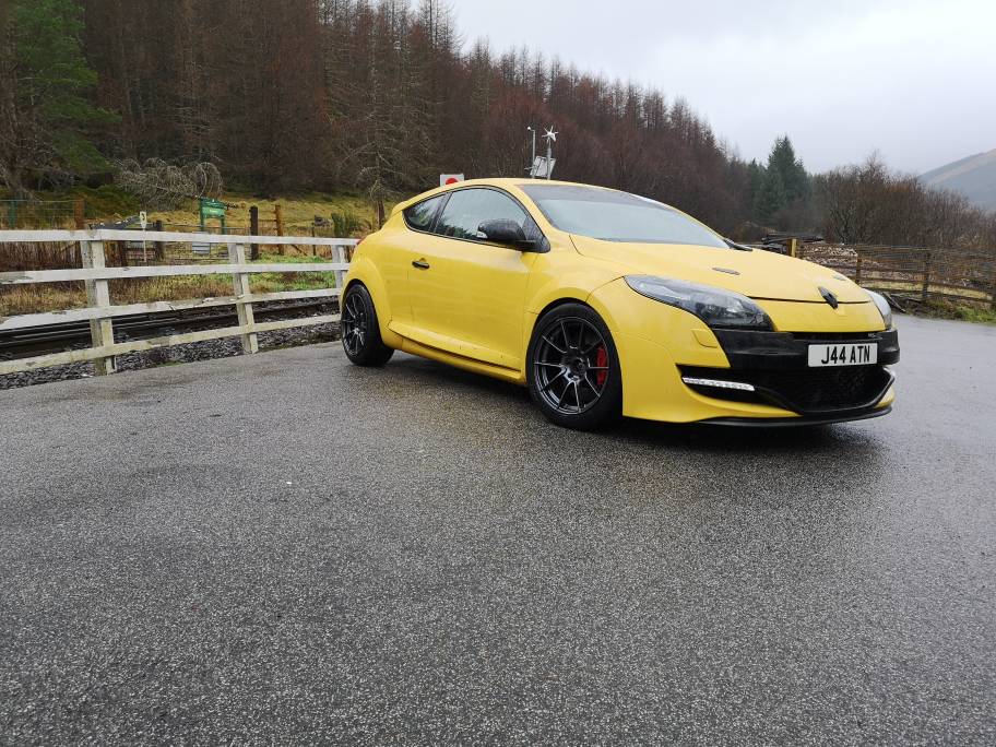

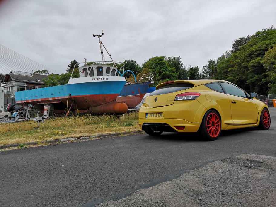

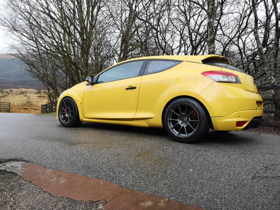

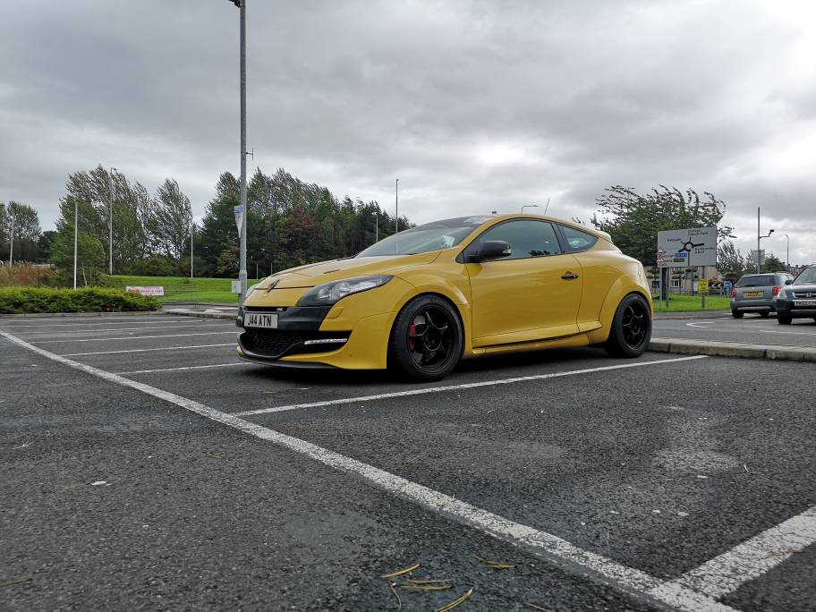

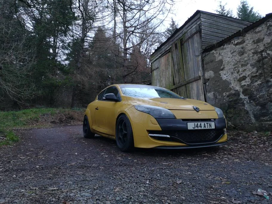

Ride heights could still do with coming down a bit but it's sitting well

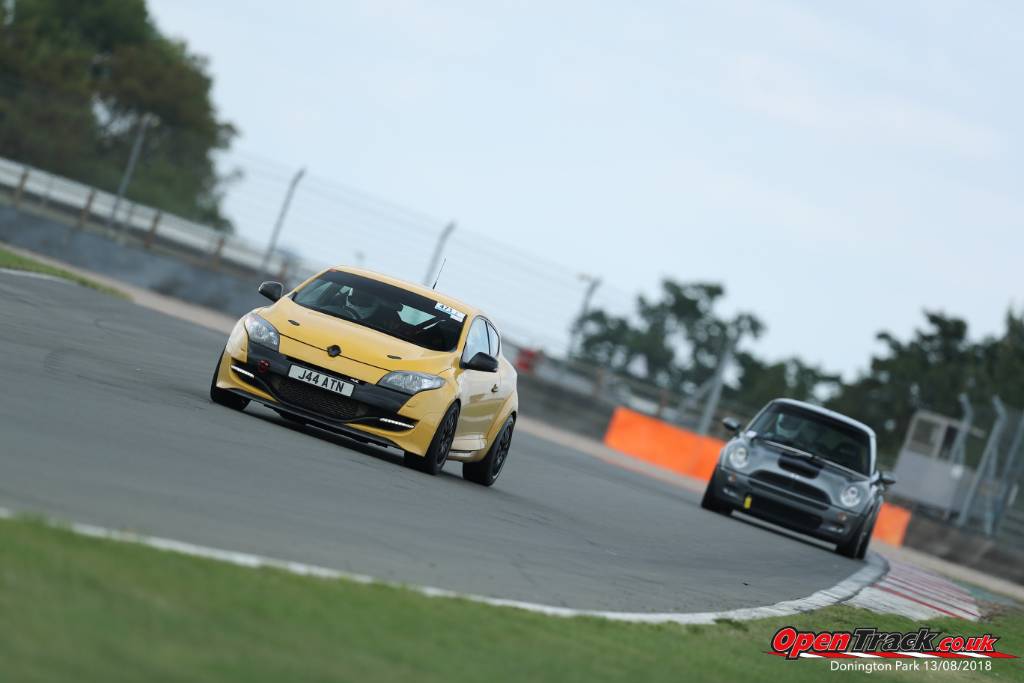

Session at EFI on the 12th Aug then over to Donny on the 13th for the Opentrack day.
Can't wait for both, Looking forward to seeing what Chris can do with it and get it running and putting out the numbers it should.

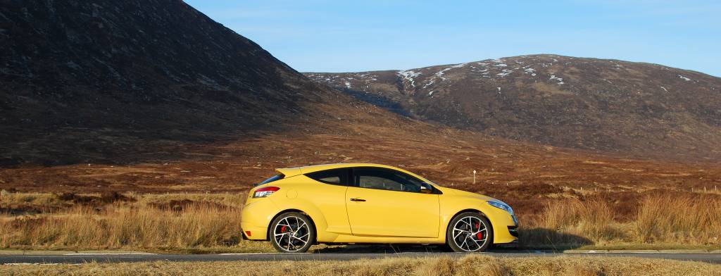

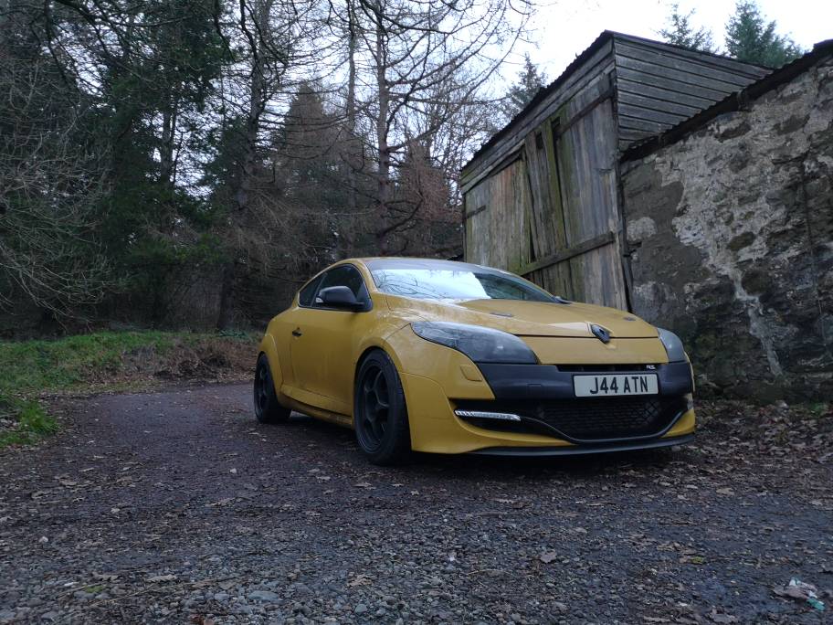

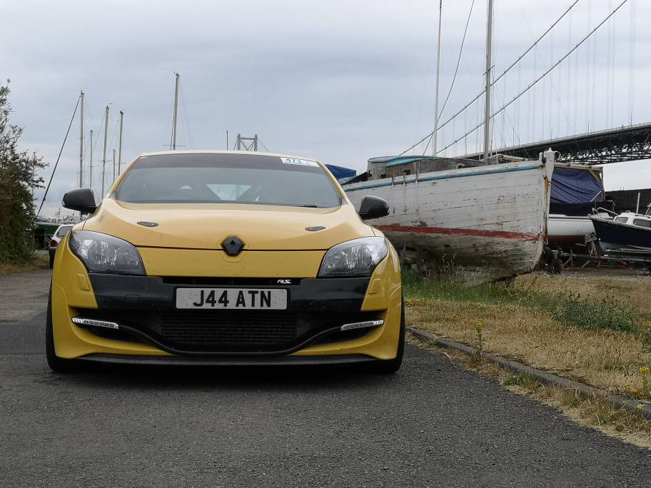

This looks so mean from the front!
Pretty sure I passed you the other week just around about Crainlarich. I think anyway. I was on the bike with 2 mates and it was raining that heavy I could hardly see lol.
Yeah you probably did, ended up rolling about in that rain adjusting ride height on the front. No fun lol

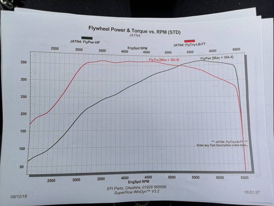

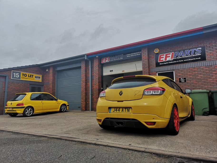

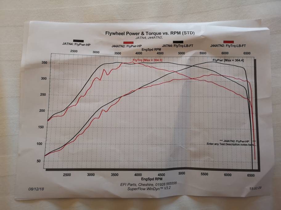

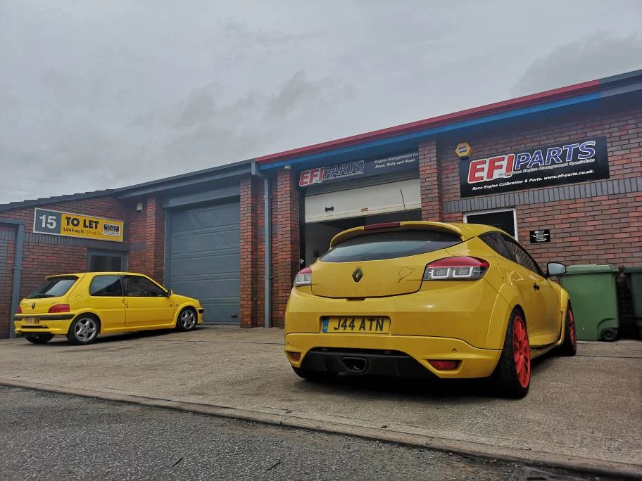

Wasn't really sure what to expect from my session at EFI today, cars definitely not had the pace the old numbers suggested it should have.
Over 4 hours of tuning by Chris and more dyno pulls than I can remember finally settled on these. Torque was kept sensible to prolong clutch etc but we did get it upto 390lbsft before winding it back in.
Can't recommend Chris enough either, such a nice genuine guy that's very attentive and keeps you updated on what he's doing, not to mention how picky and fussy he is. Don't think I would ever go anywhere else from now on.
Made 324/364 before and 364/362 after and that's on a dyno that's pretty pessimistic.
Top end has seen huge gains, 40bhp and torque holds on longer before dropping. Cars faster by a considerable amount, drives so much nicer, comes on boost a hell of a lot better and just goes right. Turbos pretty much maxxed out now.
Properly happy!
Donington tomorrow to properly test it out.

Managed 15 laps if that including the sighting ones.
No clutch and brakes have a horrendous judder and pull. Managed to get out after lunch for a few laps on the road wheels as I wanted some photos lol. Car has enough go about it to manage the whole of donny in 4th, other than having to lift off halfway down each straight instead of bouncing off limiter.
New clutch and slave on order, ill grab some new discs as e and hopefully be all good. Simple fixes just a pain in terms of the slave

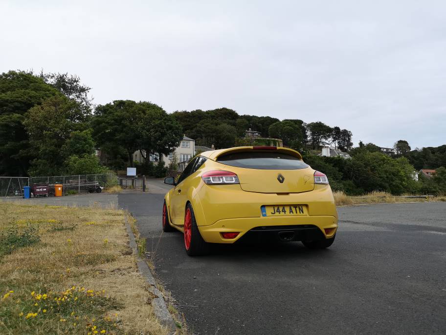

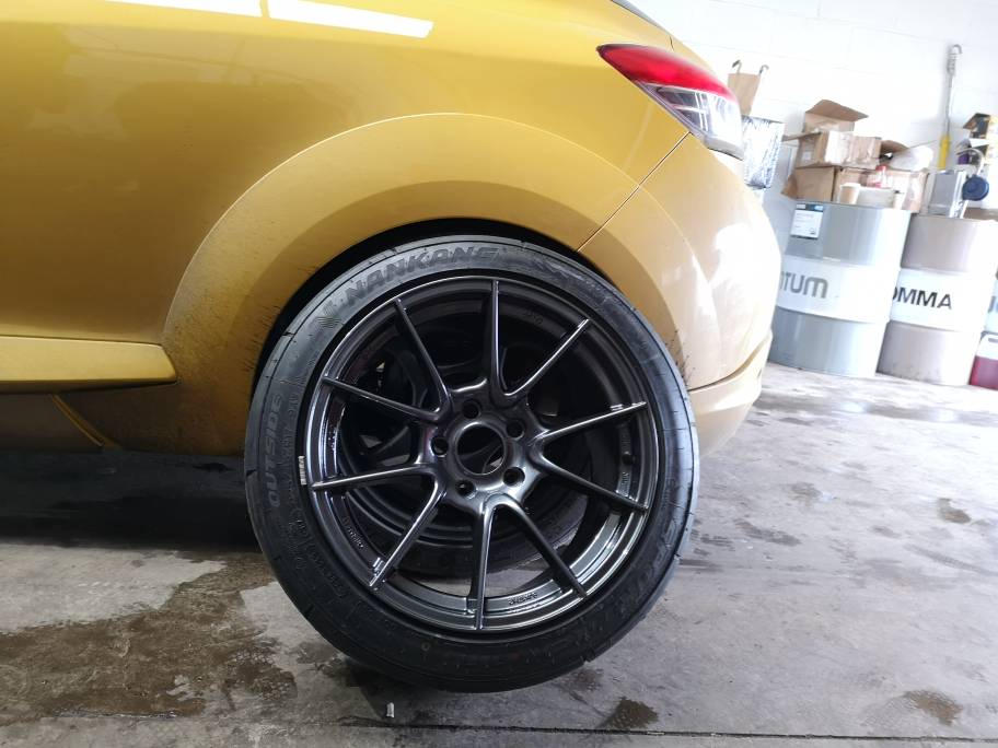

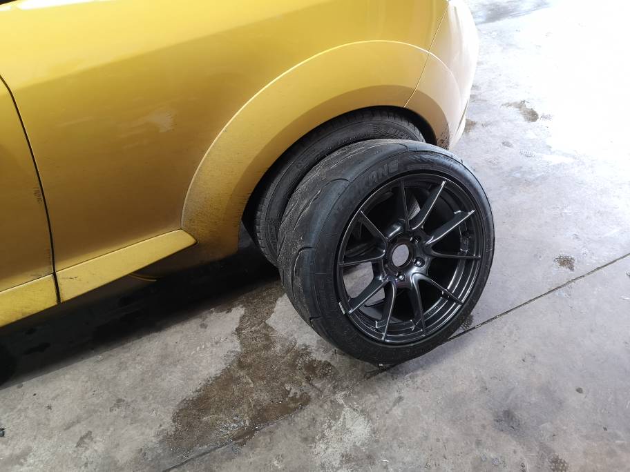

Sold the OZ's and have bought another set of 17x9's to replace them so i can have the ride heights set for 17's instead of having to compromise with the two different wheel sizes. Currently away being machined and refurbed but shall have them on next week. Gone for some 235 PS4's all round this time instead of the 255 front i have been running, Makes it a bit rubbish on the road with the wider front.

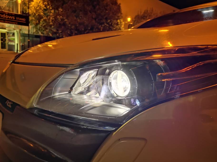

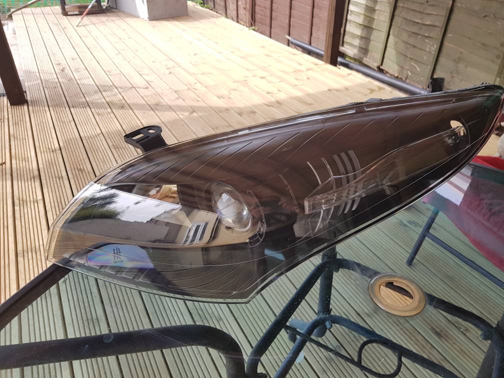

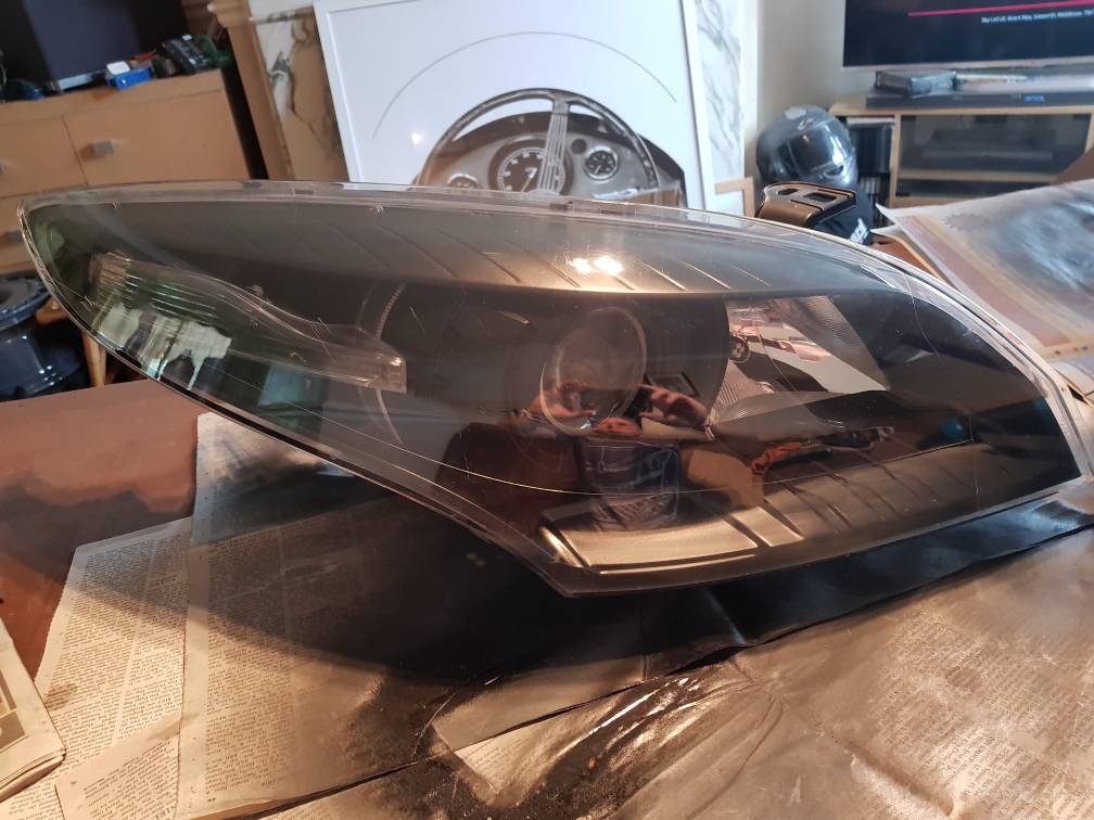

Also have a set of Xenons that are being painted black, Should finish up the front end nicely, Slave cylinder and clutch will be done in a couple weeks then thats it. Front section of the cage will be completed at some point over winter then ill be happy with it. Maybe some FRP panels to offset the cage but nothing else really planned now. Just want to use it and enjoy it

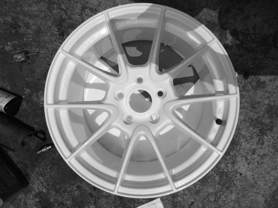

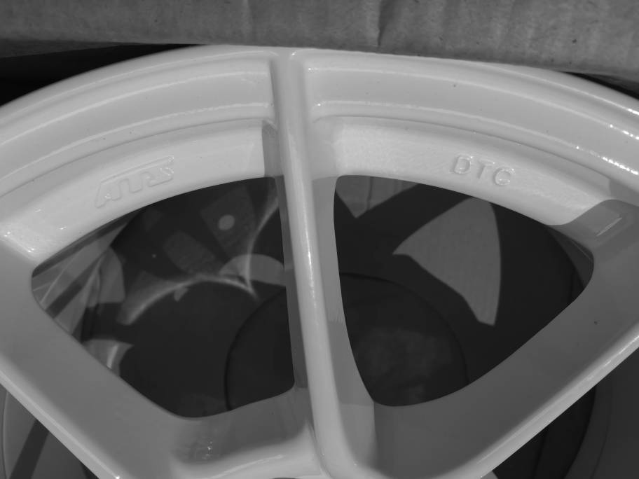

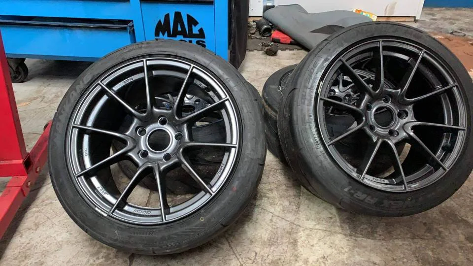

Bought another set of wheels, this time some 17x9 ATS, pretty mega wheels if I say so.
Just need to decide on colour then get my AR1s swapped over off the TDs, which are for sale ;)

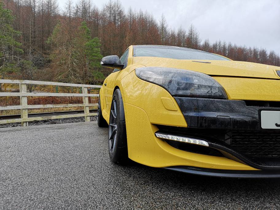

-Jamie-

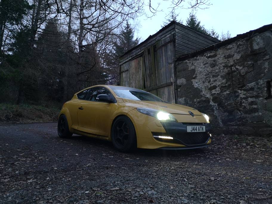

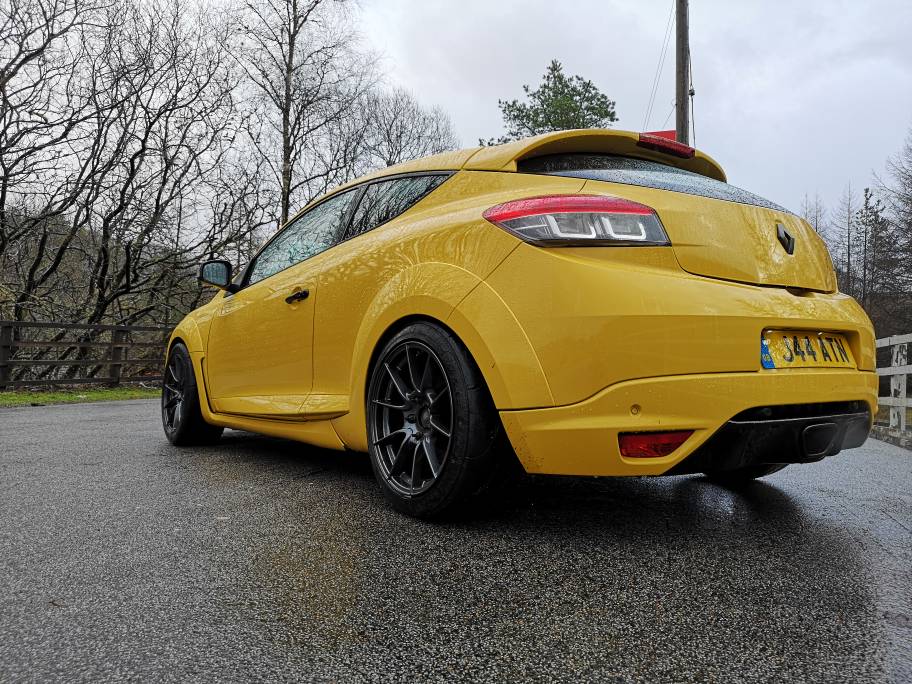

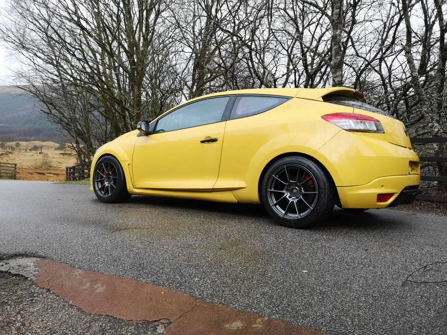

No where near as dirty as it got a couple winters ago but the rear end is currently pretty black.
Throughly enjoying PS4s for road use over AD08Rs

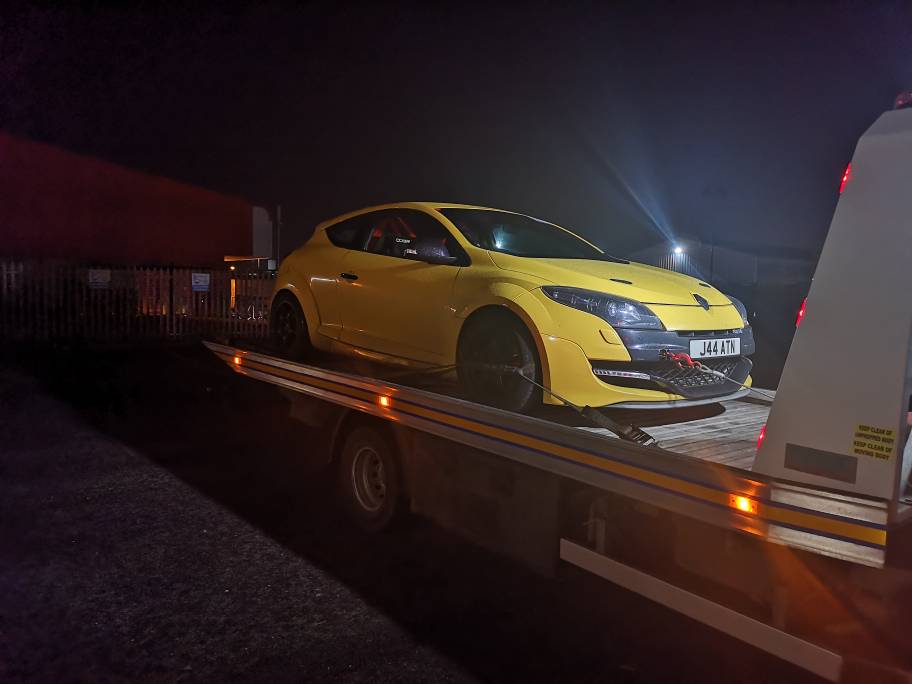

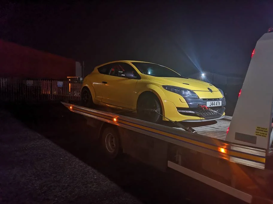

Engine s**t itself last night, motorway cruising at 70 off boost and not under any real load, before people jump on the blame the mapping bandwagon.
It'll get fixed, just don't know when or how, needless to say I doubt I'll make my ring trackday in May, if any this year

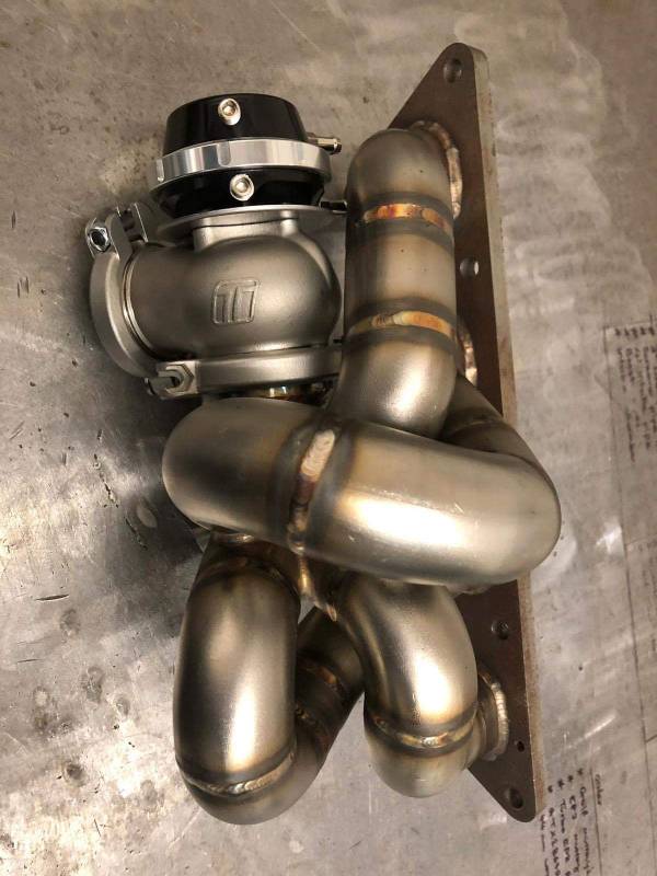

Nortech Mani, Downpipe and lines
G25 550 0.72AR
Turbosmart Comp 40 gate
