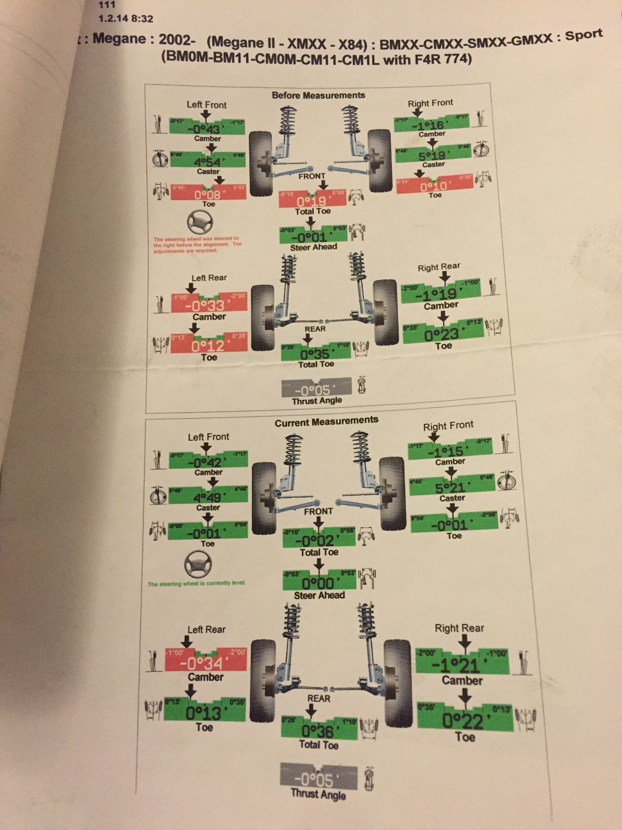

Does anyone know the dimensions for a megane 225 2007 with cup packs wheel alignment dimensions.
It appears it came out of the factory with 0.10 toe per wheel but it's been set up at 0.01 toe per wheel now.
Which one is correct.
Car is oe and unmodified other than original eibach springs
