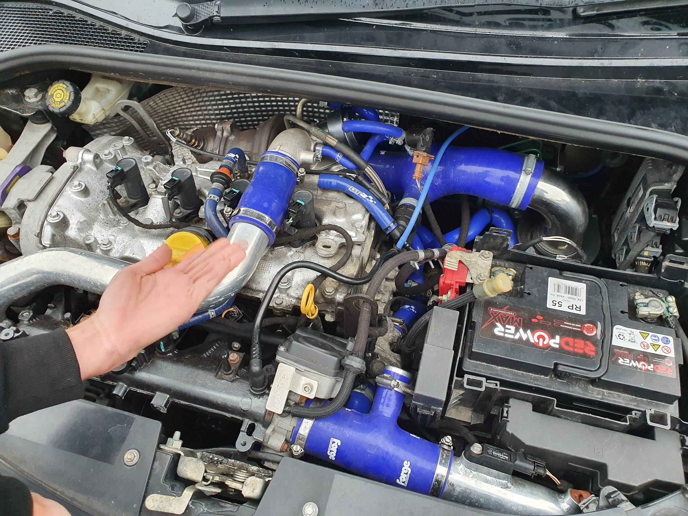

so long story short rather than build my own I have purchased a completely prepared car .
when driven hard and on the turbo the temp gauge rises as soon as you come off the turbo and let it roll for a minute it cools back down pretty quick to normal running temp.
I have tried to get some photos of the engine bay .
Having just spent a small fortune on the car the last thing i wanna do is bugger it up !
any advice is welcomed !

Pretty sure that's a common theme with clios which have the wrong engine in ;)
Struggles with cooling in a clio bay.
  Clio 197,with megan'
Meglio cooling, is NOT a Problem. Start with the simple fix problems. Start car, heat up, so fan engages, stand in front with a tissue. Is it sucked towards the car, ( Right.), OR blown away from car?. ( Wrong.} sounds stupid, but mine was, and I believe a couple of others were as well. Cooling was one of the many problems when I bought mine. They removed the grills, put grills in the bonnet, but it did not cure it. The simple process of making fan suck, not blow, fixed it. Use the R26 Rad, its a little bigger than the 197 one. Check the thermostat/renew. For peace of mind, I also fitted a switch, so I can turn on fan manually, so now road /track, can temp barely ever rises, even on a warm day.

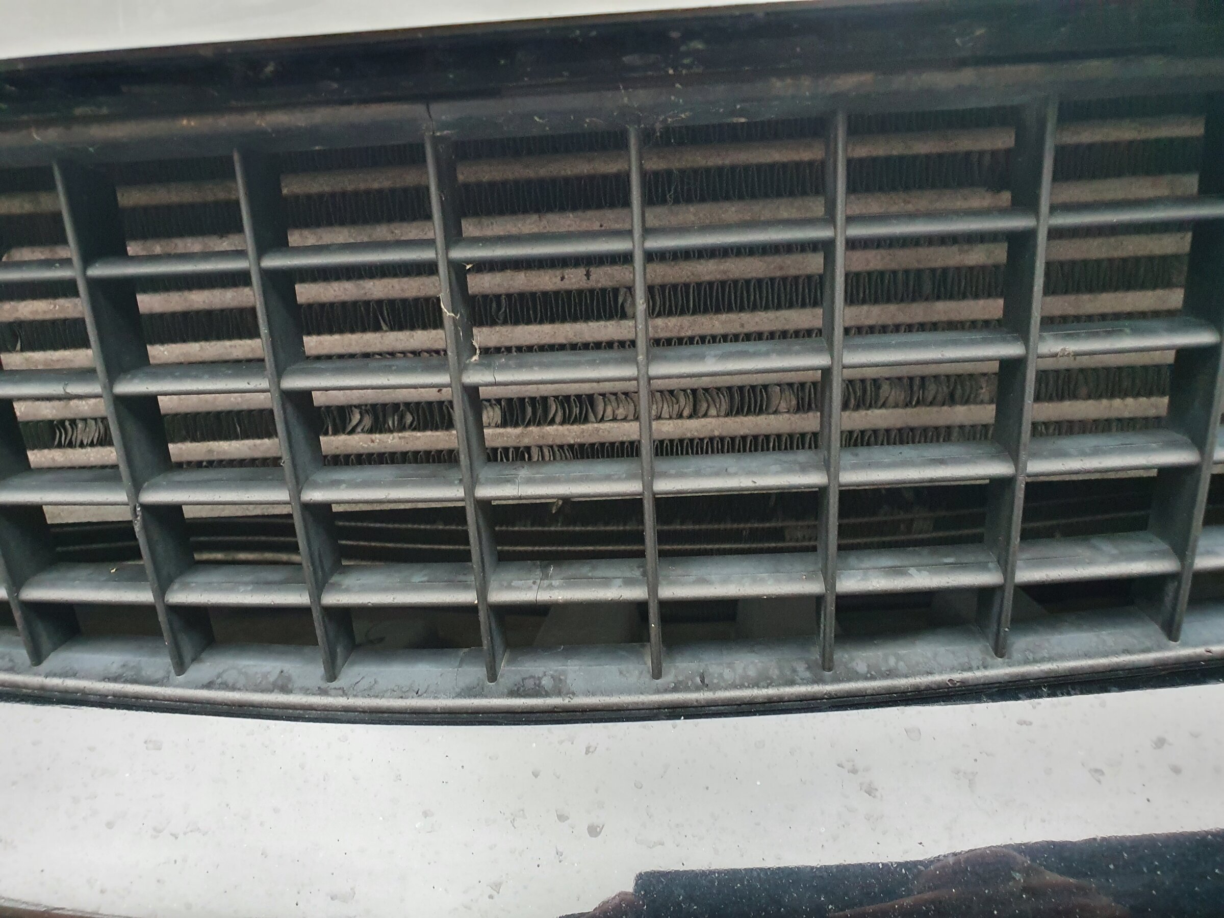

How has someone put the fan on backwards 😂
No idea , was just wondering if I reverse the polarity so the fan runs the other way wpuld that do it or do I need to manually remove it an reinstall it the other way around 🤔
Nick101
  Clio 197 !
I thought they only fit one way around.
Yeah me too but the fan is blowing the air back through the radiator and towards the front of the car ... so do I just rewire it the other way round to reverse which was it turns 🤔?
  172 Ph1
Yeah me too but the fan is blowing the air back through the radiator and towards the front of the car ... so do I just rewire it the other way round to reverse which was it turns [emoji848]?
How to tell :
Firstly gather info from the fan blowing wrong way . I mean without tools gauge air flow in the form of wind.
Then reverse the polarity and measure again .
The issue is , the blades are made in such a way that they perform better when the fan turns only one way .
So if reverse polarity is less suck then blow [emoji38] then the fan will need to be mounted in front of the radiator and the wiring left as it is now .
Nick101
  Clio 197 !
How to tell :
Thanks that makes sense 👍
