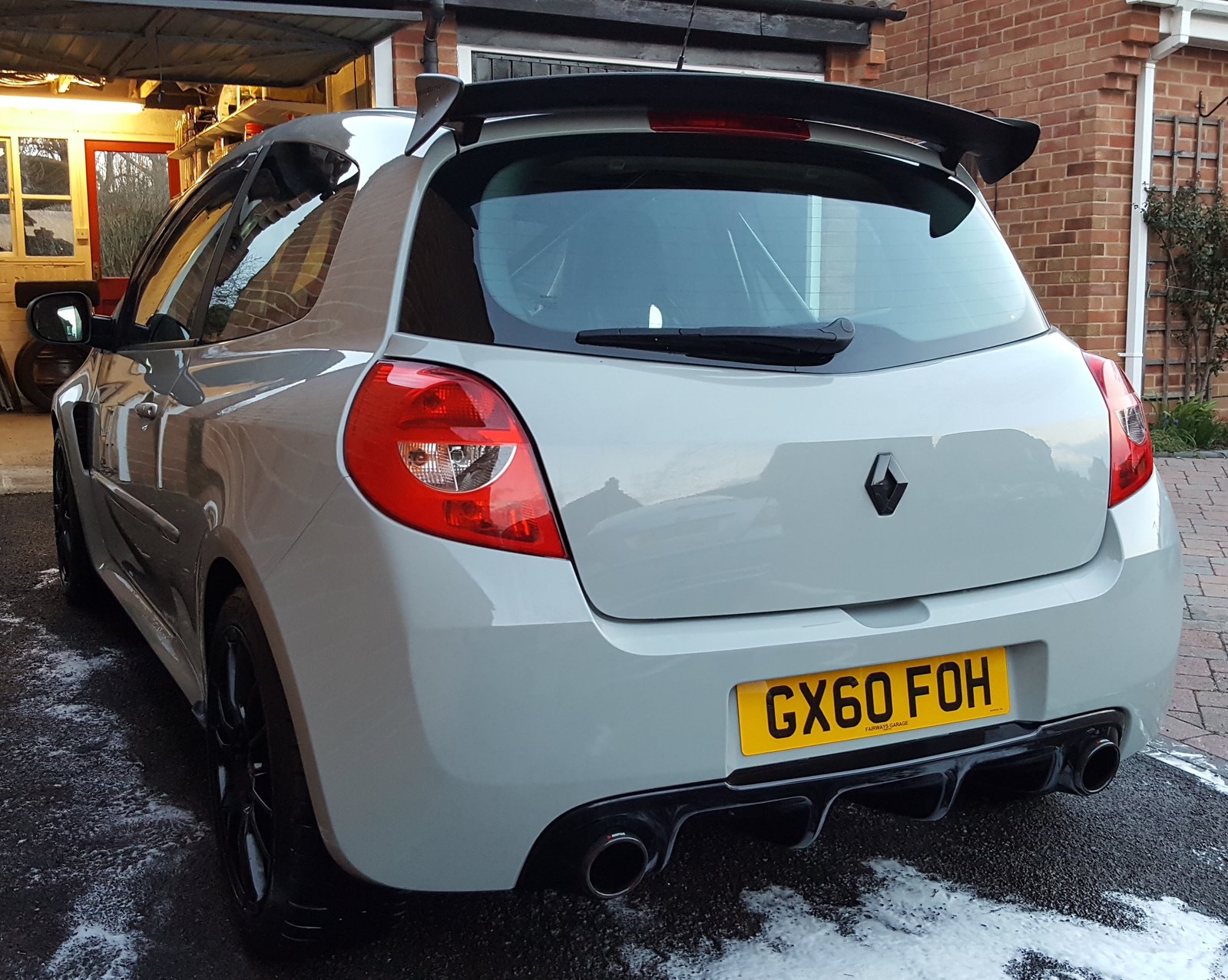

charltjr
I bloody love this car, shines up nicely too. Storm grey is such a good colour :D

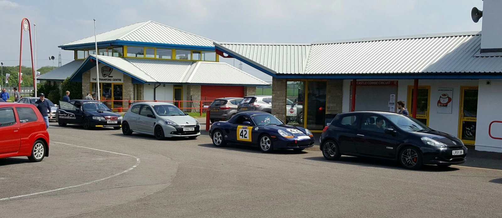

The usual queuing but didn't mind, almost entirely road cars today which was great, such a contrast to Silverstone. Almost everyone was really well mannered and even the people who pushed the boundaries a bit weren't aggressive. It was nice to have the power to get past the few people who didn't really want to move over.

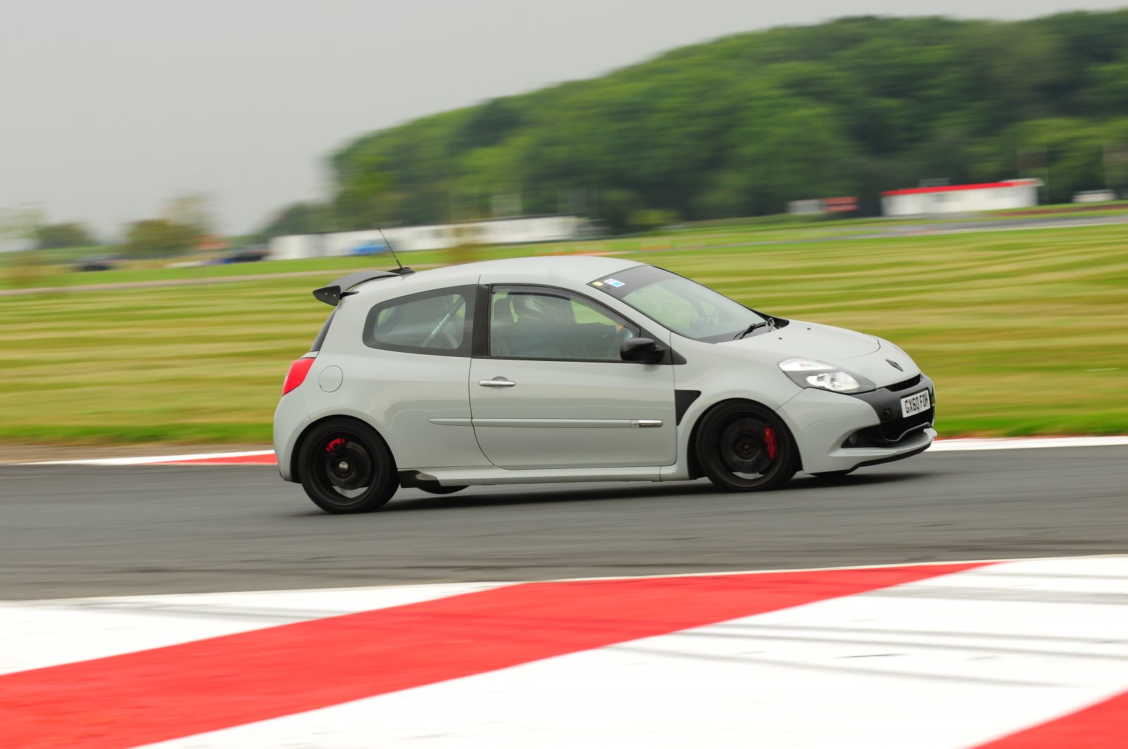

Coughed up for a couple of photographer's shots too:
Having done a decent day in the 200 I don't think I'll be fitting coilovers, it's the same dilemma I had with the old car, I know it could be faster with some properly set up track suspension but I strongly suspect it would be less fun. I think it's the way the car moves around on the current setup that makes it so engaging.

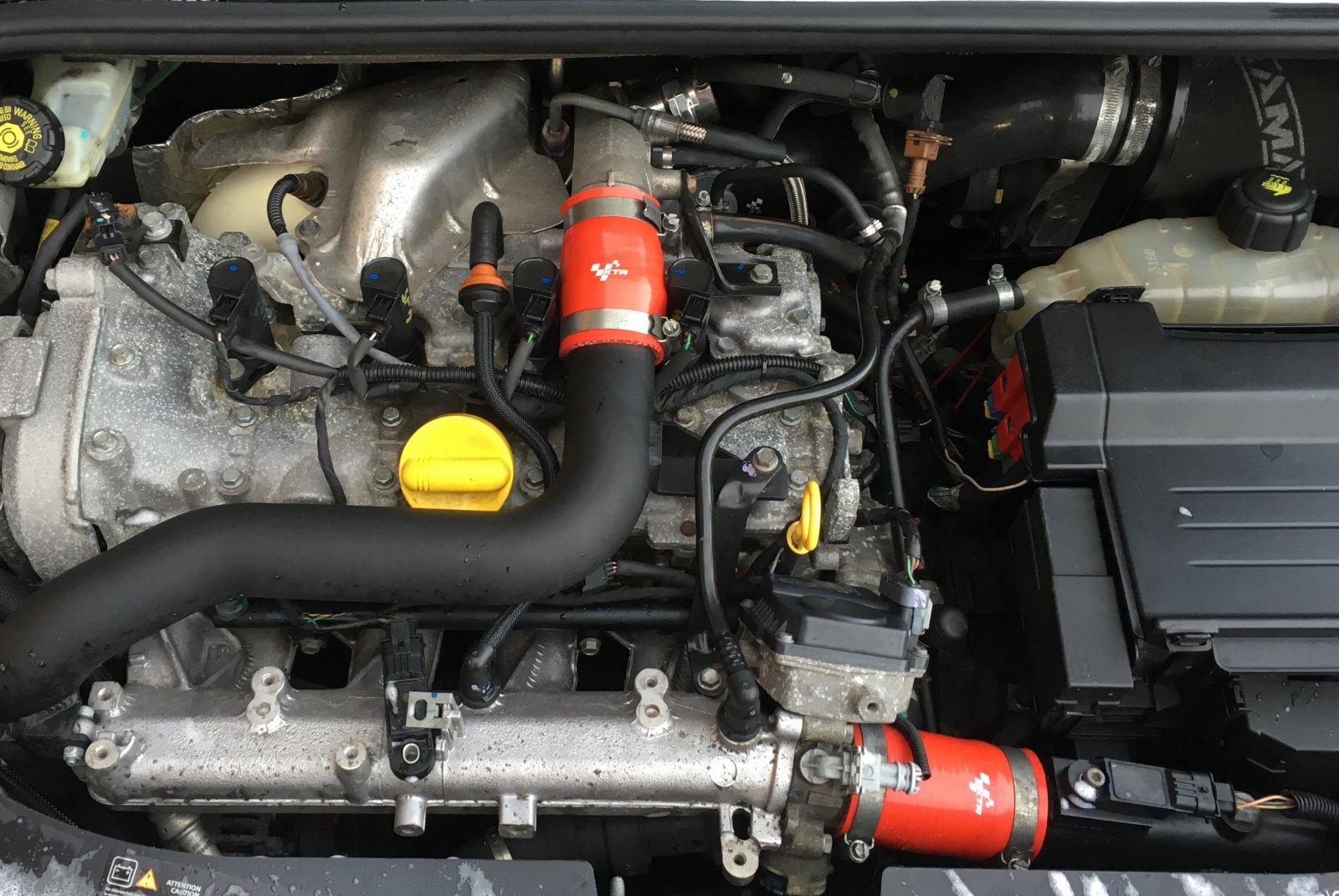

One thing I do want to look at is some sort of cold air feed for the intake, it gets very hot under the bonnet so there must be massive heat soak going on and sucking in hot air doesn't do anything for the engine temps either. That would involve either relocating the battery (hmmmm....) or cutting a hole in the bonnet for some sort of scoop (hmmmmm......). Still, just something to think about at this stage.
In terms of tyres the Pilot Sport Cup 2 were bloody awesome. Tons of grip, really consistent and lots of feedback too. If you can get them in the size you need I would definitely suggest giving them a go.

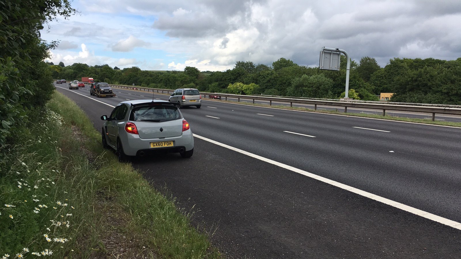

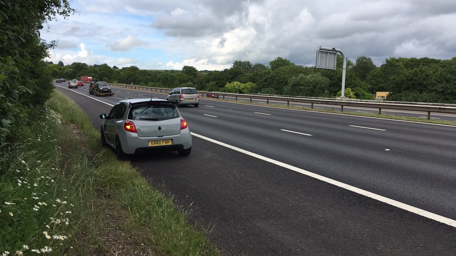

That's not gone well. Completely lost the clutch without warning, luckily was able to safely get to the hard shoulder. When recovery arrived we found the car was sat in a puddle of it's own brake/clutch fluid so something has let go.
Hoping it's not the slave cylinder, but that seems like the most likely cause. If it is and the failure has contaminated the clutch and flywheel then things get pretty expensive.......
I think the word I'm looking for is "s**t".......

Is it coming from bottom of gearbox, where it meets engine block or from the front (facing) area?
It could be the pipe which has broken, which would be 10x cheaper than a broken CSC.

Hard to tell, the undertrays hide everything pretty well and I wasn't in a position to do much proper digging around.
My mechanic has it now, I had it recovered straight to him, so once he's had a chance to have a look I'll update again. Not sure when that will be, he's usually booked up at least a week or two in advance and it's not urgent as I've got my sensible car for day to day work.
I know the slave is a weak spot on the meg gearbox but fingers crossed......
charltjr
Dodged a bullet here.....
It was the slave cylinder, but the clutch hasn't been contaminated and it's not going to need replacing any time soon either, so just slap a new slave cylinder in there and that's that.

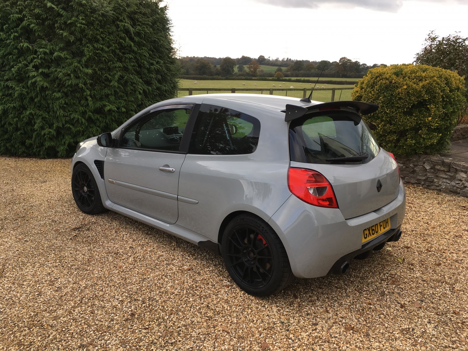

Cookson
  Mk1 Audi TT 3.2 V6
This is an epic car.
Any thoughts on any upgrades for the power? Remap/turbo/injectors??
charltjr
In terms of upgrades at the moment I'm thinking - nothing. That's very, very unusual for me!
I'd want to get the engine forged before trying to get much more power out of it, and the car really doesn't need any more power at the moment - 275bhp in a Clio 200 is plenty. I think I could probably get close to 300 with a hybrid turbo, map and injectors but that's a lot of money for a relatively small hike - if I was going to do it then I'd go for a big jump :)
I would go faster round the track with some good coilovers and a proper corner-weighted setup, but would I have any more fun? I love the way it handles at the moment and that money would IMO be better spent on track time and tuition because I'm really not a very good track driver, people with skills frankly piss all over me, but I don't care because I've got a grin a mile wide and that's what it's all about. Chasing lap times isn't for me.
Brakes are already awesome with the upgraded setup.
All in all it's nigh-on perfect for me at the moment. The only "upgrade" I can think of is sometime in the next couple of years I really fancy trying a Seven-type car, the idea of track driving in something weighing so little really appeals because what I really love on the track is the sensation of feeling the car through the corners and thinking "holy s**t, I wonder if I can really take that corner a leeeeeetle bit faster next time" :D

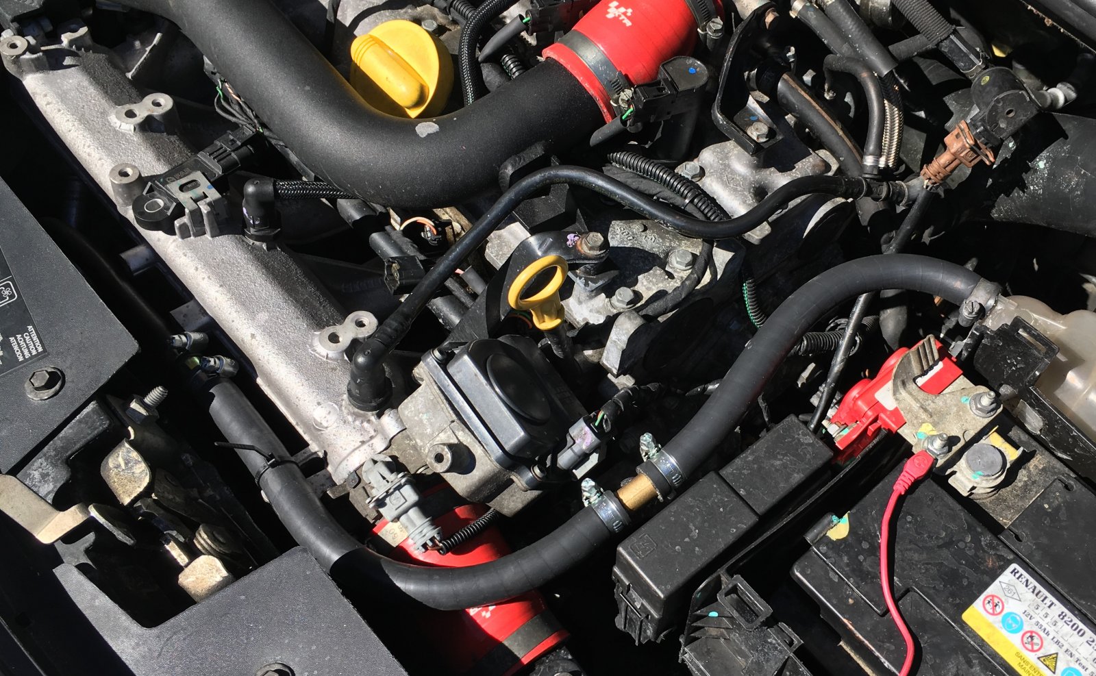

Picked the car up today and there were a couple of issues. There was a crack in the pipe that feeds the turbo water cooling jacket so that bit of pipe needed replacing - sadly only available as a complete unit with the connecting block and heat shield at over £100 😧
Also the cooling system wasn't exactly optimal in terms of how the pipework was put together. There's an output close to the thermostat housing which is usually t-pieced into the top of the rad and the expansion bottle, but that had been bypassed in the conversion and capped off. Unfortunately that's the way the system bleeds if any air gets in so it exacerbated the issue, and the cap had also split so was leaking too. Basically it just wasn't right and if there was air getting in then things were always going to get a bit sticky.
This was the old setup - turns out the pipe from the expansion tank to the rad wasn't held in place except where it connected to the tank and the rad. You can just see the cap which failed to the right of the throttle body controller.
This is the new setup - proper job. :smile:

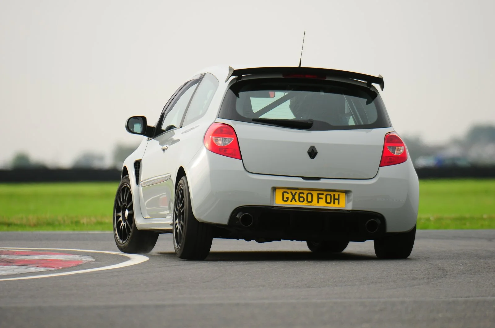

charltjr
Got to get at least one wheel in the air ;)
My new personal favourite picture, love the reflections and the little bit of tyre smoke from the front left.
The car was genuinely faultless all day, absolutely brilliant fun to chuck about. Was a bit of a shame about the weather, my quickest lap was about an hour in to the day because the rain took a lot of grip away, but it was arguably more fun that way so meh. Who cares about lap time when you're doing your best Cheshire cat grin?

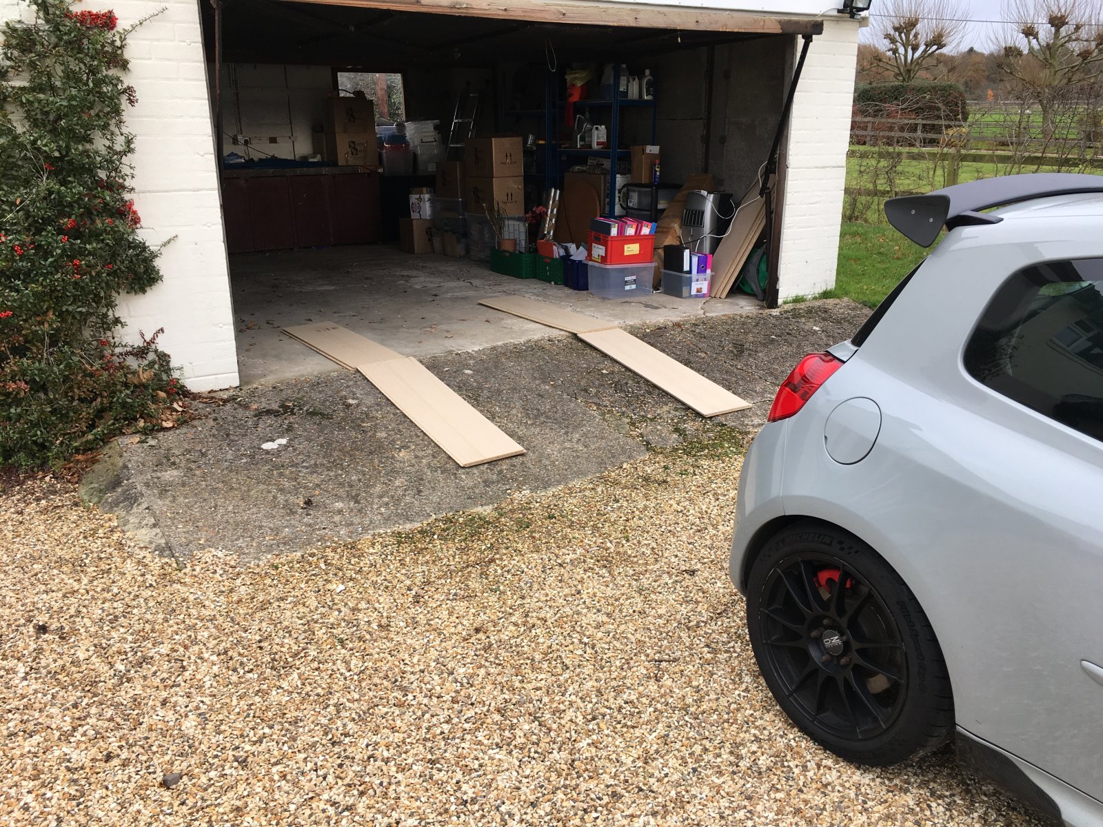

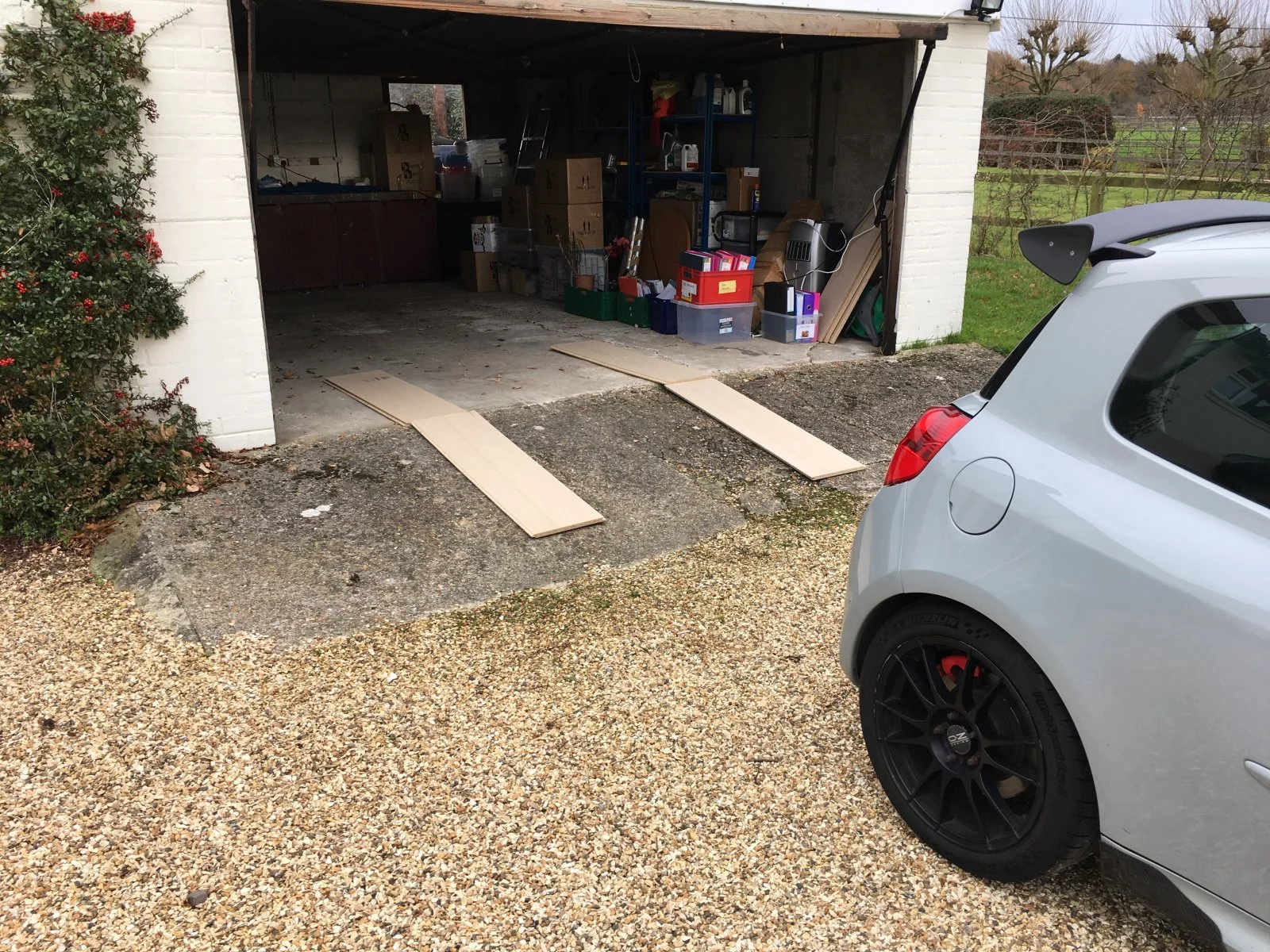

The new garage is turning out to be a slight ballache - would occasionally ground the bottom of the exhaust on the way in and out because there is quite a lip on the entry. Nothing major, just a slight touch, but still not something I wanted to be doing.
A left-over pack of loft boards and that's sorted for now :D
Long term the garage is going to come down and be rebuilt anyway. The roof beams are too low and I keep whacking my head on them, so have to walk round it with my head down or back bent. It's not ideal. Plus it's ripe to have a pitched roof on it with some sort of office space/granny annex/home cinema/who knows what in the "loft" space. Probably have that done for about... oooh... 2032. Maybe 2031 if we really crack on :D
