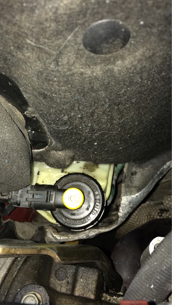

Went to check up brake fluid and I've found my reservoir cap is melted to the tank itself in the corner nearest the manifold? The bottom part of the lid is cured under. Not sure how im going to remove it now short of cutting it off!
Any one else had this issue or know why it occurs?

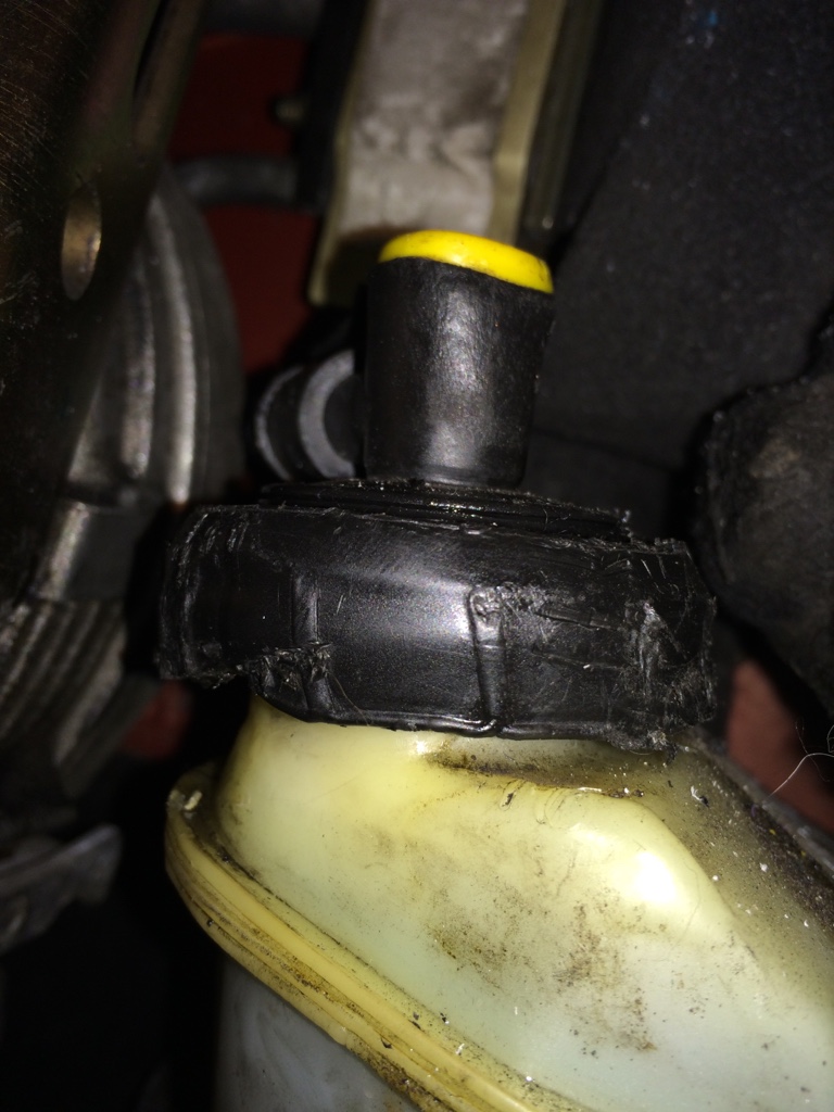

Yea I did it, had to cut it off and replace it. No idea why it happened. Not had the same thing since. There was nothing wrong with the brakes at the time either just happened to notice it.

same here, this isnt a track car just a road car so nothing should be getting THAT hot. Even if it were, hot enough to warp the plastic lid? All I can think is some fluid leaked out for whatever reason, flashed on the manifold and caught fire briefly which melted it to the lid. I cant shift it even with mole grips so ill need to cut it off I think - what did you use?
Glad i dont seem to be alone with this, been to renault this morning but they dont have one in so ordered one online, paranoid about it now as if it happened once but it could happen again

A dremel with a little circular cutter on then a pair of pliers.
  Inferno 182 & Saxo
I dont have a dremel unfortuantely ,one of those things i guess i should have bought. was thinking of just heating something up and melting through it to break its grip
  Inferno 182 & Saxo

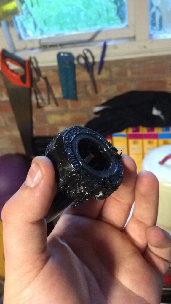

That was a fun 30 minutes, one hot engine and me leaning over to melt/cut it off. Awful was on so tight it was melted well and proper so it wasn't even square in the tank. New one fitted now from a Renault breakers walking distance from work can't get over that!
