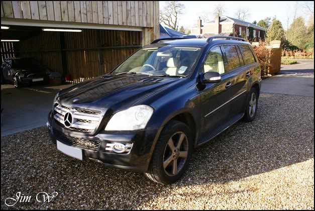

Hi all - a big black bus for you to check out. (get a brew, its a long read!)
Mercedes-Benz GL 420 CDi. ‘4MATIC’ – Enhance and Protect with Interior and LTT leather care
Oh my! What a vehicle. This is about the size of my house.. It’s ginormous! With that in mind though, I was fortunate to have an excellent environment to work from; it makes SUCH a difference if you’re able to keep warm(ish) clean, dry and out of the sun/wind.

Upon arrival and after greetings, the first thing I like to do is setup base! Five hours in, there is nothing worse than having kit all over the place…
Inspection shots:
Not looking forward to having to work on these:
Interior not too bad; leather just needs a gentle clean and protecting.

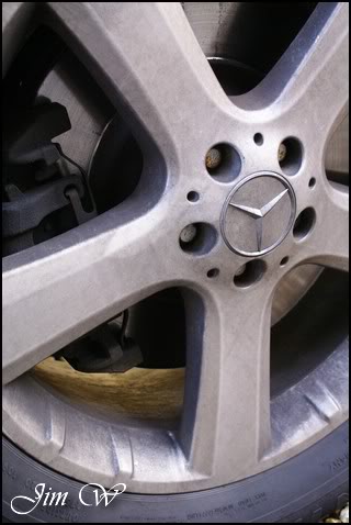

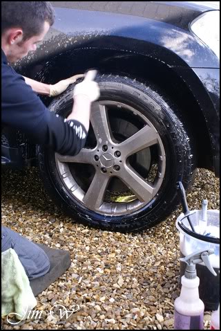

Wheels first-up;
Megs Super-Degreaser on the tyres, APC up into the arches and Wheel Brightener allowed to dwell on the alloy. Tyres scrubbed with a stiff brush, arches cleaned with a Vikan long-reach brush and alloys attacked with various mitts/tools. Last but not least, I went at them with Tardis to try and remove some pretty bad staining on the inner rim (Was unable top full remove; wheels would require coming off for a proper deep clean)

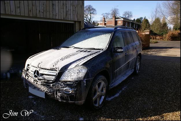

I thought I’d try something new today (..big mistake). Snowfoam the car and then run round the doorshuts and sills with APC and a few brushes whilst the foam was dwelling... This just doesn’t allow enough time to thoroughly clean the shuts. I will definitely stick to my usual method which is wheels > shuts > foam.
Suns out, heh, who’d of thought!

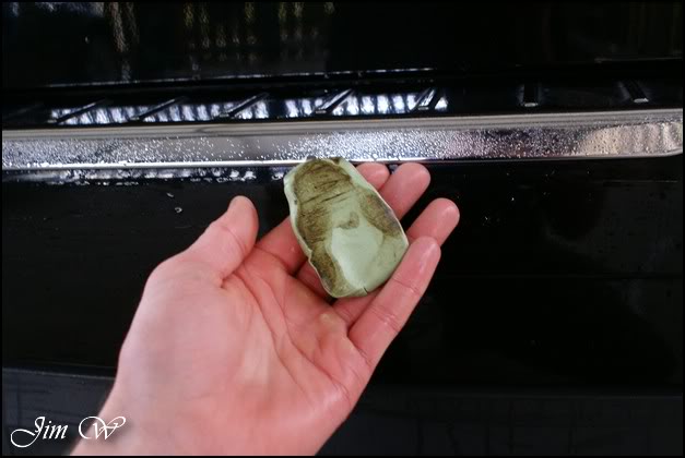

Mercedes was pulled into the garage for claying stages (sun was beaming down by now)
Now, I recently learnt that the last time this car was clayed/cleansed, was April 2007. (By me!)
General pick-up from the front end and bonnet:
O/S rear wing:
Rear window:
Rear bumper/Tailgate:
And finally, below the bumpstrips (Which had already been wiped down with Tardis to remove the ‘bulk of’)
Good. A ‘clean’ car!

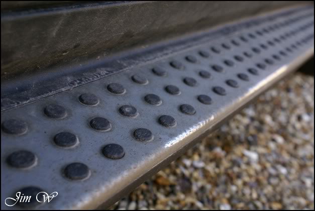

(….minus the running boards)

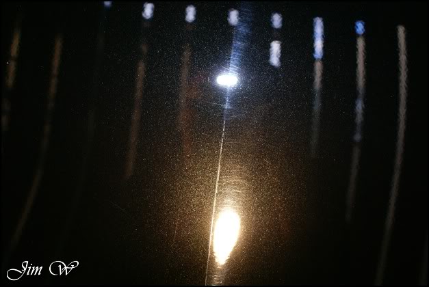

A quick run round checking the paint:
This one looks a little nasty – not sure what’s gone on here. “Rubbing” of some sort..

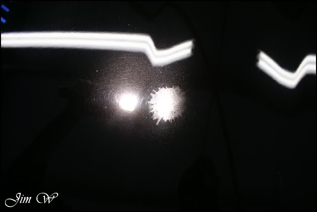

..bar this massive bird etching!
Another etching seen here – N/S front door: (just to the right of the light; a runny poo!)

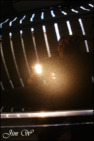

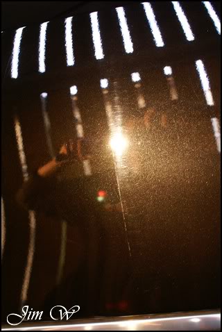

With that in mind, I jumped in with a 3M polishing pad and my usual Limeprime combo.
Before:
After:
Not amazing, but, certainly lifted the surface ‘wash hazes’. Deeper marks remained; requiring more aggressive polishing.

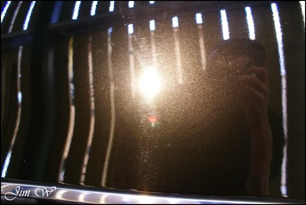

50/50s on the drivers’ side:

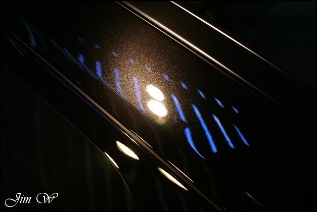

Some interesting sanding marks found here, O/S join between the front door and the wing:
All lifted OK:

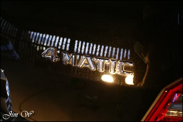

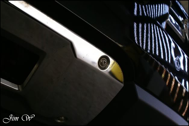

Over the years, lots of gunk had gathered around the Merc badges on the back - Prime and a cotton bud was put to work:
Before:
During:
After:
…not perfect. Very fiddly and ideally would require taking the badges off completely!

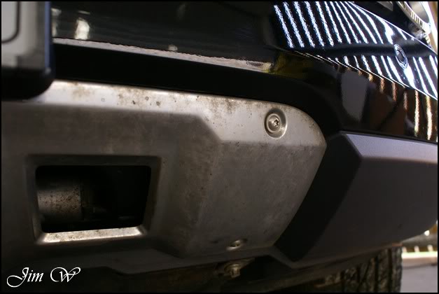

Exhaust after an AutoSol session: (Tar deposit currently breaking down from Tardis application)

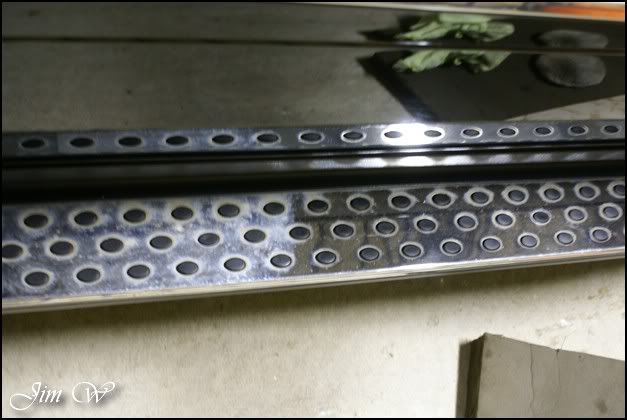

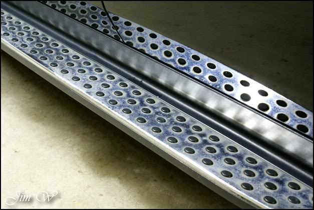

50/50 on shiny running boards:
Before:
During:
After:
Again, would need to remove ‘bobbles’ to clean fully; lots of stubborn engrained dirt wedged to the side of the plastics.

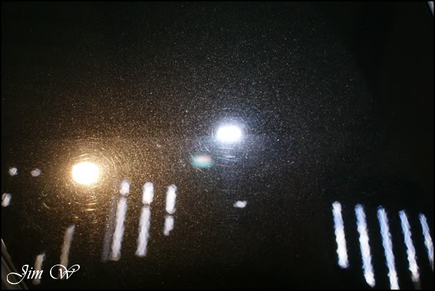

I did a little test spot on the tailgate with a sfx2 spot pad and Menzerna Intensive Polish. (Menz 203s wasn’t cutting it!)
As opposed to the ‘enhanced’ area:
Same area after:
Possible, but, on a vehicle this size I can imagine it to be very time consuming!

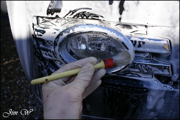

Britework around the spotlights were pretty tarnished, too:
As was the rear chrome ‘lip’:
After elbow grease and Prime:
See the stubborn bits at the bottom? Yeah, they weren’t going anywhere.
