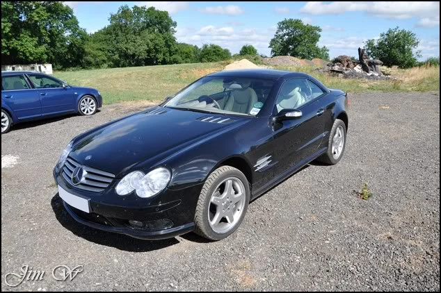

Mercedes SL600
Having spent two days on an identical (minus the wheels...) SL600 seven months back now, a close friend of the original owner wanted the same treatment on theirs.
Arriving bright and early on the Sunday morning, I put the new camera to the test!
Inspection..

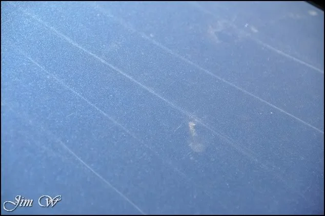

How’s this for tree-sap??
Although regularly garaged, you can see the damage tree-sap and other fall out material can have on your car!

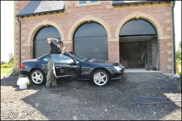

Having travelled up from down South, the front-end had collected an impressive amount of squashed flies. G101 applied and allowed to soften the bugs before a long thorough pressure rinse.

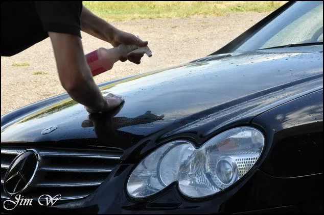

The car was foamed with G101 to help lift all the grime out the window rubbers etc. Then foamed with normal snowfoam and washed with the two-bucket system and Dodo Juice Born To Be Mild.
Meguiars Last Touch then used to aid the Sonus Green claybar in lifting all the surface contaminants. Surprisingly, it wasn’t ‘that bad’. (Considering the state of the panels in the inspection photos..)

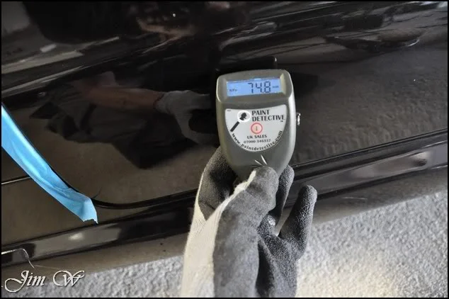

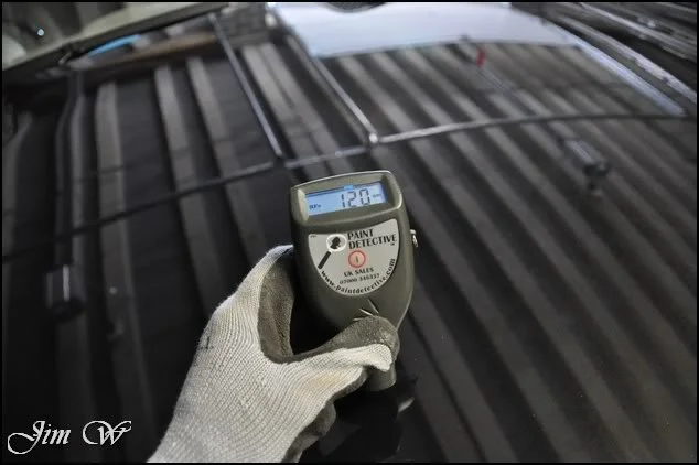

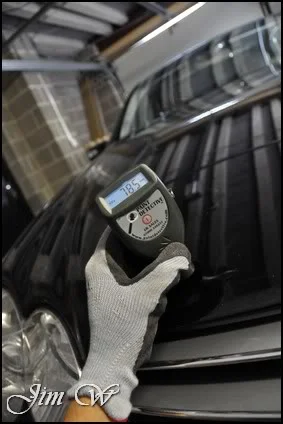

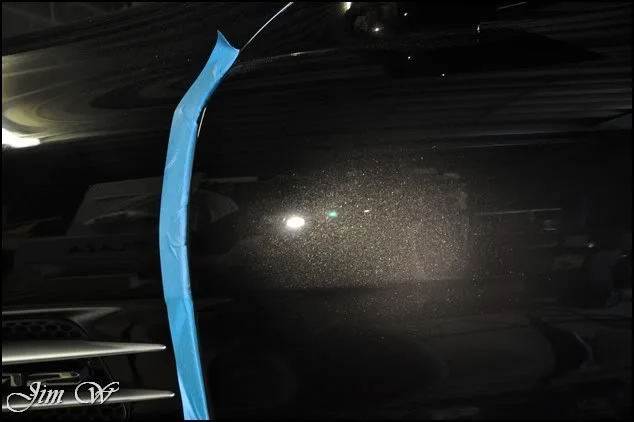

Once inside and bone-dry, any delicate areas were taped up and paint thickness measurements were taken.
Very similar to the other SL600 I did late in 2009… Fairly low readings throughout!

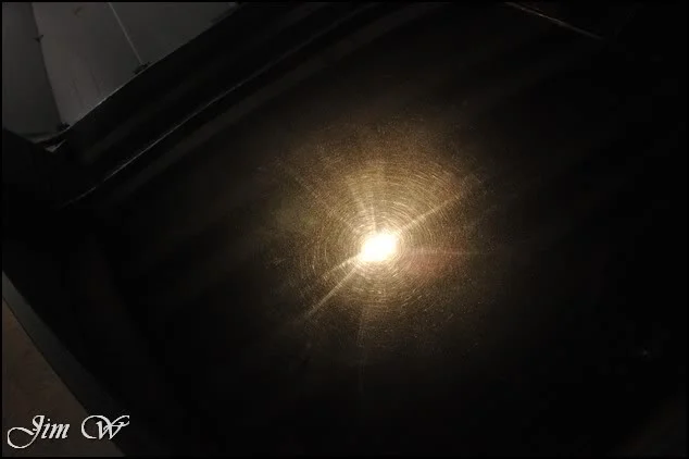

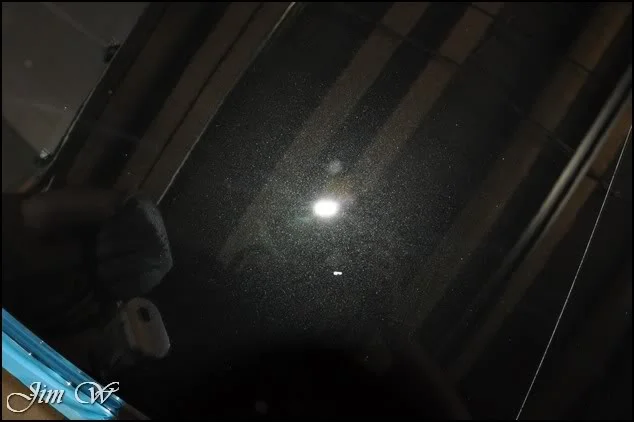

Bonnet defects to tackle:

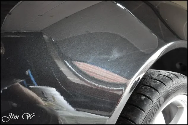

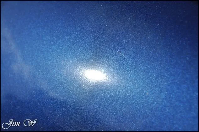

A weird ‘reaction’ spotted on the N/S front wing (you probably spotted it above in the earlier photos..) At first I put it down to the sap etc, but, upon closer inspection, there were minuscule cracks in the paint and almost drips spotted… Makes me wonder if it’s the doings of a poor bodyshop job and/or respray?

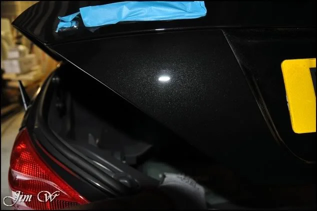

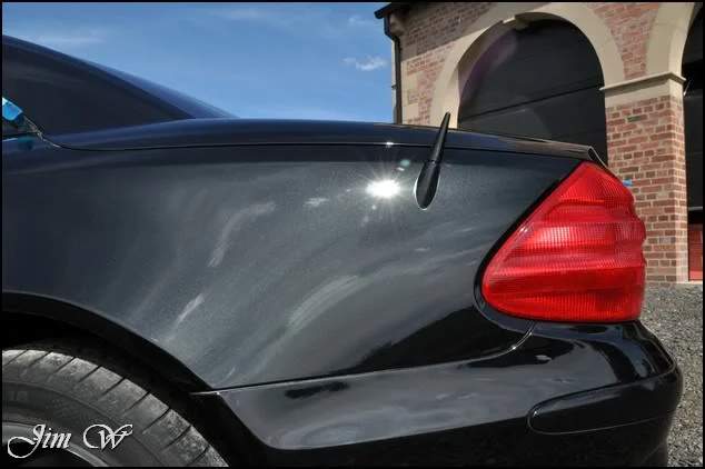

General condition of the paint throughout spotted on the N/S rear quarter in natural light:

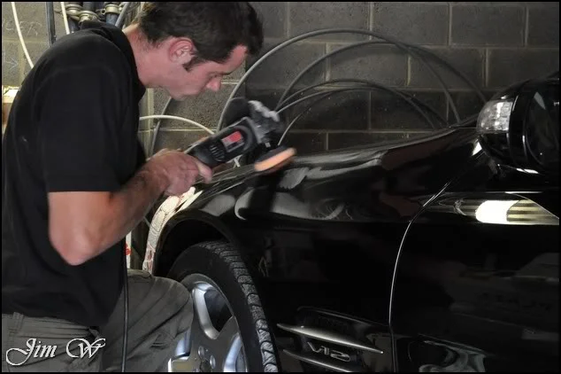

With polish and pad testing combinations out of the way, I settled on an Orange Hexlogic Heavy Cut Pad with Menzerna 85RD 3.02 as the Light Cut Pad and Menz 203s combo didn’t quite ‘have it’.

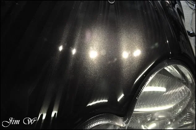

Bonnet Before & After:
50/50:
….ready for a light refinement later on.

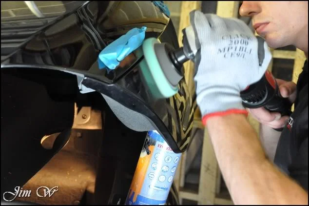

I switched to a smaller spot pad and finished all the fiddly areas before moving onto the bigger doors, tailgate and bonnet etc.

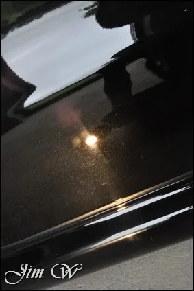

N/S door after:
50/50:

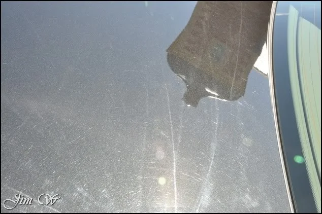

Lower down on the N/S door a series of nasty scratches were spotted trailing the length of the door…
The area was hit with the same polish/pad combinations but due to paint thickness, I didn’t want to take it any further. Not 100% removed, but 99.9% better ;)

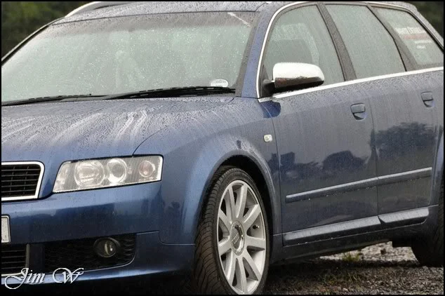

Just 400 yards before I reached the owners place that morning I put through Avant through the MOTHER of all potholes. Gutted! At the time I thought if I hadn’t bent/damaged/cracked the wheel then the tyre is most certainly shot. Turns out, I’d fractured them both.
A4 waiting patiently for repairs..

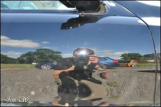

Meanwhile, progress was good and I had some decent results to show whilst the sun was still out.

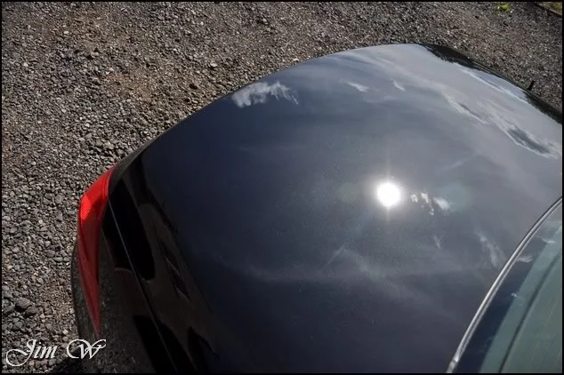

Tailgate compared to the unfinished bonnet:

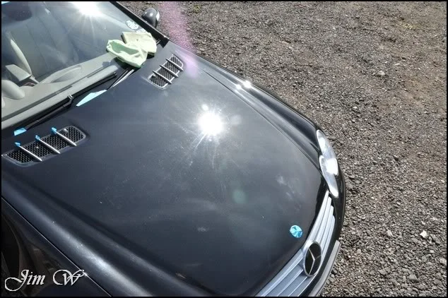

Another bonnet before/after shot:
And the sides of the bonnet completed with a series of spot pads:

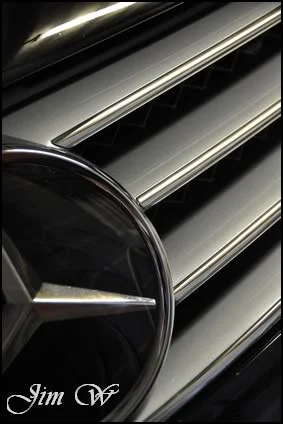

All alu trim (front end, rear and wheels) was cleaned up with Jeffs Prime to remove the ‘tarnished’ look.

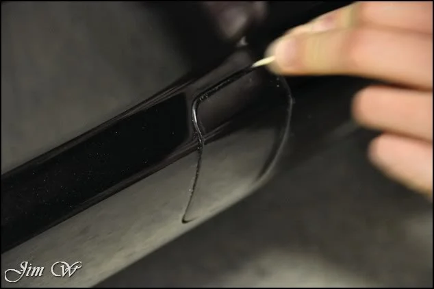

Time for some tooth-pickery of old polish residues:

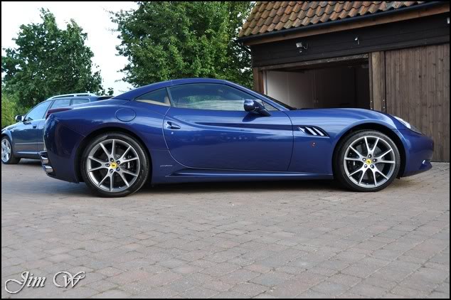

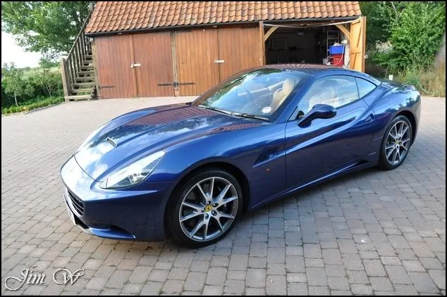

Ferrari California
A two day visit back to one of my regulars in the Midlands.
Day 1 was spent maintaining the Porsche 997 Turbo and the Mercedes GL420. Day two, a New Car Gloss Enhancement Detail was given to the daily driven Ferrari California.

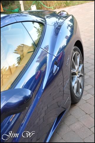

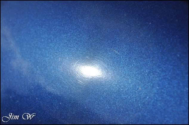

Inspection shots..

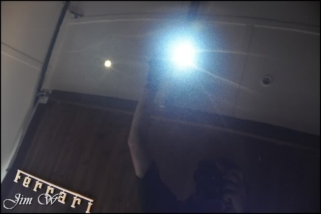

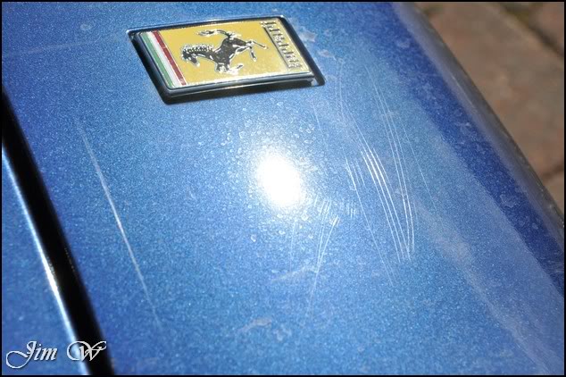

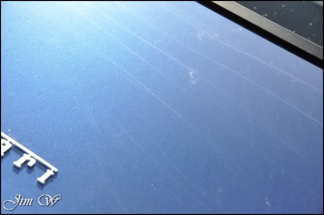

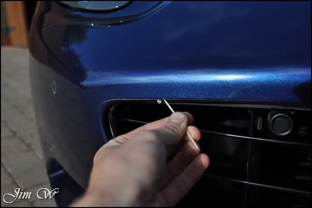

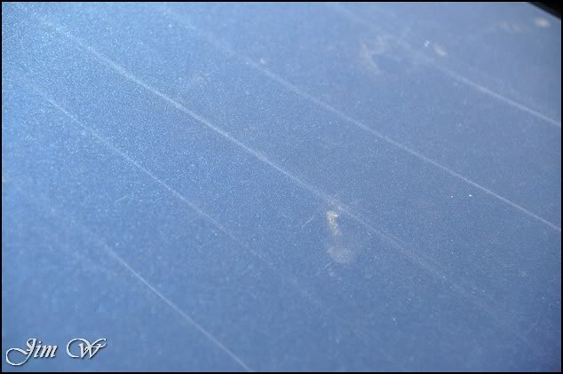

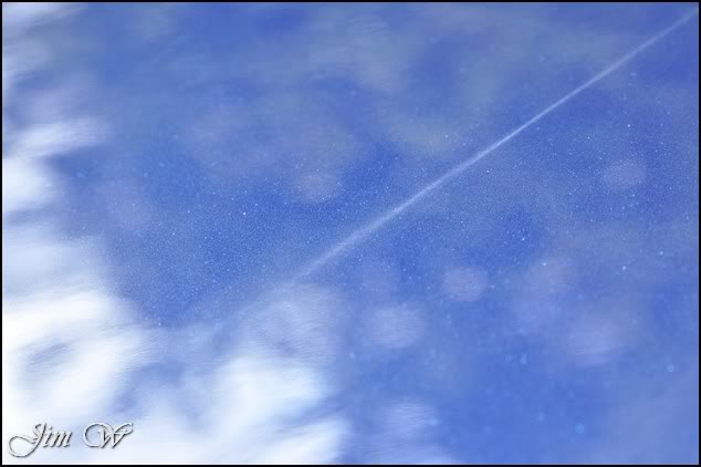

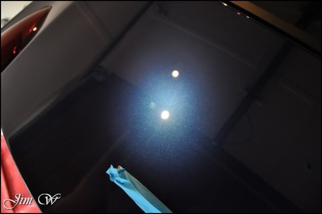

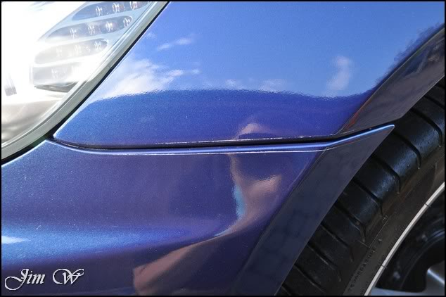

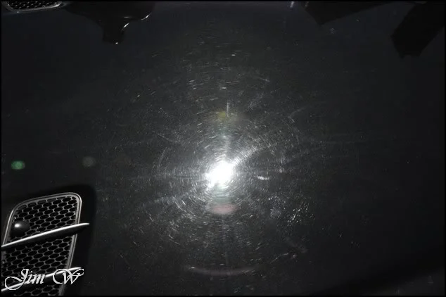

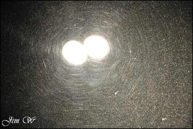

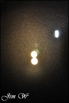

Typical machine holograms left by the Dealer prep. This car is only 5/6 months old..

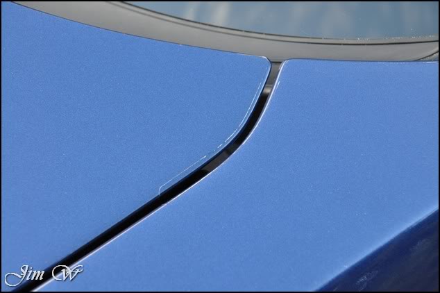

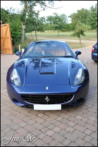

The front end had been covered by PaintSheild to preserve the paint from stone chips, bugs etc etc. Although it serves a purpose, it doesn’t half steal the clarity of the paint underneath. Film applied to bumper, bonnet, both wings and mirrors.

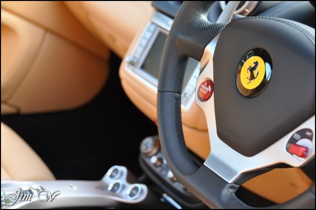

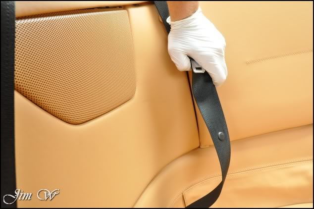

The interior would require a little attention today as what with it being a daily drive, the light coloured leather was showing signs of dirt already.
I’m without any ‘before’ photos I am afraid; very difficult to capture on the camera.
A design-fail on Ferrari’s behalf this:
Stepping up to my strongest cleaner by LTT, I was able to improve, but not fully shift the stubborn mark.
LTT Auto Ultra Foam used to clean all leather areas – doors cards, dash, front and rear seats. A weak G101 mix used to clean other plastic areas that required attention. LTT Auto Ultra Protect later used to help ‘shield’ the pale coloured leather.

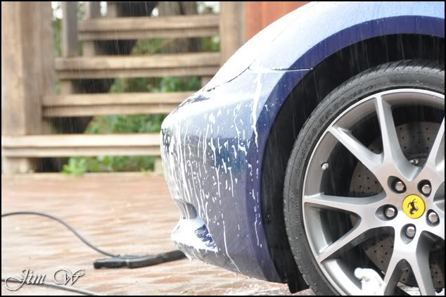

Front end covered in APC to eat into the bug-splats.

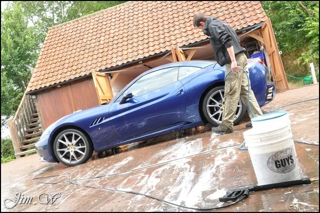

Vehicle rinsed and snow foamed. Rinsed and additional foam applied to assist my two bucket wash.

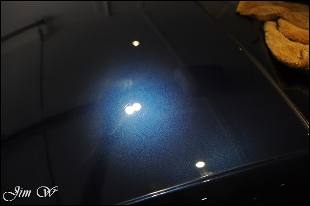

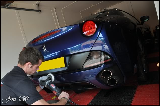

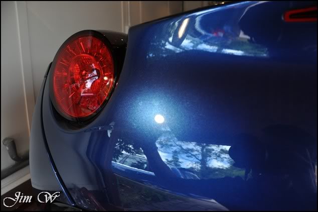

Treading very carefully, I loaded the rotary with a finishing pad and Menzerna 106FA.

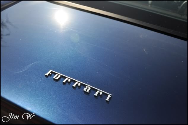

Boot-lid before and after:
Tailgate after:

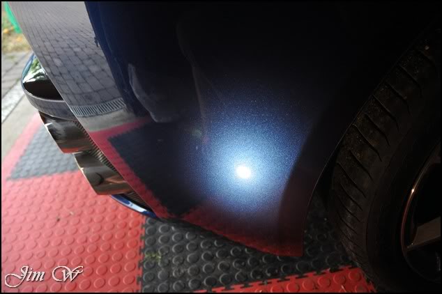

Rear bumper before:
After:

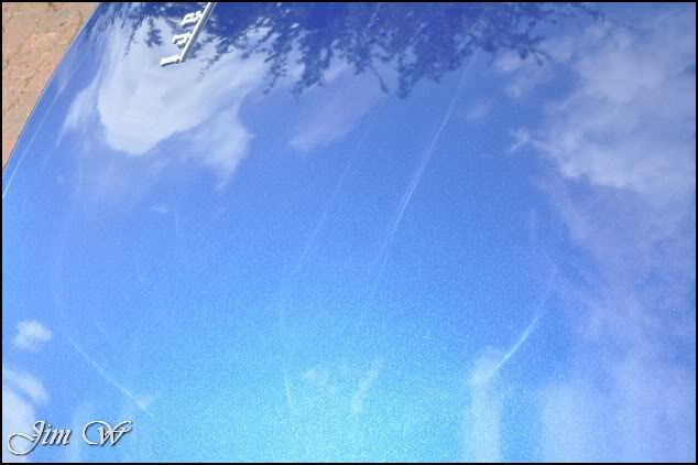

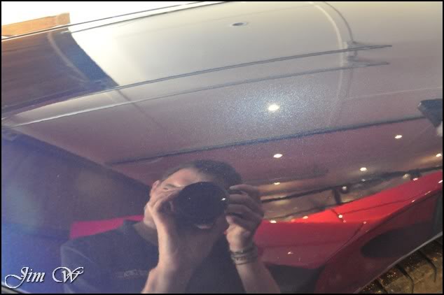

High up on the roof befores:

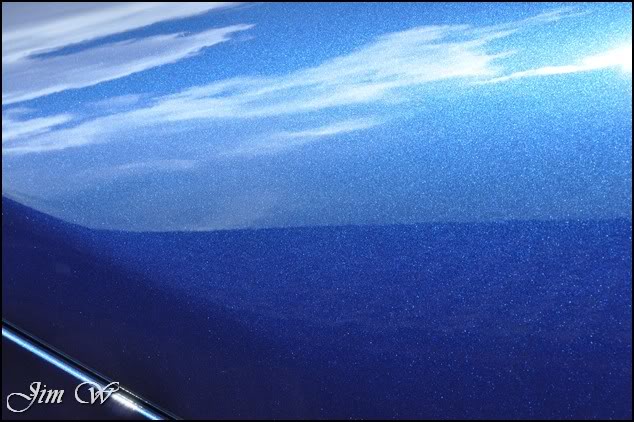

And all knocked back leaving a sharp and refined finish:

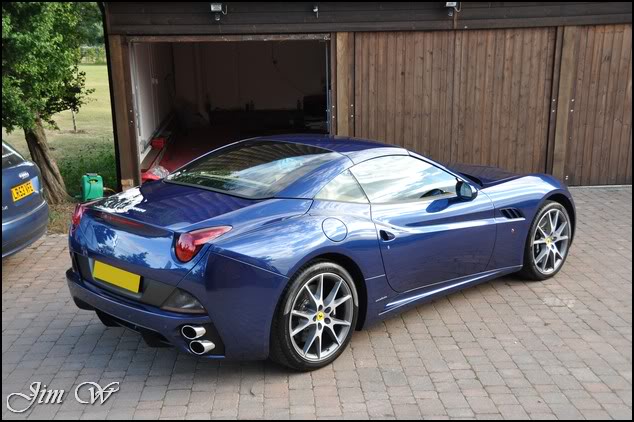

That was the O/S of the car complete… I now have to dodge the rain showers again and manoeuvre the vehicle back in the garage the other way round..
Cheeky photos whilst spinning round:
N/S completed in much the same way.

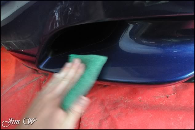

Fiddly smaller areas where the machine wouldn’t reach were cleansed by hand.

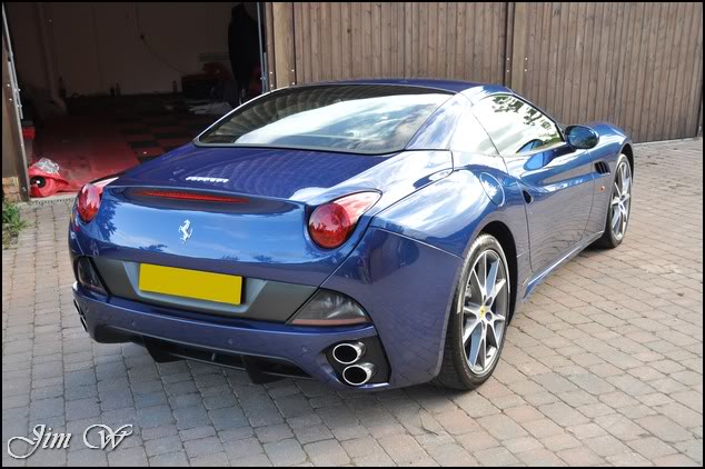

Windows cleaned with 3M Glass Cleaner. Tyres Dressed and Alloys sealed. Exhausts polished and final Z8 wipedown given upon completion.
Polish residues caught in the Paintshield edges removed via toothpickery…

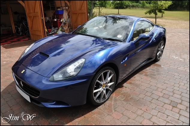

FINI.
It has to be said, a beautiful car.

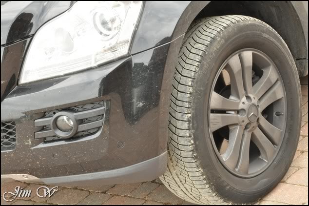

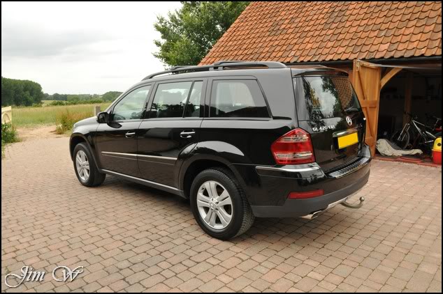

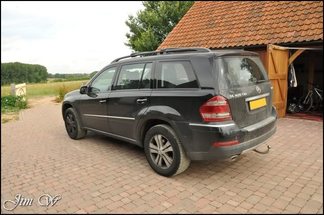

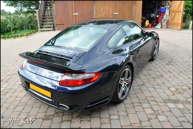

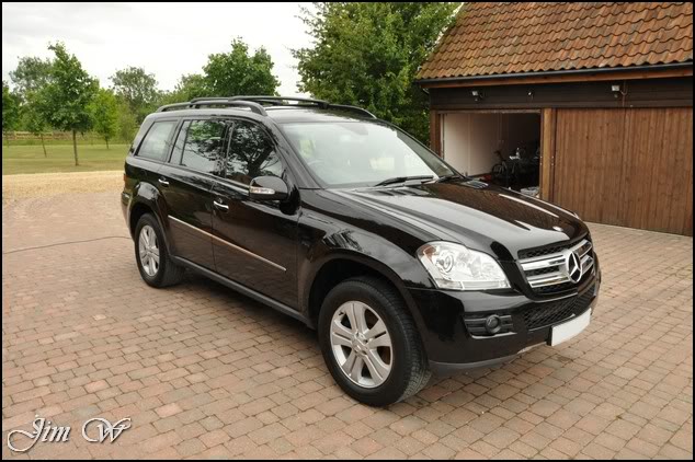

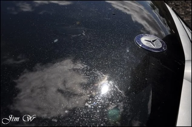

A few snaps from the previous days work on the Porsche and Mercedes going through their 3 month maintenance plans:
