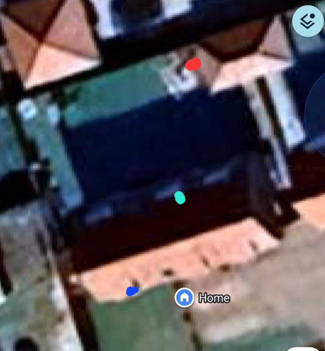

Im f-ing useless with Tech but just want a decent signal to our shed/outbuilding as we're turning it into a mini gym so will want music or a TV streaming out there and the treadmill requires WiFi and we have a cheap WiFi extender plugged in the utility at the minute thats a bit crap.
Its not a long way but our open reach socket is at the other end and side of the house.
Blue Dot - Open reach Socket
Red - Outbuilding/Shed/Gym (Has mains power)
Green - Current cheap WiFi extender plugged in.
You could try powerline as the least invasive option. I used this for a number of years and it was fine.
Second option would be something like an EAP225 Outdoor by TP Link, run a cable from that to your router and put it as high as you can on an external wall.
Third (and best) option would be burying a cable and running cat6 or preterminated fibre and linking your router to a garage access point that way.
Id try all of those in turn, from easiest/cheapest to hardest/most expensive.
