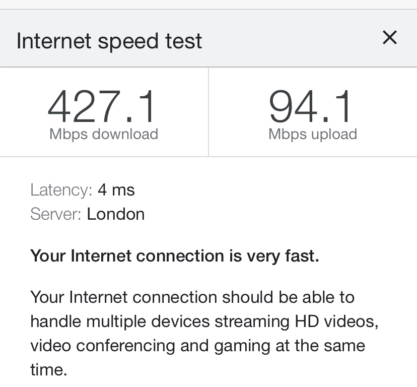

These are the speeds I’m getting connected to the upstairs wireless hub

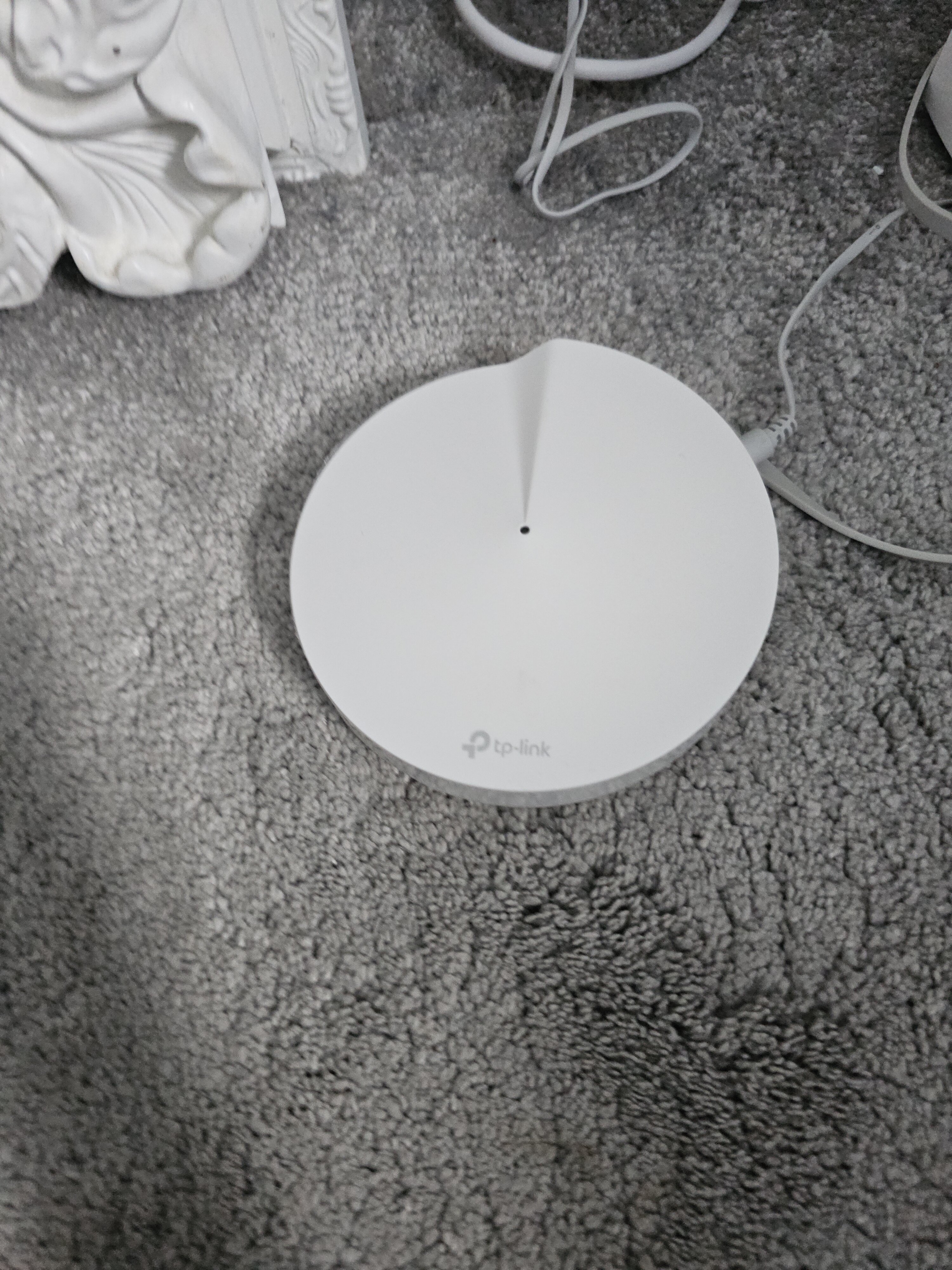

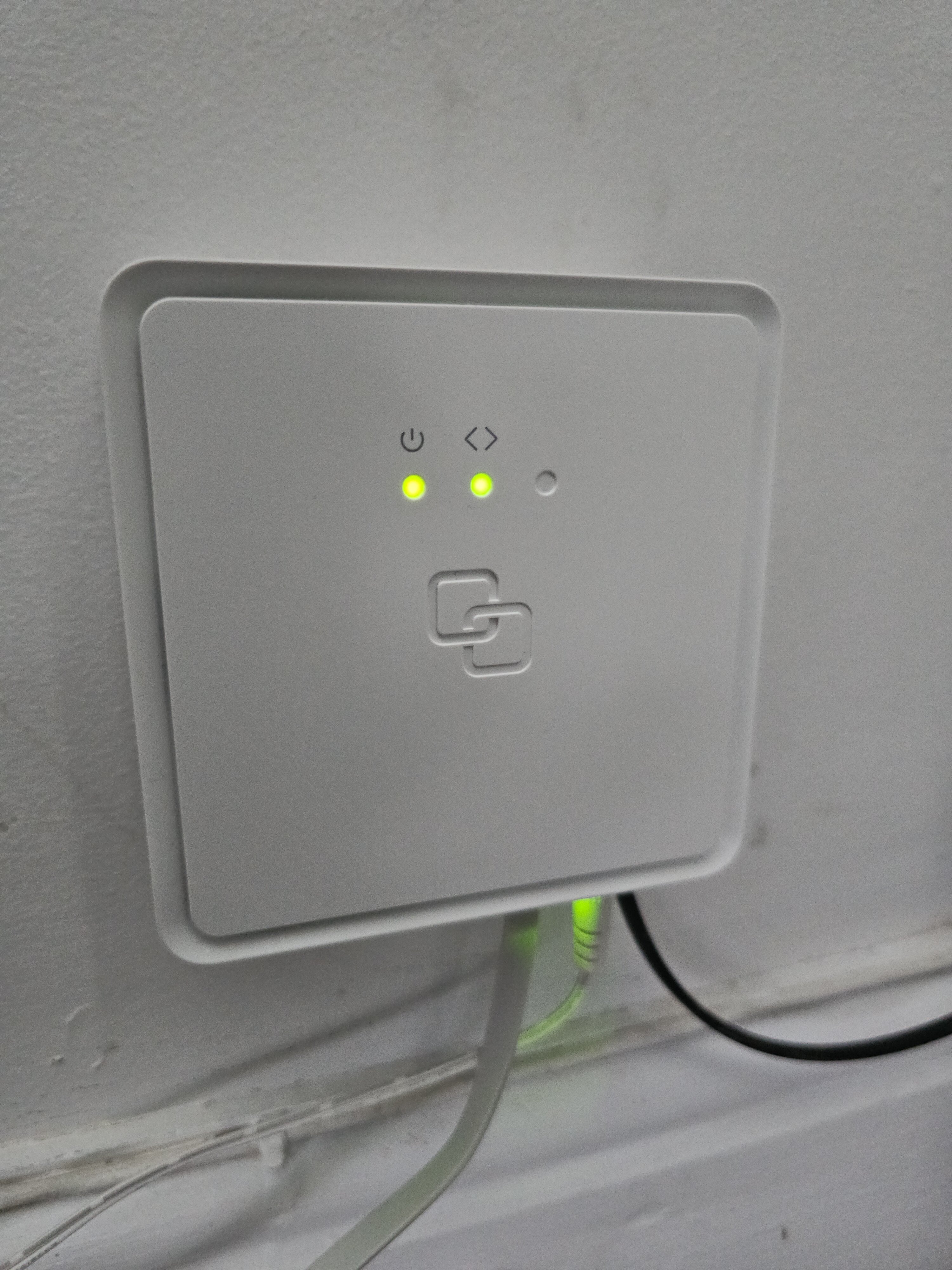

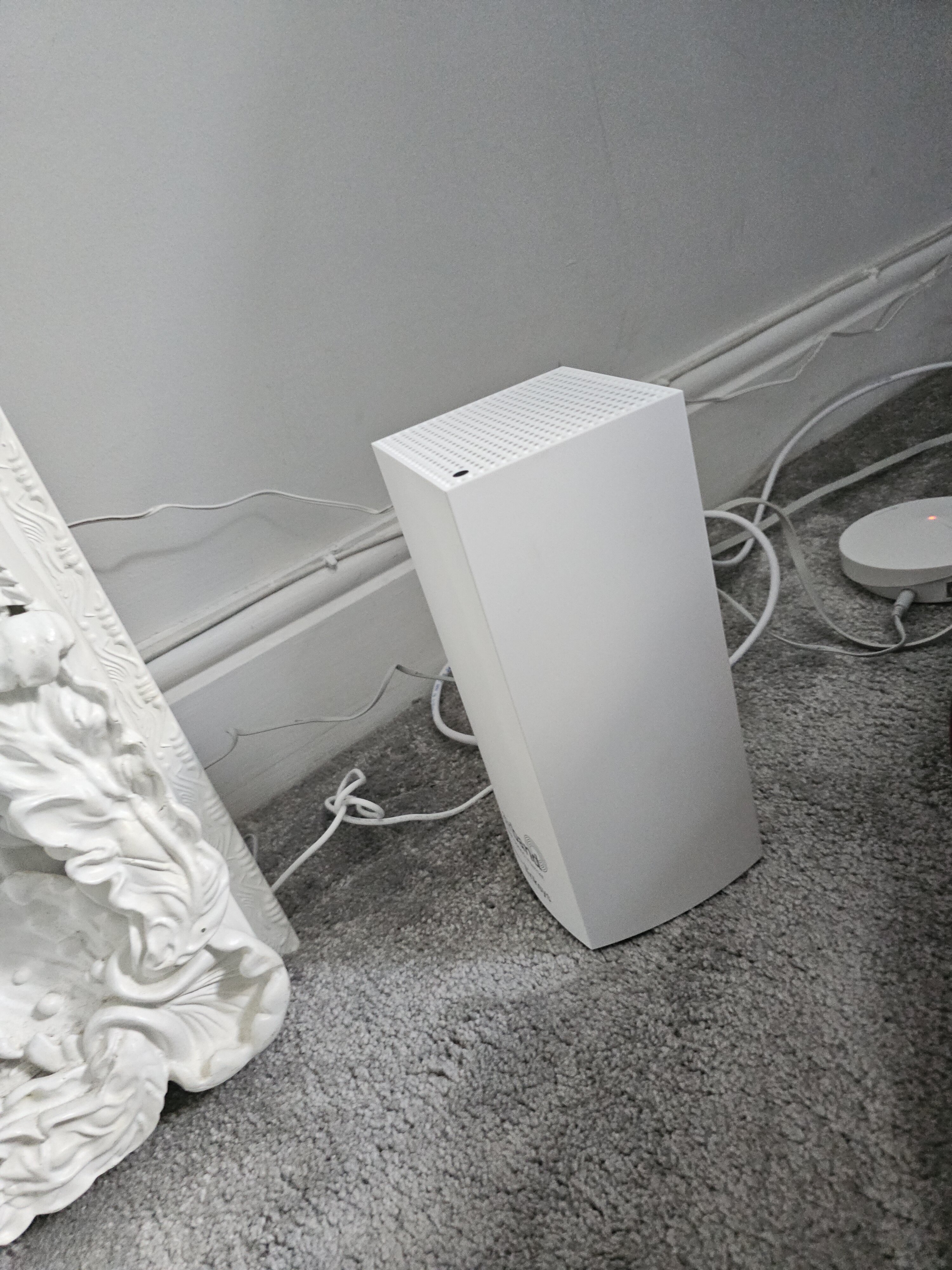

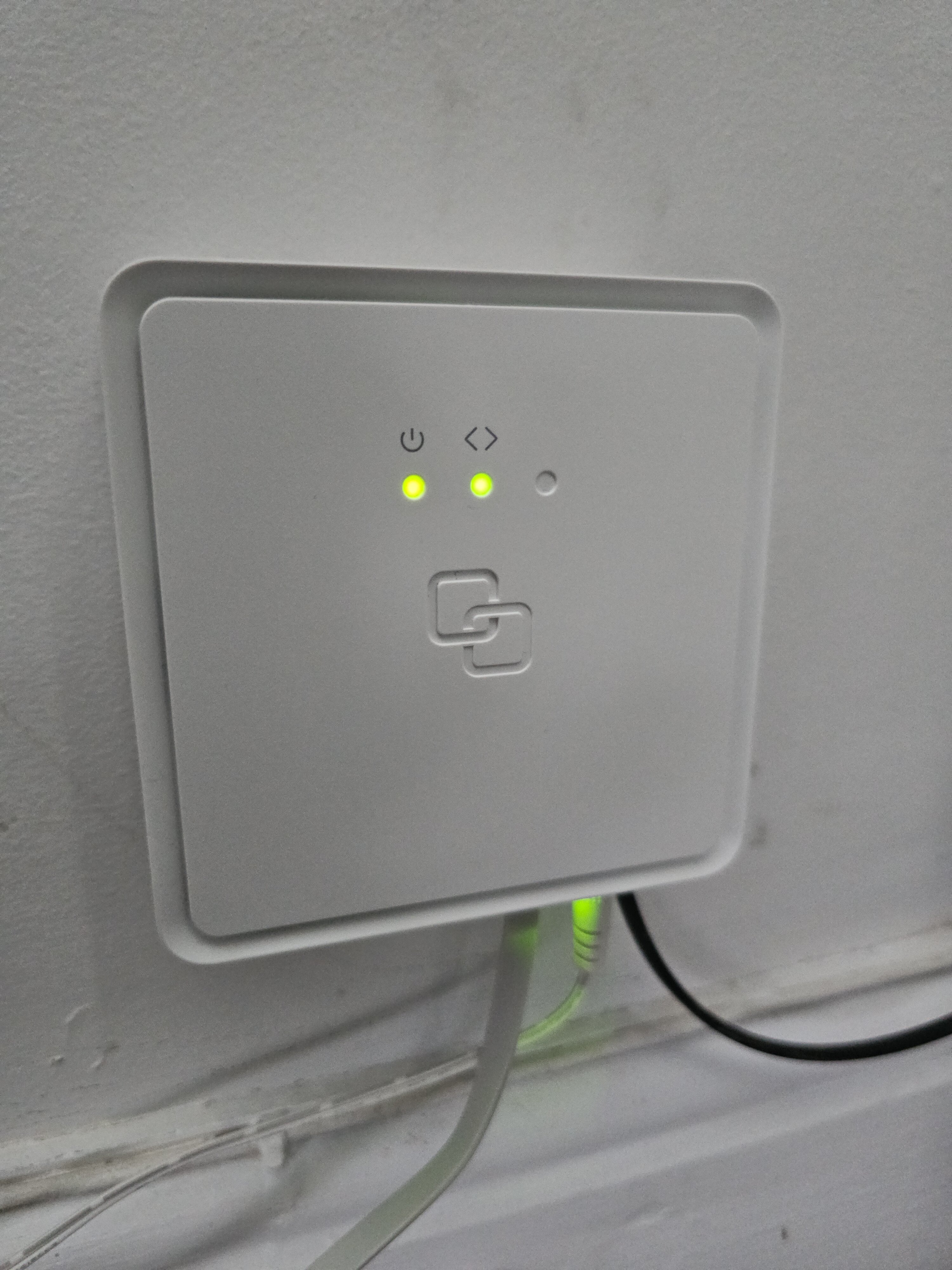

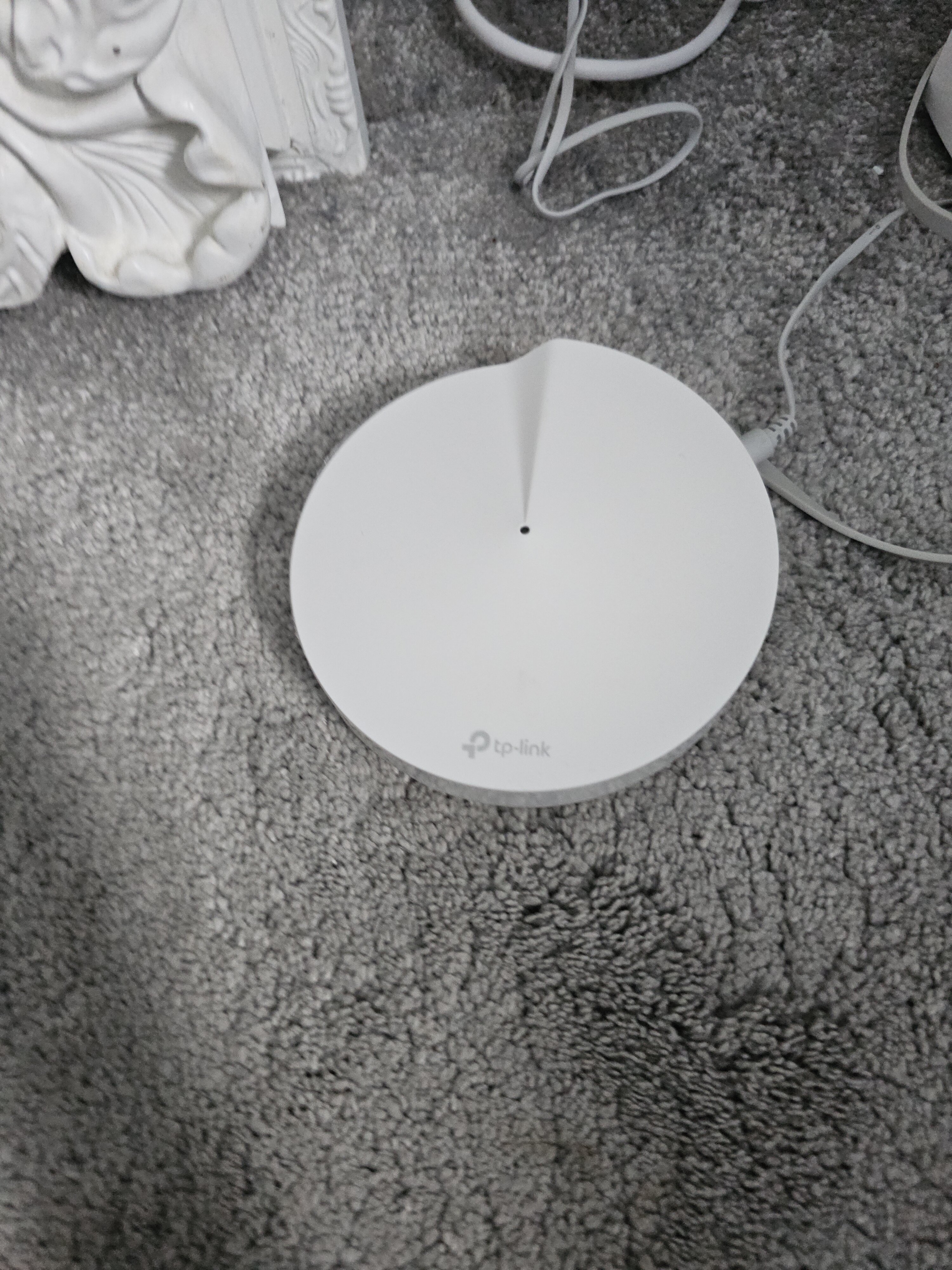

Hijacking a thread.
Just had Gigaclear rural broadband fitted.
The supplied router is huge and I want to use my Tp Link Deco M5 Mesh thingies as they spread the net around the house better.
Do they have to connect to the router or can they go straight to the wall.
Picture of wall socket and giant router.
Hijacking a thread.

If you're removing theirs, you'll need to login info, I haven't checked but I presume it's PPPoE
The box on the wall is known as an ONT, this doesn't provide any account level information.
Your (their) router will probably have it - so if you replace it, you need
a) the details
b) a router that supports that protocol
Im not familiar with gigaqueer, I trust they gave you the router admin login?
Thank you
My bad its done by a company called Airband.
It is PPPOE
I think my deco would work I just need the account details.
Give them a call, they are usually generic details oddly.

OK thank you.
When I get the details from my isp and Ill use that on the TP.
From memory there a few options on the tp link to connect it to the ont. Would that ppoe again?

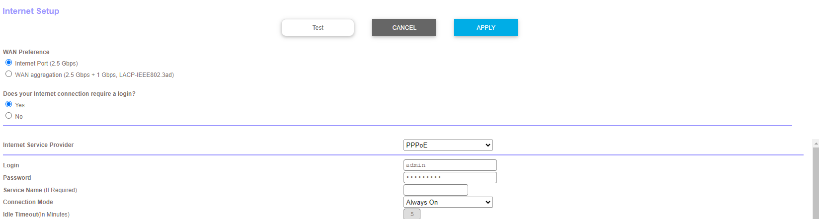

from memory, you should be able to set the pppoe details on the TP, and then it'll authenticate just fine. It certainly won't be too problematic, mine is like so:
Thank you
I've gone from 12mb Internet to 270mb.
Just a shame it doesn't broadcast anywhere until this mesh is sorted
All sorted, thanks for the help.

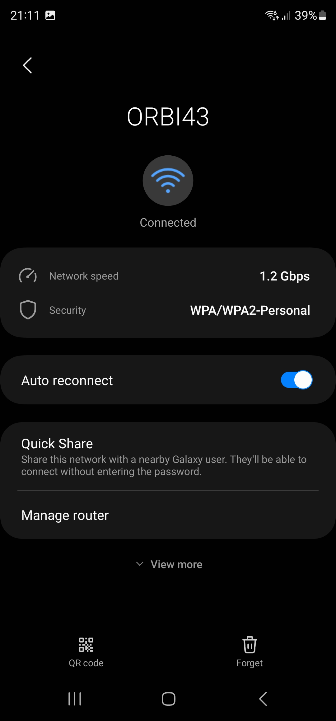

I run a router and 2 satellites, the Orbi RBK953.
