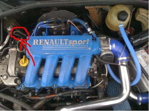

metal plate fallen off engine
Car  clio sport 172
i had a tapping noise while driving when put up on ramps found a metal plate loose and ripped my gater on my drivers drive shaft (what i only had new a month ago) does any one know what the plate is and what it is for the metal plate is circled in this picture.(this isnt my engine). pic of clio engine.webp
that is a lifting eye. Only needed if your're removing the engine really (or hanging it up with the subframe off to remove the gearbox)
your fine to drive without it mate, you'll need it if your ever going to take your engine out or have a clutch fitted etc, you fasten an engine hoist to it!
