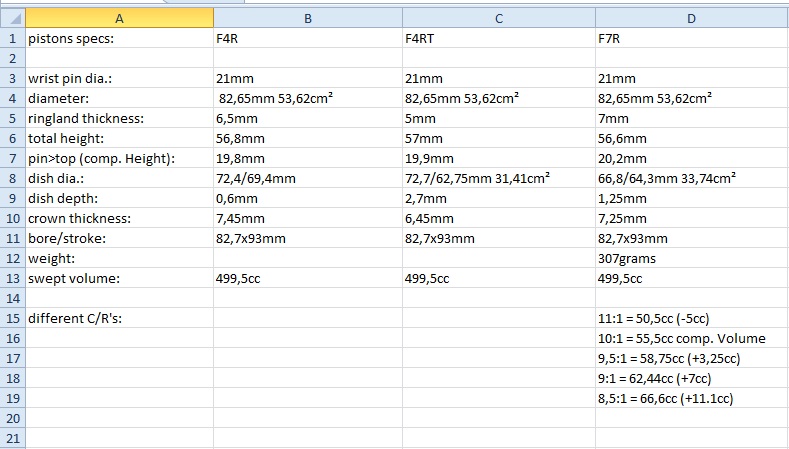

i don't know what your C/R is with the 197 head but atleast you won't have to go low comp pistons right? i've specced the 3 F pistons and put them up in an excel file:
i'm going to skim a set of F7R pistons again only this time i'll just flat top them -1mm. C/R will be 9:1 and crown thickness will be .25mm thinner then OE F4RT pistons.
as the casting of the F7 pistons is much better than F4RT pistons i'm confident they will hold upto or even slightly over 300bhp which is my next goal :)
sorry for the hijack but i'm sure this will be of use for anybody!
