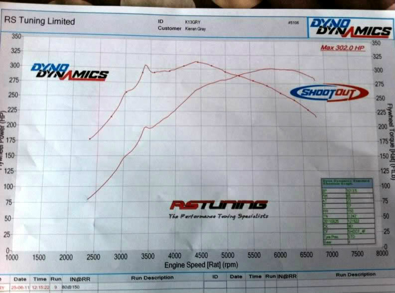

My r26 has been running 302bhp / 312ft.lb on a standard bottom end, with ARP rod bolts for the last 20k with no issues at all.
Hydrid turbo gray? And is that with a decat?
  340i
Yes and yes :)
Hybrid turbo
Turbo back 2.75" exhaust
630cc Siemens Deka injectors
forge intercooler
forge actuator
forge re-circ valve
forge boost pipes / hoses
ARP rod bolts
It goes really, really well... Mid range pull is brilliant and it puts the power down so easily.
I would love more, but the next step would be a forged engine.

ARP rod bolts
