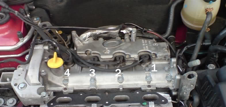

I changed my spark plugs today however car is now misfiring.
I just want to check the orders of HT leads etc.
Is it on the coilpack the order of:
3 4
2 1
And then what is the order when placing the HT leads into the actual spark plug.
Purely because the actual number on the white tag is a different number to the one on the end of the HT lead.
I am under the impress the number of the white tag on the HT Lead should correspond to the spark plug below, is this correct?
Any help appreciated!
Surely the numbers on the coil pack should correspond to the spark plugs, rather than just the white tags on the leads?
Checked all the plugs and they are sparking fine.
Its just weird that the little number on the tag of the lead - corresponds to the coilpack number.
However the number on the actual HT lead that goes into the spark plug has a seperate number.
Causing some confusion!!
If you had a lead the wrong way, it would be missing on 2 cylinders. have you checked the spark plug gaps?
number the lead needs to goto is on the coil pack, and you have the number 1 cylinder in the correct place as well.
Forget the tags on the leads, if you have the leads in the wrong order they wont sit correctly, go by the number on the coil pack.
Oh and did you check the plug gaps as well.
