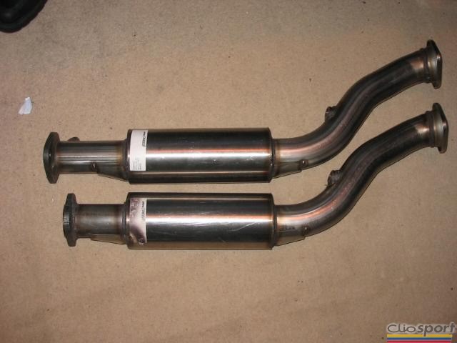

A local garage replaced the catalytic converter on my mk1 172 recently. Mine has the one lambda sensor, while later mk1 172's have two lambda sensors. The garage fitted a two lambda senor cat on mine, which I think is slightly longer as it pushed the whole exhaust system back and mate it rattle and bang. The also cut a hole in the heat shiled to stuff the spare sensor through! Can anyone reassure me that the two sensor cat is slightly longer, and by how much? Cheers, the garage are being buggers and claim that the work done was A1!

It wasn't knocking against the heat shield, some crossmember I think? not too sure as I'm far from technically minded! Day contacted me and said there was a differnece in length and sent a photo. Anyone else know anything????
Gentlemen, lets not stray off the original post. Is the two lambda sensor cat for a mk1 172 longer than the one sensor cat? If so by how much???
Janspeed Decat ~ Mk2 172 pictured top
Janspeed Decat ~ Mk1 172 pictured bottom
