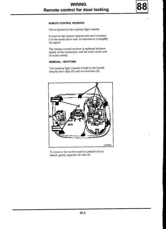

Hi Brian,
It's a year 2000 with no sunroof. Is that likely to have the receiver near the interior light?
Thanks again.
Rob.
  Carrera 4S. Clio 172. M5
Hi Rob,
It is up by the interior light on your car.
I have a diagram for you, but photo bucket is playing up at the moment.
I will post it as soon as I can.
