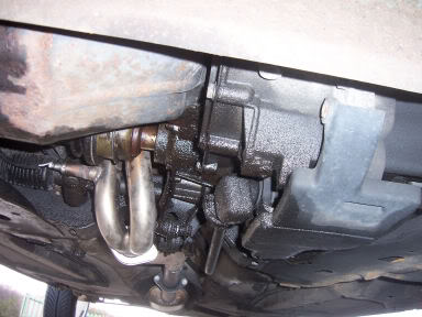

Yea mines a phase 3. You can get them ready made I got a 4-2-1 manifold on mine, just needs fitting correctly as too close to the gear shifter under the car, which im doing wednesday.

Pic of it fitted -
If you go to "Tuning Shop", "Clio 1", "Abgasanlage", "Fächerkrümmer" then scroll down to the one that mentions 1.2/1.4 Eco and thats the one you want I believe

With postage you will be looking at around £300 - £325 depending on postage. With the standard exaust ive noticed an improvement and the revs freeing up more (only other mods on my car are de-cat and k&n panel filter with custom cold air feed pipe) I havent managed to test it properly yet but theres definatly a difference. http://www.zippyvideos.com/8841397224568066/100_0235/
