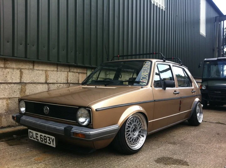

so shes been sat up for a month or so ive just been too busy to sort the suspension, but last night on getting home i just had the urge to get it out.

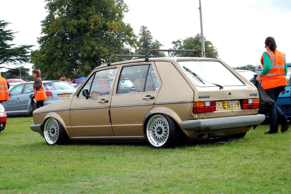

i love mk1's and this is lovely :eek: only thing that i dont like is the way it sits with the wheels looks to 4x4 for me, smaller dish and tuck some wheel and it would be a winner ;) ......like this
  AMV8, Mk1 Golf
I don't like tuck on mk1s where as I agree they are a little large... Finding 14" bbs rs's .... Good luck.

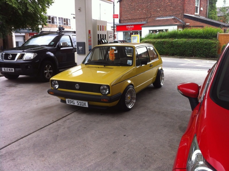

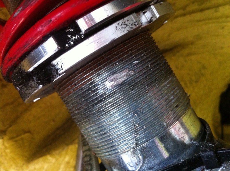

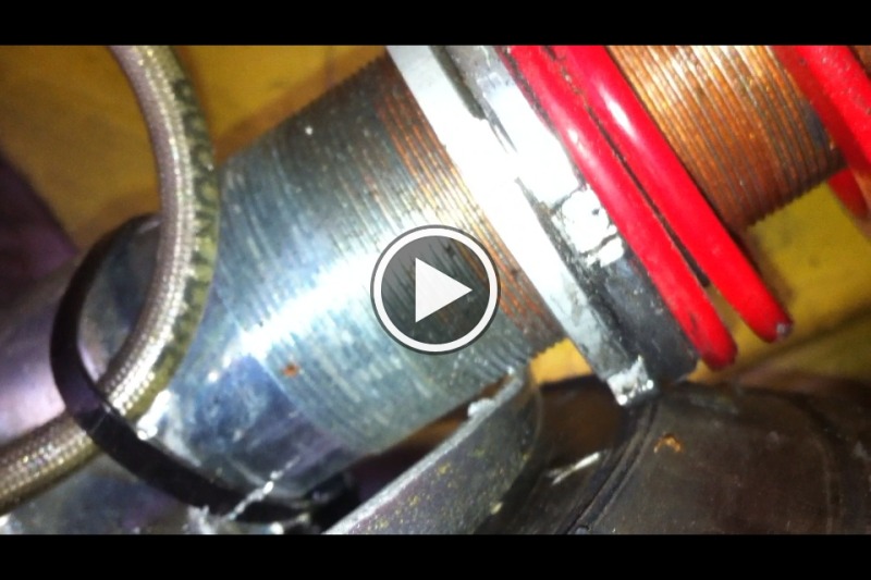

went about sorting the suspension out yesterday so i can drive it on the road.. rather than just on my drive haha

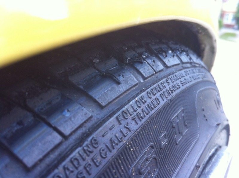

the front n/s had more camber for some reason and the inside of the wheel was toutching the coilover
and in turn the ajuster ring had been gazing the inner edge of the tyre
wee swist of the camber bolt and all was sorted on the fronts.

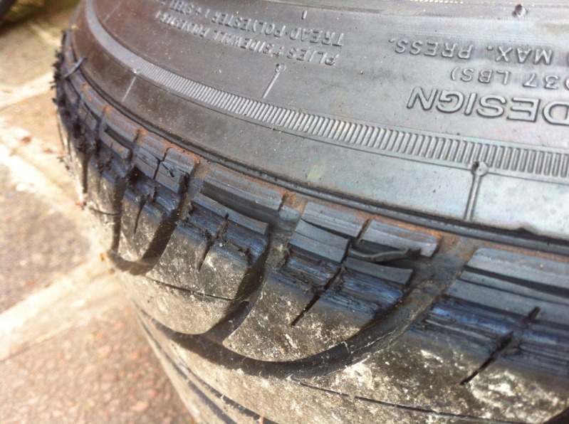

The rears had eaten the tyres after about half a mile
FML
raised the rear so had some clearance
actually int new looks better as its not squatting so much...

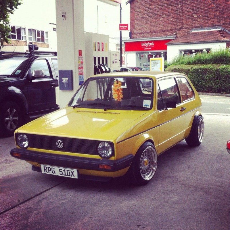

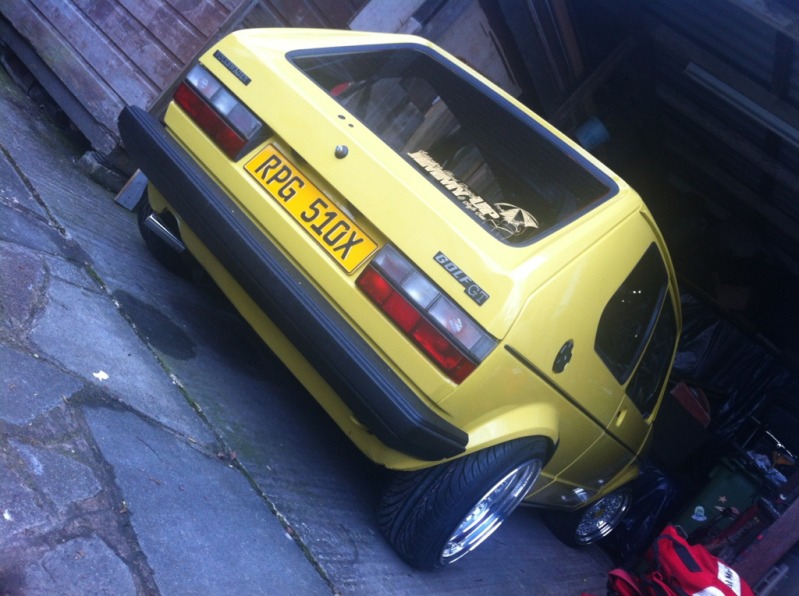

then it was time for its 1st propper functioning drive with the new wheels
amazing ... love it.. gets some propper funny looks
its actually OK to drive, as much as a 32 year old car can be i guess, very different to the A1 though. its not that quick at all but it still needs to be set up to get the best from it... but it drives ok and can do 50ish no problems.
