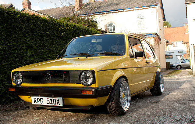

thanks for this kind comments guys, like i say still a few bits to do, but asthetically its pretty much there :D
lol thanks, got to say i do really love it, just want to sort out the height of the front, only needs about 10mm or so, i did drop it on that side about 20mm further already, but not quite enough it seems, and do the other side, still loads left to go on the coilovers so no problems there.
I'll echo everyone else. Looks great.
Genuine BBS RS? Must have cost a few pennies.
Nah reps, just fake bolts.
hahah not really , yeah genuine. Also a very rare set, originally off a renault Alpine GT, one of 25 sets ever made apparently.
well if your going to do something you may as well do it properly eh. were in a right state when i bought them too.
As said on Facey, I want to make a sex with it. Get the front height tweaked for pure perfection! Look forward to seeing it at some shows this year.

silly question, but is the front tyre the right way around? Love the car too!
not about this weekend but im going to spend next sat working on the suspension levels, then the following weekend the exhaust :D
if you were keen enough to notice the tyres were you keen enough to notice it still has steel wheels on the other side? haha, like ive said it was just to check fitment and ajustments needed.

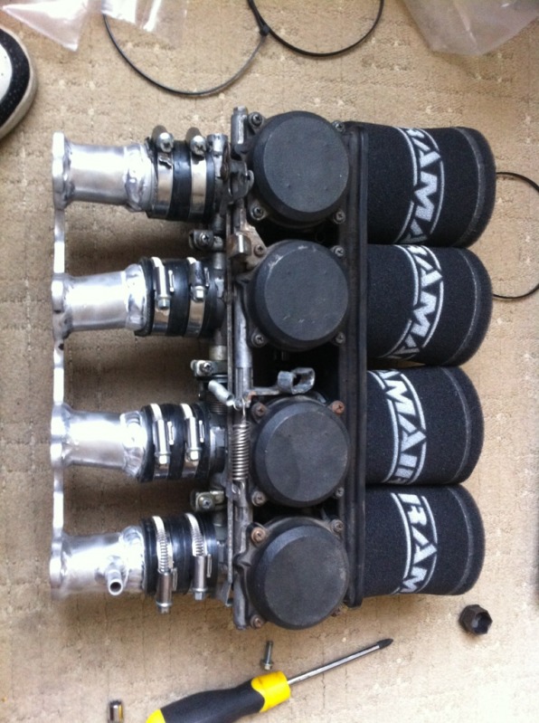

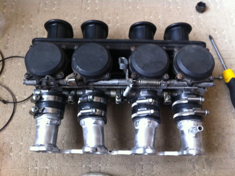

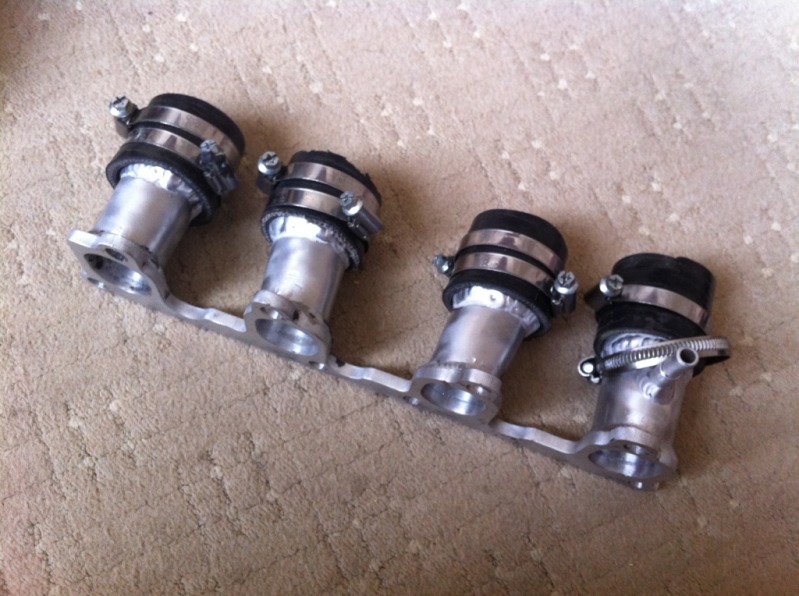

by the time the new manifold arrived it was too late to put it on so sat was spent on the monifold, re working the throttle cable mounting and fuel lines.
so very happy with the results.

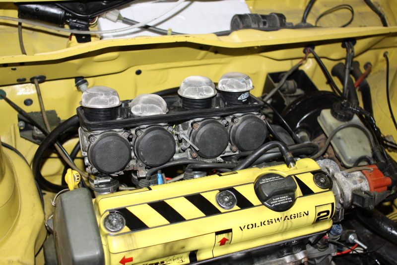

remember how it was before?
terrible... angle is completely wrong, the angle of the engine hadnt been taken into consideration which ment i had to run a nasty intake design.

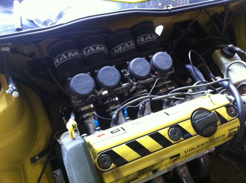

but now....
with the propper trumpets fitted
and filters
actually looking what they should look like!! :D

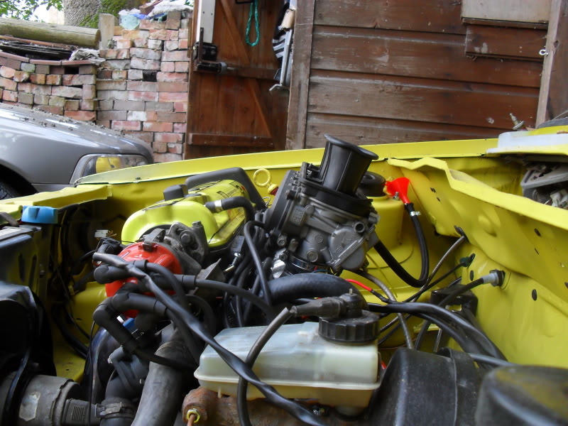

and finally ....
i do have a video of its 1st drive... but no idea how to get it on here. Its amazing, unfortunately the cabs now put too much strain on the hoses holding them on and they work loose so need to fabricate a bracket to support them now.

well ive ordered some new samco hose, although it feels softer im hoping it wound go as malubal sp* when its warm?
Shouldn't go soft if it's samco.... Though a carb is pretty heavy... Hang on a min.... You know you can't use silicone hose there don't u?? The carb is injecting fuel through the hose.... Which isn't fuel safe it will melt and peel off and go in ur engine and make the hoses fold and collapse
