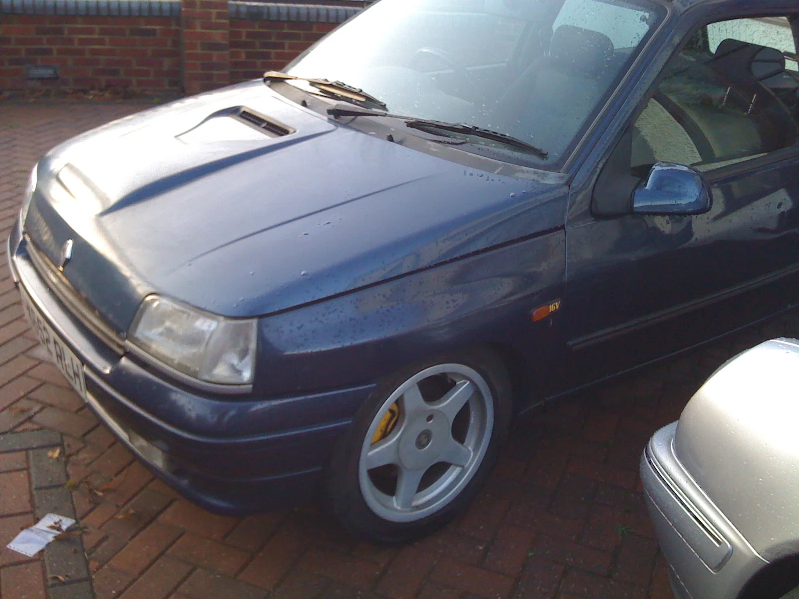

Been thinking if this is a good idea or not... hopefully i can keep updating it!
so currently own a 1.4RT thanks mainly to my dad its a very reliable car its very tidy too, had it re-sprayed a year back..anyway saw this valver for cheap and decided to do the mad thing...buy it and give the old one to my little bro.
collected it last night...on pulling up realised the mammoth task ahead in-terms of body work..surface rust..its rainbow blue...its messed up!
tried to start...doh no battery power no worries power started it and off we went to the petrol station. filled it up checked levels and tyre pressures and set off on the 50 mile trrip home...
never been so demotivated in my life! suddenly realised there was ALOT of work infront of me lol.
so plan is to get it running as it should and get all the interior bits functioning.

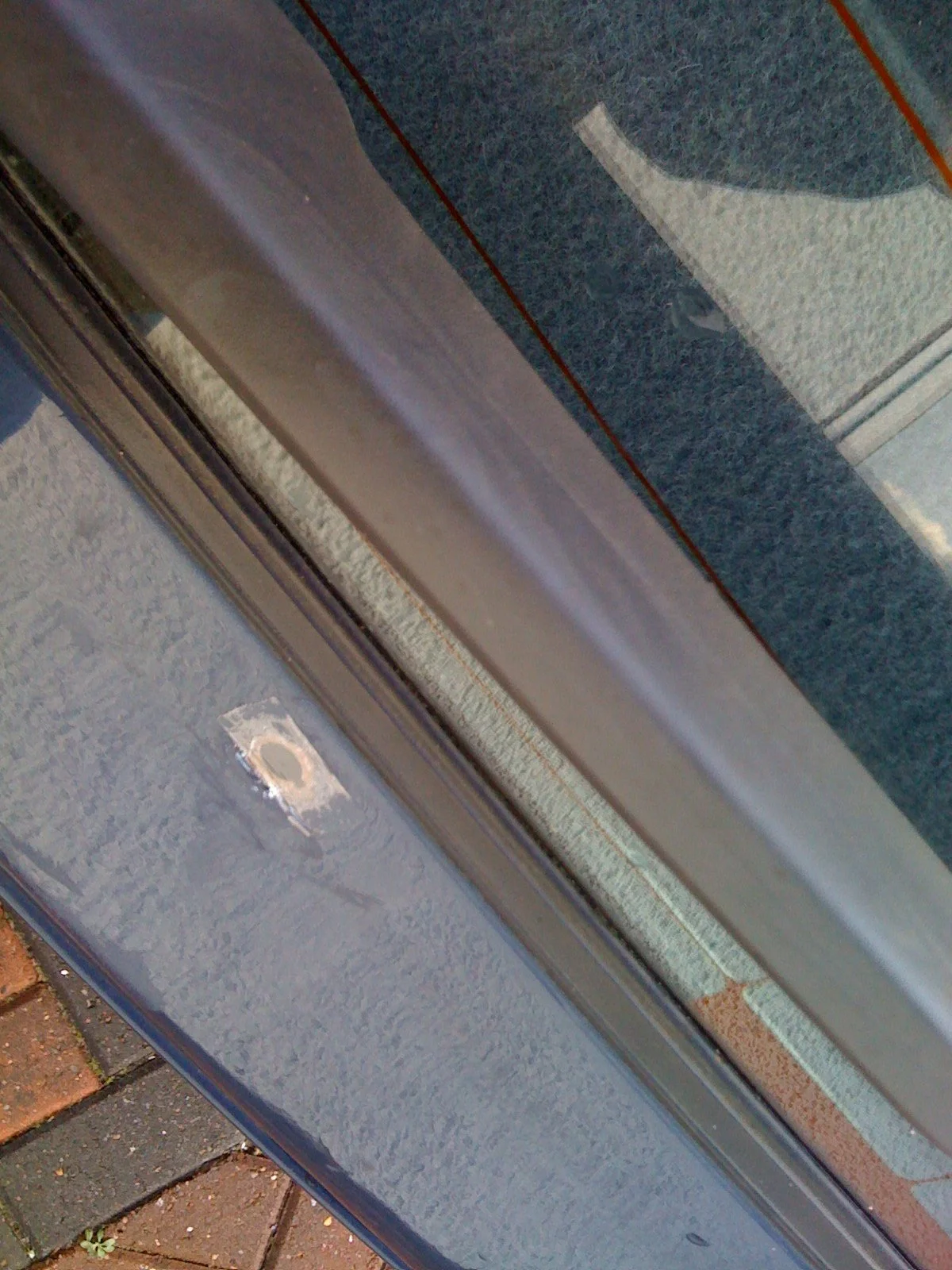

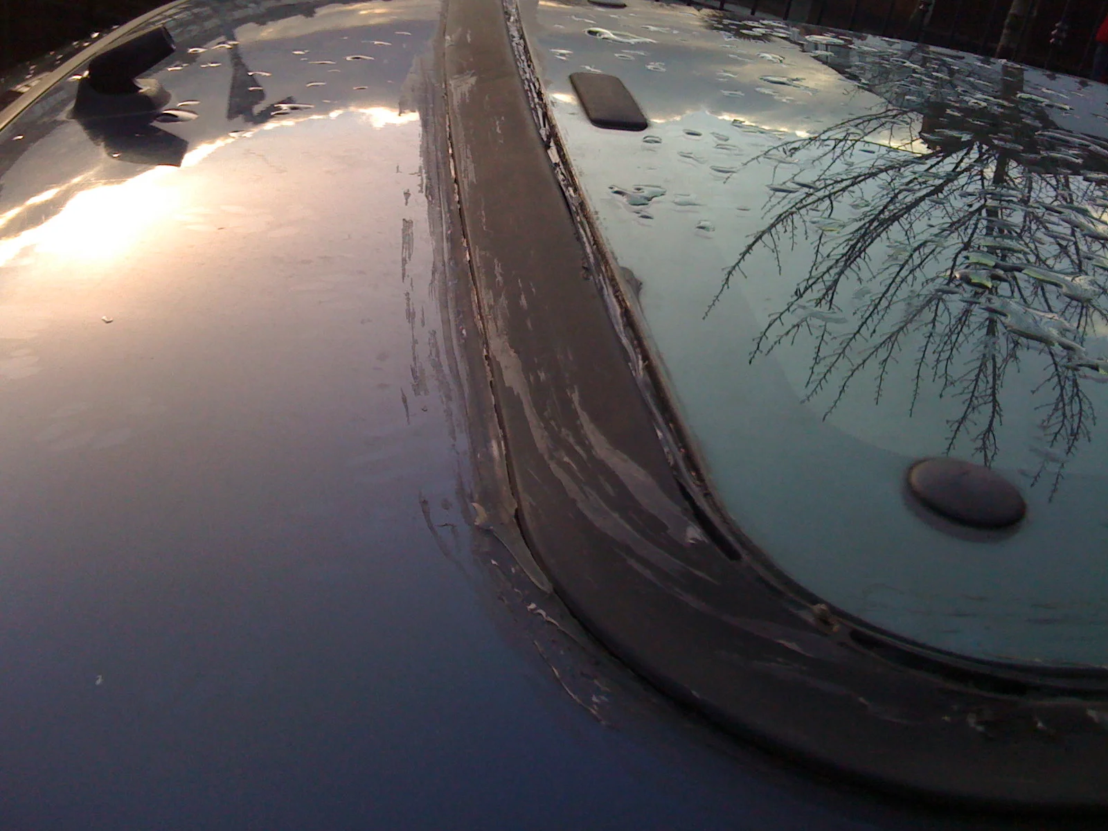

Stop sunroof leak

sunroof is almost impossible to stop leaking lol.

see williamsclio.co.uk guides for the sunroof. It is a mission. as good as the WHOLE interior out and roof lining
Try replacing the ariel 1st ;) is it a ph1 or 2?
Mine leaked loads, turns out it was the seal on the base of the ariel was fcuked. £12 from renault ;)
If yours is a ph1 with the square ariel base then it probably is the sunroof thats leaking

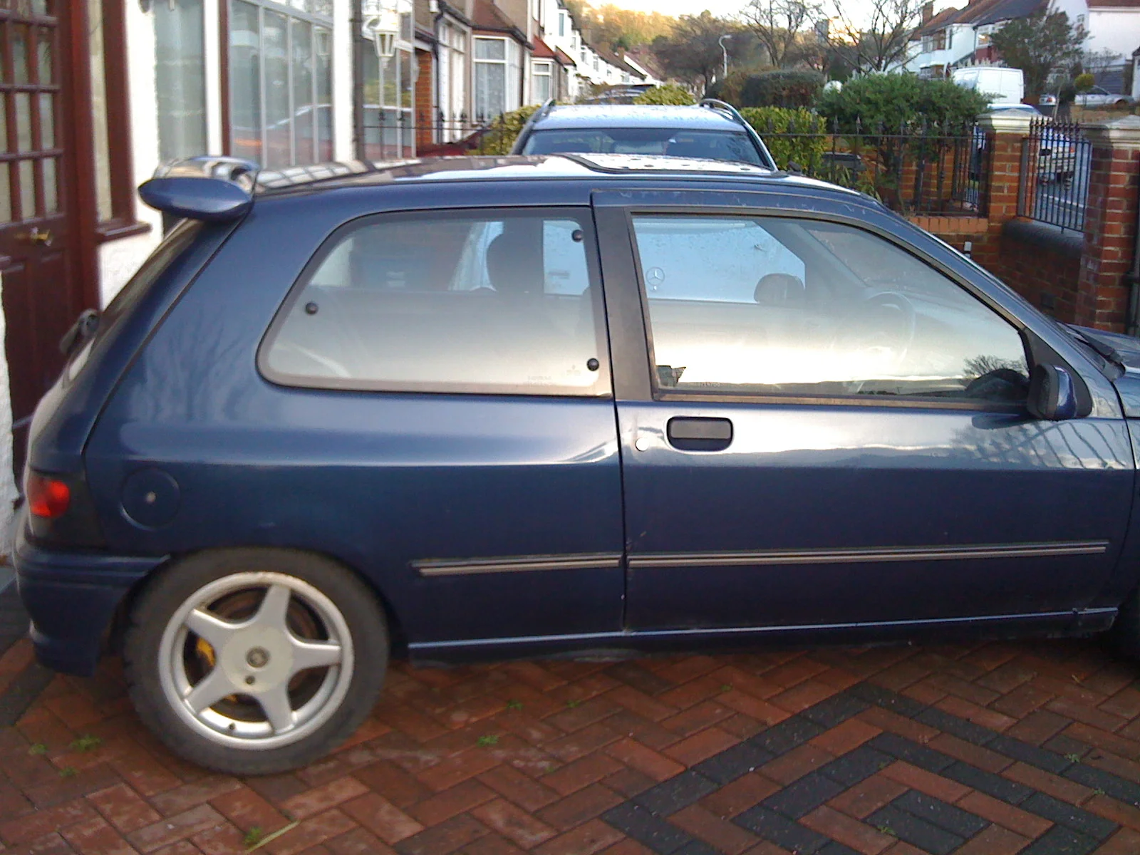

the paint is appalling i have never seen anything so bad all the laquer is peeling off. so dad said we will have to get a full re-spray when its done.
now it has willy wings...i want willy widetrack lol...ill need to change the shocks so im thinking about it..so if anyone is selling the bits give me a price :) also needing some recommendations for coilies...might as well do it one time and done with it.can i use valver coiles on the willy widetrack?

OTT on the sealant TBH and it still leaks!
Gash Spoiler
the spoiler was attatched with woodscrews and no thought was put into the process end result it the bootlid is pretty rotten so after another one.
