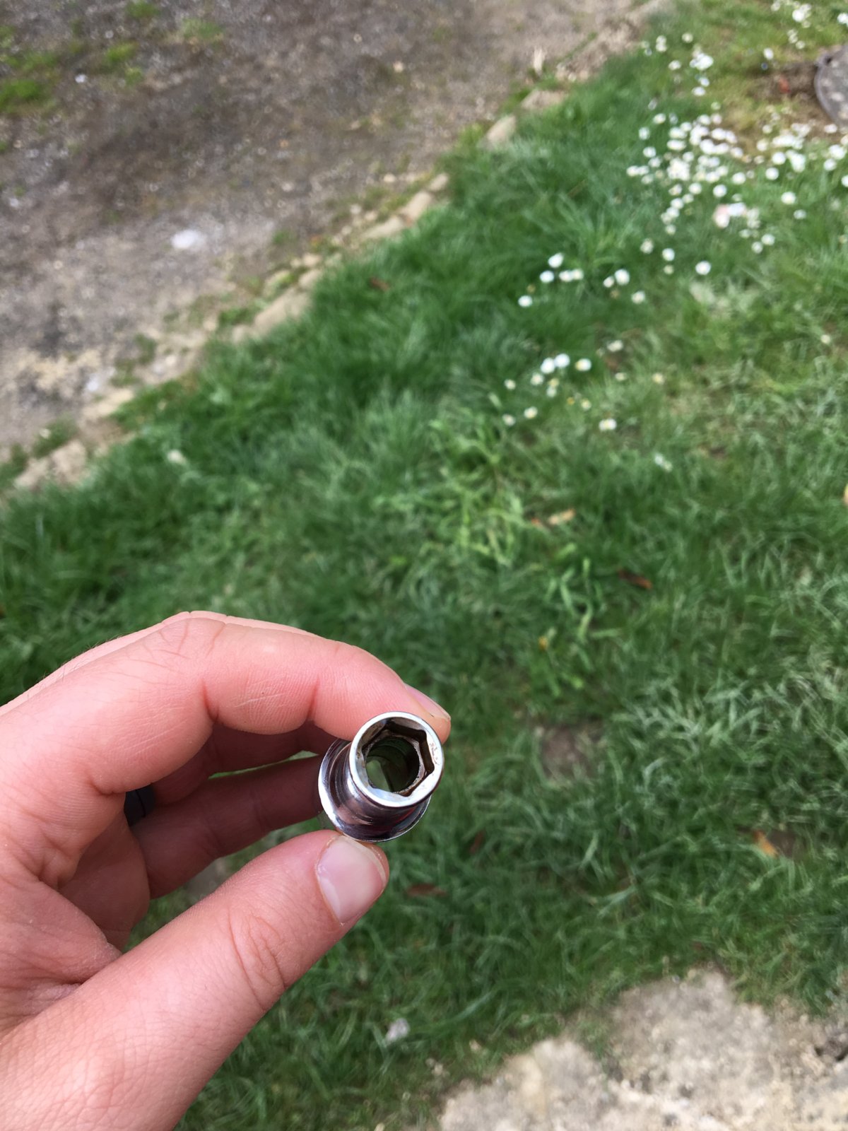

2 rounded locking wheel nuts greeted me.! ?? spent 2 hours getting them off..! Finally got them off and made a start on the brakes. Discs and pads off, and then I realise ECP have given me the wrong brake pads. So another delay there, having to use another car to go and get them.

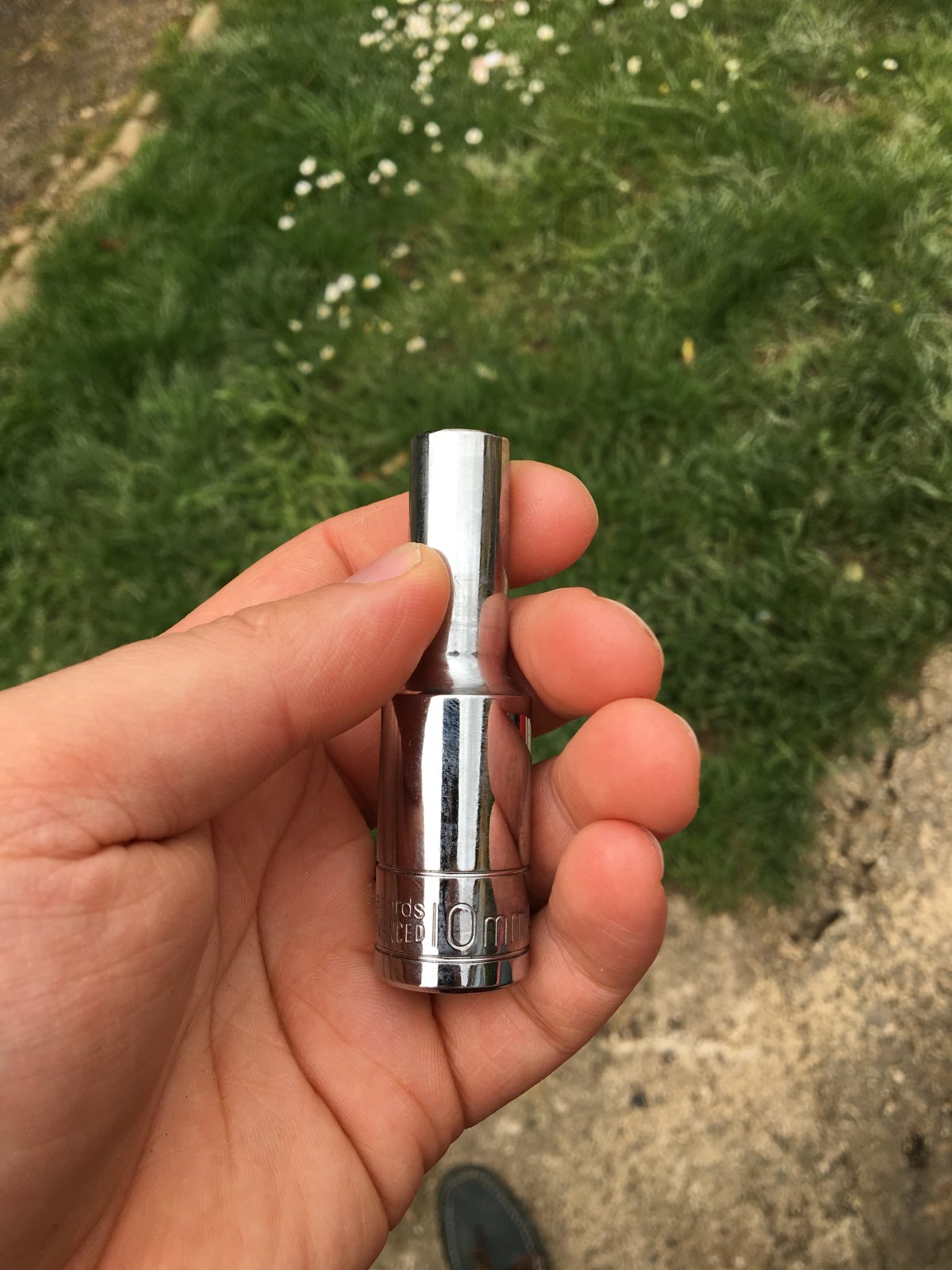

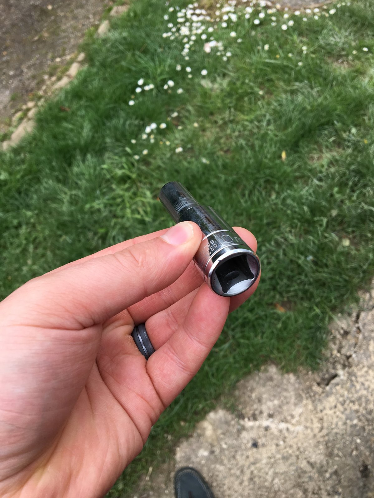

Need to do the glowplugs on my dci as its a bit moody on idle when cold, what socket did you use to do yours, as i believe they need a thin wall deep drive socket
Sound i already have the deep drive set from Halfords so should be ok. Not looking forward to it tbh, if any snap its hassle :cautious:
Just spray plenty of WD40 around the glow plugs the day before, then take them out while the engine is hot - I was worried, but mine came straight out without fuss.

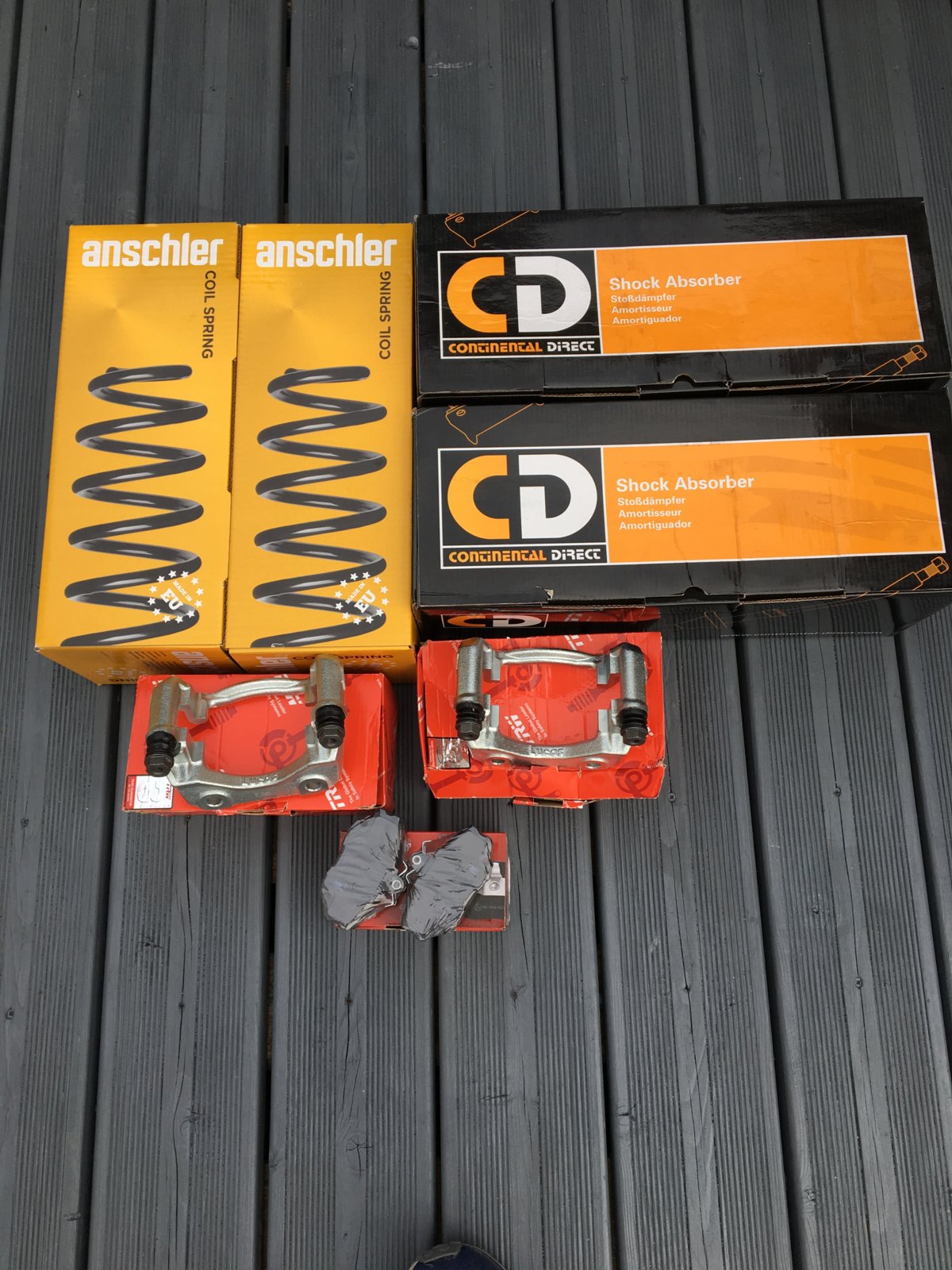

I took @Brigsy ’s advice and bought the eBay shocks on offer. Unreal how cheap parts are for these Clio’s
I think it’s less than £100 on all these parts..
Discs and pads on the car are fairly recent, but the passenger side caliper has been sticking - so new pads going on with the new sliders for peace of mind. £15 for new pads ?
