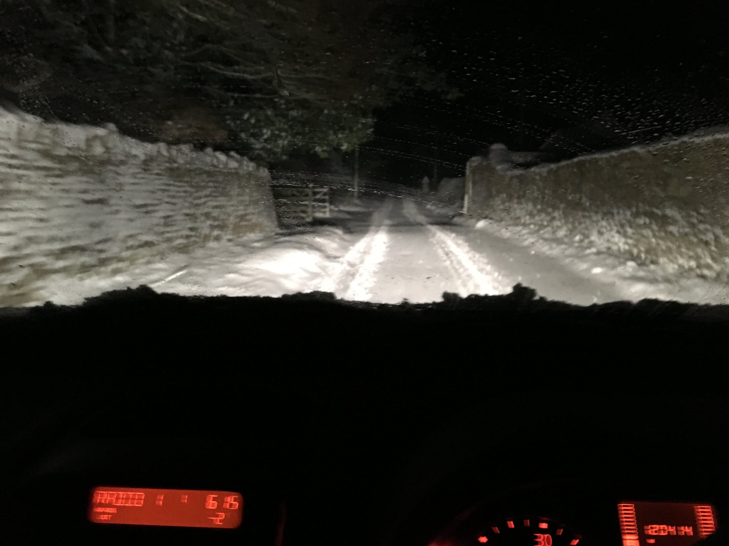

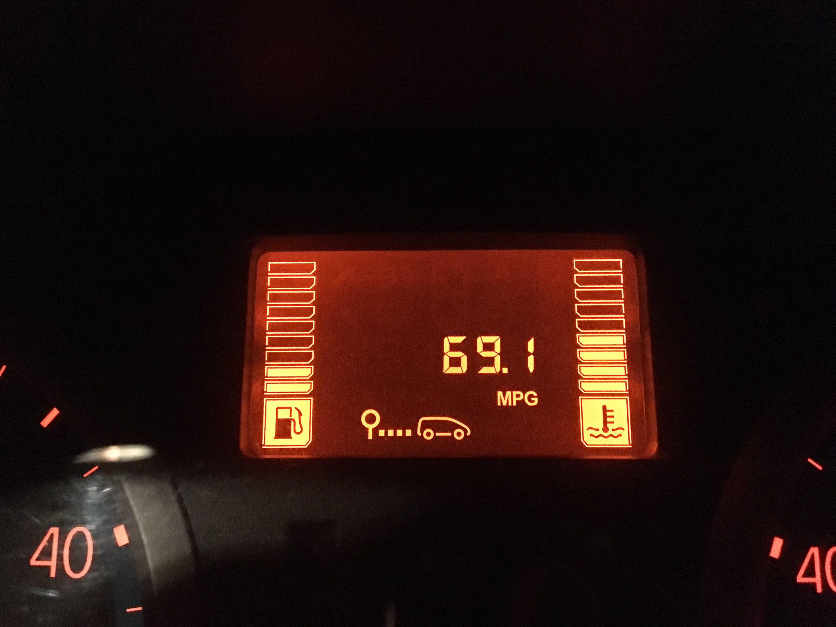

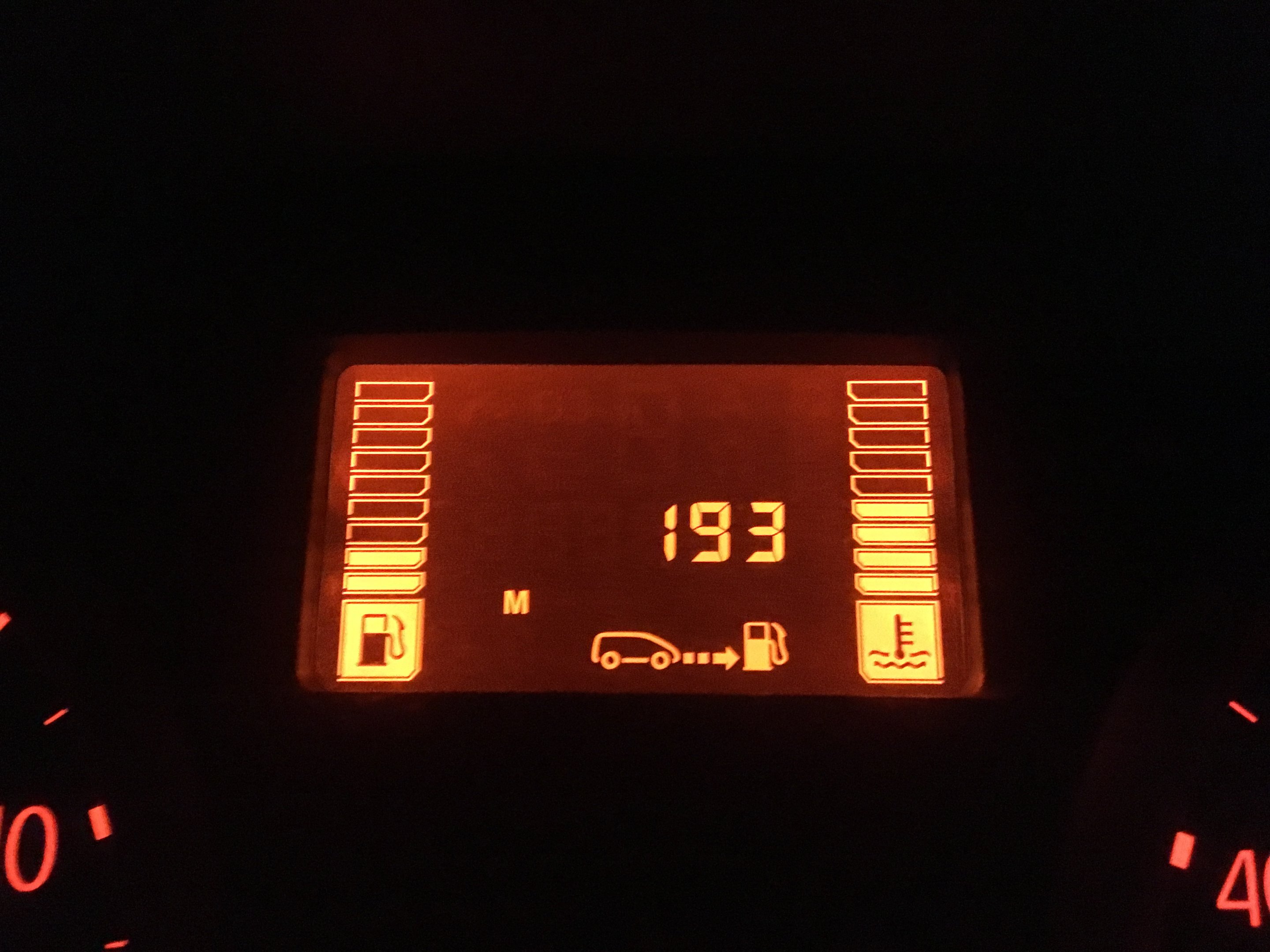

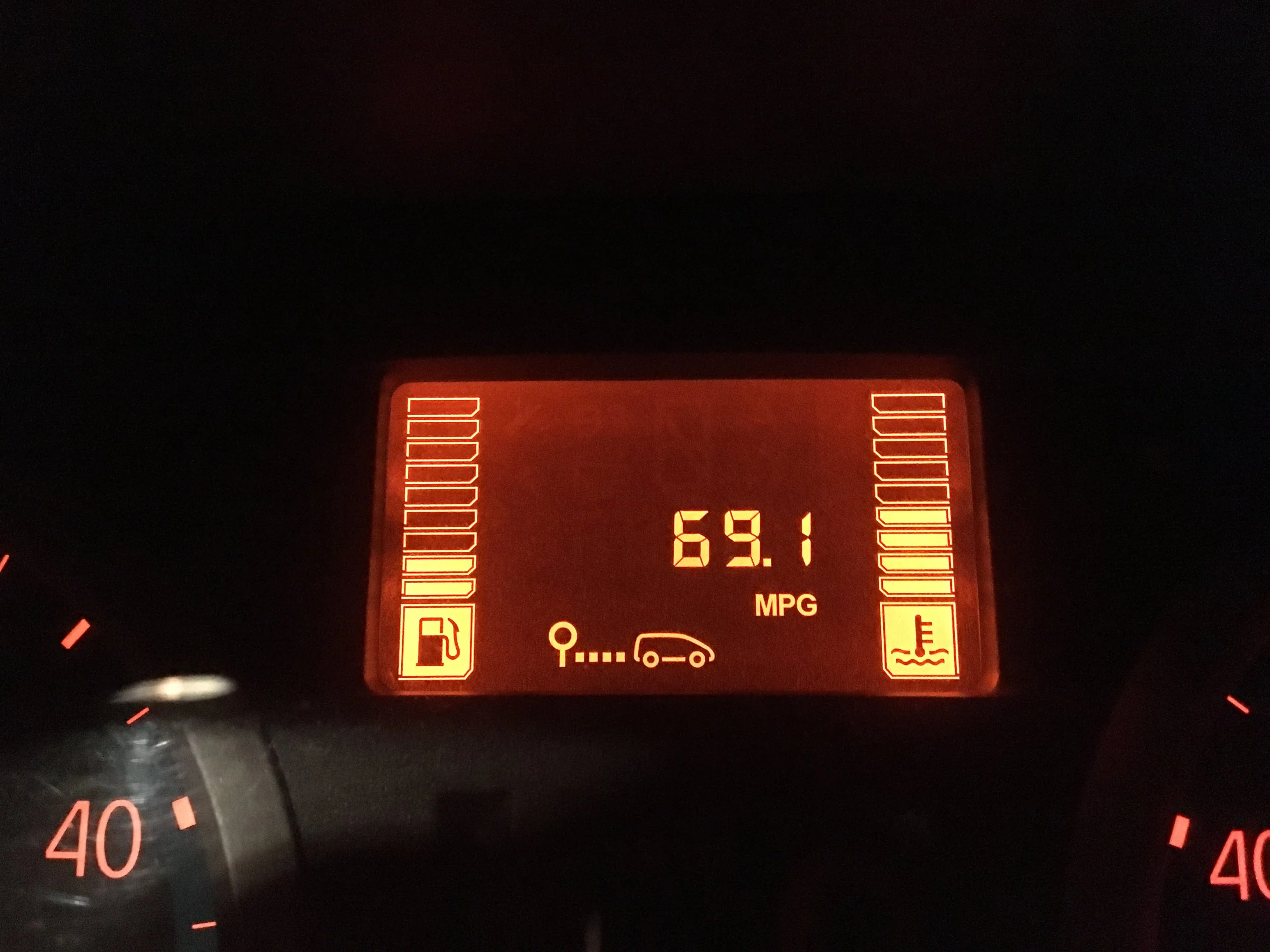

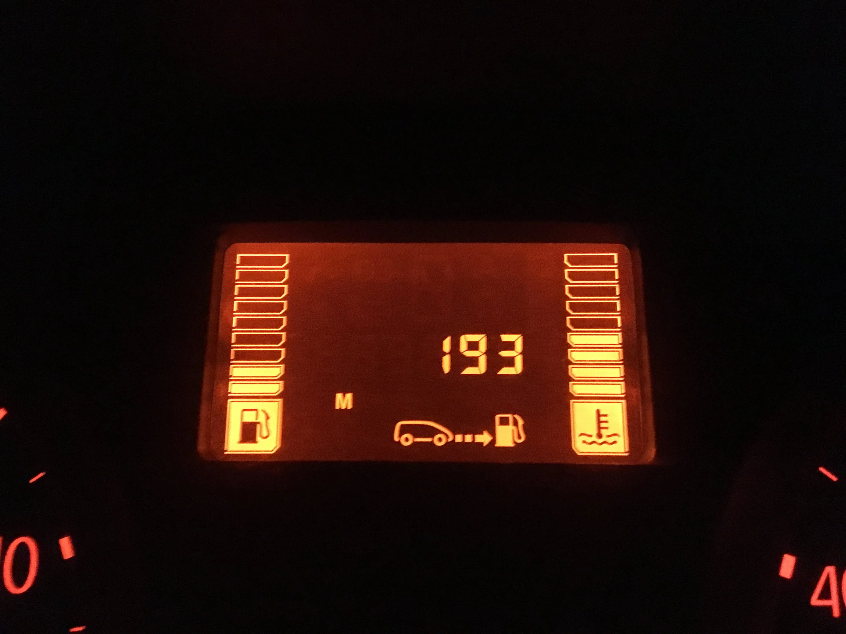

I took the car for a little spin tonight, to test it a little more. Very surprised at the figures.

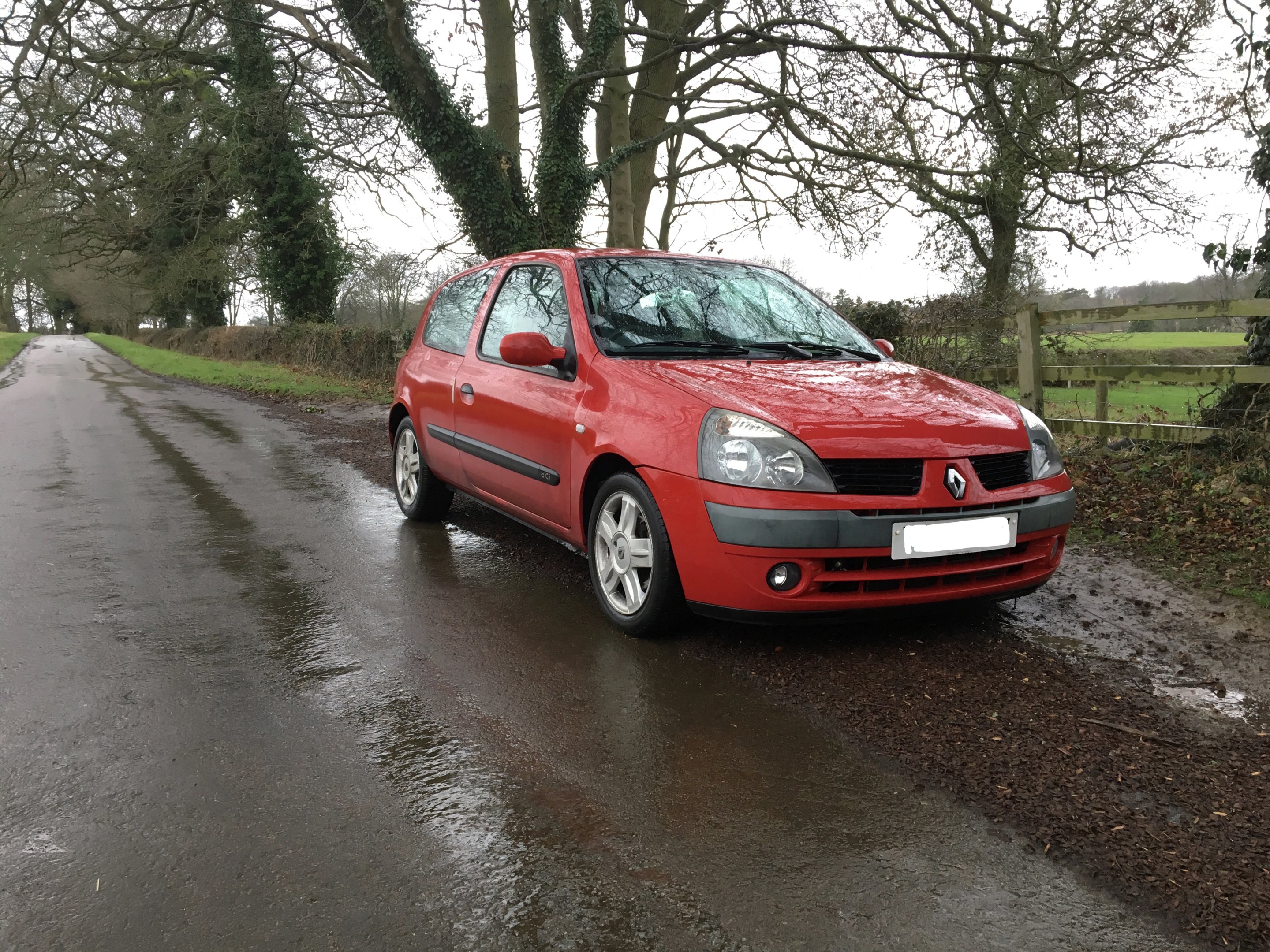

Just a little update,

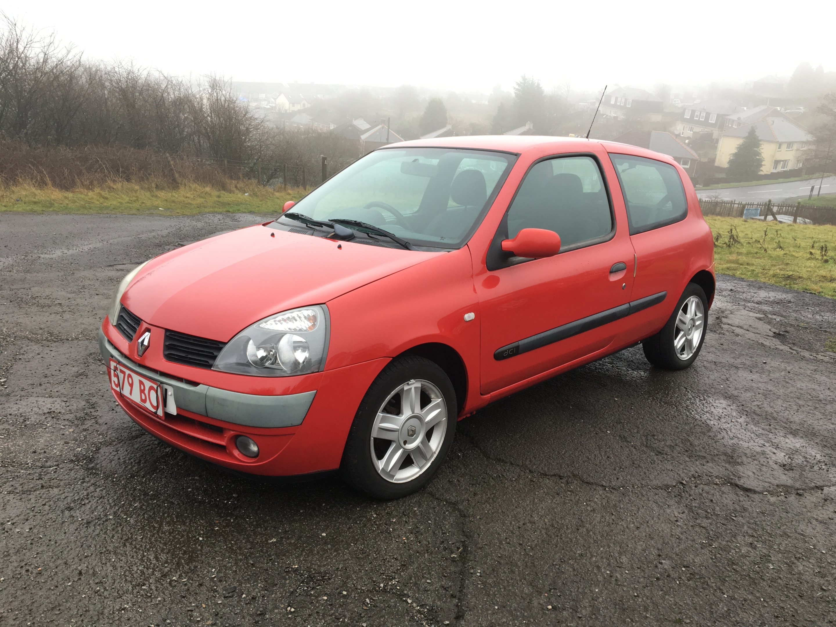

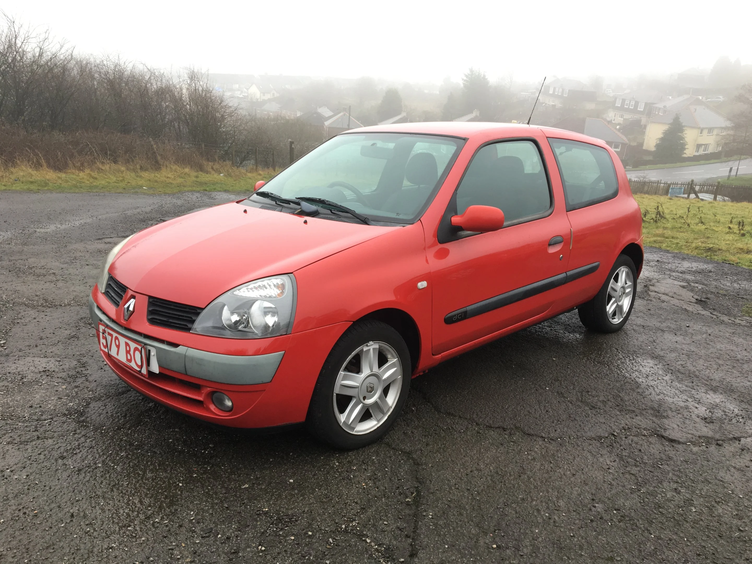

This is the first proper picture I’ve taken of the car. No idea why I even stopped to take the picture! It’s just a DCi...
I feel like my interest in cars is slowly returning and it’s my ‘petrol(diesel) head’ creeping back out, now I’m starting to have more spare time again.
Anyway...
she’s now on 119,500 miles. I still haven’t cleaned it inside or out. I’m glad the previous owner kept it tidy.

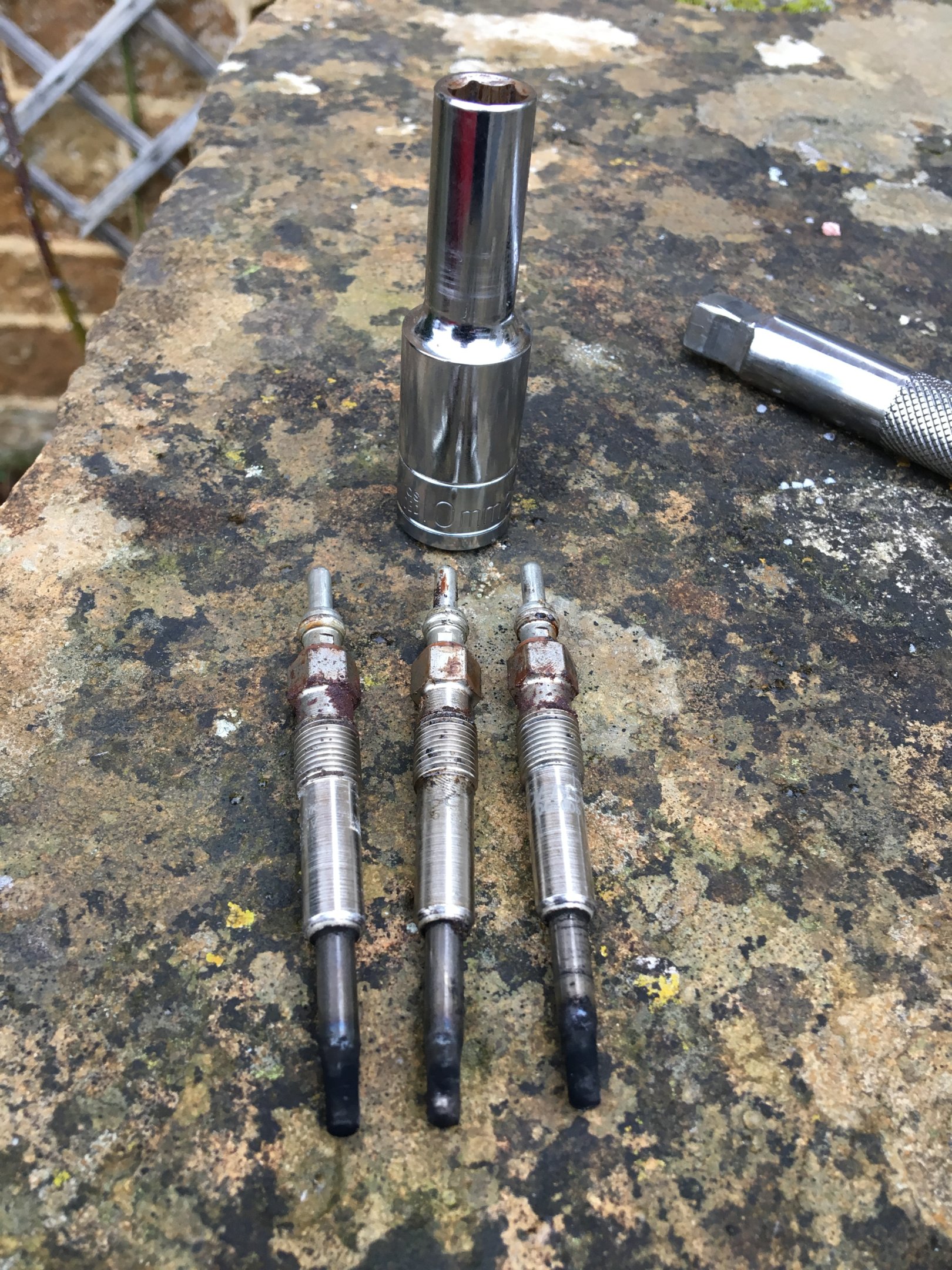

Finally got around to changing the glow plugs! I didn’t have a tool in my Halfords tool box that would reach over the glow plug, so I have bought a 10mm long reach halford socket and it’s done the trick.
The job took less than 10 minutes and it was a doddle with the engine run up to temp, the glow plugs removed without much fuss.
Now, they look quite grubby, so im hoping a full set of genuine Bosch ones will cure my initial slow cold start! Fingers crossed ?. They were Denso glow plugs that I removed, so I guess they have actually been changed in the cars lifetime.

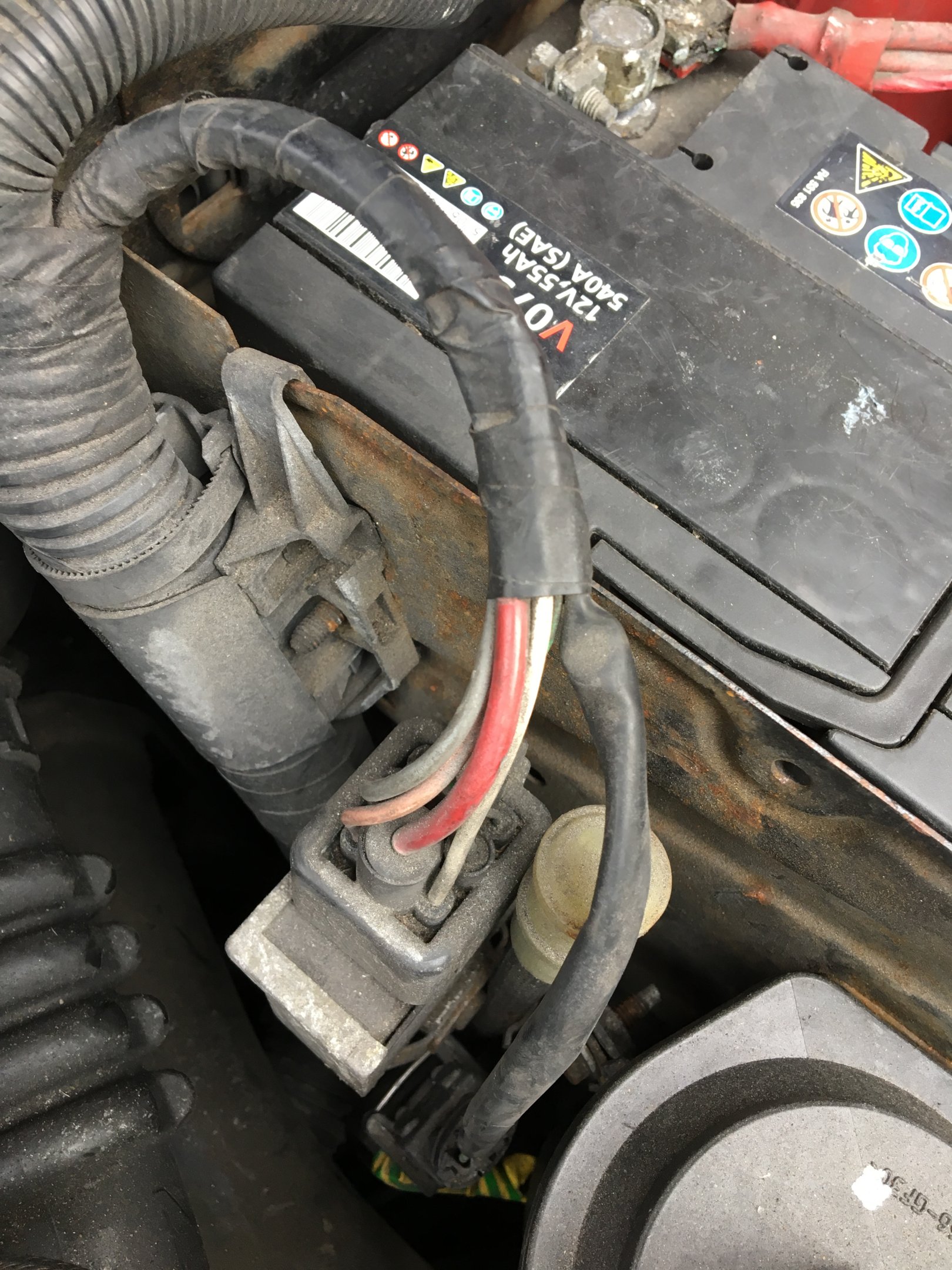

The battery and STOP light has been flickering over bumpy roads..
A quick look and it seems the battery wasn’t even clamped down or tight, luckily the clamp was still there.

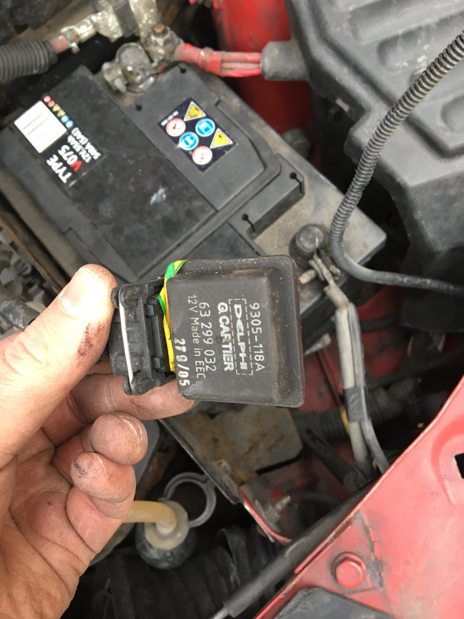

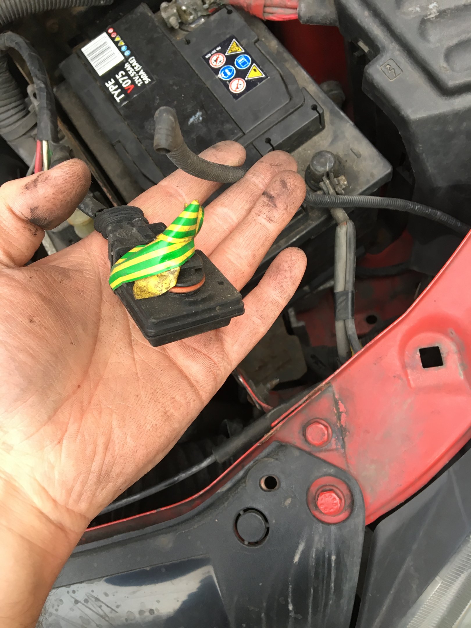

On investigation though, there’s a plug that’s been taped up and a vaccume pipe of some sort left off.
There’s no lights on the dash and the car drives perfect. So does anyone have any ideas? I thought it might be some kind of eBay chip ??‍♂️ But it’s labelled with Delphi.
gez 172
  Defender 110
That's a temp sensor for the fuel filter iirc. Can only be used with Delphi filters obvs lol
Can you expand on this for me please buddy? ? should it be plugged into the fuel filter then? Should I have issues with it in this state with tape over it? Lol
I didn’t take the tape off, just in case I caused an issue.
YorkshireKyle
Not all gingers stink of piss. But I do.
They're not on every model but I'm sure it just clips into the fuel filter underneath, I'm sure they detect water in the filter too. At least that's what I'm led to believe, I never had mine flag up for water in the filter I just drained it after every 6k service and primed it back up haha
gez 172
  Defender 110
I’m wondering why it’s been taken out?
Broken clip?
gez 172
  Defender 110
They probably went into EuroCarWank and bought the cheapest filter for that Reg and just stuck it on not realising what it's for? I thought only the MK3 and Modus/Megane had the sensor on the filter. @HMS Derv Destroyer you seen this before on a MK2?
Ohhhh..! I see what you mean now.
I’ll check the fuel filter then and get a new one if there’s no sensor plug on this one.
At least I have a good starting point now to investigate ??.
YorkshireKyle
If it starts and there's no light on the dash I'd cover it in cling film (not earth sparky tape!) and keep it how it is lol
If you get a fuel filter in future get a Genuine Delphi one as others will only give you headaches??
gez 172
  Defender 110
This is what I’ve thought too, if it’s not caused any issues so far, then I’ll just leave it and make the plug more secure.
