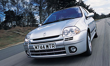

ALSO... id quite like to put these headlights on mine.. will they fit? if so.. how much am i looking at second hand? thanks guys.

The headlights are called dual optic headlights and there is a good guide in the guides section.
Yes they fit. You'll have to split the earth when routing wires from the H4 connector, other than that it's plug 'n' play, and put a fuse in a slot on the fusebox to keep the dipped headlights on when using full beam. There's a full guide for CS Members.
Prices for a second hand set of Dual Optic headlights is ~£60.
