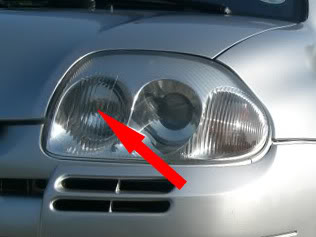

This is what illuminates when I turn my regular dipped beam headlights

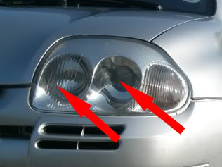

This is what illuminates when I flash the high beams (as if you were letting someone go)

The dome shaped lense is your normal beam, the one on the left of the picture is your full beam/dipped, on mine when I flash my lights the normal beam stays on aswell as the full beam, when I click full beam fully on, normal beam comes off, hope that clears a lilttle bit up?
Yeah cheers it does a bit, I thought I had most of it right now, only thing you and I both have wrong now couzens is that the normal beam is going off, in the guide it says that there is a fuse to stop this from happening which can be fitted to all clios, although this is not the case and it seems most do not have thhe space for it.
