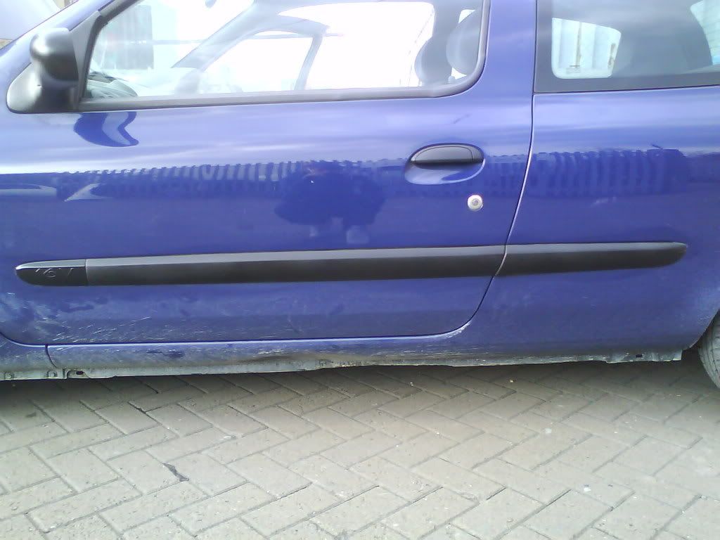

Probably an easy one for you here, can the door side strips from a mk2 ph2 clio be used on the mk2 ph1 clio doors?
I think the ph2 ones look smarter (engine size badge at the front of side strip rather than a few inches back).
Is this and easy job to swap them? Can they fit straight onto the mk2 ph1 doors? Any help much appreciated!

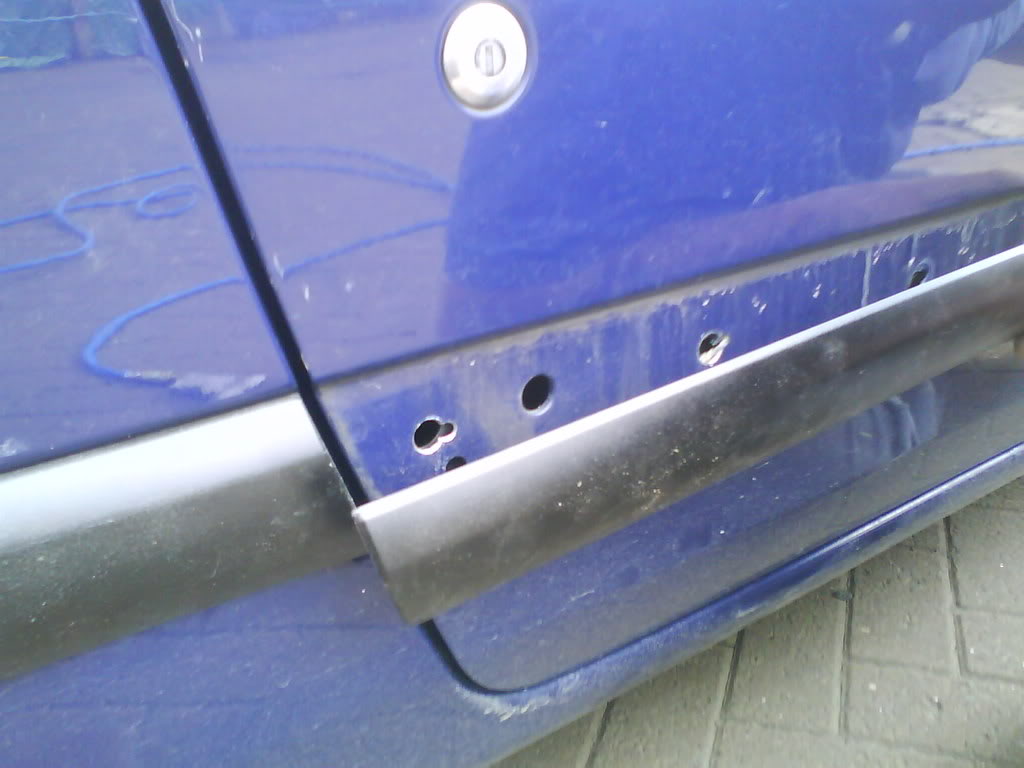

yes but i think it depends on the age of your ph1, as some require you to drill new holes or make the holes bigger for the strips to fit
They're not interchangable on pre 2000 models iirc.

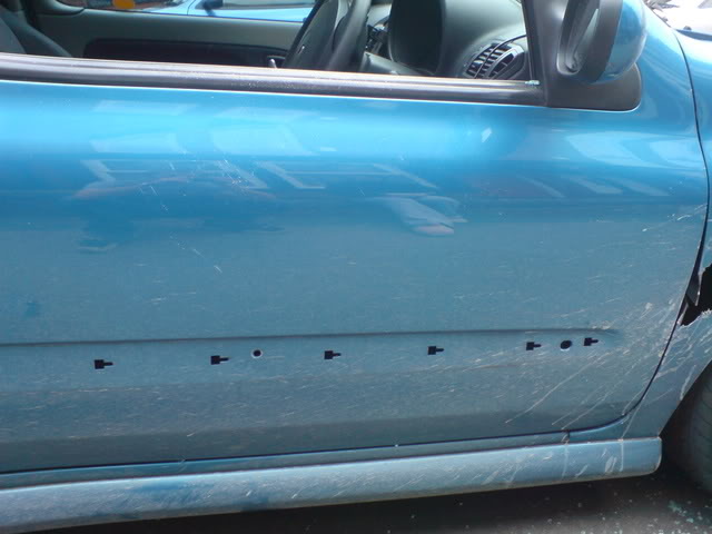

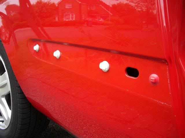

Take your strip off and if looks like this
rather than this
you'll struggle.
