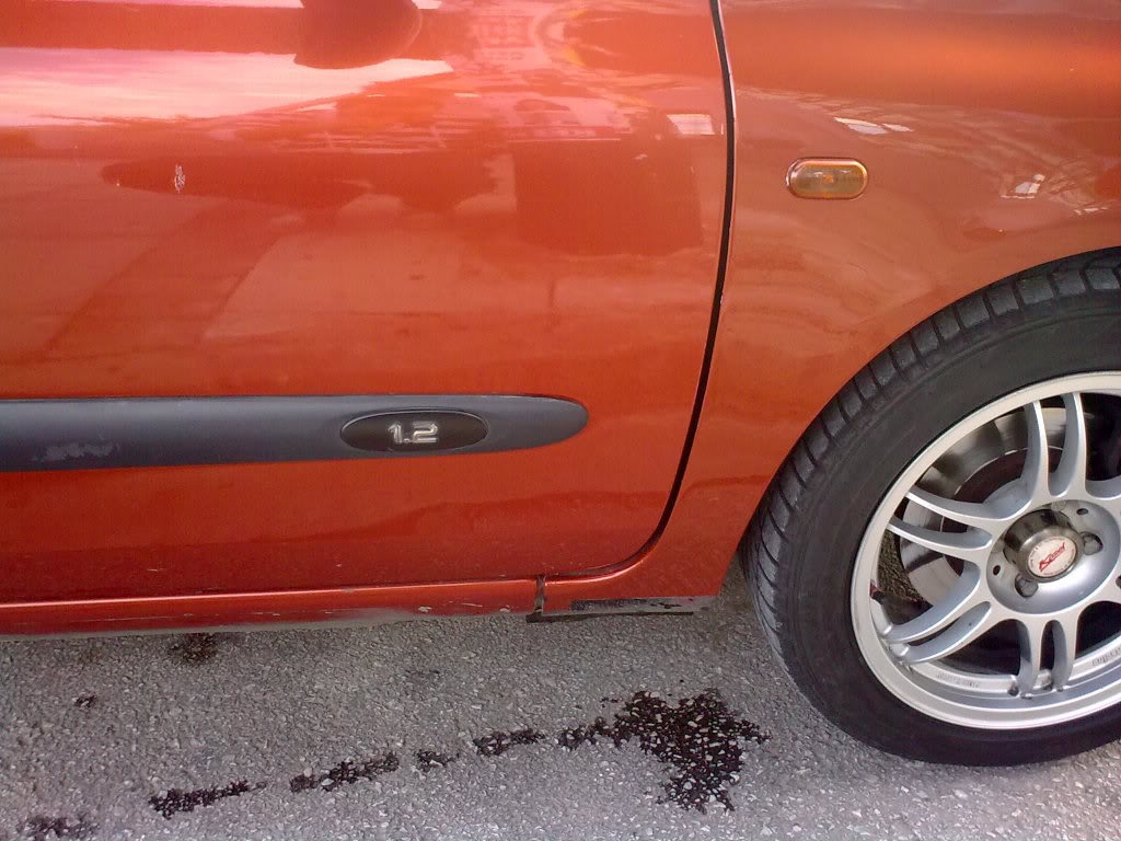

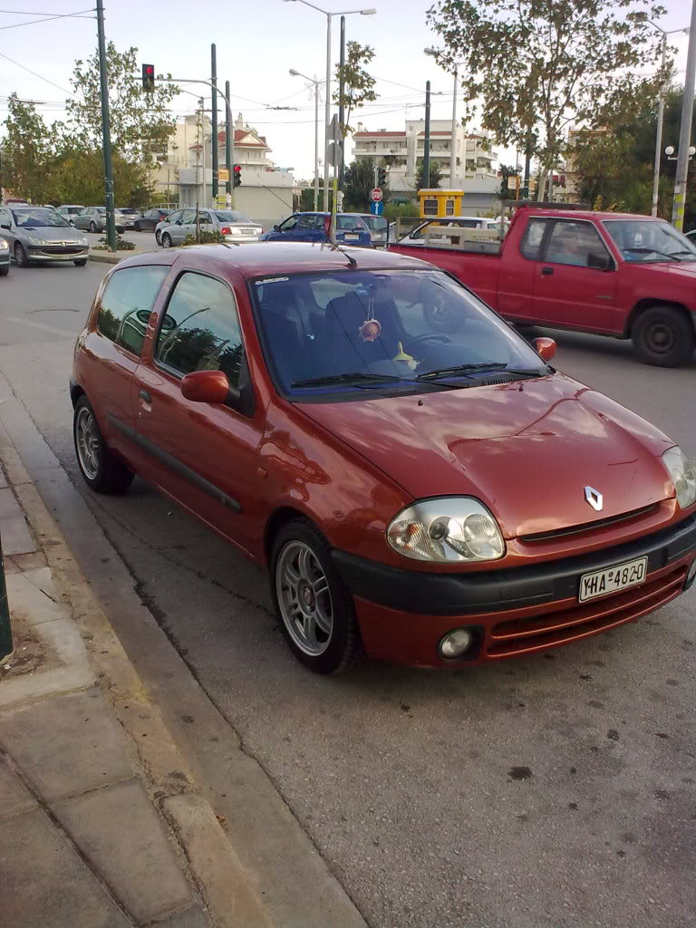

This is -almost- it's very first shape, when I laid my hands on it

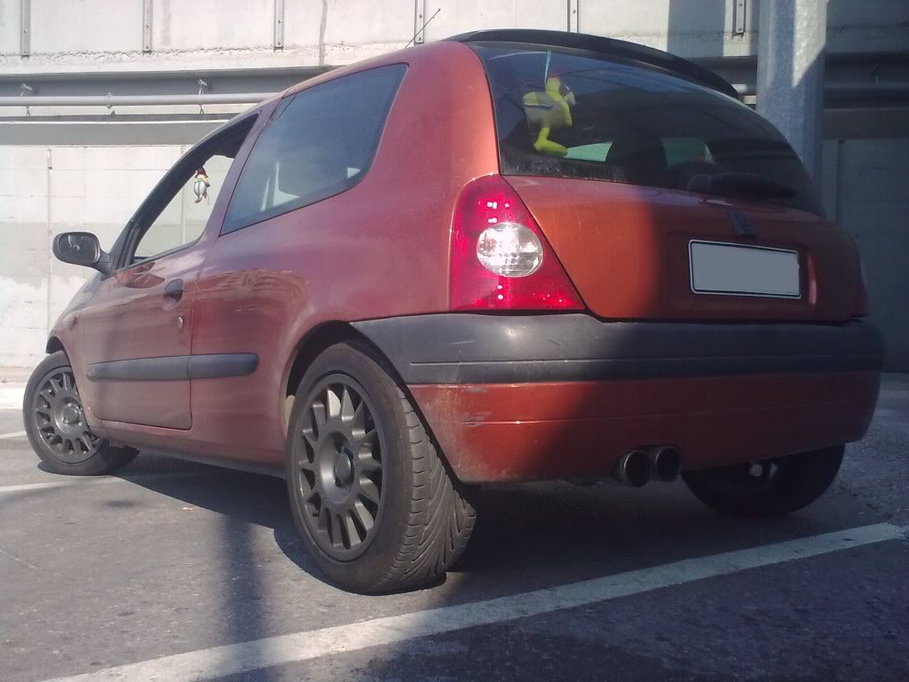

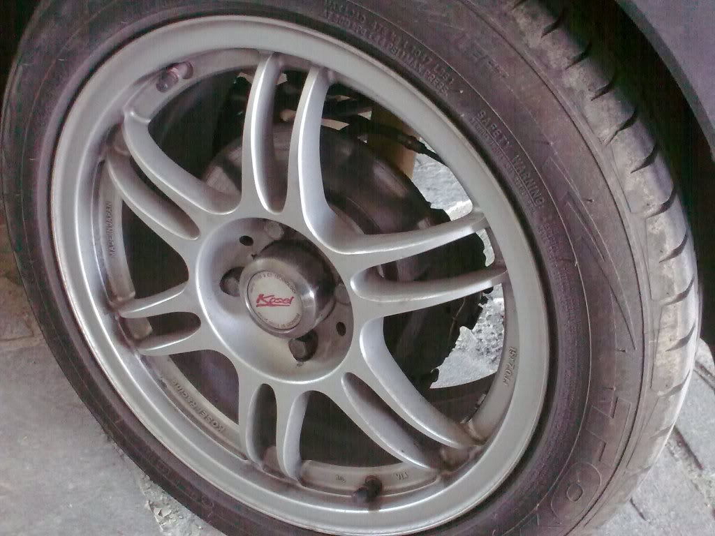

MATRIX 15'' wheels (lol), no other external mods. The wheels did look a bit good, and they were heavy as hell, good thing when you're driving in Greece.

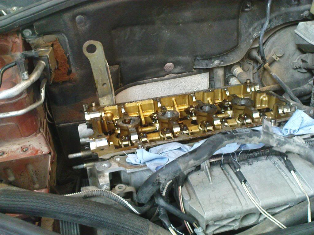

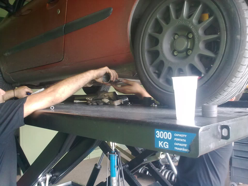

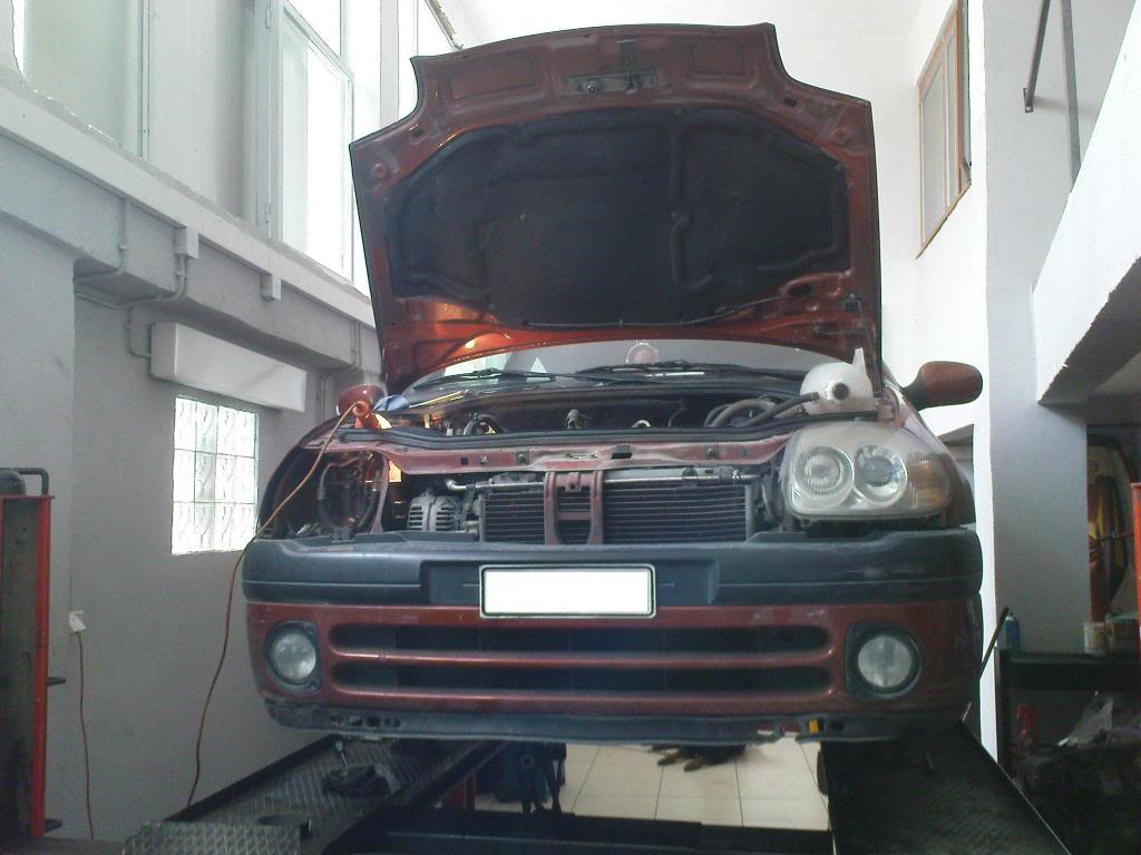

In the workshop, fitting SCHRICK 244 cams the throttle body from the 172, Bilstein+Eibach suspension, Supersprint exhaust manifold and Americat 300dpi catalytic converter.
No mods to the head, so far. I'm up to fitting ITB's when I have the money and time to do so...

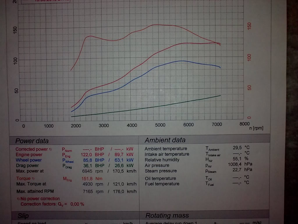

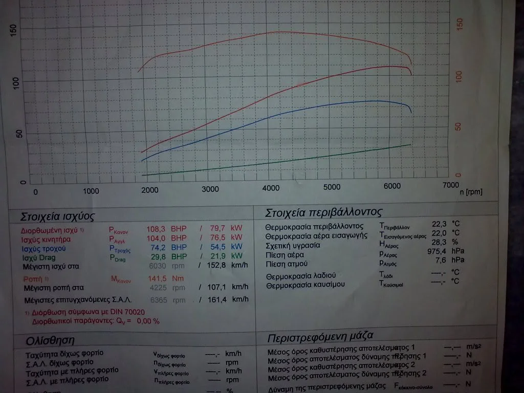

before/after dyno. Two different dynos. Although the increase in horsepower seems not much, on the road it was like unleashing hell.

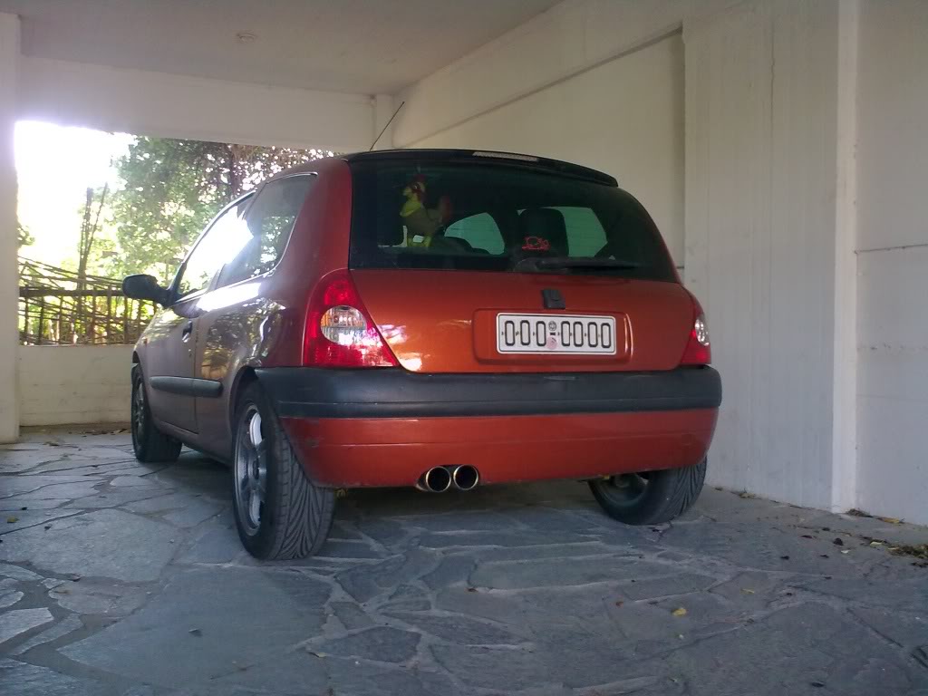

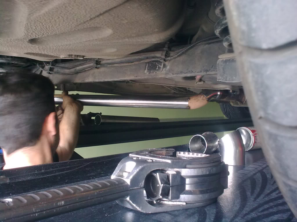

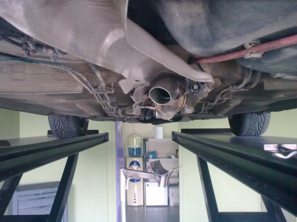

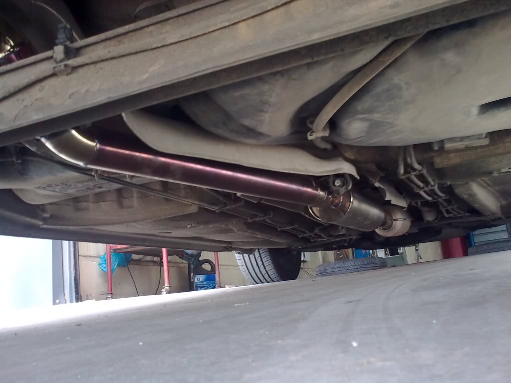

Fitting the new, full 54mm exhaust, with twin mufflers

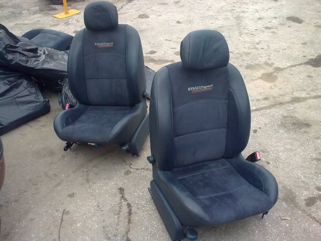

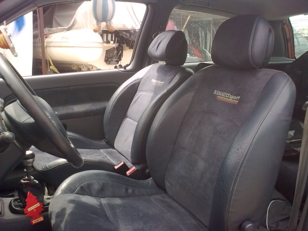

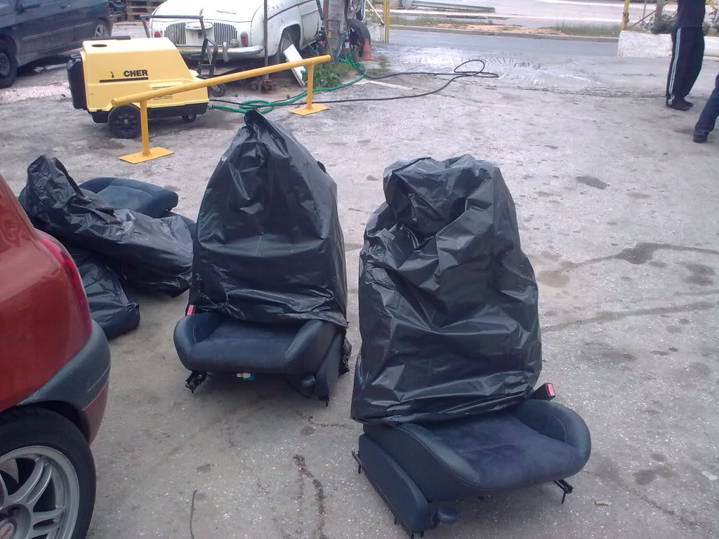

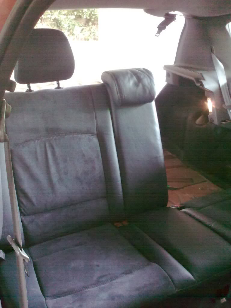

Later on, it was time for the big interior change, so I replaced my old one with the full 172 interior

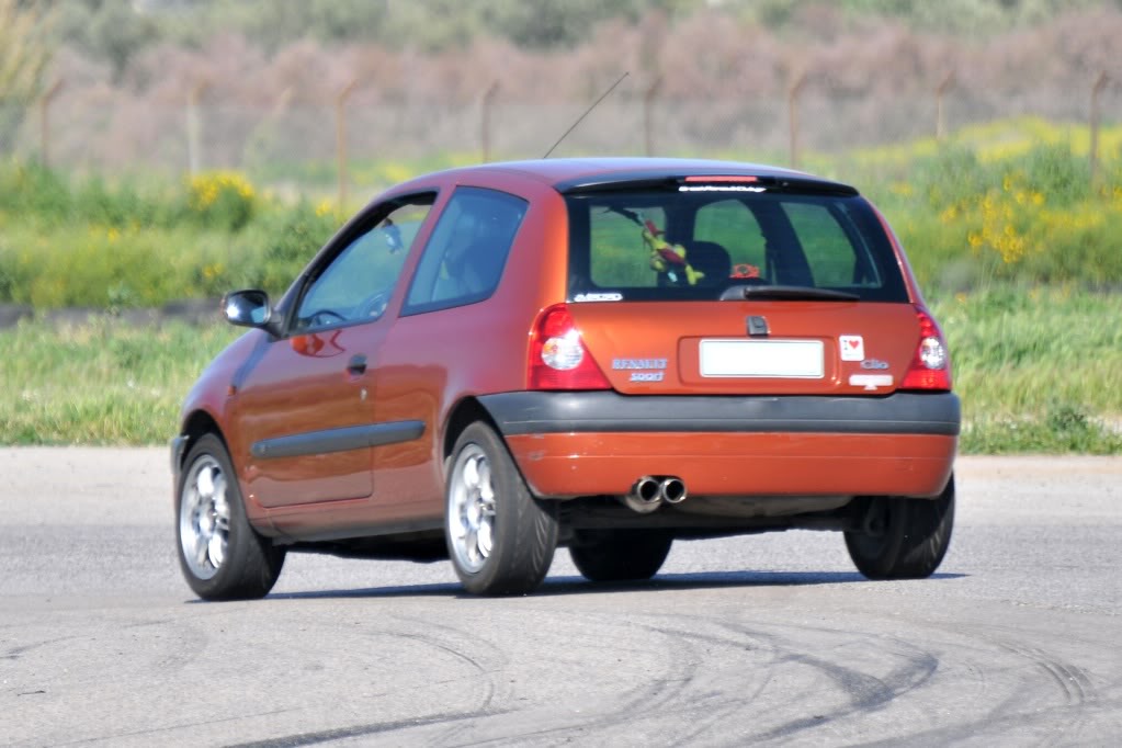

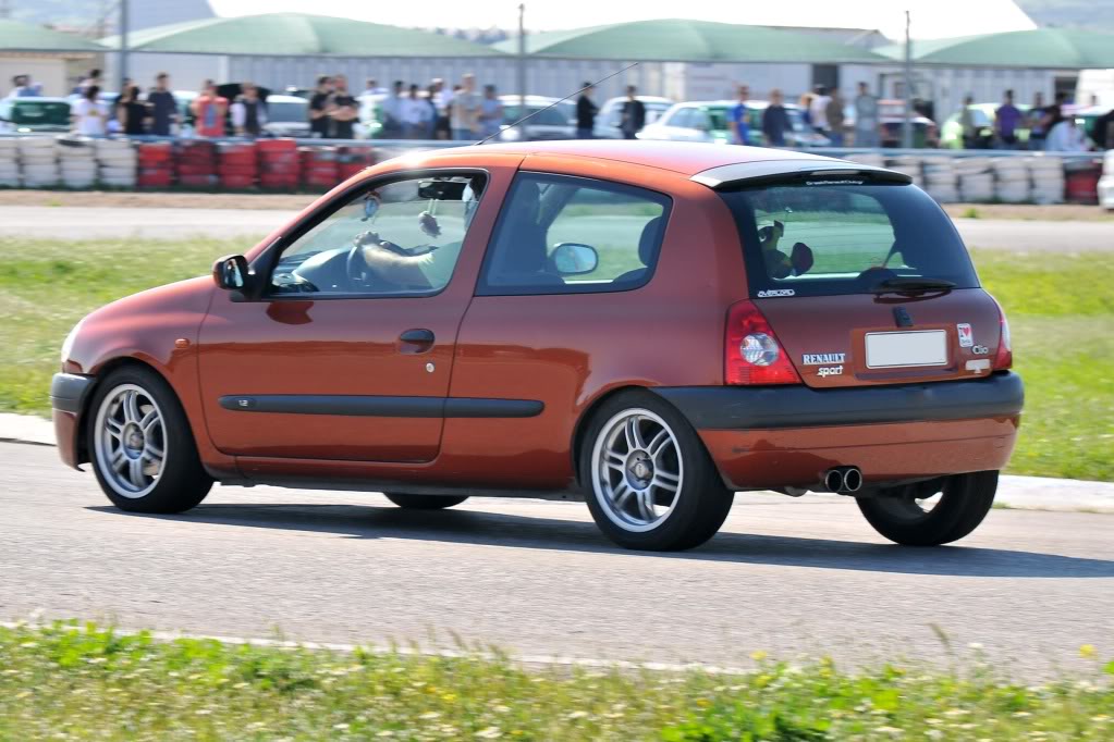

some photos from my first track day (yea, I got a LOT of little thingies hanging from my dashboard/central mirror)

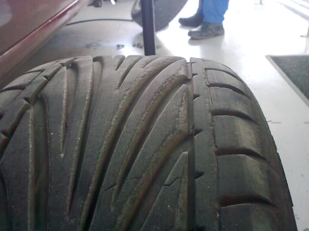

My Toyos after the TD

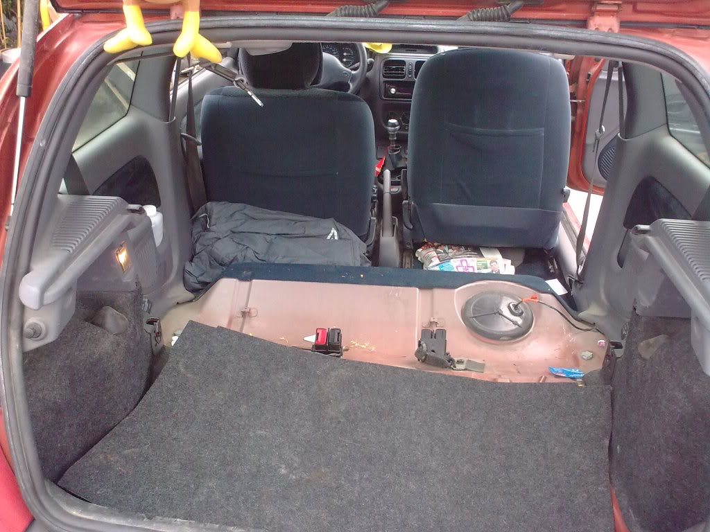

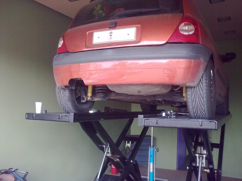

It's already starting to look like a 172... So why not put the rear axle as well? :cool:

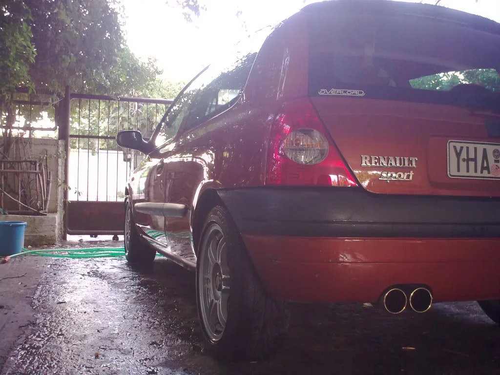

I think it looks better with no decals on

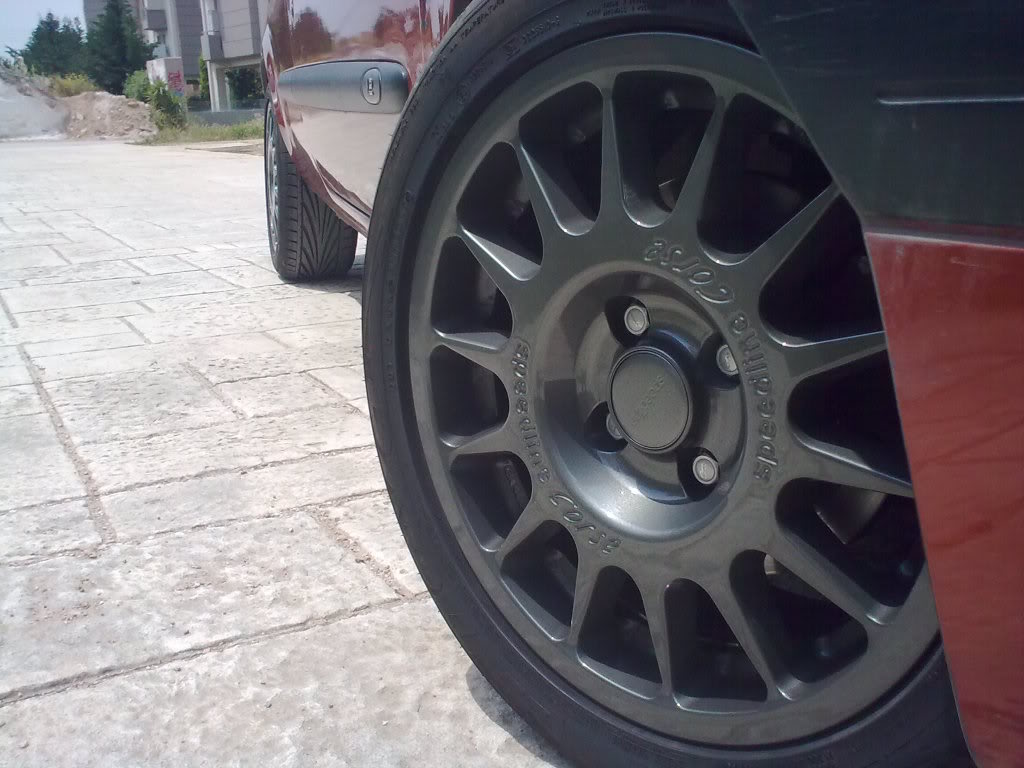

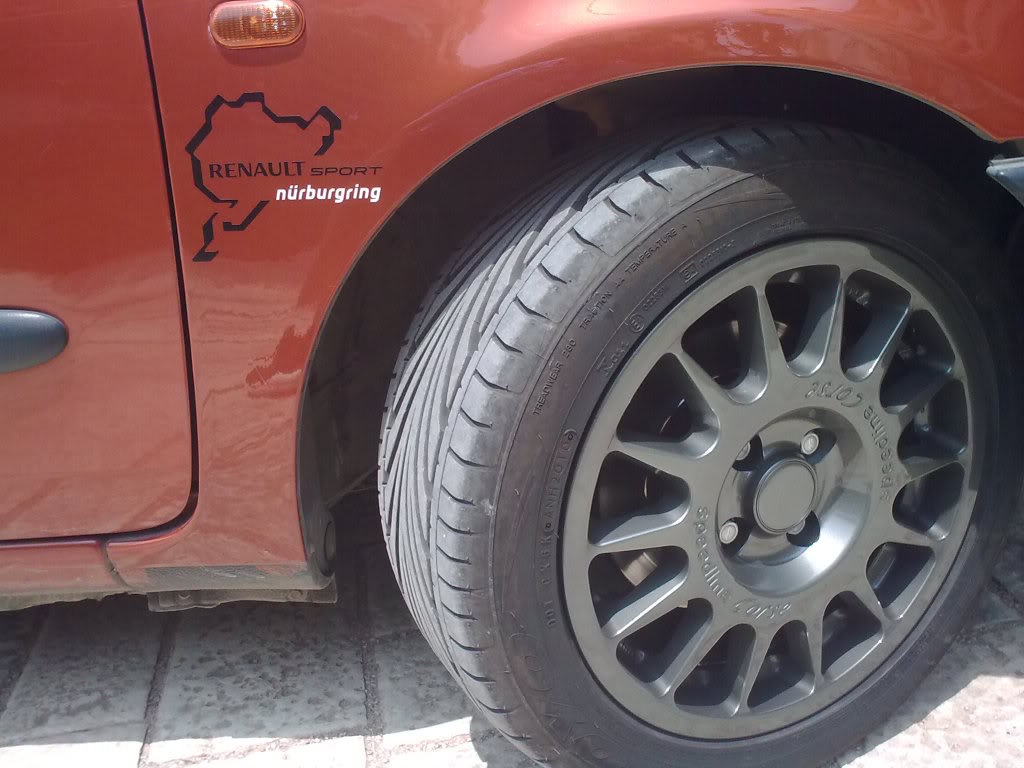

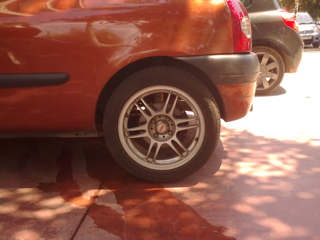

When a good friend of mine proposed that I change my K1 with 2118's, I JUST COULDNT SAY NO.
Little sticker added on the co-drivers side

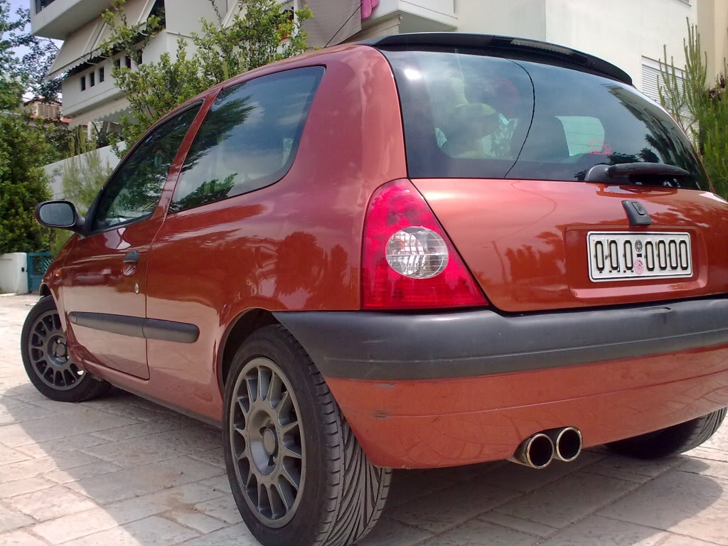

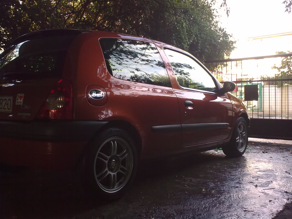

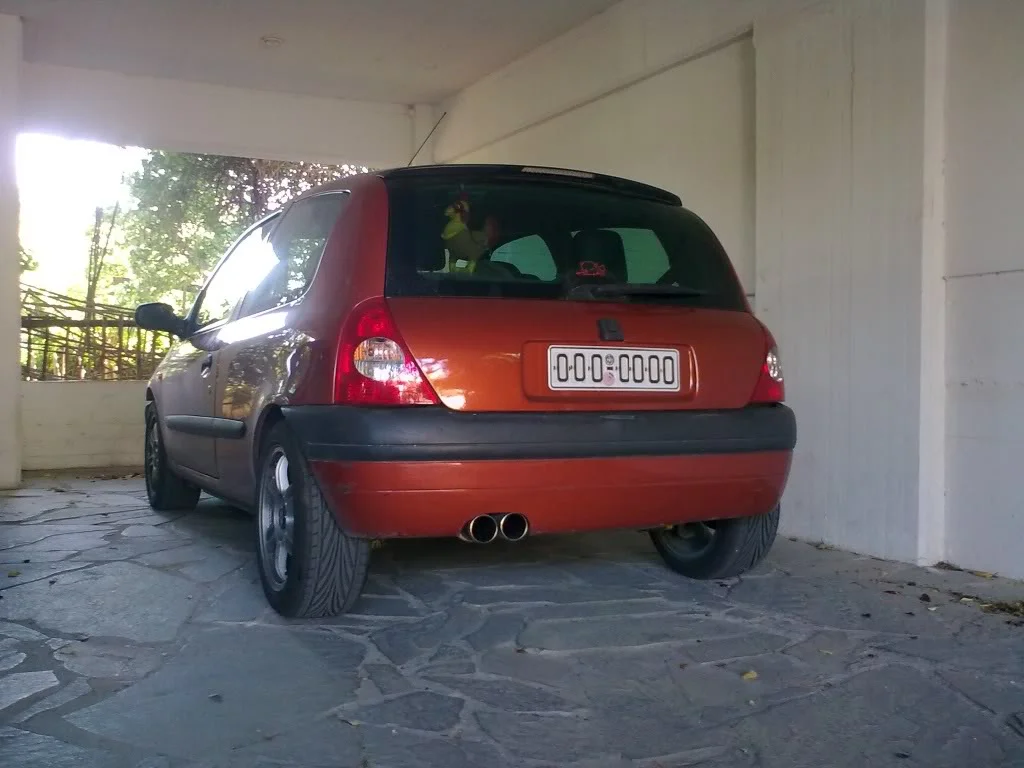

Aaaaand that's how it looks today

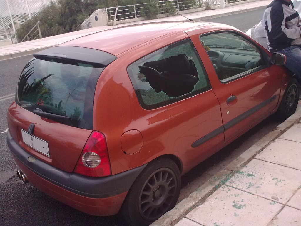

p.s one bad moment that fortunately did not cost me much. Though I'd really want to kick the living s**t out of the guy that did it...

Is it mapped or not?
You should re-map it sometime later, cause from the 2.5 till 4k rpms engine looks kind of powerless now.
It is mapped, though I sincerely believe that there has not been much work into it. I have it on my mind to make a dyno session for it in the -not so- distant future.

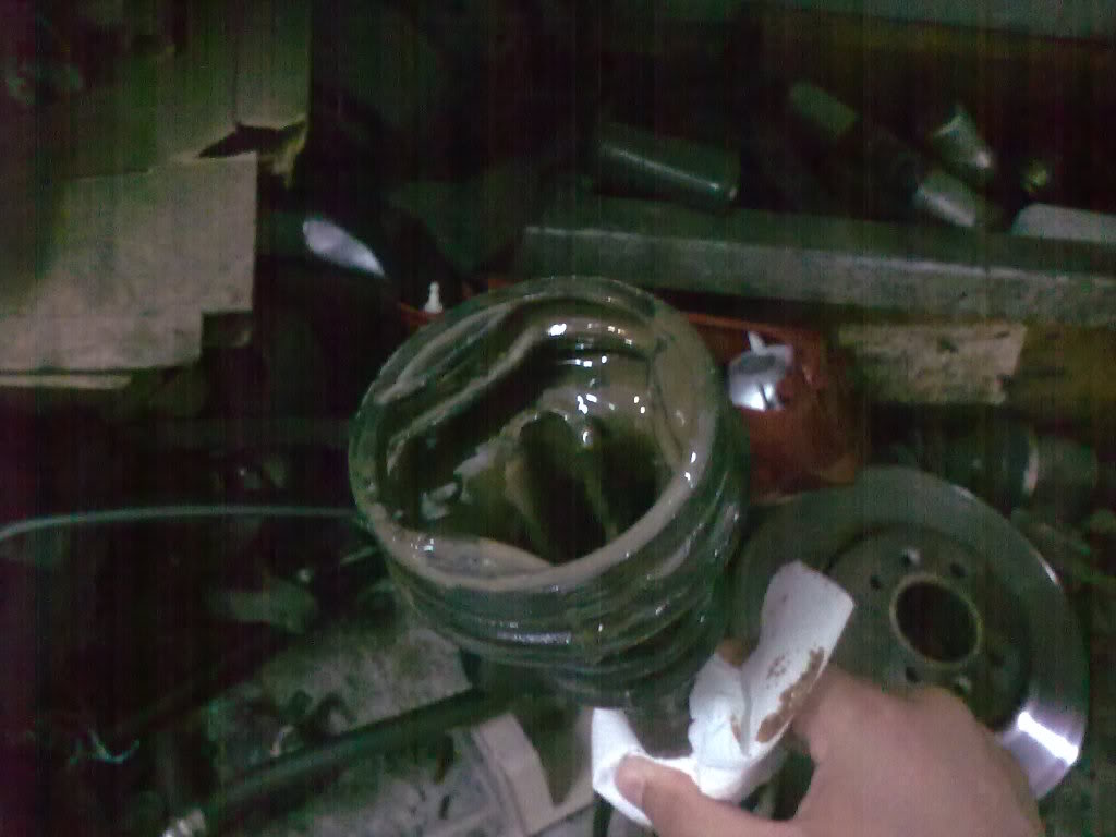

Bad, bad moment, the driveshaft said goodbye the hard way...

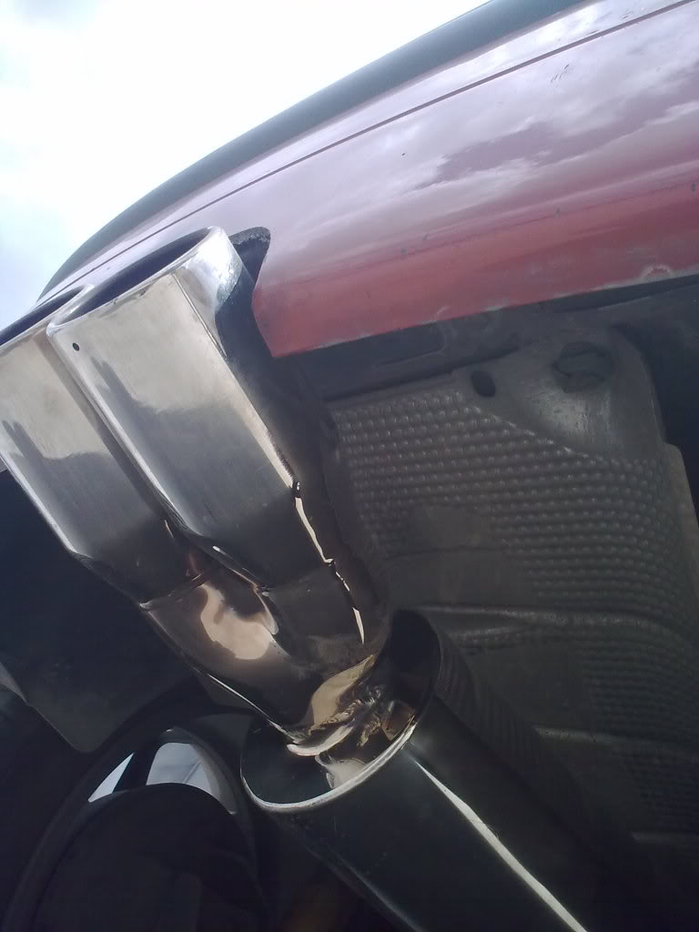

And some updates on the exhaust... :coffee:
