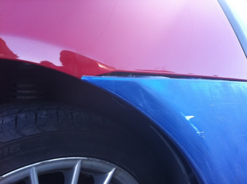

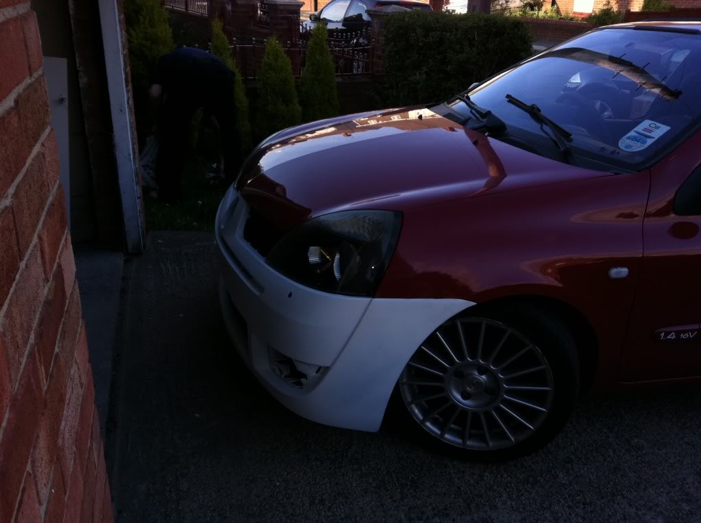

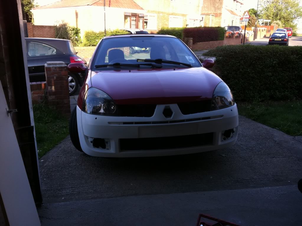

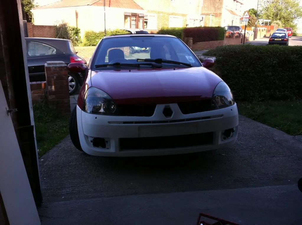

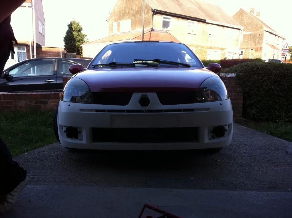

Upsetting update; remember the stencil what I cut out to modify the bolt hole in the wing? I shouldn't have done that, it's now too short to bolt in, oh well, body shops gonna ring me to book it in next week (one of two) so that gives me time to get the bolt holes right and fill in the excess
  Ibiza FR

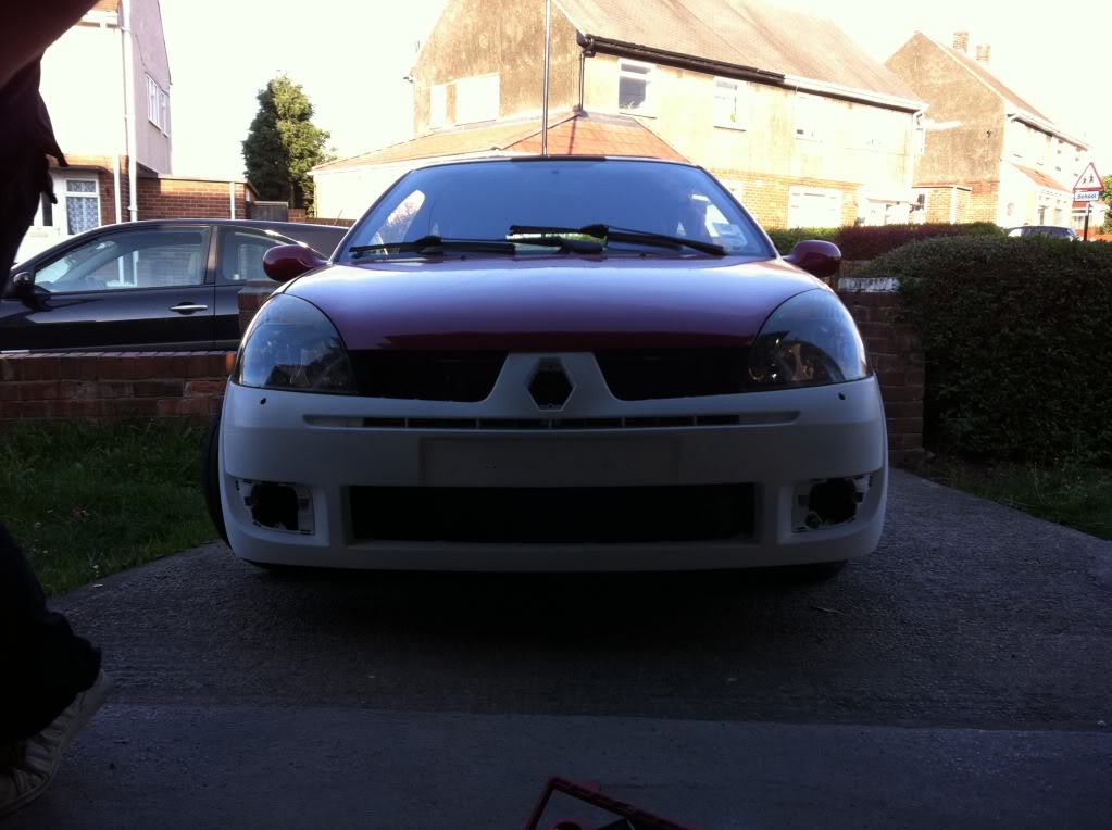

Looks good, fair play for doing all the work yourself too! The one thing I am unsure about is the lip that goes up the side of the wing - I think it would look better with the standard gap? Just a thought
Knuckles
ClioSport Admin
The lip is much better than the gap mate, it would've looked so out of place. I'll see if I can find a pic to show you...
Found one

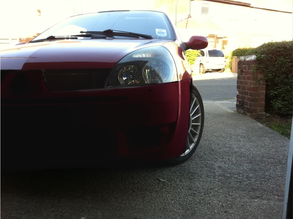

before cutting the bumper to fit the arches
After cutting and tucking
Best I have but you can see the gap would make it look a bit shoddy if I left it

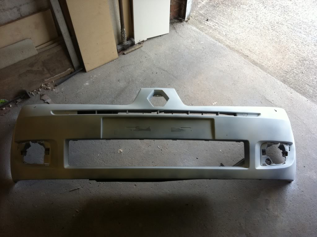

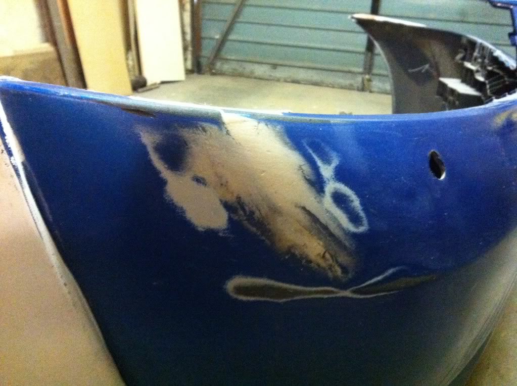

Right, the updates are going to be small for a while, I've decided to get the bumper all ready for painting, primed and smooth so all the painter will need to do is apply colour;

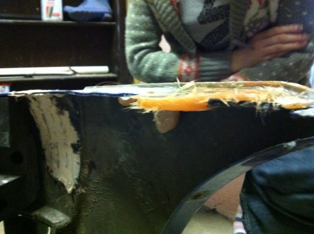

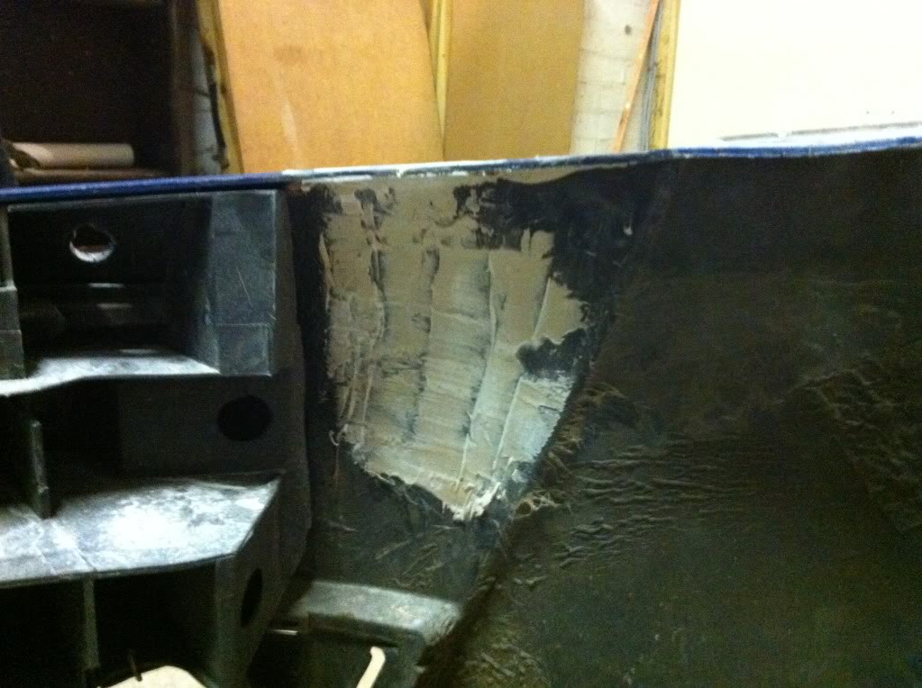

Remember I cut the bolt hole too much? I hope this has fixed it
The plan is to sand this and cut it so it's a perfect fit then screw the bolt through to taper it
The cracks almost finished too
Oh, please don't defecate on my rainbow by telling me the fibreglass won't work, id like to find that out on my own
Shame about cutting too much out. Have you put the bit you cut out back into the fibreglass or was this not possible?
Done a good job of the crack as well! If you're priming it why not paint it and lacquer it? Surely if the rest of you car is different shades of red anyway the 'pro' wont be able to do it much better than yourself? Unless they are blending the it into the wings and bumper in that case, It'll be a lot on money!

There's no point, I only cut off about a centimetre anyway so it'd be easier to just reshape the fibreglass myself.
I don't trust myself to spray it, plus I don't have a spray gun. And halfrauds don't stock a colour close to mine, I was talking to a doorman I work with who owns a garage the other night, he recommended an apparently cheap decent place not too far away so I shall check there next week :)

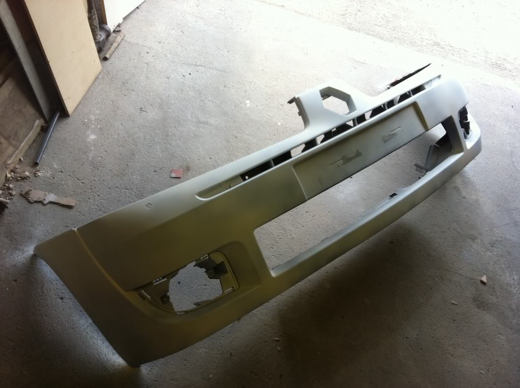

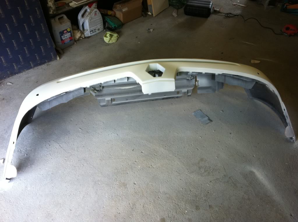

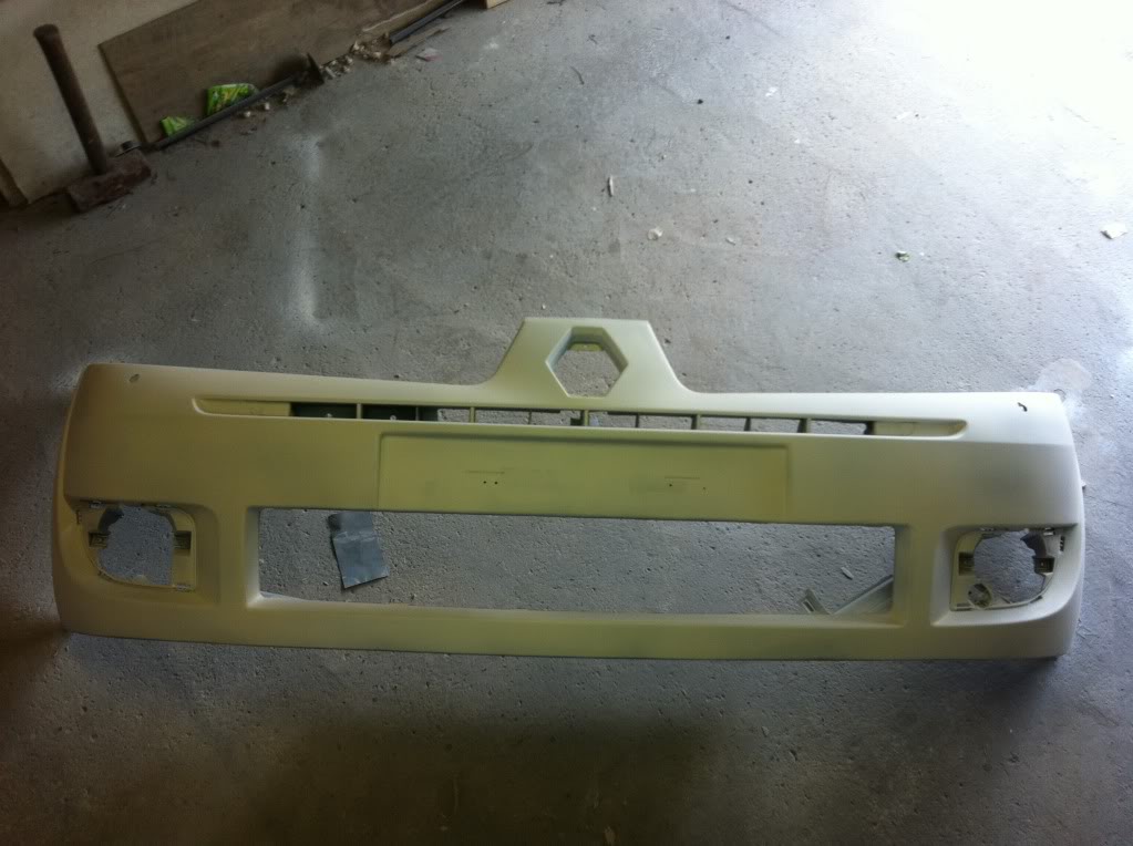

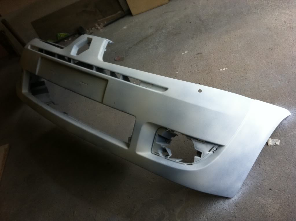

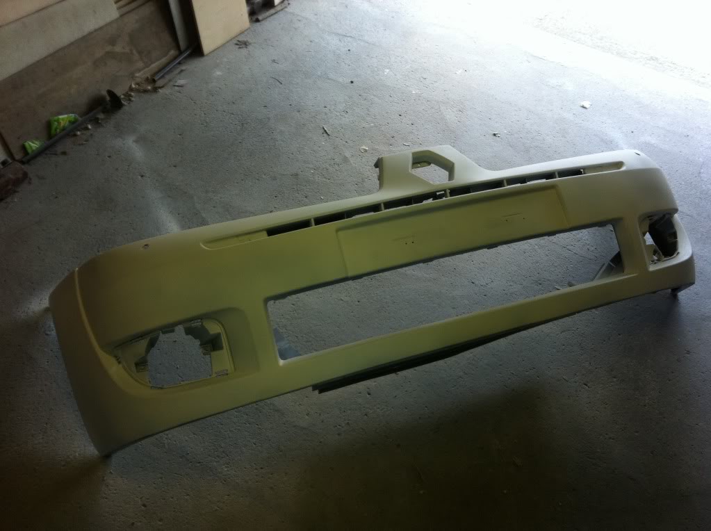

I thought the bumper was all nice and ready to be sprayed the other day, I had some primer lying around so I give it a once over to show up imperfections... There were a few :/
I went over the whole thing with p800 p1200 and p1500 to get it all nice and smooth, filled in any bits that needed filling, resanded. And reprimed.
The plan is to sand it all down so it's all ready to go to the body shop, find a body shop, bolt it on and take it down :)

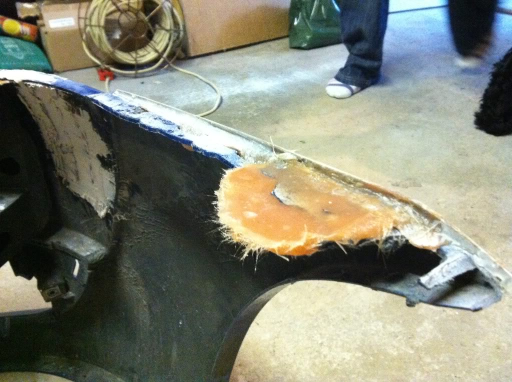

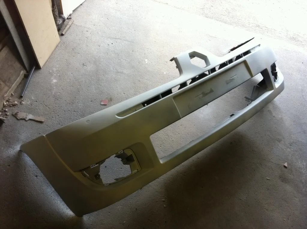

I'm quite chuffed that I managed to get a bumper off in 5 mins without jacking, get another bumper sanded, fitted, marked out, cut and drilled... All in an hour :approve:

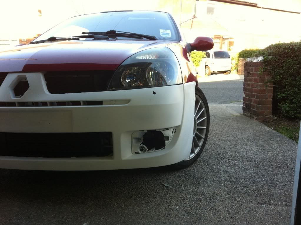

Here's today's progress
The fibreglass 'sea urchin' has been cut to shape and drilled so I don't need the metal clips to screw the bolts into :)
All that's left now is to make the join between the boer and the wing smoother and more flush. Another coat of primer and then to a body shop for spraying :) I recommend anyone who's thinking of doing this to do it. It's been so much fun and a massive learning experience

Yeah, cars in the body shop ATM, getting the paint blended into the bonnet and wings, should be back by next week. Quite lucky that the garage my girlfriend bought her car from had a body shop out back, the guys dead canny and I've seen a bit of progress he made today and the colour match is spot on :) I'll be updating this and posting a media post soon :)
Knuckles
ClioSport Admin
I need to learn to not be exited about things before I see results :/

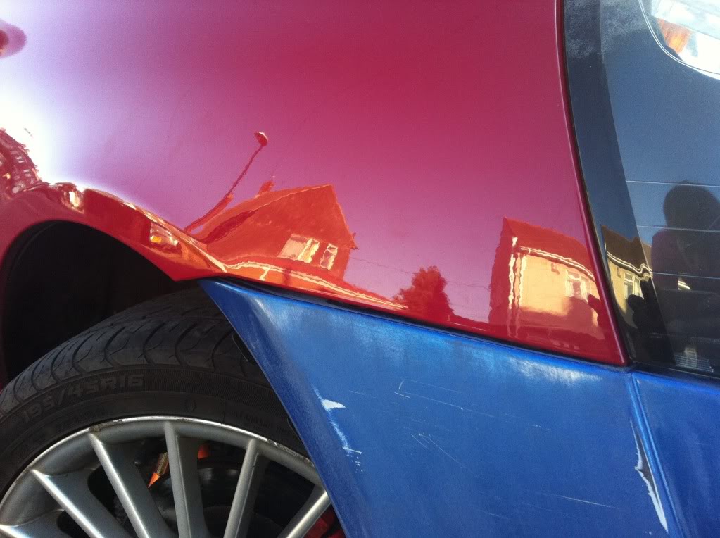

Remember this lovely crack that I repaired so awesomely?
See, no sign of damage at all... When the garage put the bumper in the car to take to the body shop... A front bumper... In a Clio, doesn't really fit. So that put pressure on the bumper making the crack re open. The guy at the body shop said he won't bother fixing it, because if he does. It'll be under too much stress from that kind of crack and any vibration or jolt would make it crack again.
So I'm leaving the normal bumper on and looking for a mint example of a 1*2 bumper and then I'll start again :dapprove:
I am genuinely let down by this... I'm over reacting but I can't help it for now. :/ oh well, ima trawl the for sale section and eBay again
