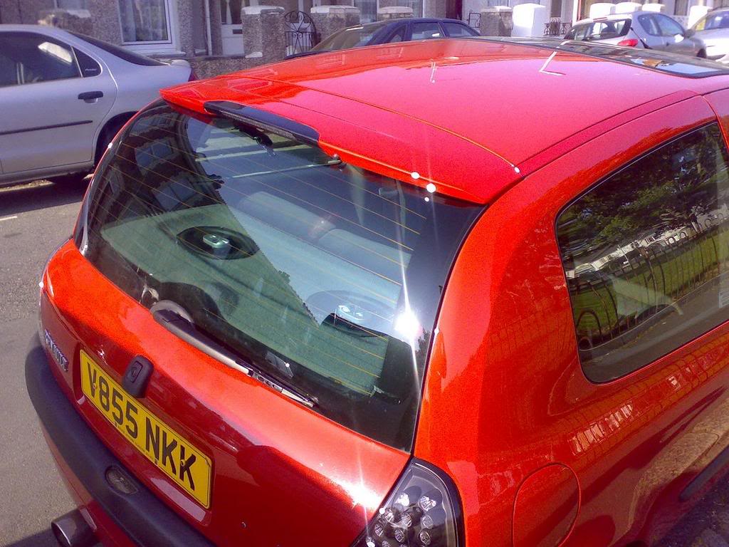

The Grande only has flat black strip of plastic across the back rather than a spoiler, the dynamique one is similar bit sticks out like the sport ones, can be had in black plastic too so it matches the bump strips etc
heres the dynamic/187/182 spoiler (all the same just dynamic is matt black)
