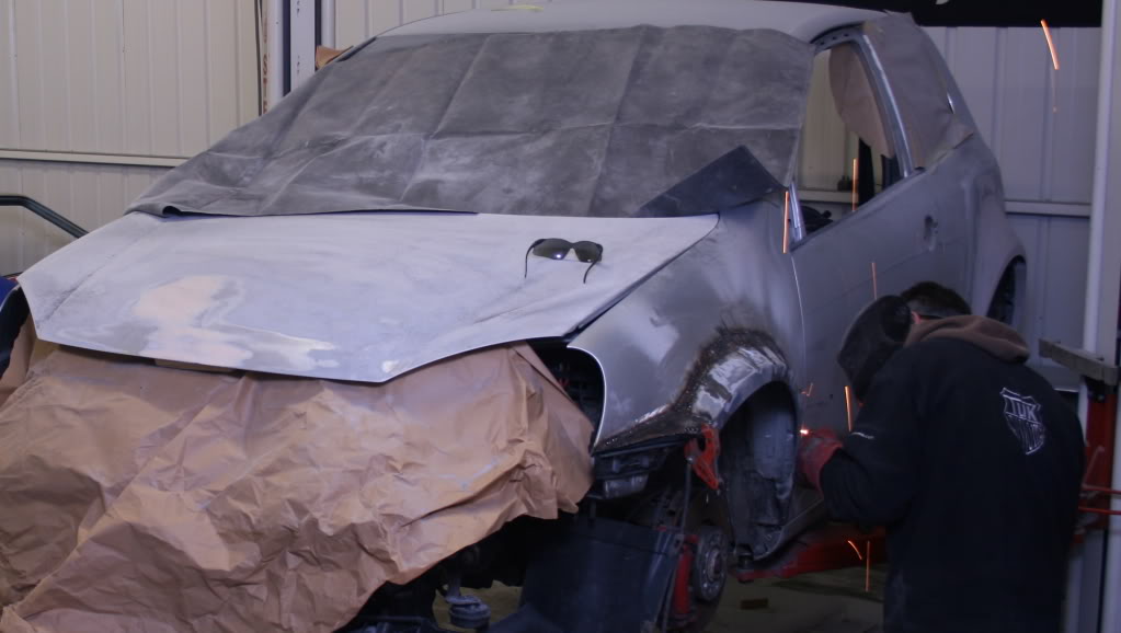

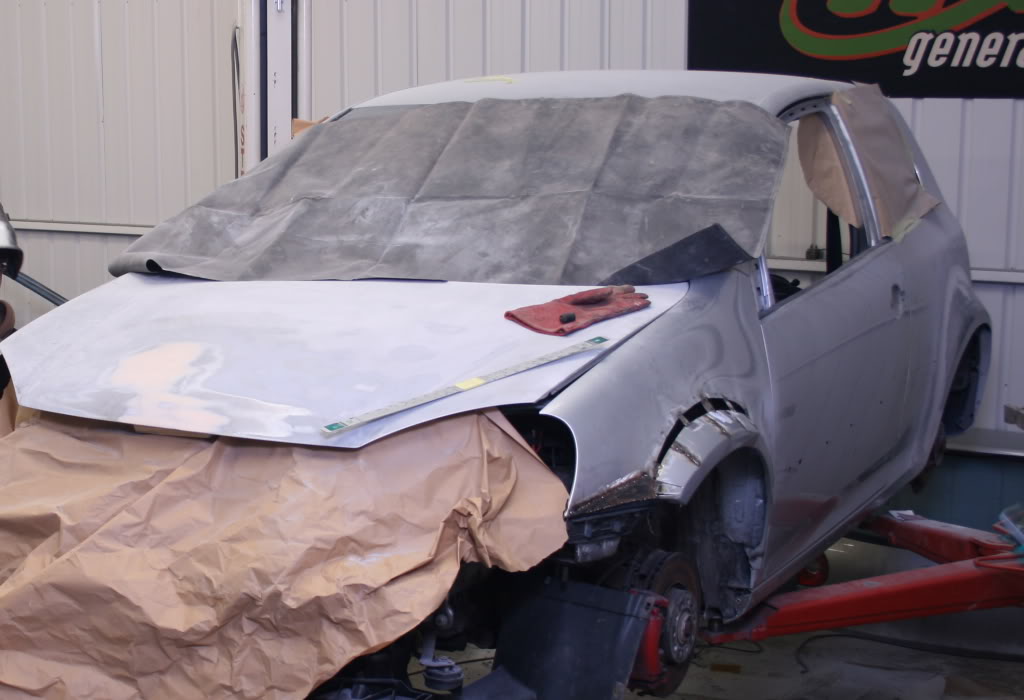

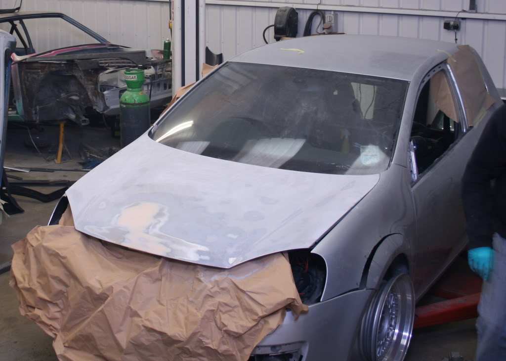

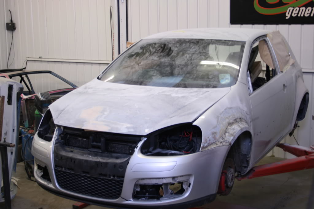

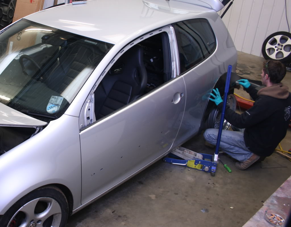

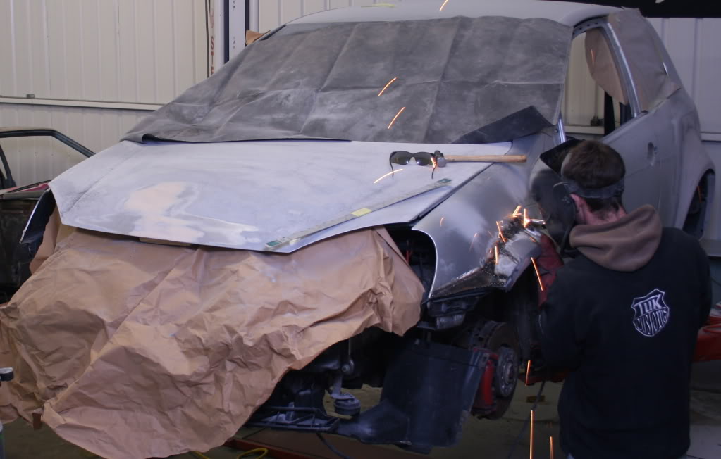

Rob cutting up a front arch to make up the rears
Marked up

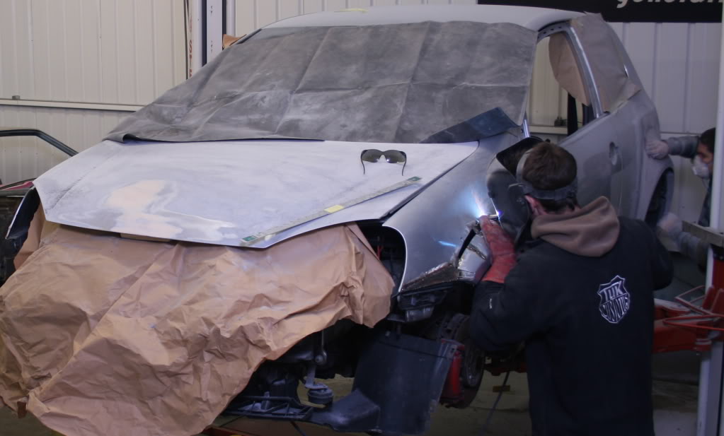

Tack'd in place
Welded up and beaten into shape

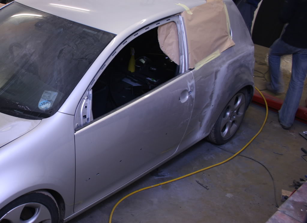

Rear arches Ground back
Metal work finished and ready for skimming

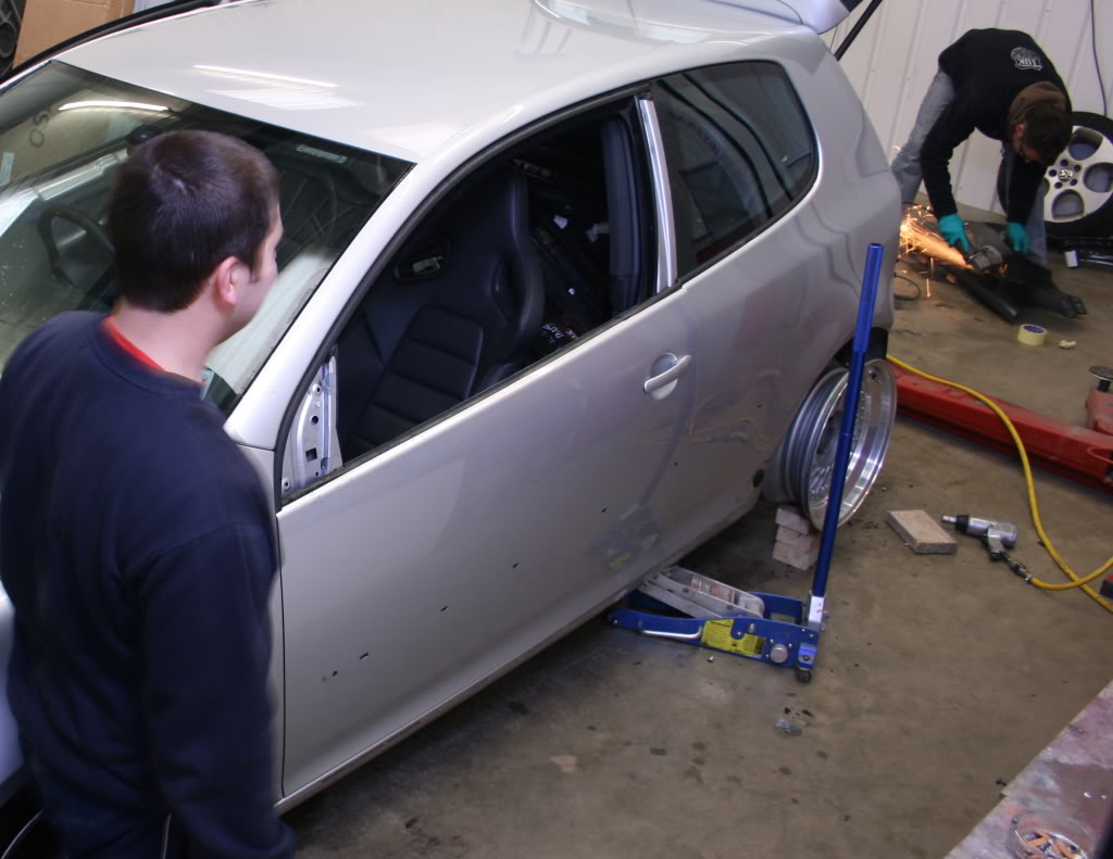

Wheels on and arches cut ready to be pulled
Wings extended to compensate for the movement of the bumper, front arches measured mm perfect and tack'd into place...rears skimmed

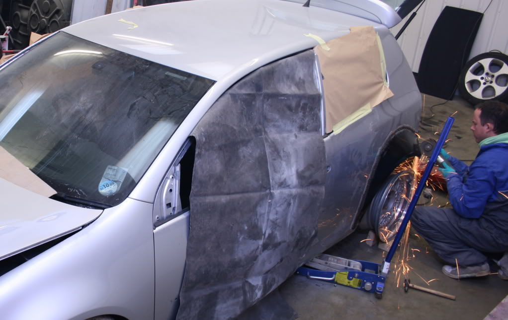

Tack welded strips removed and arch plates shaped and welded into place

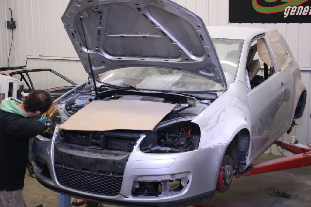

Rob grinding back the welds on the front arches
Fronts ground back ready for skim with filler
Front and rear arches skimmed

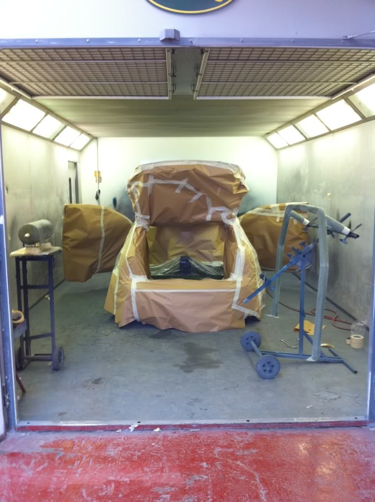

Primed and getting ready for paint

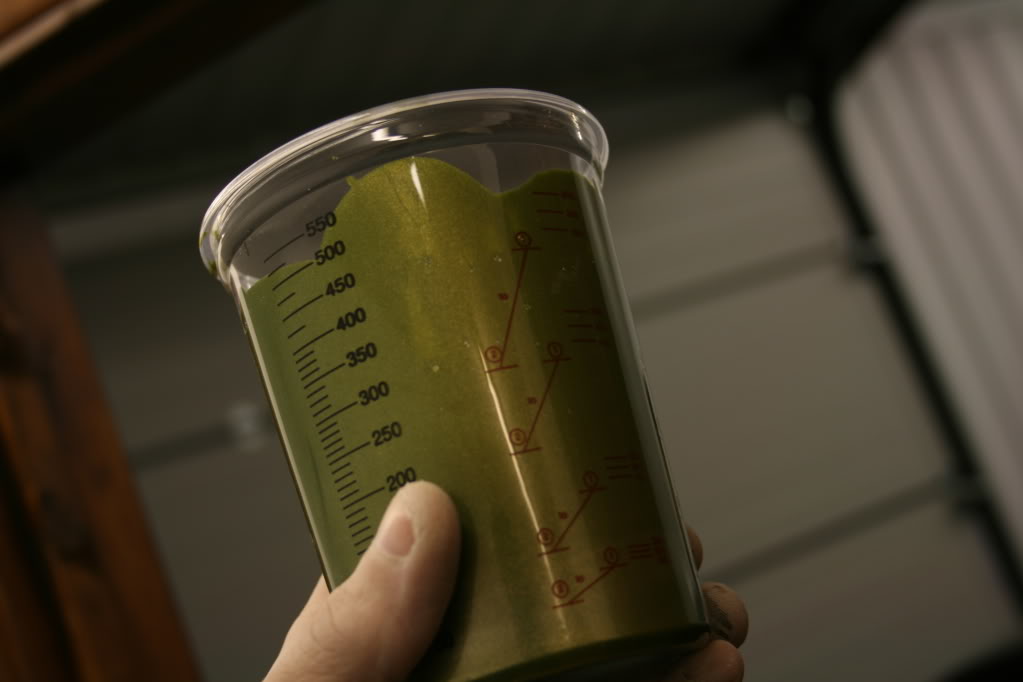

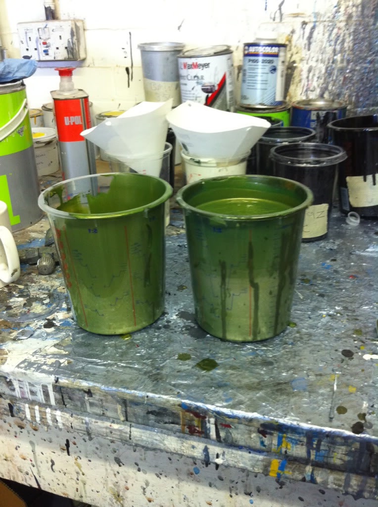

The famous Pot

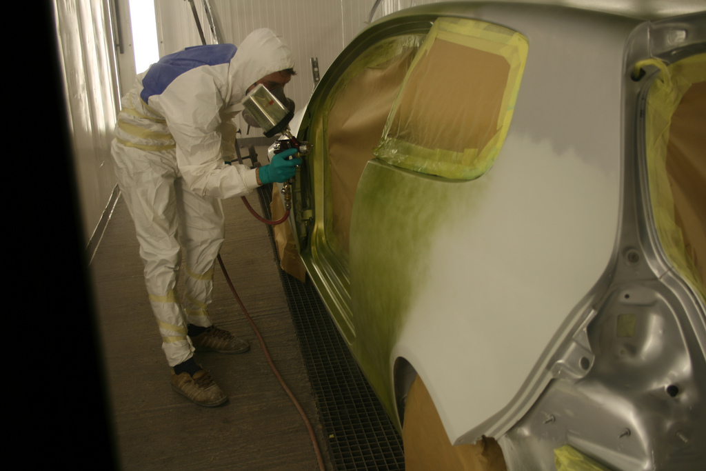

Rob in the booth doing his thing

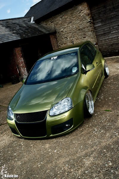

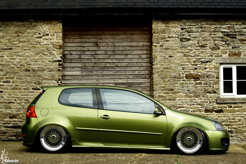

And the finished article

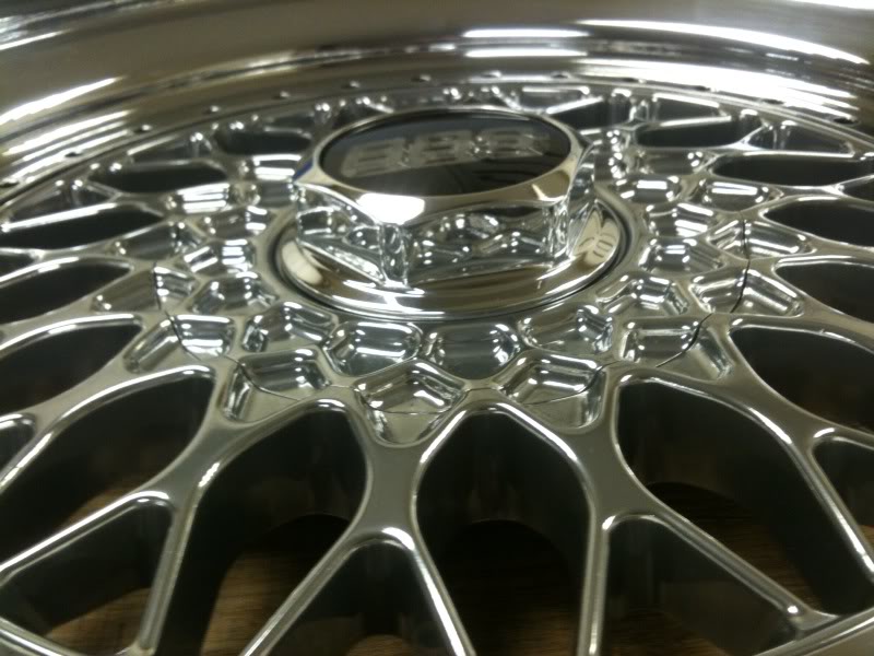

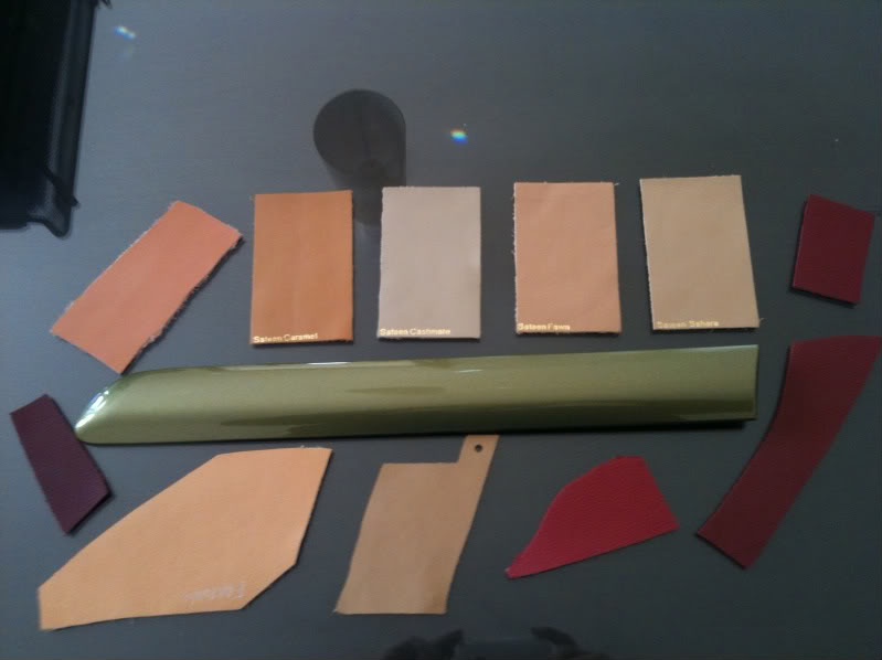

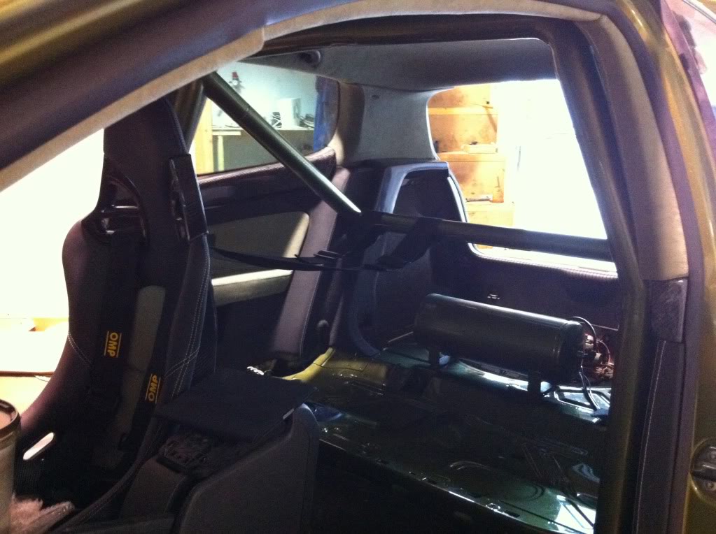

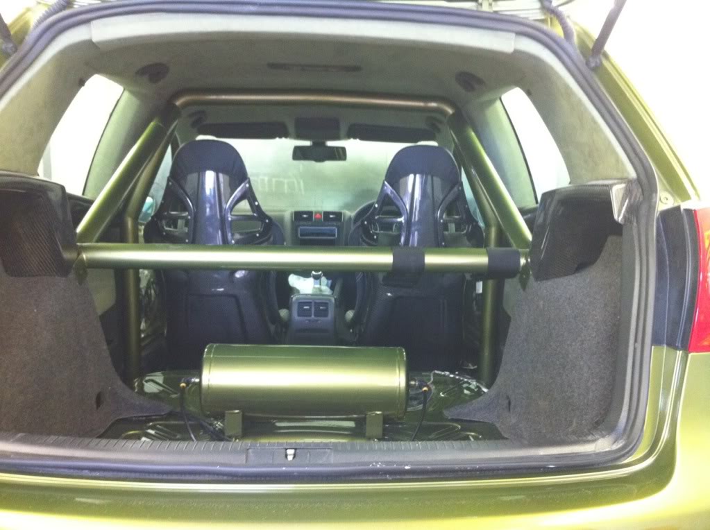

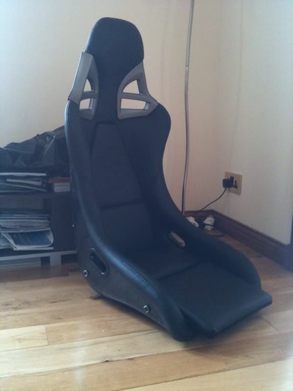

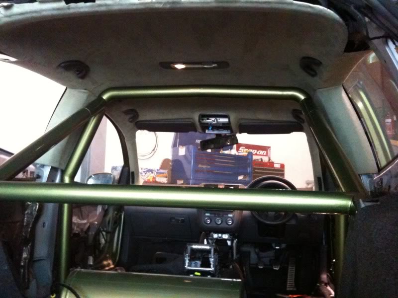

Now that its back with me I've decided to raise the bar on it and give it a bit of a make over. The green is staying, the rims getting a full polish and a full interior over haul, original seats have gone and some Carrera GT seats are going in after a retrim, with a custom cage, painted floor and plenty of carbon fibre.
Hopefully it will all be done in the next 2 weeks in time for uk show DC10, progress so far.....

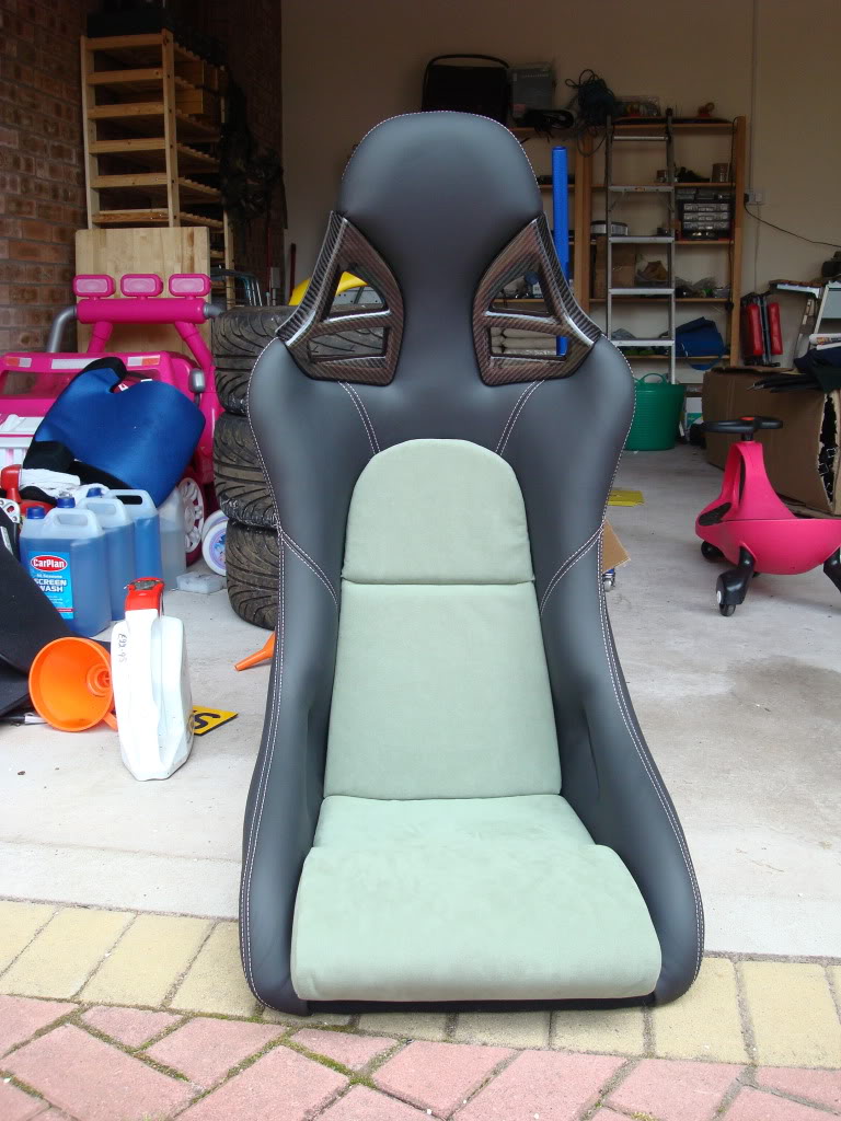

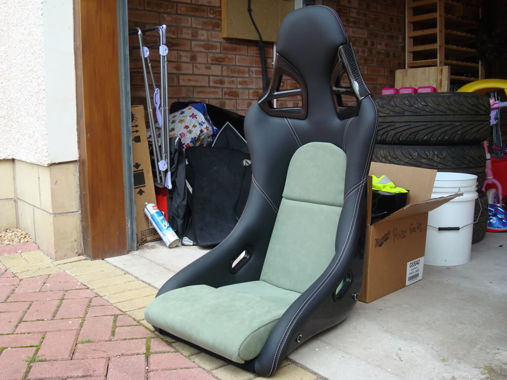

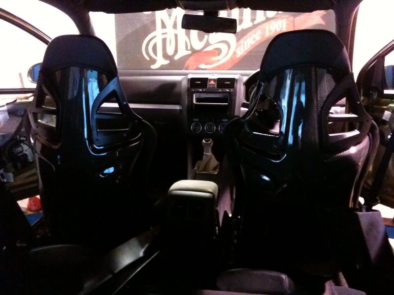

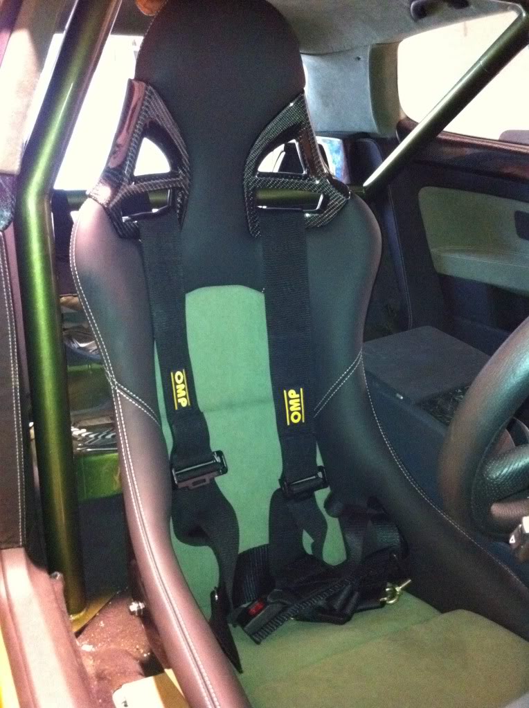

Few pics of the seats before they go in

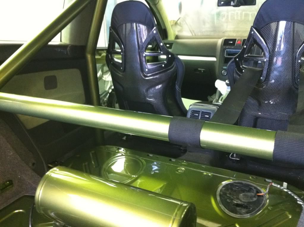

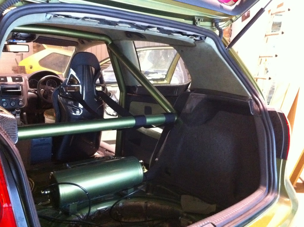

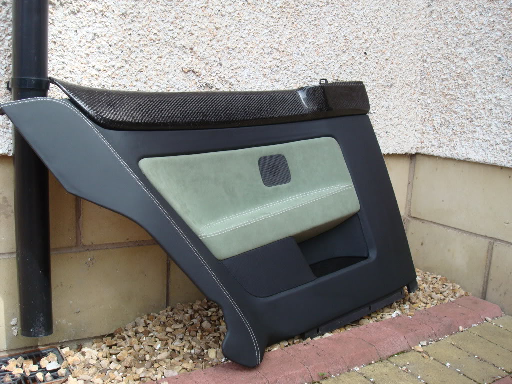

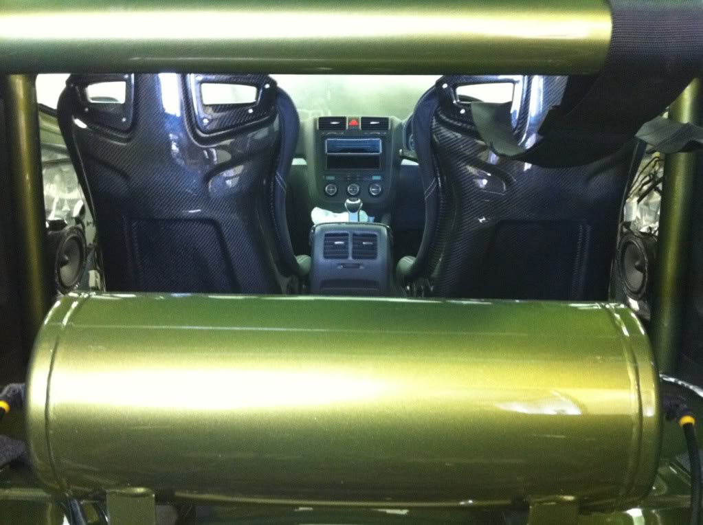

Interior is mostly done now, Waiting on the handles to build up the front door cards and the brackets for the bucket seats to come back from the powder coaters.
Im extremely happy with how its looking at the moment, its far from finished but by next weekend it should be pretty much in one piece, just need to re paint the floor and fix the boost and steering issues then tidy up the wiring and pipework.
Plenty more carbon and trimming i wanna do before edition and it really needs re paint to get it up to standard but i think that can wait till over the winter.
Few terrible Iphone pics, interiors are really hard to photograph :laugh:
Couldnt find the harnesses i wanted to decided to get these 3" OMP's and spruce em up a bit after MIVW :ph34r:

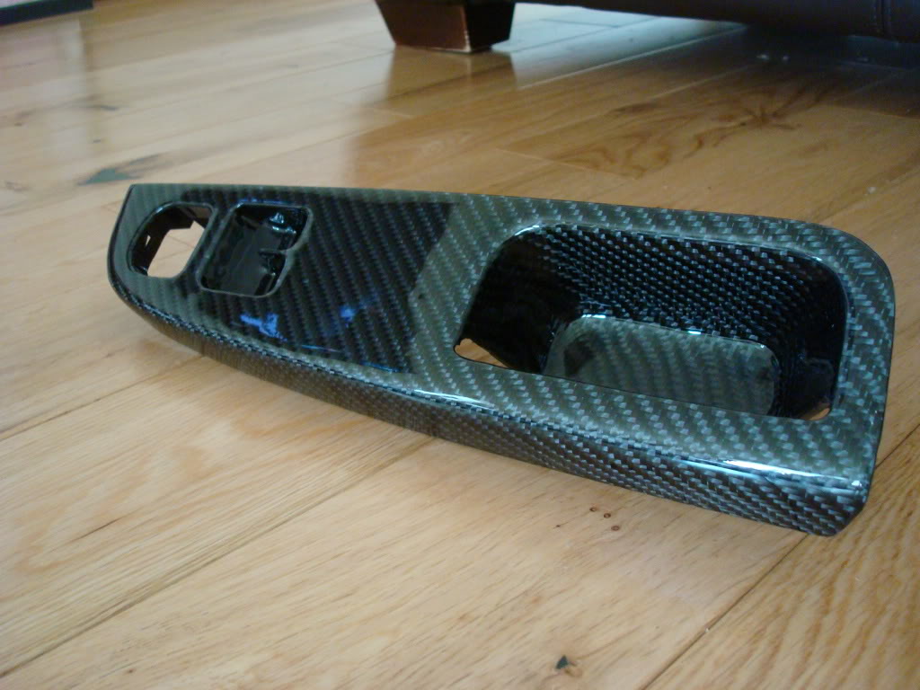

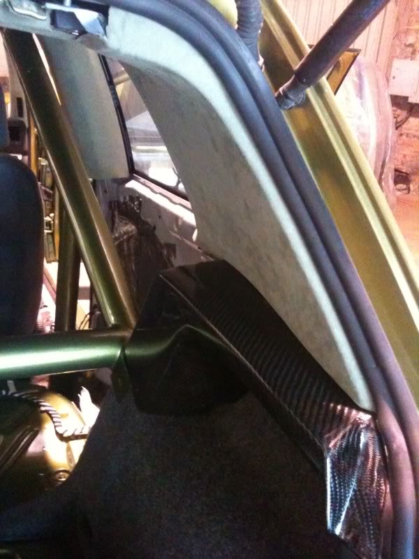

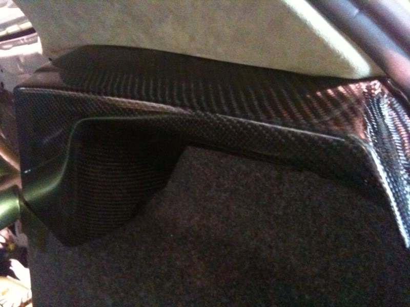

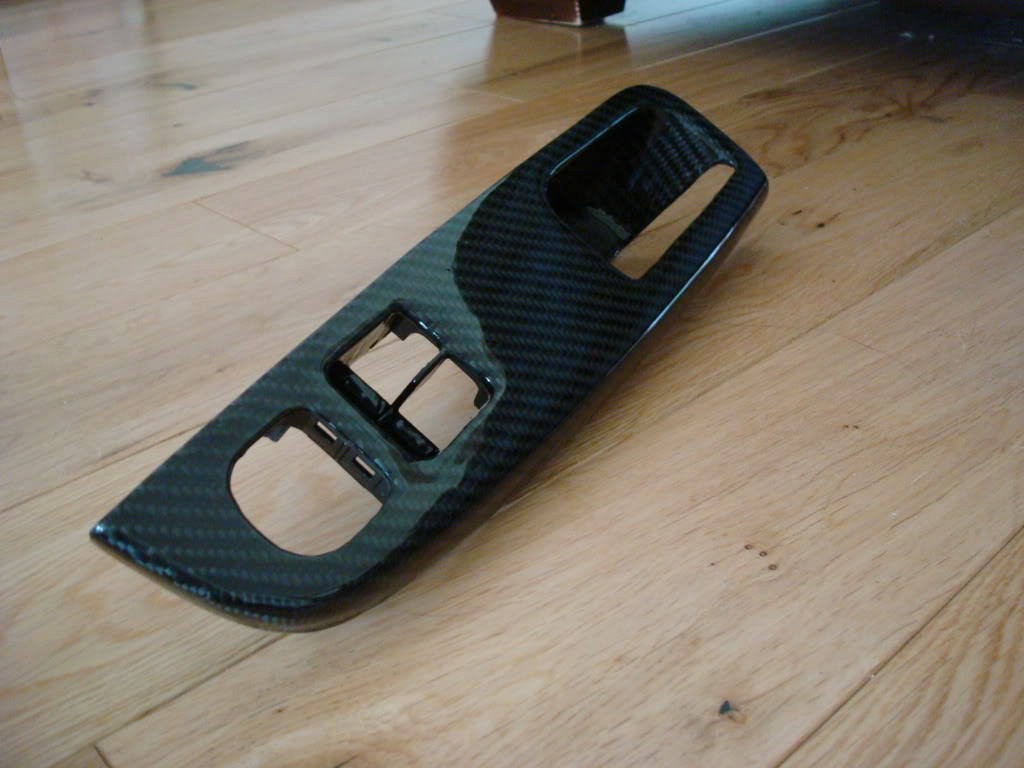

Carbon Fibre touches
Parcel shelf supports which i trimmed and smoothed off before carboning them
Console Inserts
Arm Rest
Door Handles

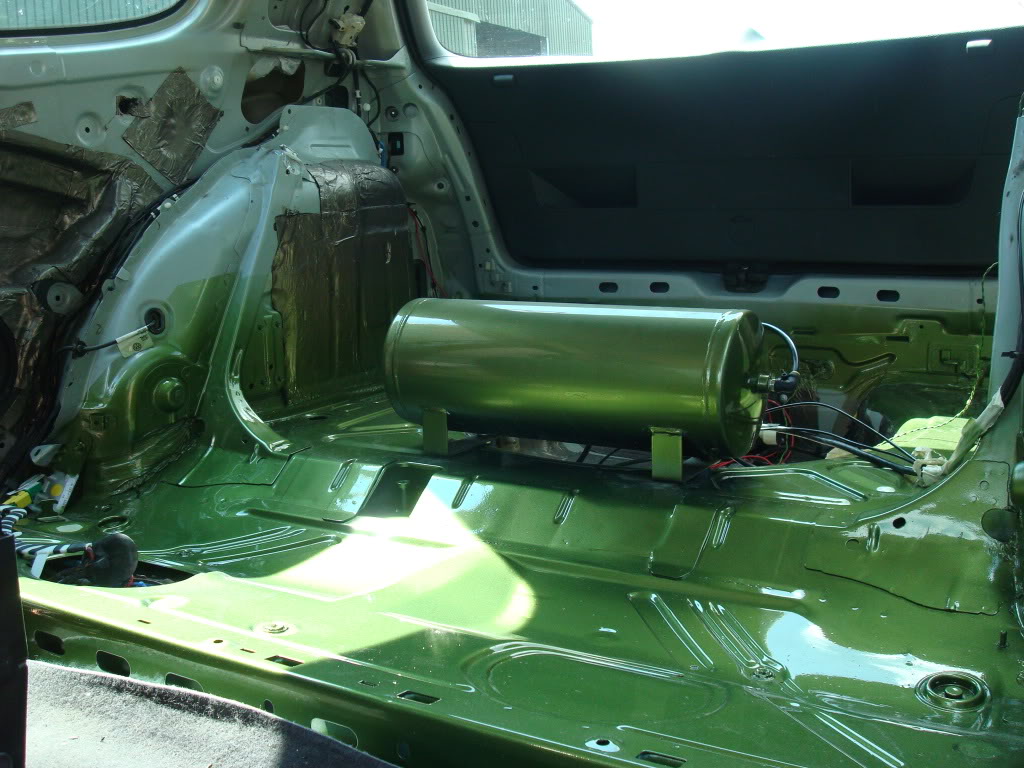

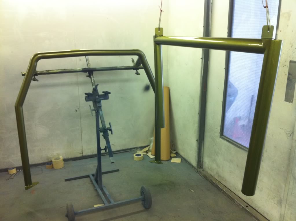

Repainted the Tank and the cage along with the boot floor

Amazing!! Even i like that. In Onyx Black or Dolphin Grey it would be Perfect.
Gally
I'm not a massive fan of the modding scene but W.O.W
That is one impressive car I think because all the touches are nice and not too in your face.
I'd like to see how he made that rear number plate recess!
Taken a knock to the head this weekend? ;)
Looks sort of OEM+ if you had to sum it up, it's almost what a manufacturer might kick out if someone was allowed a little more freedom to produce something in your face.
As above re the colour. I don't understand why people put so much work in and then basically ruin it (in my eyes) with such a sheet colour!
That aside, love it!
