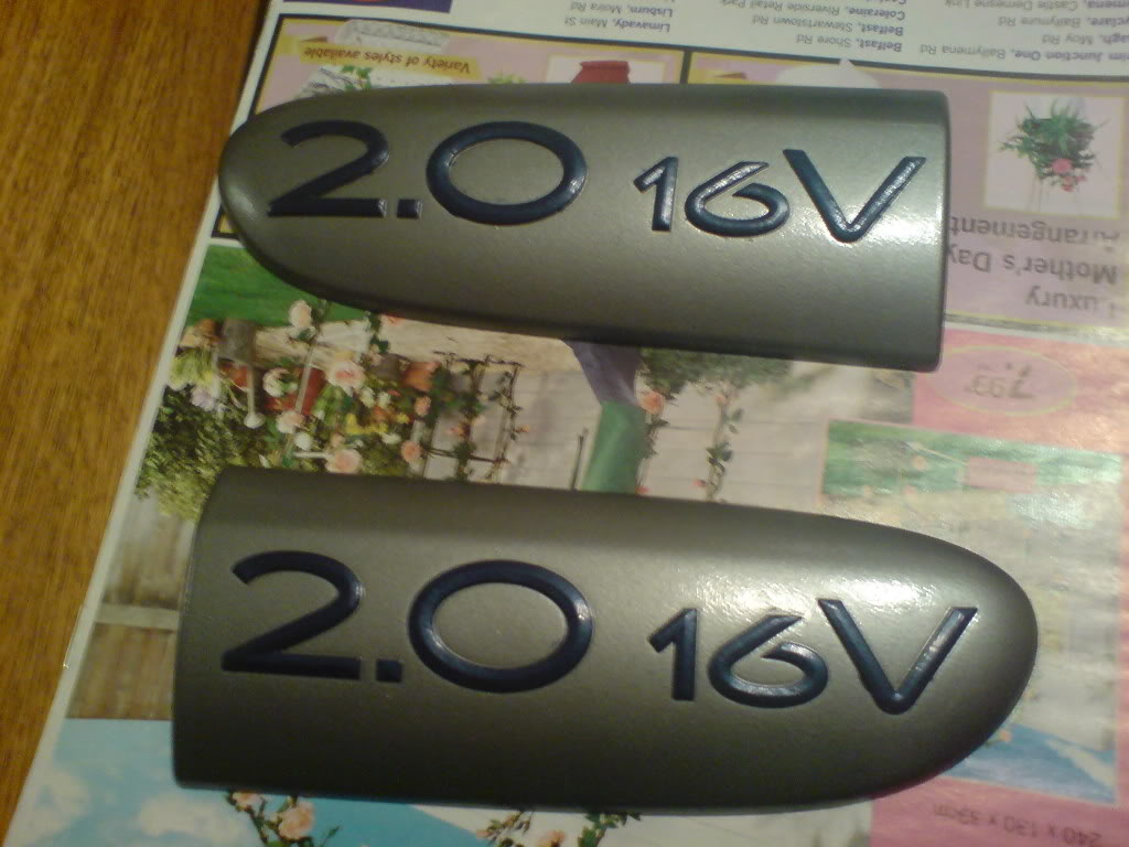

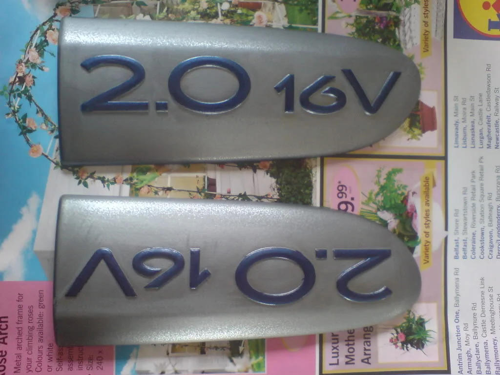

Just sprayed lacquer onto them today.
first pic is numbers just painted on,
This is them sanded with wet n dry 1200,
and finally lacquer, not as glossy as the finish acheived by clio-coby but im happy enough. maybe they will need flatted down but well see when they dry properly!
verdict?

none yet....still drying and may need rubbed down to get a bit more gloss. though i quite like the way they are.
  Monaco 172
cheers guys just fired a bit more laquer on there and seems to be bringing a gloss up. but im gonna stop now cause it looks well and ill prob ruin it if i go anymore!
iirc, if the laqcuer is giving you a bumpy/rough texture, your holding the can too far away from the job.
dont quote me, but think this is right.
  Monaco 172
either that OR the fact the badges were in line with the heater causing it to dry too quickly, but it was roughed up again and sprayed...seems to be working!
