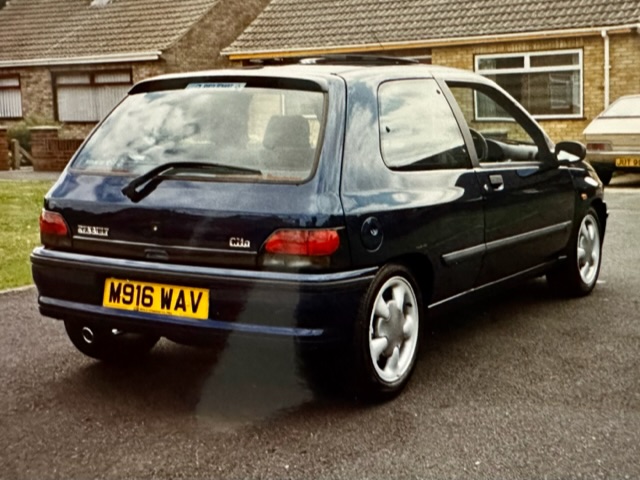

Back in the summer of 1994 my mother wanted to replace her Peugeot 205 and chose a brand new MK1 Phase 2 Clio 16v delivered on 1st August 1994 with the reg M916 WAV.
I vividly remember that when she ordered the car, the dealer asked her if she wanted to have a Clio Williams 2 instead as he was sure he could get her one? I was all for that, but she declined the offer as she wanted the ā€œLuxuryā€ options of Sunroof & Remote stereo controls that only came on the regular 16v.
I was so taken with that car, and the reason I bought my first 5GTT Raider as it was the closest thing to one I could afford at the time (Here’s my 1st Raider behind my Mothers Clio 16v)
One of my mothers work colleagues actually bought a Clio Williams 2 at the same time and I can remember drooling at the two ā€œHOTā€ Clio’s parked next to each other at my mothers office when I used to visit her.
I knew back then, that my mother had made the wrong decision buying the regular Clio 16v and wish she had bought the Williams. The car just looked so much more purposeful with those Gold Alloys and wider/squat stance.

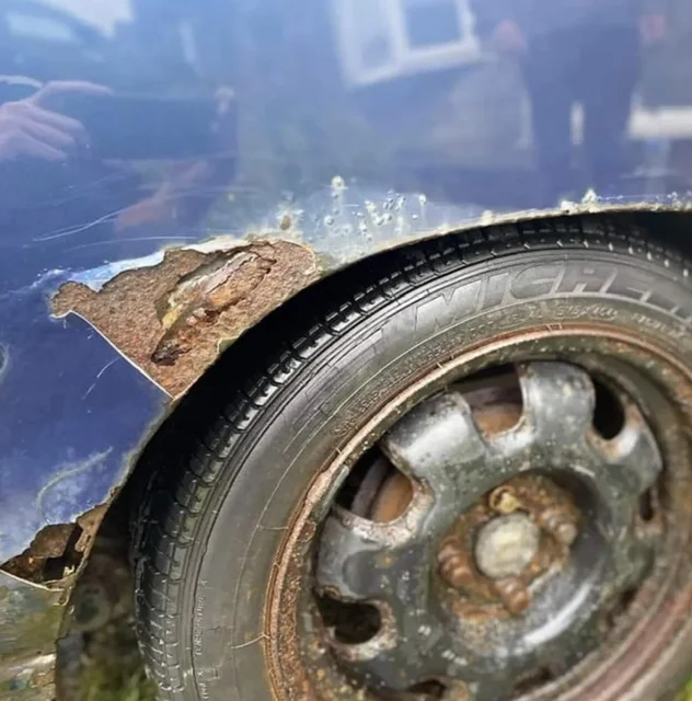

The problem is, the cars ROTTEN as a pear!!!:
The other problem with this car, is it’s got a load of bits missing which are just unobtainable now.

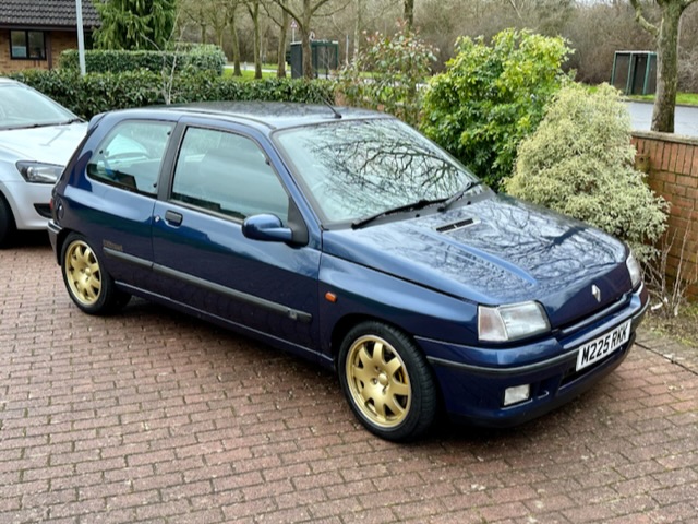

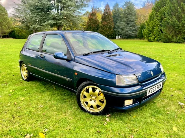

Well, I then found a lead and gave it a tug… an unearthed a Clio Williams 2, 127k miles, plenty of owners, 6 months MOT, original book pack and some service history. Started a conversation with the guy, and the found the numbers could work, even with the pair of sills it needs.
I was REALLY into this car, as I could see where I could make a difference to it with my history of working with Old Renaults…

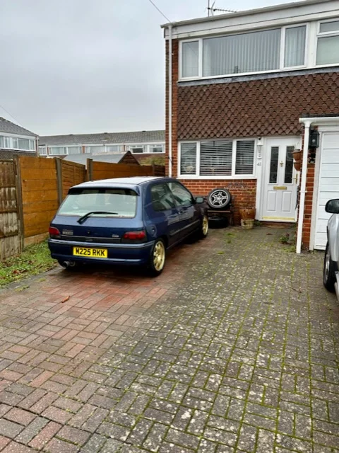

So on Sunday 18th December 2022, my best man Jez and I took a ride down to Andover to have a look at it… turned up and this was the first time I saw the car:
The car looked great, but was covered in rain so knew it was going to look better for itself! Have a look over and could confirm everything was present & correct and the engine ran sweet.
Took it out for a test drive and just fell in love with it… within 3 miles, I could see why the motoring press make such a noise about these cars! Took another photo whilst out on the test drive whilst I changed driver with Jez
Jez drove back to the sellers house and instantly commented he thought the car would be my best car should I buy it! Preferring it over my Clio 182 and Clio 200 Raider!!
So with that… I bought it! 😲
Took nearly 3 hours for the money to eventually be transferred to the seller, so by the time I was ready to drive home, the 2022 Qatar World Cup Final between France & Argentina had started, and I spent a truly memorable drive home listening to that game play out!
The car drives REALLY well and just SOOOO comfortable with those big squishy armchair seats! The only issue was I had no heater fan and you can see I’m the picture above, the centre vents are also missing for some reason..??

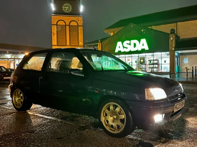

By the time we got back to Peterborough, the Megane desperately needed some petrol, so I took the chance to get a couple of photos whilst the car was being filled as I was listening to the penalty shootout play out!!!!
We also had to pick up a bit of shopping:

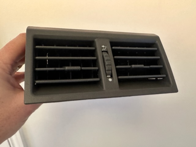

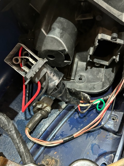

Following the drive home, I was keen to get the heater fan and Centre vents fixed, so and I took a ride over to a breakers yard near Bury St Edmunds and grabbed a few choice bits:
Including a new passenger side door as the original one is starting to look a bit crusty at the bottom!
Also grabbed the dash vent:
So with that, I got cracking on the car on Christmas Eve 2022 and got to the bottom of the shoddy attempted fix to the heater resistor loom, and made it good (this is before):

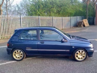

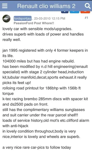

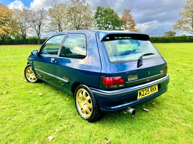

Wanted to just share what I know about the car, the advert for it read as follows:
1995 Renault Clio Williams, long mot, 127k, loads of service history, stamped original Renault service history booklet, original handbooks, a folder full of documents and old mots, a very original example, even has the original rare suit holder parcel shelf that sell for a grand alone, full engine rebuild by N.D Hill Engineering 20k miles ago, drives very well and pulls like a train, handles like it’s on rails, stops on the spot, has a stainless steel exhaust, stage 2 cylinder head, 4-2-1 tubular manifold, kent cams and bigger brakes, electric windows, electric mirrors, Michelin tyres, only ran on V-Power, if you’re fussy the rear arches could be done and the sills tidied up, or really fussy then a respray, perfectly useable as it is though, could easily be a Ā£20k car with a light resto but still perfectly useable as it is, only going up in value, super rare little cars and still continuously hailed the king of hot hatches!
You can see there’s a few points which caught my attention which I marked in bold…. full engine rebuild, Kent cams, 4,2,1 Tubular Manifold..?

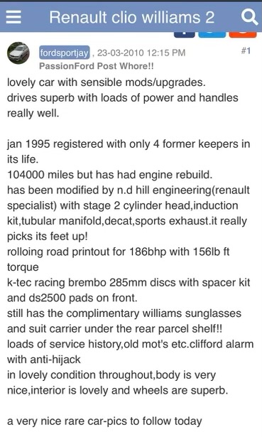

So I did a fair bit of Googling on the car, and actually managed to unearth the advert from the chap who actually sold it to the guy who sold it to me!! In his advert he wrote:
1995 Renault Clio Williams 2. FSH + MOT July 2023. Runs + drives superbly. Had plenty of work done recently, but sadly just don’t have the time or money available to carry on. Would be suitable for a restoration project, but is more than capable of being driven as-is. Couple of minor issues: Heater doesn’t work, suspect wiper motor is in its way out, rust beginning to creep in, but body work over all is very good. Open to any sensible offers or discussions.
nterestingly, the sellers phone number was at the bottom of the advert… so ever the chancer, I sent him a message!! 😬
Turns out he’s a Renault Tech at St Helens Renault near Liverpool!!! 😁 And was pleased I’d got in touch. He shared with me some more information on the car:
Hello, just standard things for a car nearly 30 years old. It’s got a bit of rust underneath and definitely needs some TLC. Couple of minor cosmetic bits inside and out as well if I remember right. Was serviced by me in July but will likely want belts doing. Actually runs and drives very well. So it would be ideal for either a long term project or just something fun at the weekends. It’s definitely not perfect but it’s not bad either.
I asked him if he knew anything about this supposed engine rebuild by ND Hill Engineering:
I know bits about it, but not a lot. The guy I bought it off was a bit vague about the history so I don’t know the full story. But I’ve kinda worked some of it out. There’s a book in the car full of paperwork as far back as 2008. I kept it and added to it with any work I did. Some of the earlier paperwork suggests that it has had bigger brakes, exhaust upgrade, couple of engine bits and a bit more. Also, if you look at the engine bay picture, you’ll notice at the top of the suspension is 3 drilled holes on each side, suggesting there has been a strut brace there at one point. Some of the clues hint towards racing. Or track use of some sort. I can’t remember how much of the paperwork has details of engine work, but the guy who bought it off me did his own research and found an old advert for the car from 2010 which had a bit more detail. I’ll see if I can find that for you now:
Hmmm… sounds interesting!!! But also a little spurious! You know how hard it is to get more power out of an NA car… well this advert states 185bhp up from the factory 150bhp… that’s some going!?
He then sent me a load more pictures of the car from when he had it.
I was very quickly getting a good bit of detail in this car!! As I was looking at the car, I did an HPI report and found that the car wore the registration K60 FRY from 9th May 1997 - 19th August 2020, and found a picture on Facebook of it:
Shame, I've always thought that spoiler was a poor effort, ruins the car for me.
Nd hill aka Hill Power. Very popular mk1 tuner back in the day.
Had my old williams 2 down there a couple of times.
These engines always responded well to cams. Most willys on the rollers were making close to 160bhp.
Oh wow, so there might be some truth in that statement then @Daz?? I must admit, she really does pick herself up and shift down the road when you give it some..!?

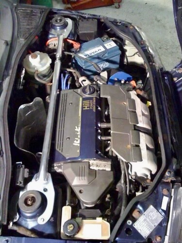

And MOST IMPORTANTLY, sent me a picture of the engine bay:
So I can now see how the engine bay looked following the Hill Power engine work that was done, and I can also see the reason for the holes in the strut towers, a Sparco Strut Brace.
RIGHT after I bought the car, I had a punt on a strut brace that was advertised on eBay that looked like it might be the right one:
Well bugger my old boots!!! Looks like I’ve lucked out with that strut brace now šŸŽ‰
BUT… Flippin YODEL appear to have lost the parcel in transit 🤬🤬🤬🤬 Fingers crossed they can find it.. šŸ™„
Back to the engine, the valve cover isn’t blue anymore, but it does look as though it’s had some work polishing it up… so I’m guessing somewhere along the ownership, someone stripped the blue paint off, to return it to somewhat standard??
Going to have a couple of days on it this weekend and do a couple of bits & pieces. Will report back.

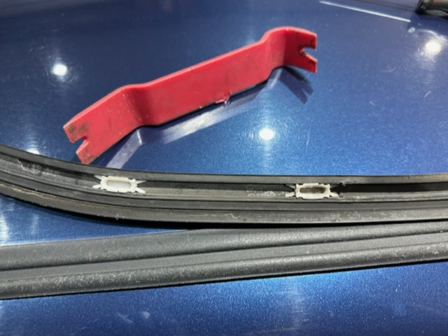

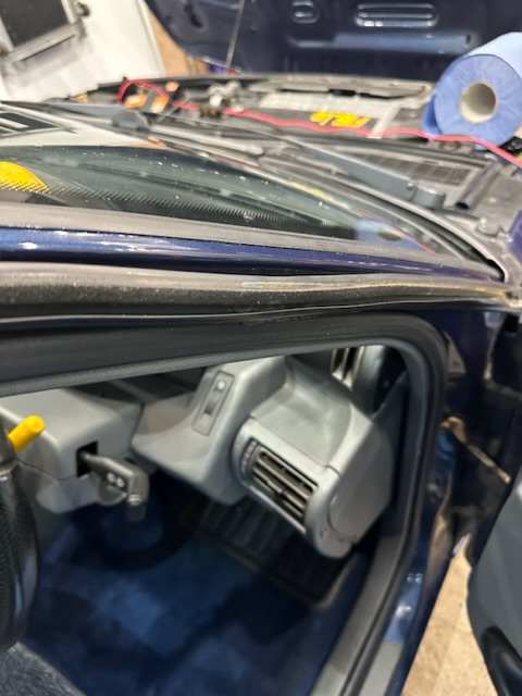

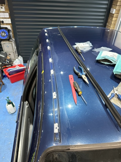

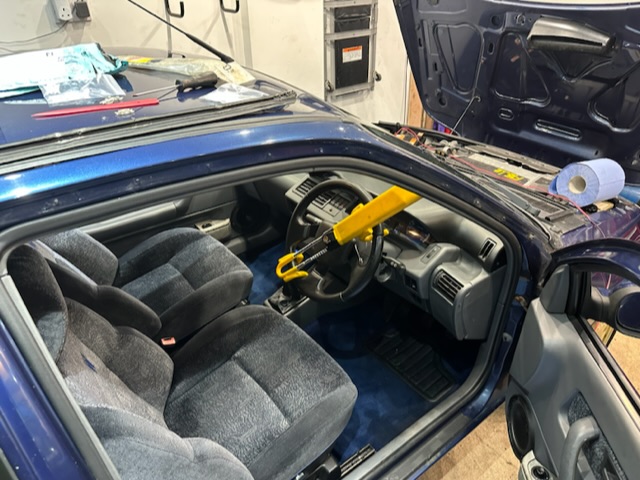

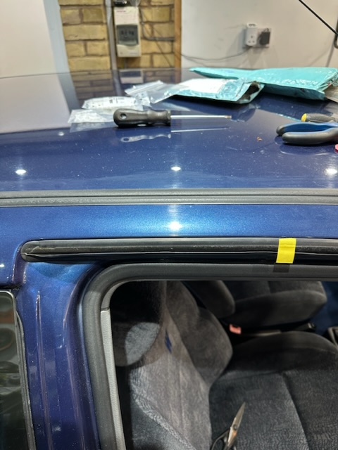

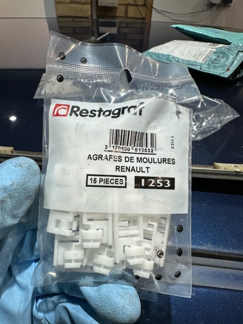

Wanted to improve the way the roof trim and upper door gasket was fitted to the car, they weren’t quite sitting right:
Whipped the door seal off, and sourced some new clips from eBay:
The reason it wasn’t quite sitting right was a combination of rusting metal substrate within the seal, and broken clips.
Gave it a bit of tlc and a blob of tiger seal where it wasn’t playing ball… and it was soon looking better for itself:

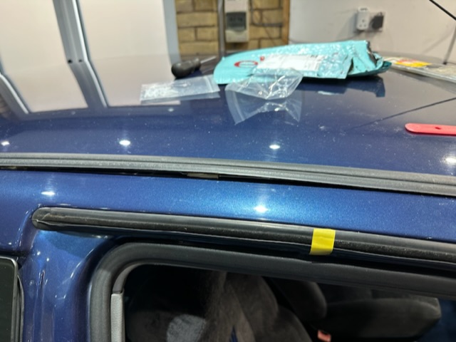

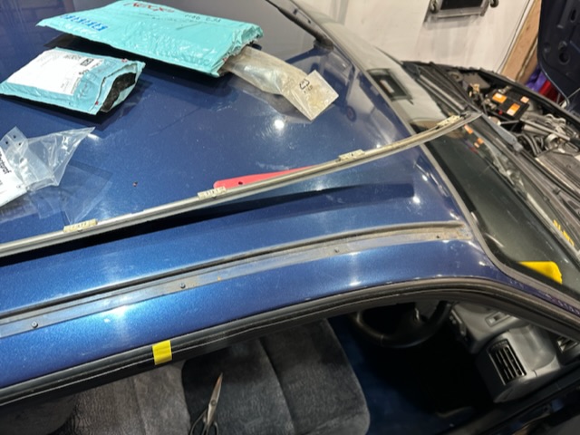

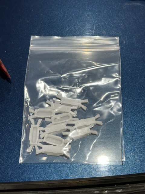

Roof trim was again just broken clips, again managed to source some clips from eBay:
Pulled off the old clips:
Fitted the new clips:
Then it was soon back on:
Looking a lot better for itself now.

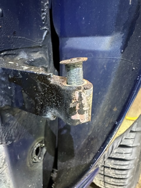

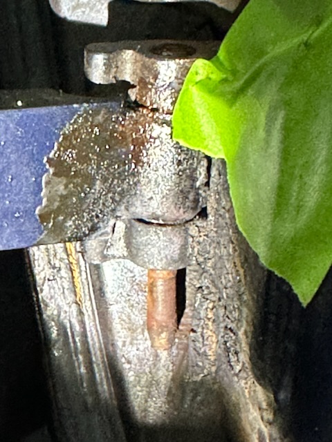

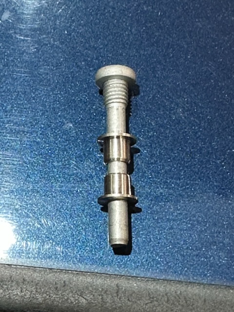

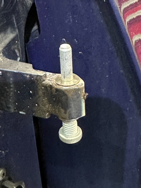

Drivers door is suffering from the usual Renault dropped door syndrome.. šŸ™„ so I bought a pair of new hinge and bushes from CGB in Telford:
Just a case of whipping the old hinge pins out, and replacing with the new stuff..
WHY DO I KID MYSELF THESE JOBS WILL BE THIS EASY…!??? šŸ™„

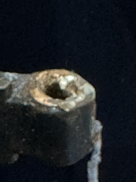

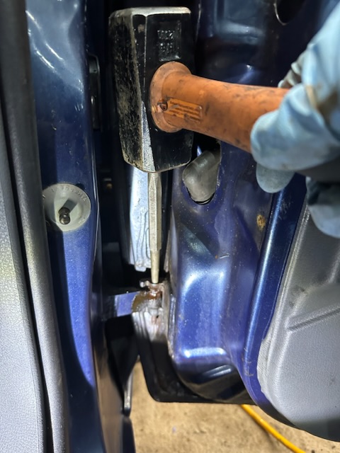

Of course, the old pins had rusted into the hinges on the door, so when I tried to remove them, they sheared at the end of the Impact Gun I was trying to undo them with:
So faced with the remaining bits in the hinges, out came the hammer and chisels:
Then the Gas torchšŸ”„:
And finally I managed to get the door off:

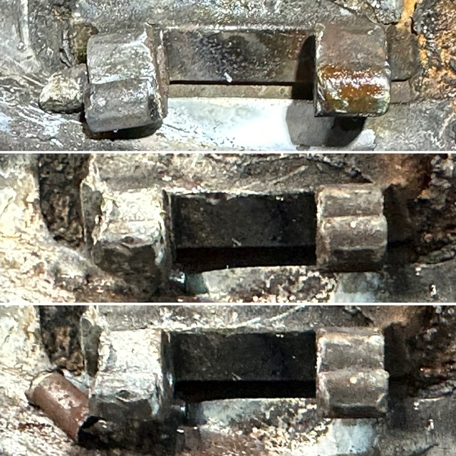

I was sick of hammering, so I thought I would make the hinges on the body right first. Just a case of drilling/driving the old bushes out:
And then dropping the new bushes and pin in:

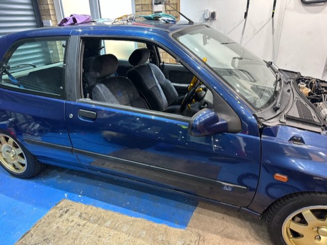

Was sick of it at this point. So just left the door off and decided to go back to it another day:

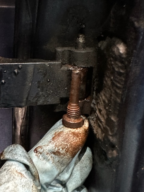

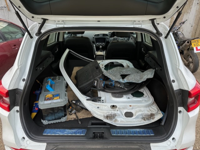

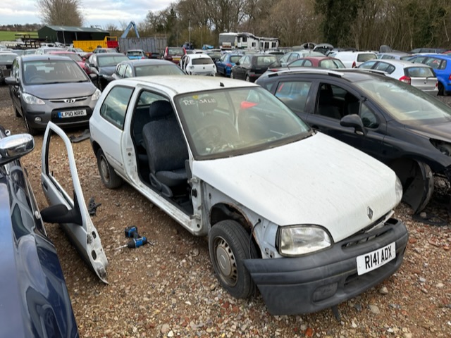

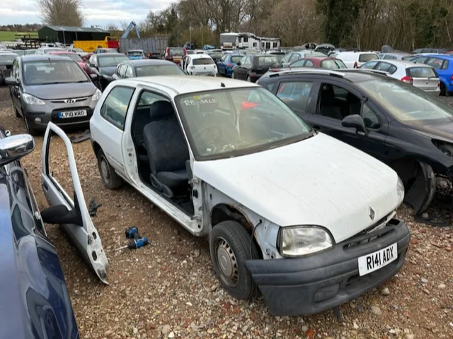

Following the saga of the drivers door, I couldn’t resist the opportunity to get hold of the minty door off a low mile breaker at a yard in Bury St Edmunds, so dashed over there and grabbed it:
So I’ve now got BOTH doors from that car, which should put me in good stead for the rebuild of this car.

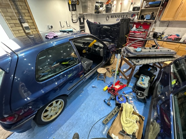

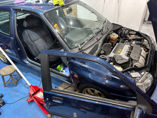

After a week off, I got back into the garage today with the bit between my teeth to decide if I was going to fit the new doors now, or get the old one back on?
Following a LOT of hammer, gas torch and drill action, I managed to get the last piece of pin out of the door hinge:
and managed to get the original door back onto the car:
So is it better…? NOPE 😔 But I’m pleased I’ve done the donkey work now which will let the new doors go on easier when I do get the bodywork done.

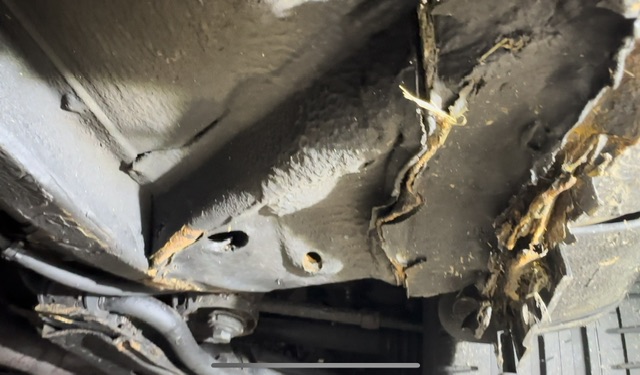

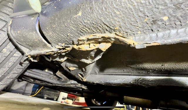

Whilst I was in the garage, I took a few photos of the sills to help my welder get a better idea of the work needed:
Looks like some monkey has just been going HARD with the trolley Jack.. šŸ™„šŸ¤¦šŸ¼ā€ā™‚ļø
But hey ho, everything’s fixable…!
