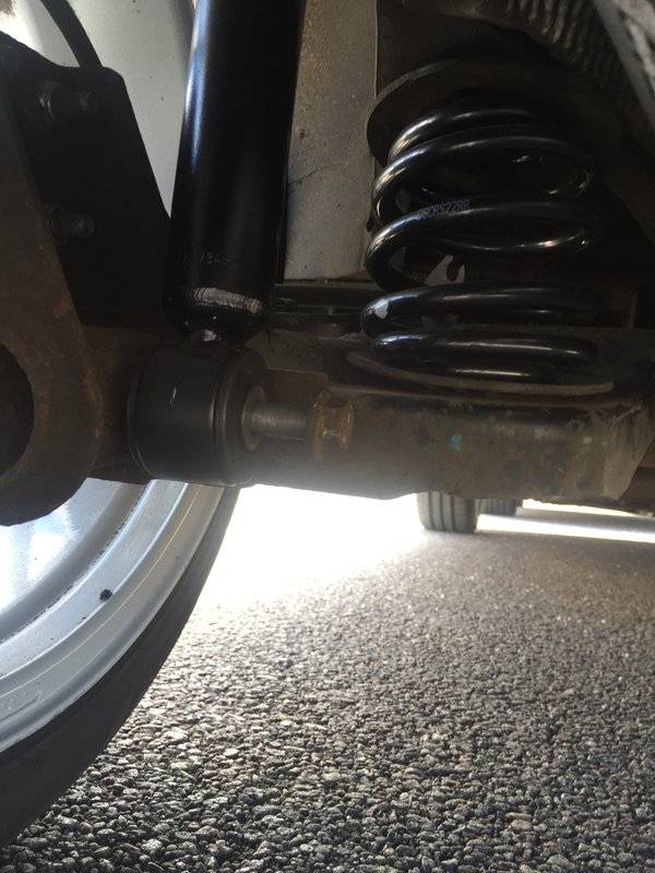

Upon inspection I discovered the knocking sound was a result of the rear damper bolt having worked itself fully loose (it was almost hanging out, which could have been devastating if it had fallen out on the M4 at the speed of circa 70Mph which I was travelling at shortly before!!!) Not great.
Anyway this was a simple fix and I nipped it up by hand then used a spanner from one of our Engineers to tighten up properly. I was pretty unhappy at this point because I have to wear smart attire to work so this was the last thing I wanted to be doing. A simple mistake on Chris's part I suppose, and upon discussing he assured me that all bolts had been properly torqued. It goes to show that you should always double check your work especially on key areas such as the suspension. That aside, I got it home last night and set about getting stuck into the other jobs.

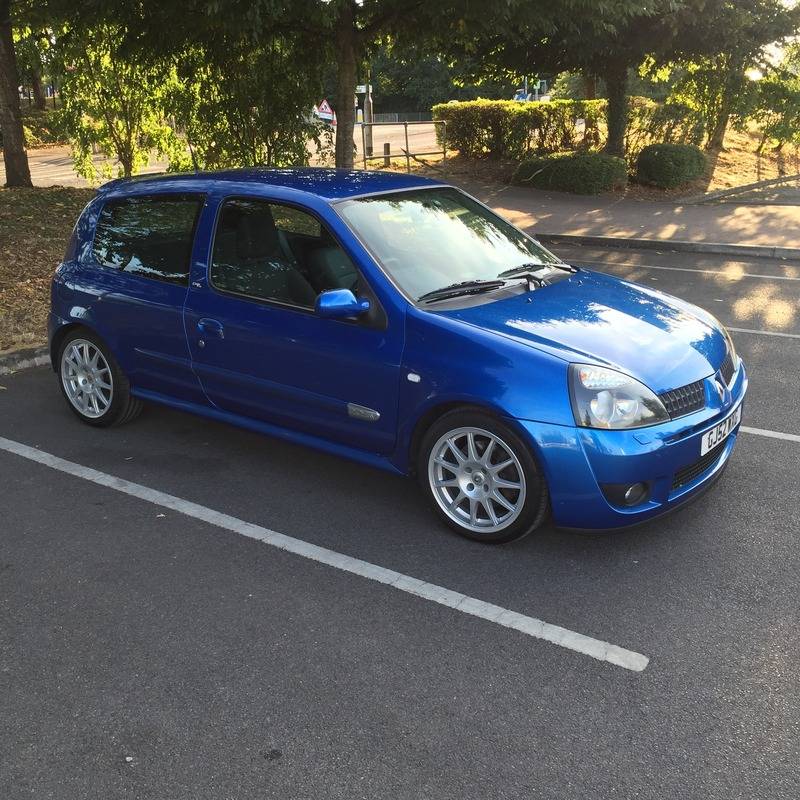

Parked up at work, with sunscreen protector in place to protect dash / steering wheel / interior from this hot weather:
Loose rear damper bolt:

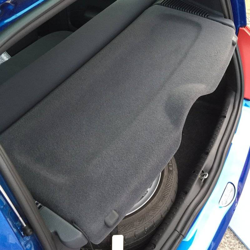

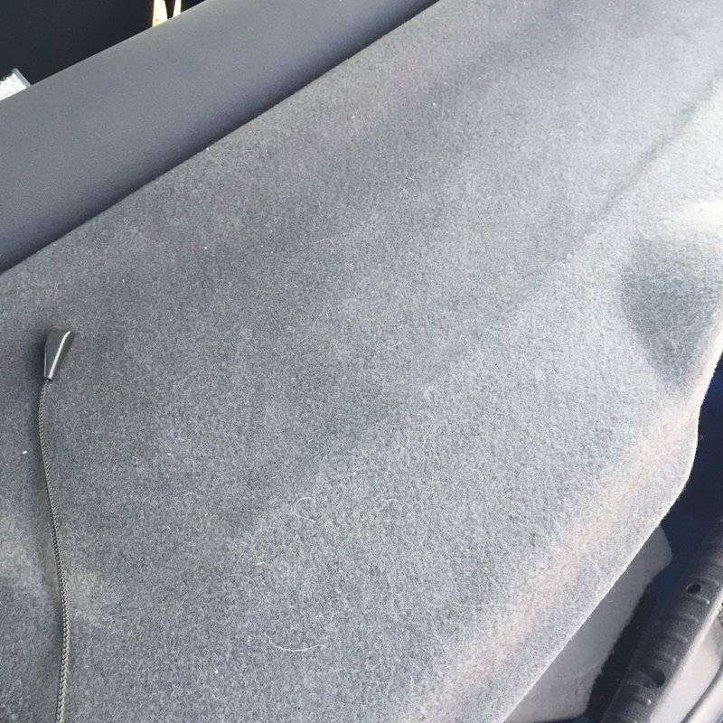

Start on Parcel Shelf, a bit hairy and in need of a good clean:
All done, it's important not to rub the fabric pile too vigorously as it's quite delicate and prone to damage:

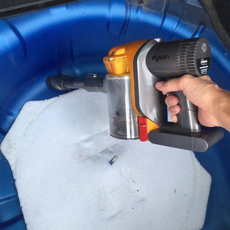

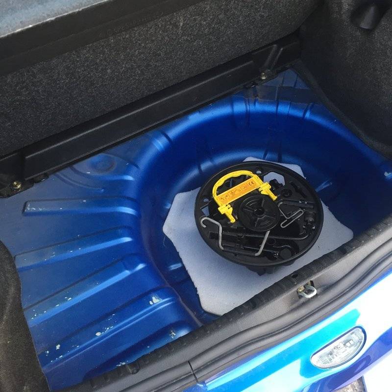

Hoovering out spare wheel well:

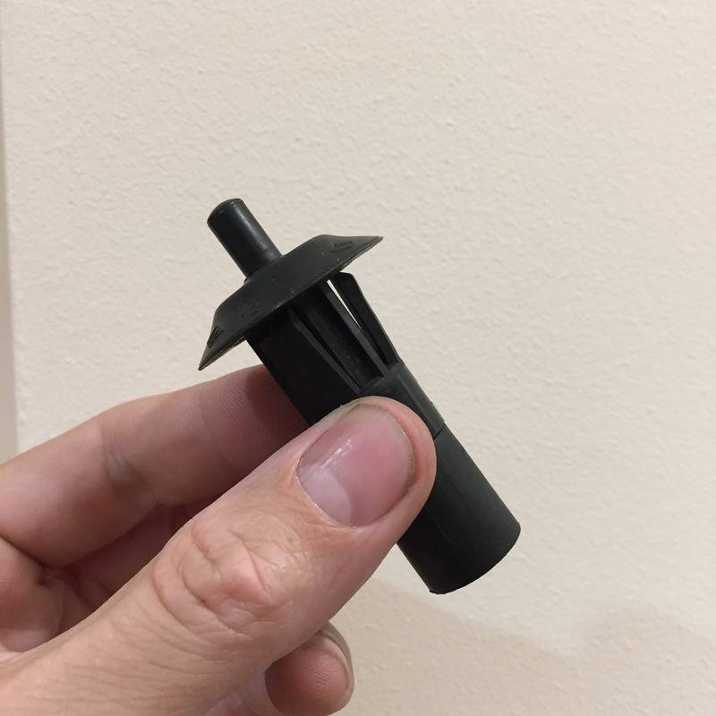

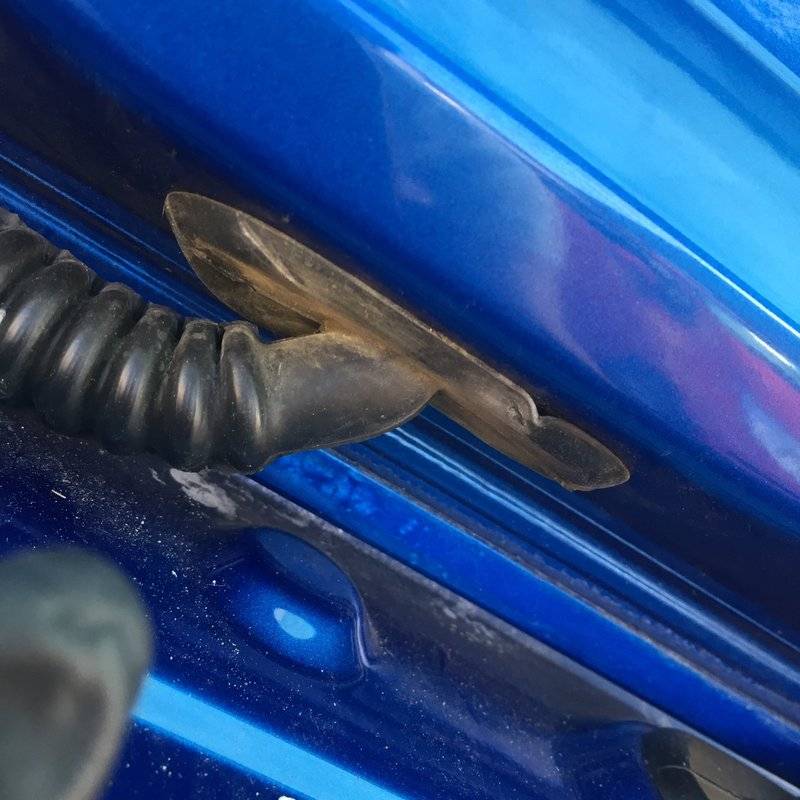

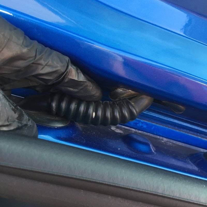

Rear wiper wiring grommet had been bodged into place so this was corrected. It was also cleaned but no pic of that:
Correctly inserted, it's a little pulled on one area but it seals fine:

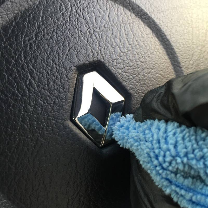

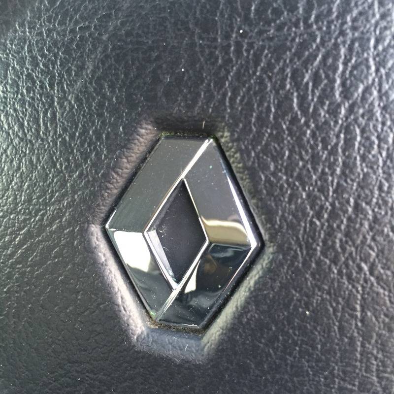

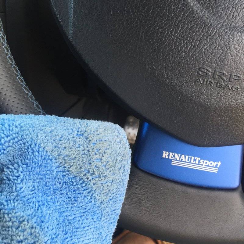

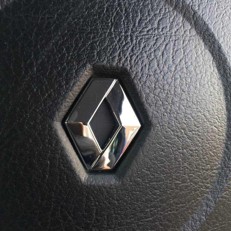

Cleaning Steering Wheel:
Some more,

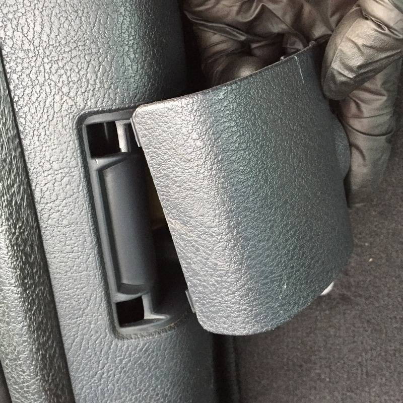

Cleaning out dust / debris from door handles inserts:

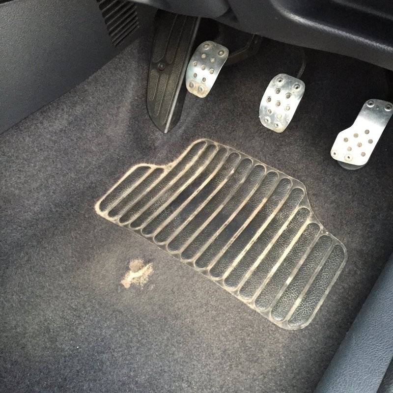

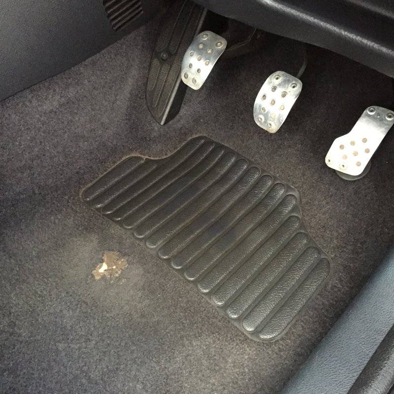

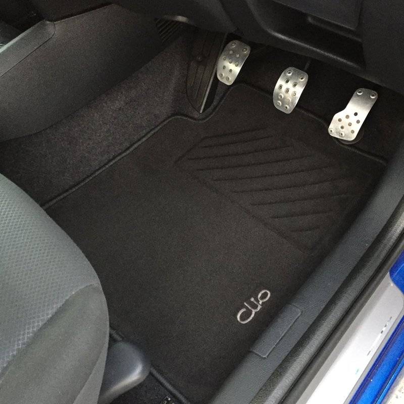

Some heathen has worn a hole in the floor carpet by not having mats in place previously, but this has been cleaned and will receive further treatment in due course. Also considering Renaultsport mats as they are in fact the correct type for the car.
What I began with:
Part way through:
Complete:

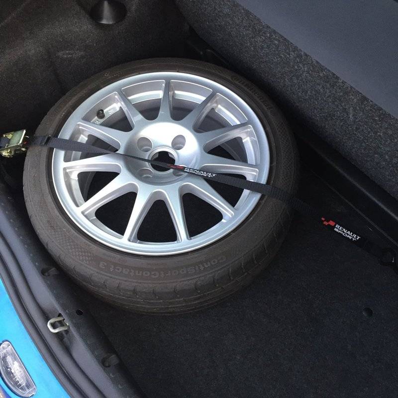

Got my spare Turini strapped in with an RS ratchet strap from my Trophy R, to avoid it moving around during transit and scuffing up the interior carpet. It doesn't quite fit in the wheel well and I don't fancy the repair kits as they don't work and ruin the tyre and make a right mess of the alloy wheel:

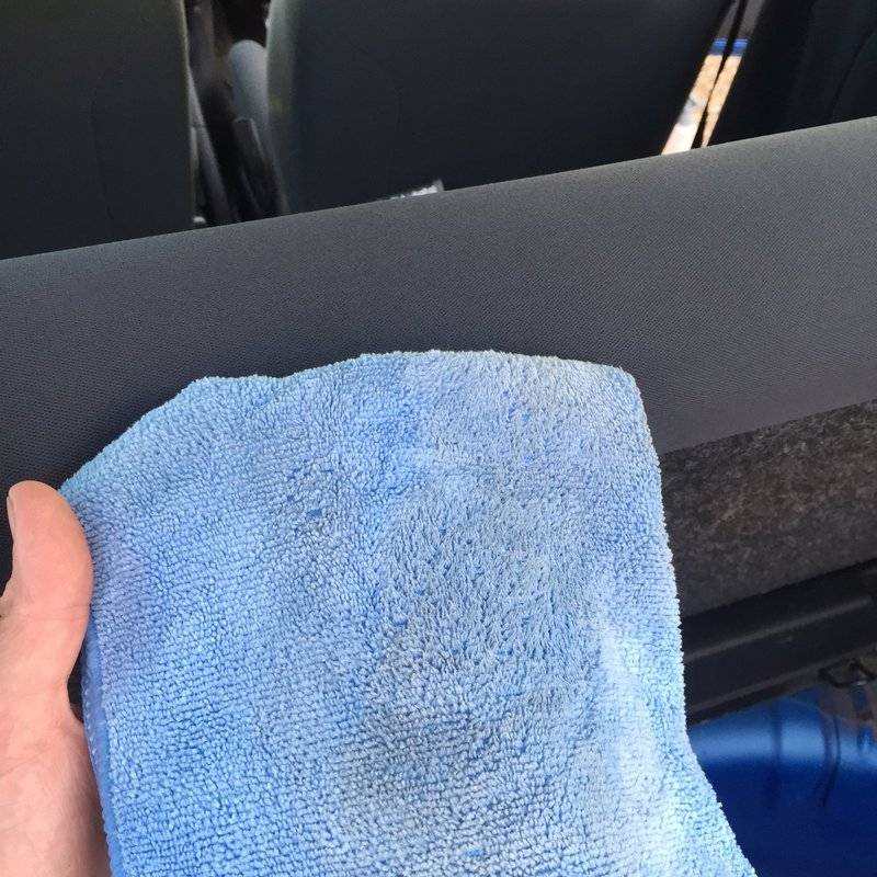

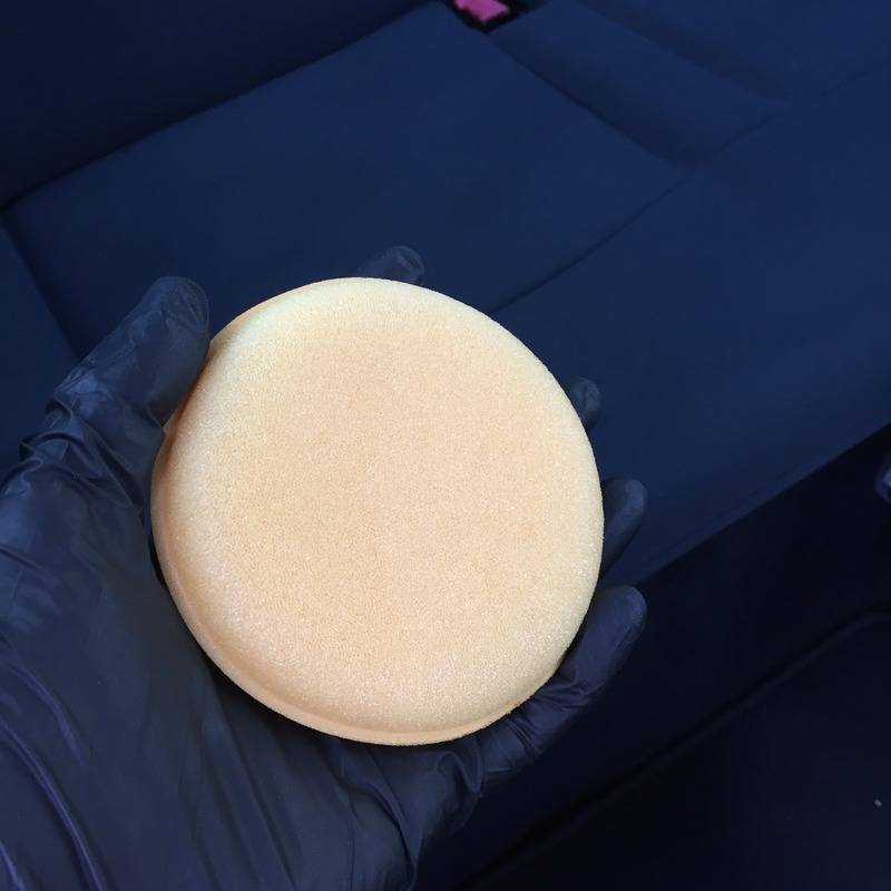

Cleaning of top part of rear bench. It looks clean to the untrained eye but a pass with some Megs QD (gentle dilution for interior work) and MF reveal otherwise:

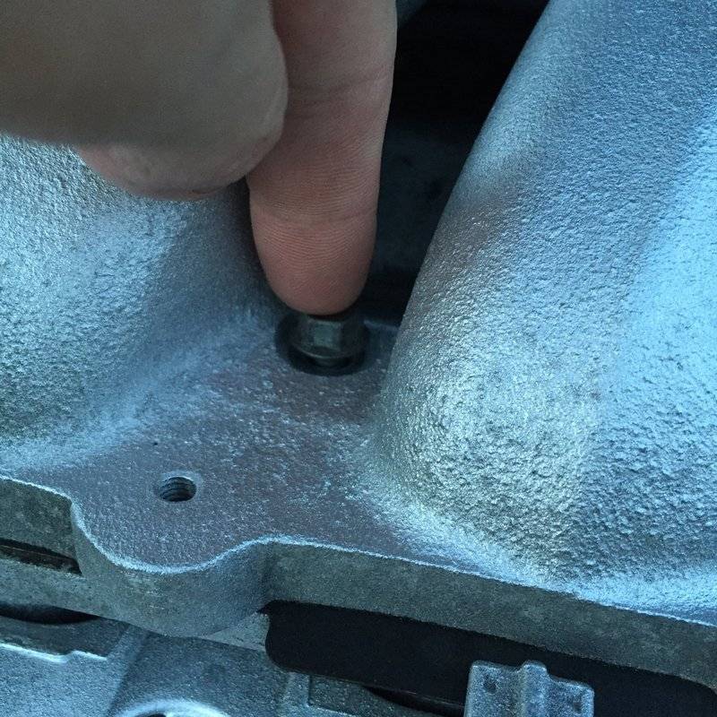

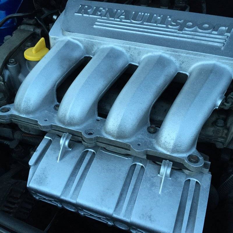

Intake manifold bolts inspection, I need OEM replacements, and will probably lose the micky mouse paint finish as I prefer a factory OEM finish so may vapour blast this. We shall see:
As you can see above one loose bolt and one missing....

It was very close, only saved by my good fortune and the fact I checked it at lunchtime. If I'd have driven home like that who knows what could have happened.

Wouldn't be surprised if the threads are stripped and that's why the bolts been left out on the inlet. I had to helicoil 3 of them when I changed my spark plugs recently
Don't think they're stripped as I've put some temp ones ni and they bit nicely, just another forgotten item I think...
I've ordered some replacem,ents
Furthermore, if you look at Chris's build thread the bolts are all in place and present in the both photos, so they've been removed after these photos were taken.
Perhaps i'll ask him if they were removed by the mechanic who checked the timing, why this would be the case I do not know, however, it could be possible, and the guy who checked the timing is supposed to be 'the knowledge' on RS Clio's, so this level of sloppy absent minded workmanship would not be something I'd attribute to an 'expert', something doesn't stack up....
That's a good thing a suppose! As I say you need to separate the inlet to access the spark plugs so if they were testing compression or something that would make sense as to why it was off. Seems a daft design really but the other FWD cars ive owned had the exhaust coming out the front.

Get on to Ebay and order some M6x20 stainless or yellow zinc bolts for the inlet, buy a 50 quantity bag as they are used extensively and is a great way to tidy up the bay. Have you got some pics of your Trophy R you mention. Looks a lovely car.

RE the rear bolt, that's not good but these bolts often need a tap running through into the beam as they can stiffen up very quickly. All the crap and rust sits in the beam and stops the bolt going in properly so I don't doubt it was torqued up, it just wasn't screwing in properly! I'd remove it and run a tap down it personally.
Will have just been the vibrations working it out.

Salient point being, that if that bolt had come out on the Motorway at 80MPH then I could've been killed, or worse, killed another motorist, I don't think you can appreciate the gravity of the situation.

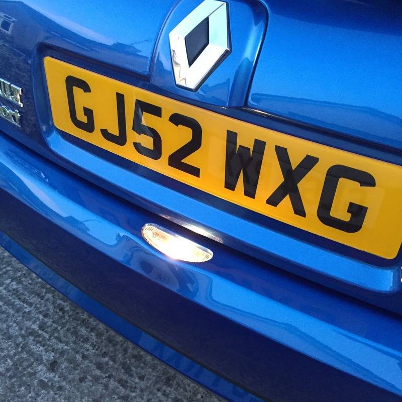

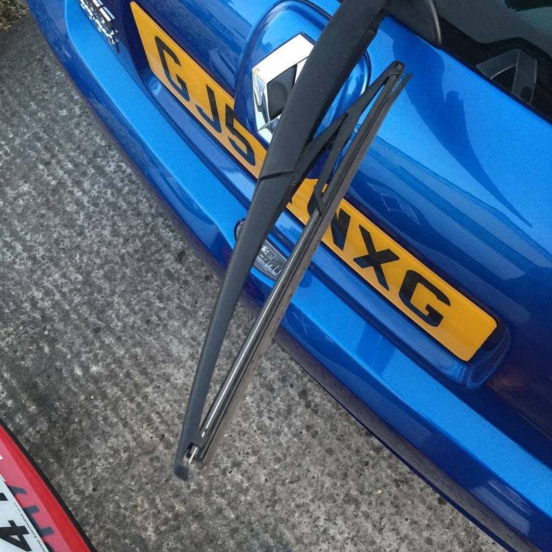

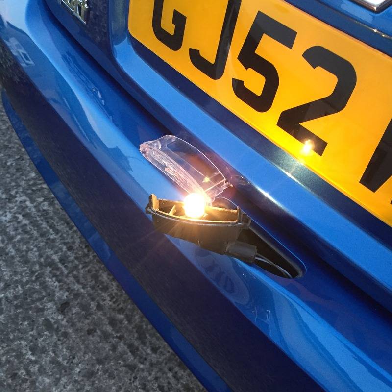

More progress last night, new wipers and new number plate lamp. Also set about adjusting the exhaust as it is touching the bracket which is causing the annoying resonance, but it will have to be redone when I have more time as it is not a Renault OEM part, therefore the hanger needs to be 'persuaded' to allow some more clearance. God I hate exhausts! :) I might even explore the possibility of installing a BTB but they're circa £1K.

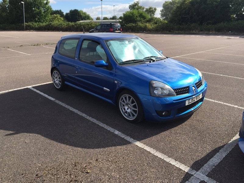

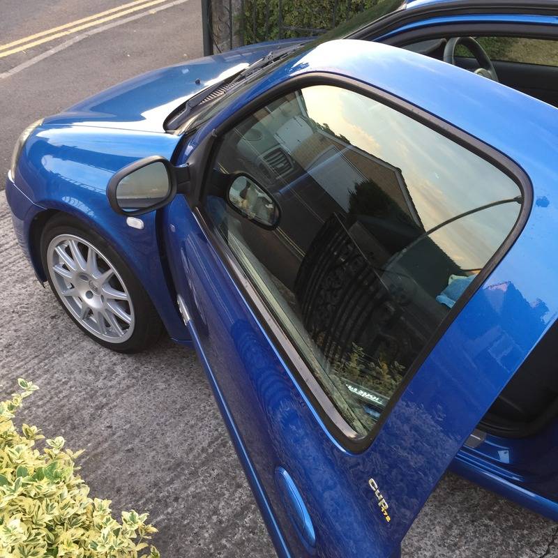

A couple of pics of the car externally:

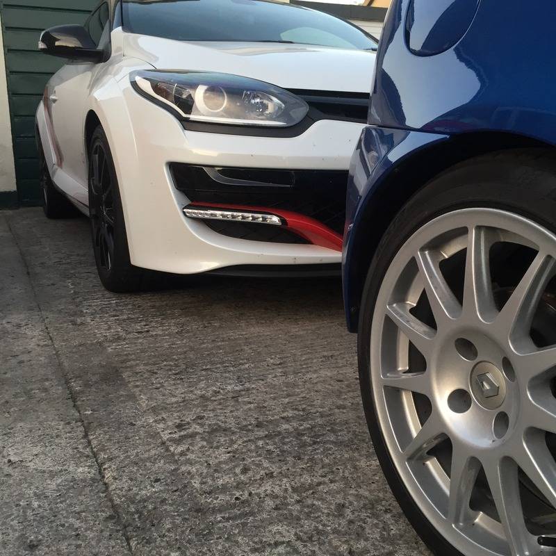

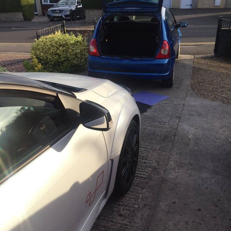

Big brother:

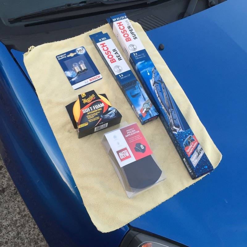

New parts, and some accessories for cleaning it:

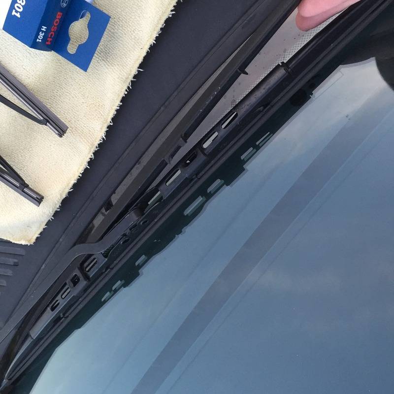

Wiper installation, old broken one (excuse upside down photo):
No pic of new one fitted yet!

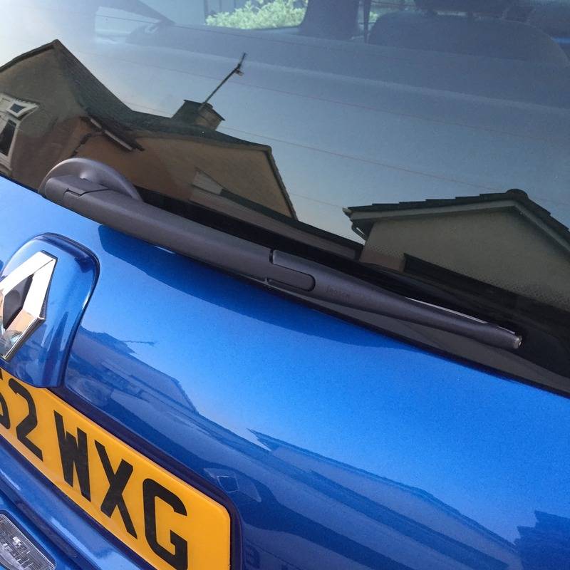

Old rear wiper:
New one fitted:

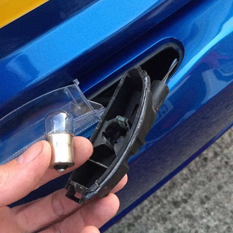

Numblerplate lamp:
CHECKED and working:

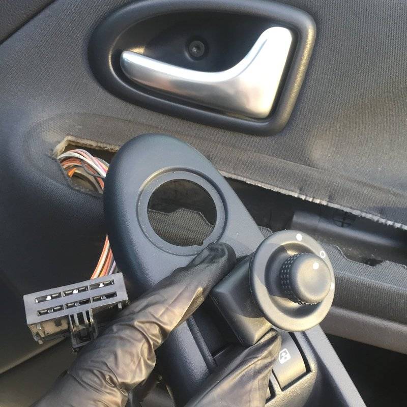

Another strange anomaly is that the electric mirror switch appears to be at fault. At first I thought they weren't working at all, but they are, just that the when the right side switch is selected it adjusts the left mirror and vice versa, so unsure what's causing this, any ideas? I suppose it could just be down to the vagaries of Renault electrical systems, but I'd like to resolve it if possible.

Regards the the mirrors would it be as simple as swapping relevant wires around?
I’m sure I remember someone on here having an issue, forget what the outcome was now :/
I thought initially the switch button had been installed upside down but I checked last night and that is the only way it can be fitted, not sure what else it could be other than a wiring discrepancy?

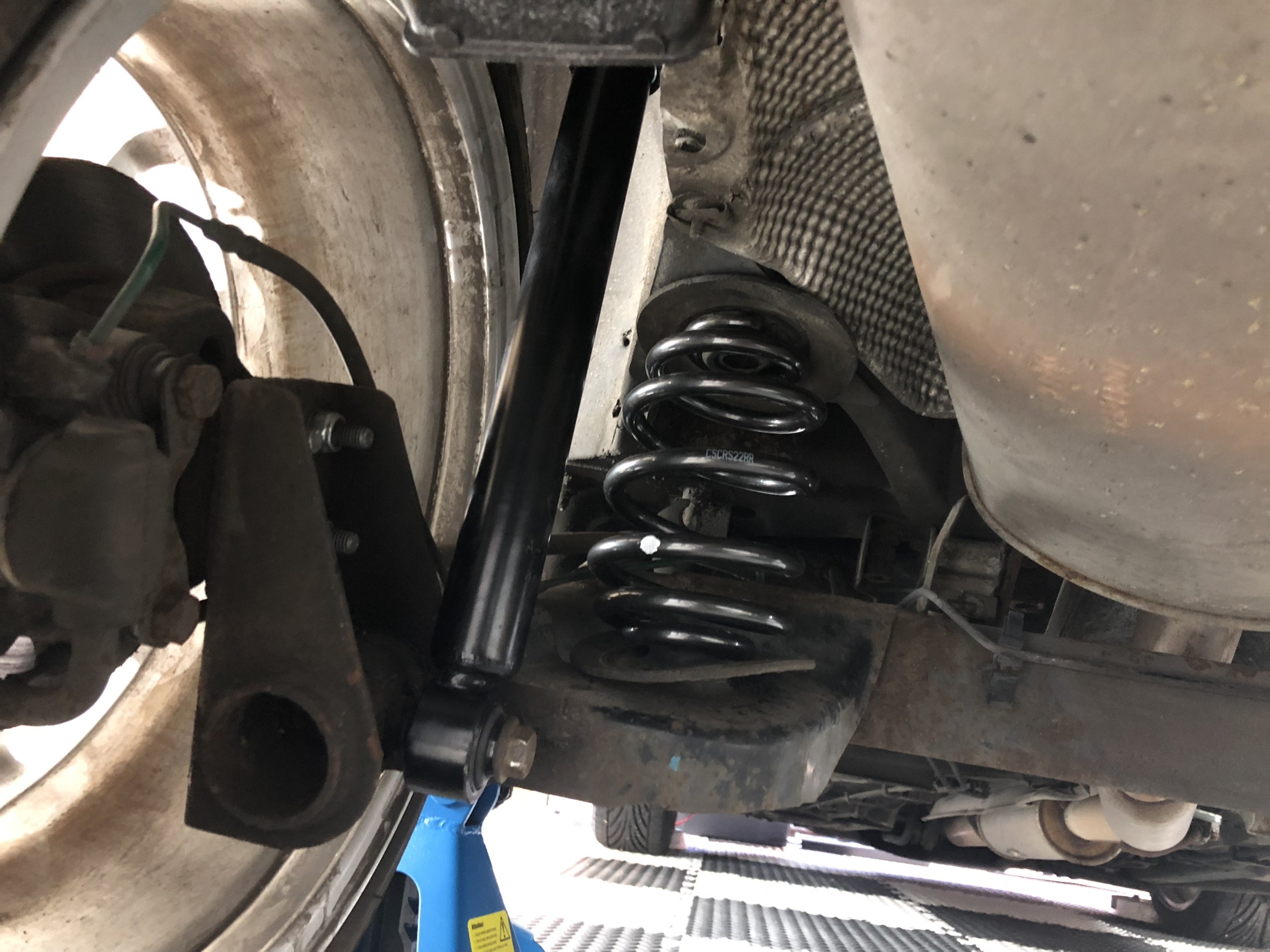

I checked most other bolts on suspension and haven't had time to do them all but I will do. Nipped up a few that were fastened but not quite as tight as they should be, but otherwise it was ok.
The sensors point into the car from the pillars by the windscreen as normal. There is a dash cam fitted (would've been able to put my demise due to loose damper bolt on youtube 'lol) so I'm not sure if the wiring of this has somehow cocked up the rest of the electrics? This was fitted before Chris owned the car just to clarify, not having a pop there!
I would imagine its fairly easy to strip the rear beam threads for the shocks if you don't support the beam when un-doing them and un-do them slowly as the beam will just fall down and the bolt could get stuck in the thread, I think I made this mistake when I first did mine a few cars ago but was lucky enough not to destroy the thread.
100% not stripped or threaded, just not tightened correctly. I've had a thorough inspection, but yes I can see how this could be done. Same set up as a Saxo in terms of the rear dampers.

The mirror switch does exactly the same on my Cup and previous ones I have owned. I have replaced my door pulls on most of them with the non-sticky ones from a basic model. I still have the old handles and a few switches so might try them and see if the origional switch is any different.
I'm pretty sure some cars came with the switch pointing the other way so it may have been replaced at one point as the 3 dots are meant to be closest to the dash
I wonder whether it's because Chris swapped out the handle with a base model Clio that it's different? My wife had a Clio years ago and I can't remember whether that had the three dots facing down or up...must be a logical explanation for it anyway.

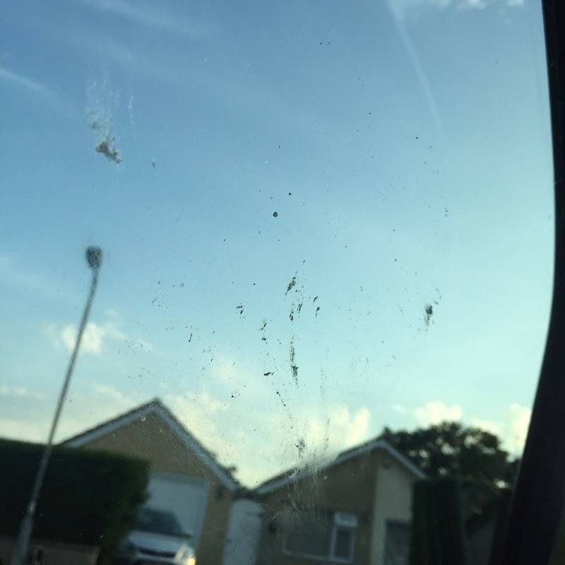

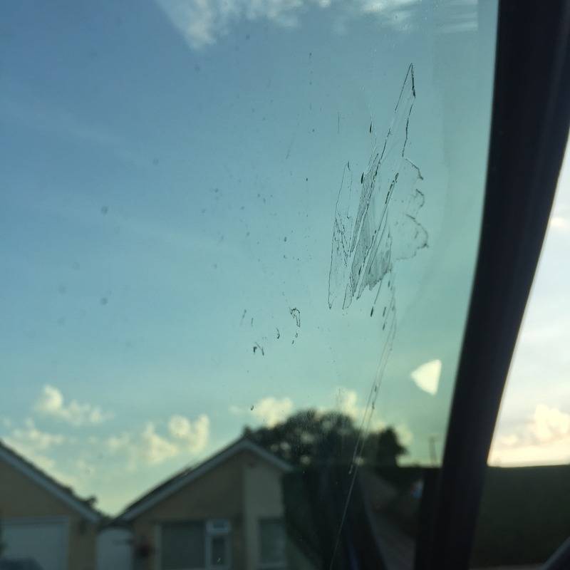

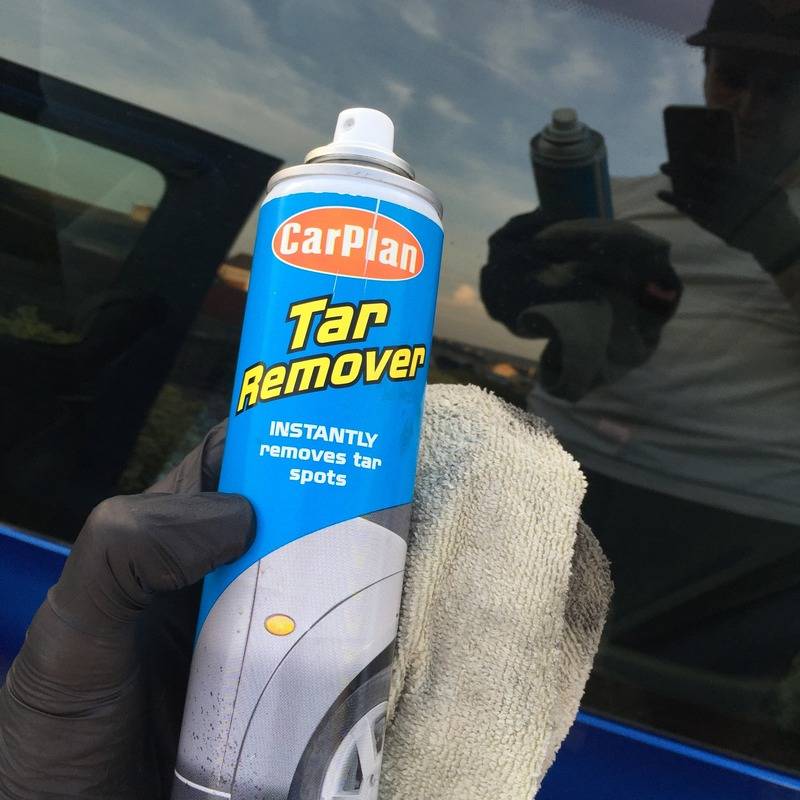

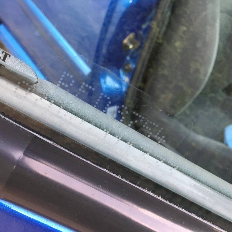

Last night saw the ticking off of a few more small jobs. There was some kind of sticky sputum / glue residue along the top edges of the driver windows which I can only assume is from window tints (shudder), so I set about cleaning this off with some strong solvent. There was also glue residue from the old window stickers along by the A pillar so I cleaned this off too. Looks heaps better. I also cleaned the fabric on the door cards as there was ingrained dirt and grubbiness on the drivers side (again not particularly visible to the untrained eye but obvious under close inspection). There was also some detritus in the edges of the badge nook on the steering wheel so this was dispatched too. My goal is to get the car as mint as possible.

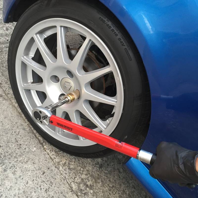

Following on from the previous loose nut debacle, I thought it prudent to check the wheel bolts were torqued correctly....mostly they were just ok, but all needed to be nipped up to the correct setting. One locker was also frighteningly loose, but in fairness to Chris he did have new tyres fitted so one can only assume this was down to the muppets who installed those. You just cannot get the staff these days!

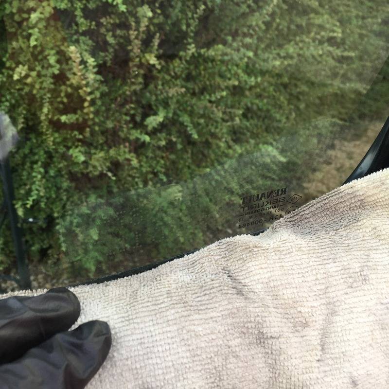

Window residue:

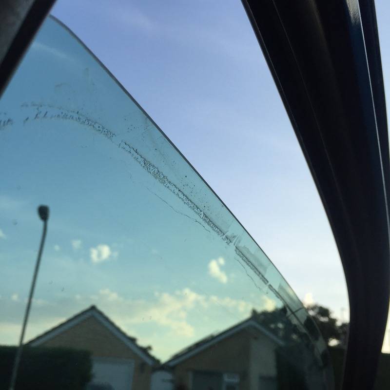

Window sticker residue:

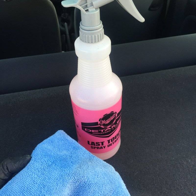

The solution I used to remove it. If you buy some of this be very careful as it's particularly potnent and the vapour should not be inhaled, also be careful not to get any overspray on plastics as it could quickly damage them:
During removal:
All gone and looking much better:

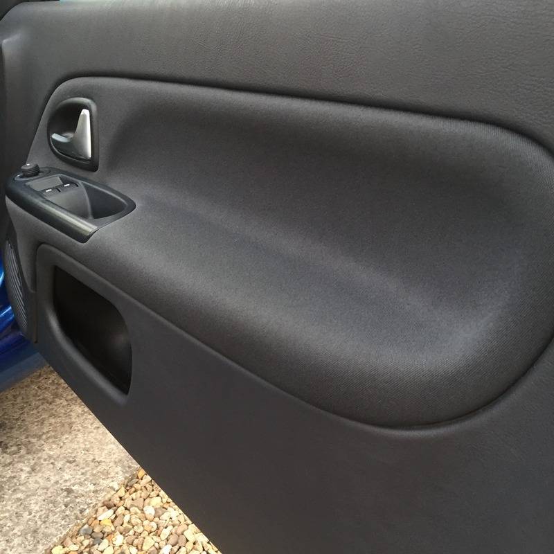

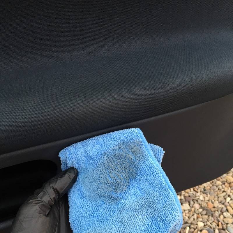

Cleaning of door card fabric, most of this dirt was overlooked during previous 'detailing' processes, you can see what has come off on the microfiber!
All done and looking much better:

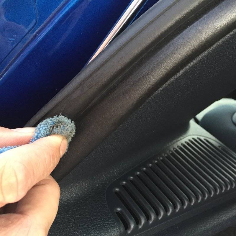

I also cleaned the nooks and crannies of the plastic trim along the footwell edges:
Checking and nipping up of wheel nuts:
They are all good now so the last safety checks are to go over the suspension bolts during the weekend. It will then be onto external detailing, exhaust correction, and engine bay tidying and addressing of finishes.

Also what did you use to clean the cloth on the door cards?
Correction to my post above, glue was on both windows not just drivers side hence photos of passenger window!

On the doorcards I again use the Megs detailer, it's a gentle solution but just potent enough to remove stubborn dirt and it does not foam up loads and create lots of work to remove unlike AG interior shampoo. Just don't rub them too hard as you'll damage the pile otherwise, it's quite delicate. It's not the stuff you buy from Halfords though it's the large 5L bottles available from detailing companies online, and it is a different type of solution.

ok thanks,i need to give my seats and cards a clean,i was thinking of using the AG stuff,but may look into another one now.
I believe it's just the interior ones.
