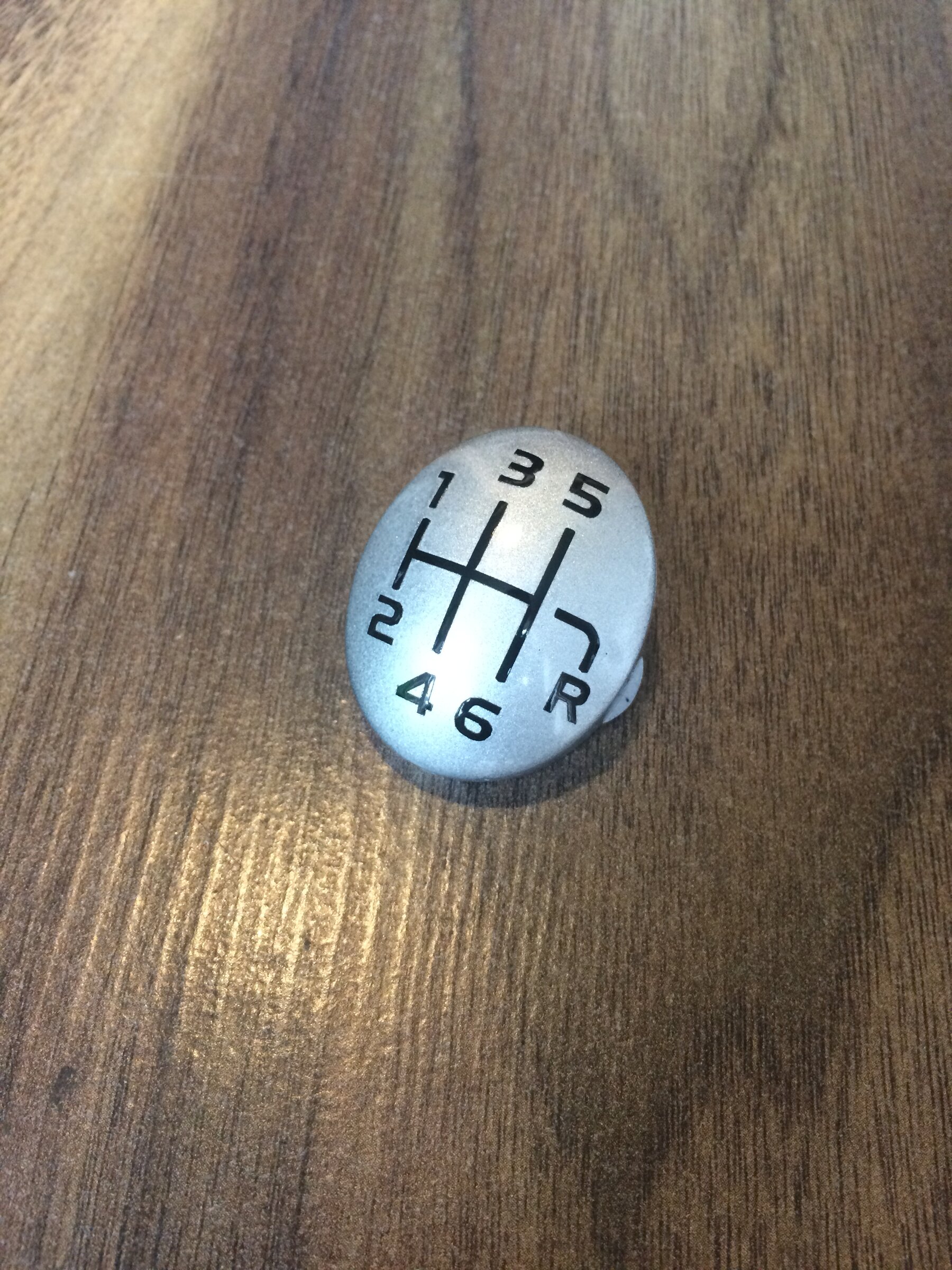

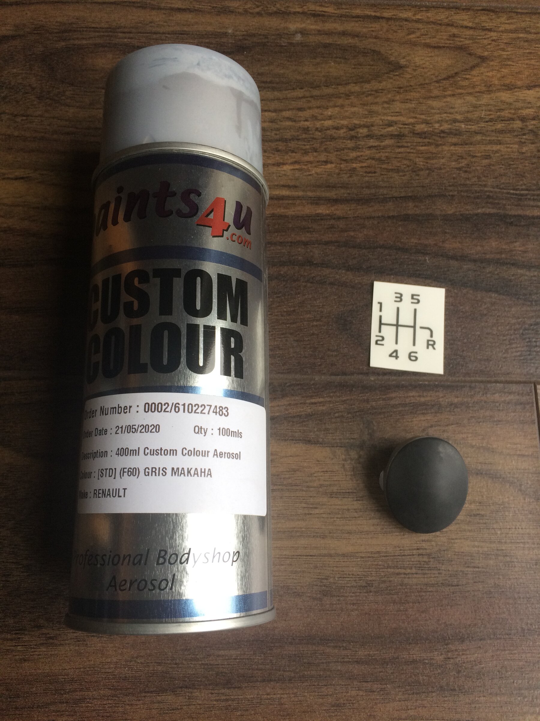

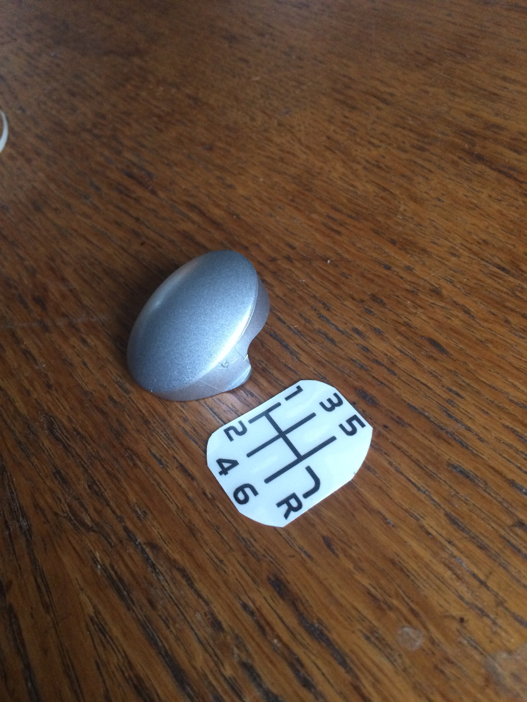

Also re-did the gear knob insert:

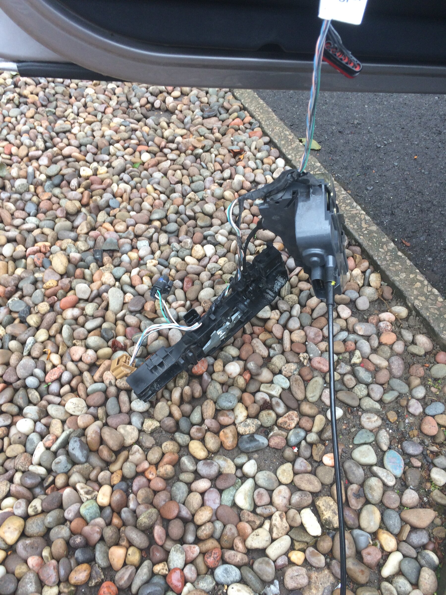

And installed a new passenger door lock mech as mine was sticking. Cost £7 and 30 mins to fit - very satisfying quick cheap fix :)

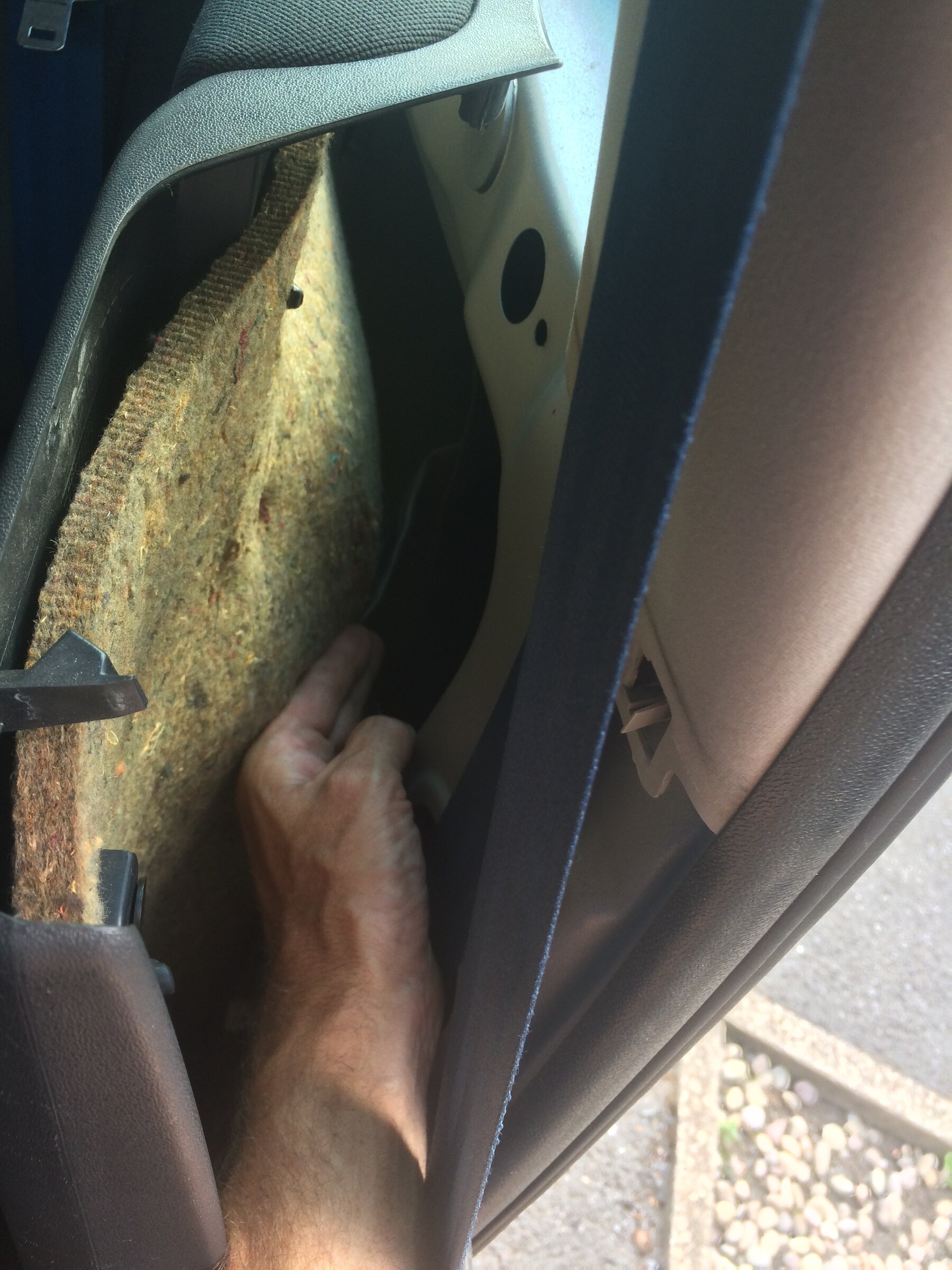

how do the side strips come off the doors and rear quarters?
Same as the clio mate
Push the rear quarter to the front and the doors to the back
Actually it’s far easier and you don’t break clips on the rear by doing it this way:
Prise rear card off and reach inside:
Teach down and you will feel 3 fastening tabs. Just simply squeeze with the fingers and they release the trim:
Takes literally 2 mins and nothing gets broken.
The sliding method can break clips and also damage the paint if you have to knock it.
Fronts are the slide method but one thing you need to do to stop you breaking a hidden clip is take this grommet off and push a screwdriver in to push the clip forward and then the trim slides off towards the back:

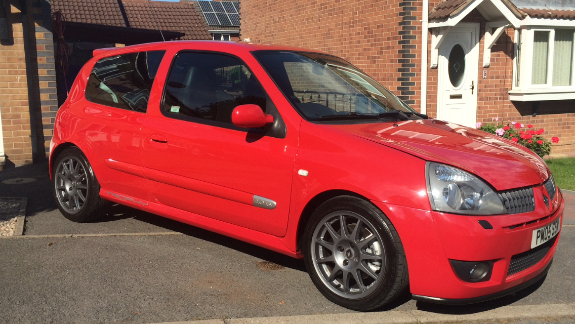

Hi mate, just wondering who you use locally for paint? My mum has clipped a fence in her Fezzy and needs rear quarter/blending.
Hey mate, I use a chap who is 10 mins walk away in Holbrook and will be about the same distance for you.
His name is Jon and has a small unit next to the Mercedes breakers and the gypsy camp, opposite side of the road to Bankside Tackle shop on Holbrook industrial estate.
Don’t use Spraytek - they’re super sh1t!!!!
His number is 07900 992255. Tell him Clio man (Paul) has recommended you ;)
He’s very good and sorts anything you’re not happy with straight away. He does a lot of concourse VW stuff and has an awarding winning Golf mk 1 himself.

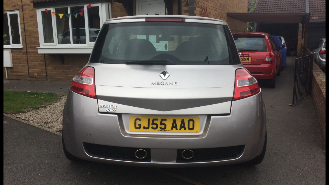

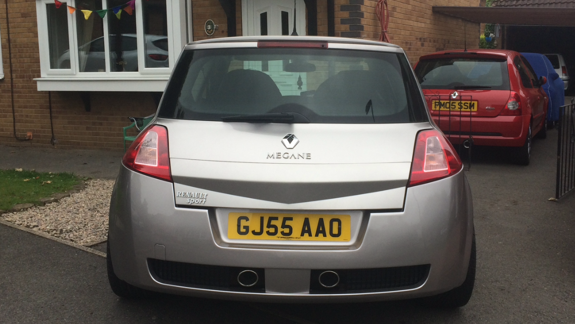

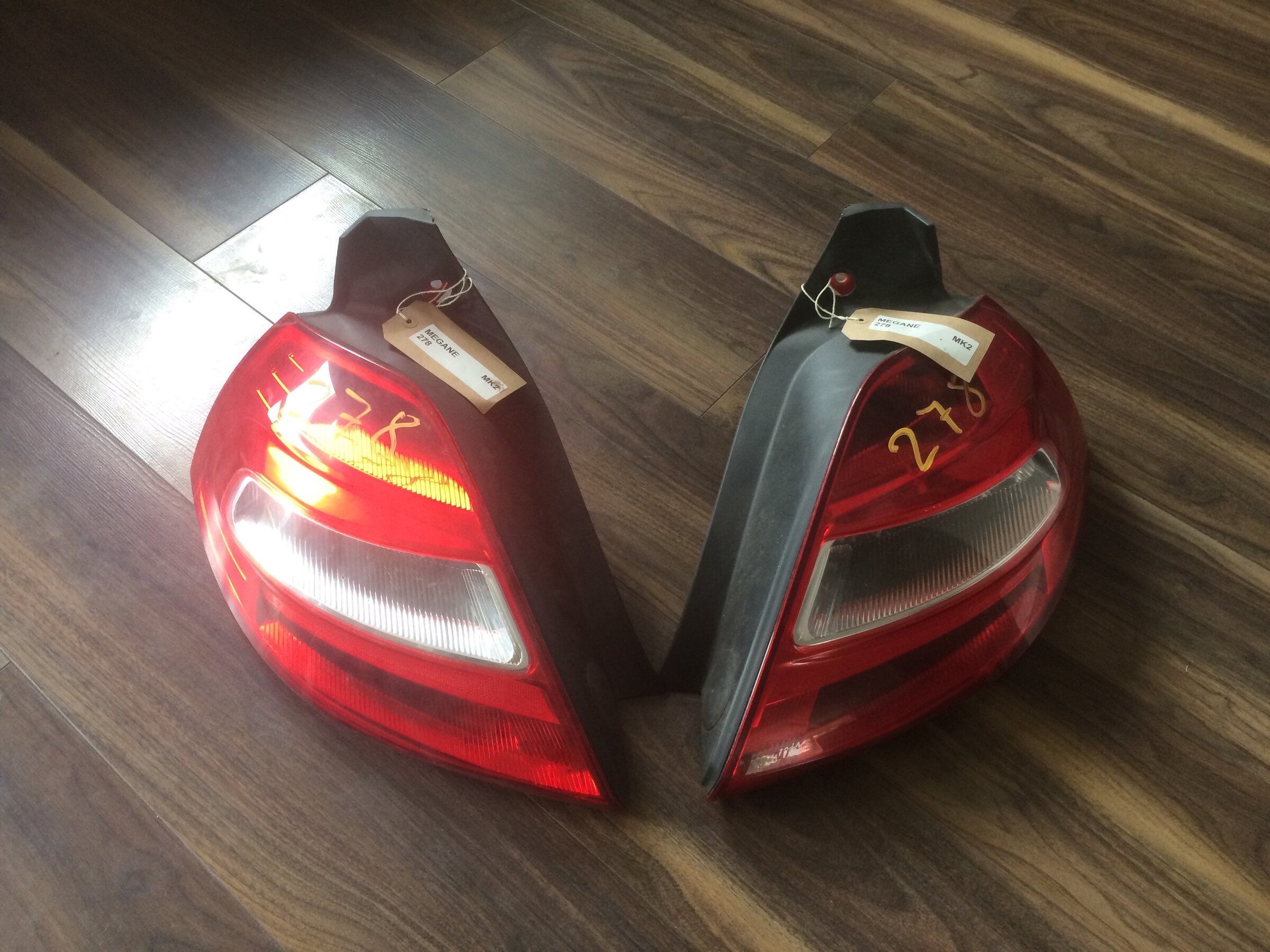

Always preferred the facelift rear lights on the meggy and a easily reversible mod. So tracked a set down with original wiring plugs:
So from this:
To this:

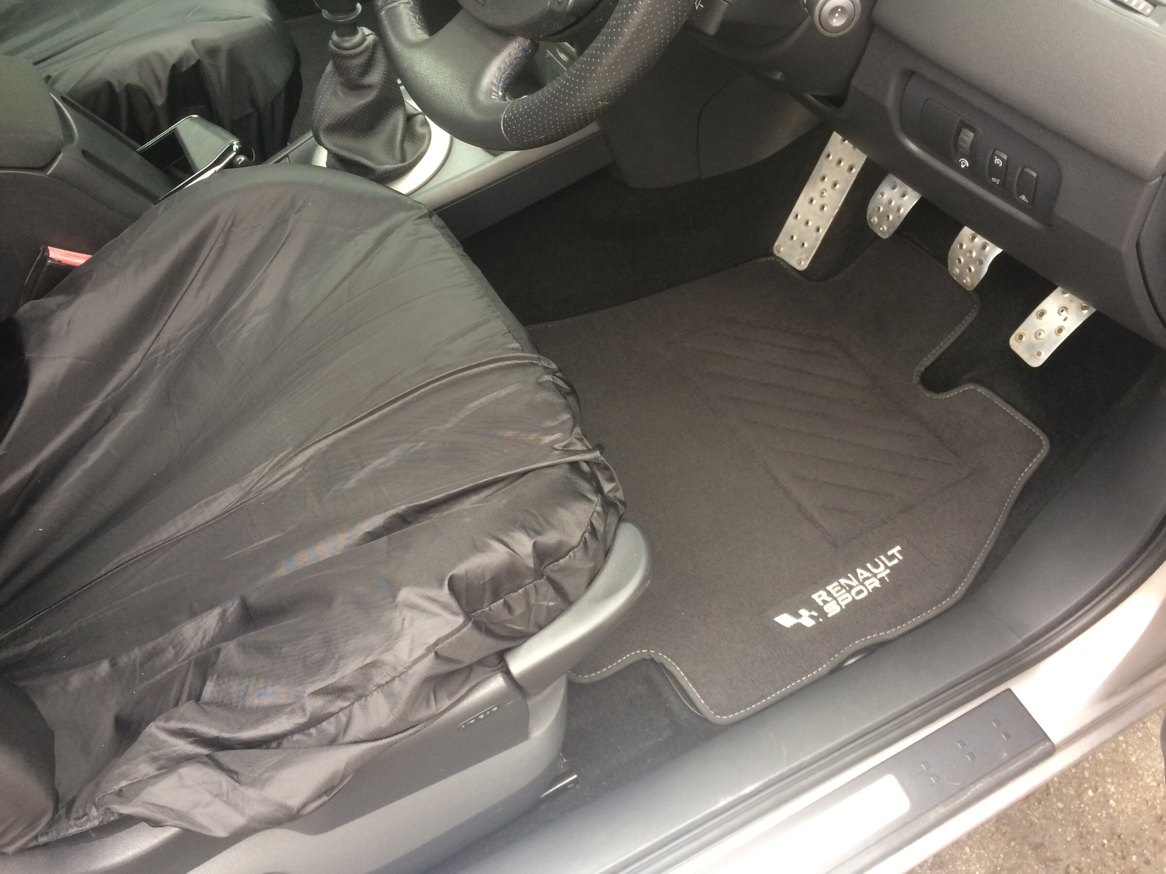

Also managed to track down a set of original mats - these are NLA:

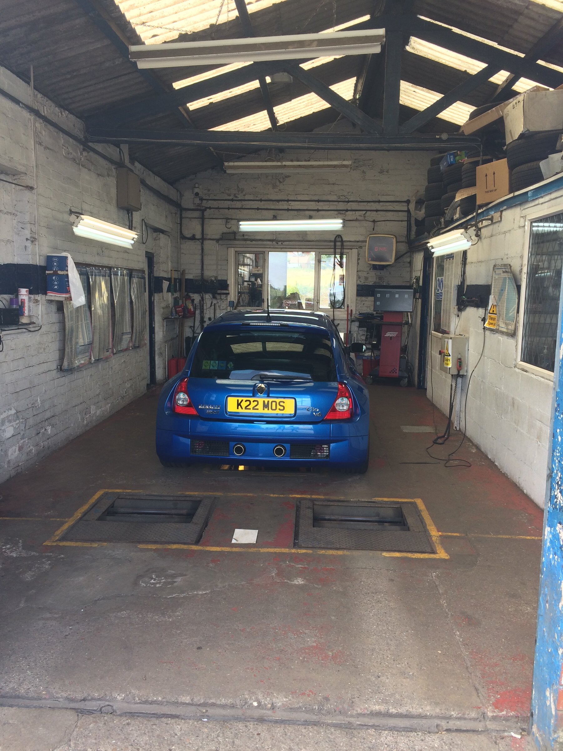

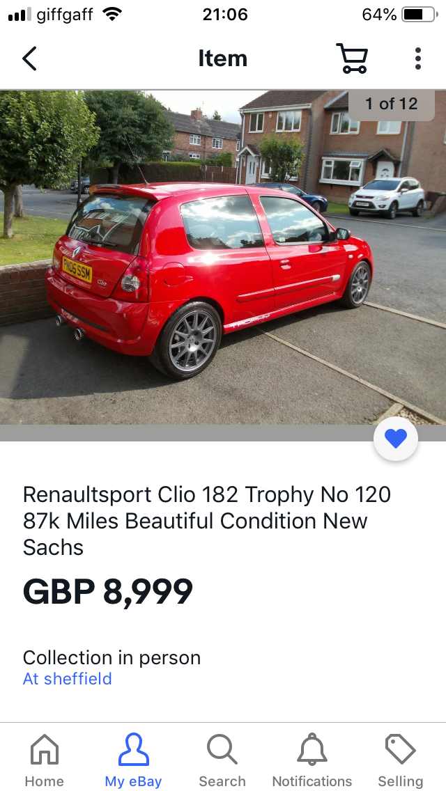

Air con re-gassed today. Used a mobile chap who serves Chesterfield and Sheffield. He did a UV leak down test also and all okay. Cost £55.
Awesome mate I need my air con sorting in the Volvo.
I literally dropped him a text Friday night and he replied saying he was in the area next day. Took him about 20 mins.
I know a guy called John Carr from Sheffield! That's not him btw🤣. Decent price that too 👍.
Lol.
Some of the prices and waiting times I found when I had a quick internet search weren’t so good!
So yes, well recommended.
