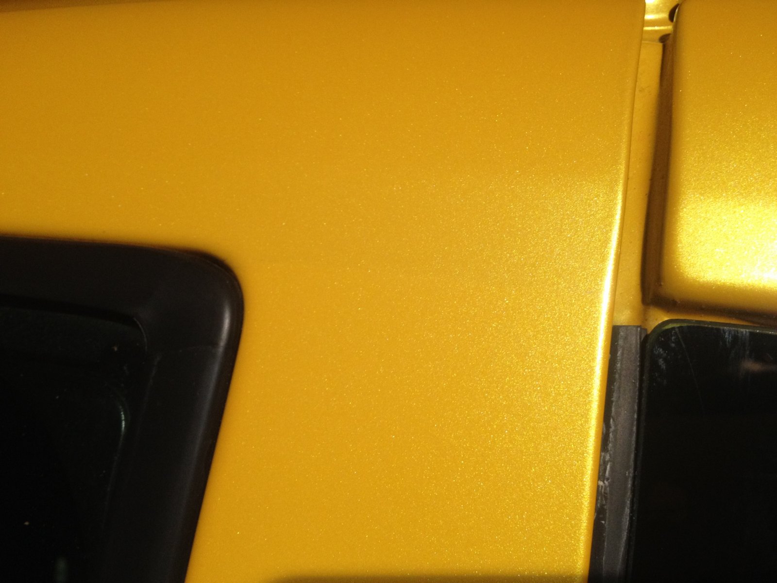

This was intriguing me so been out and attacked it just now and looking like we are good to go without :smile: looks like the colour coat is the same throughout the door and just lacquered. Will be able to see better in the daylight.
mossyv6
  Trophy,V6,5GT,AG200

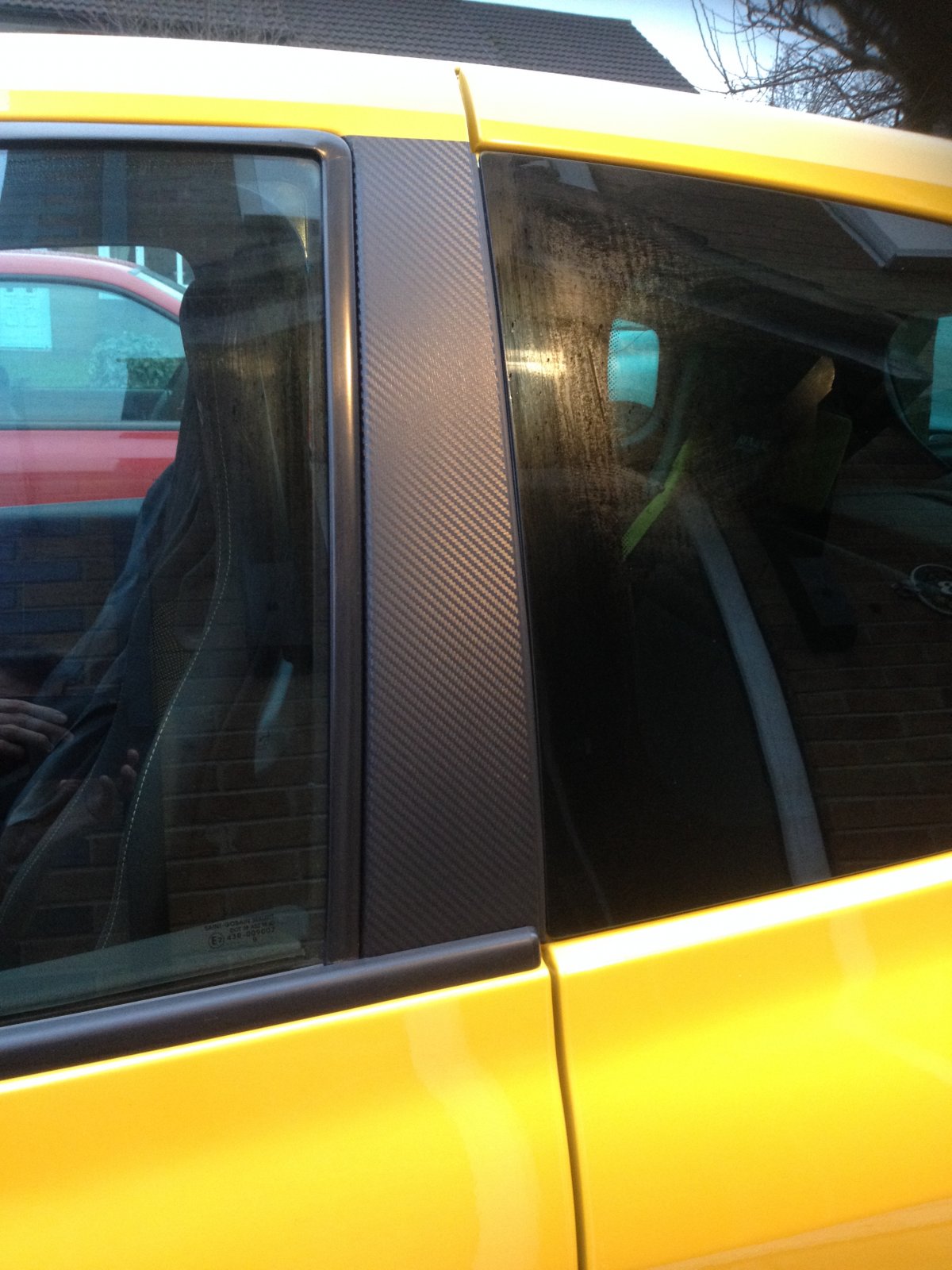

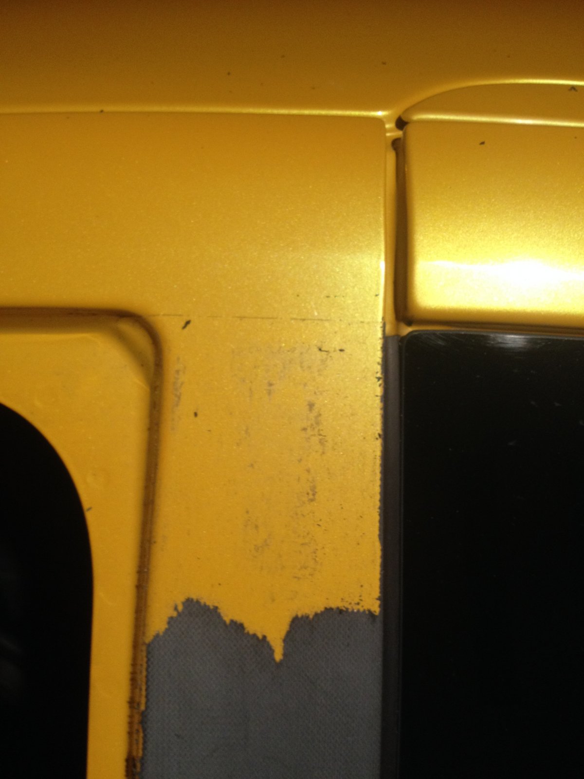

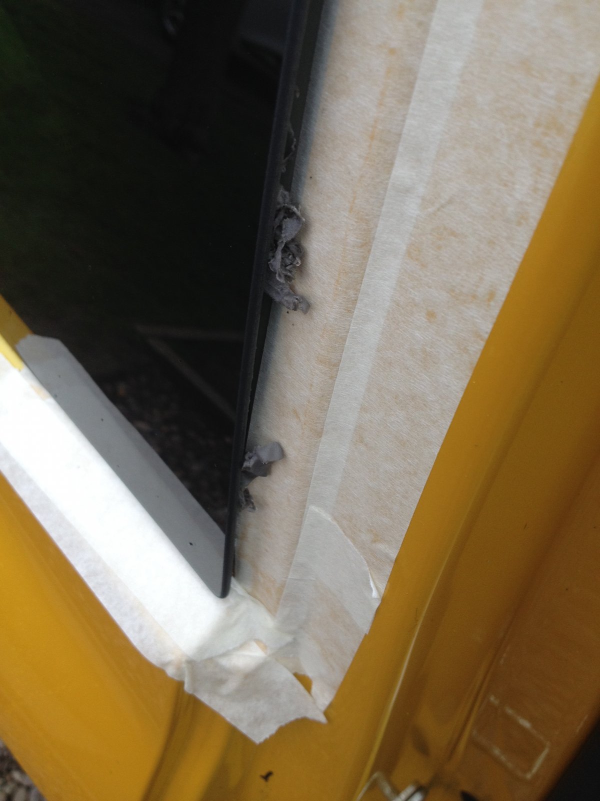

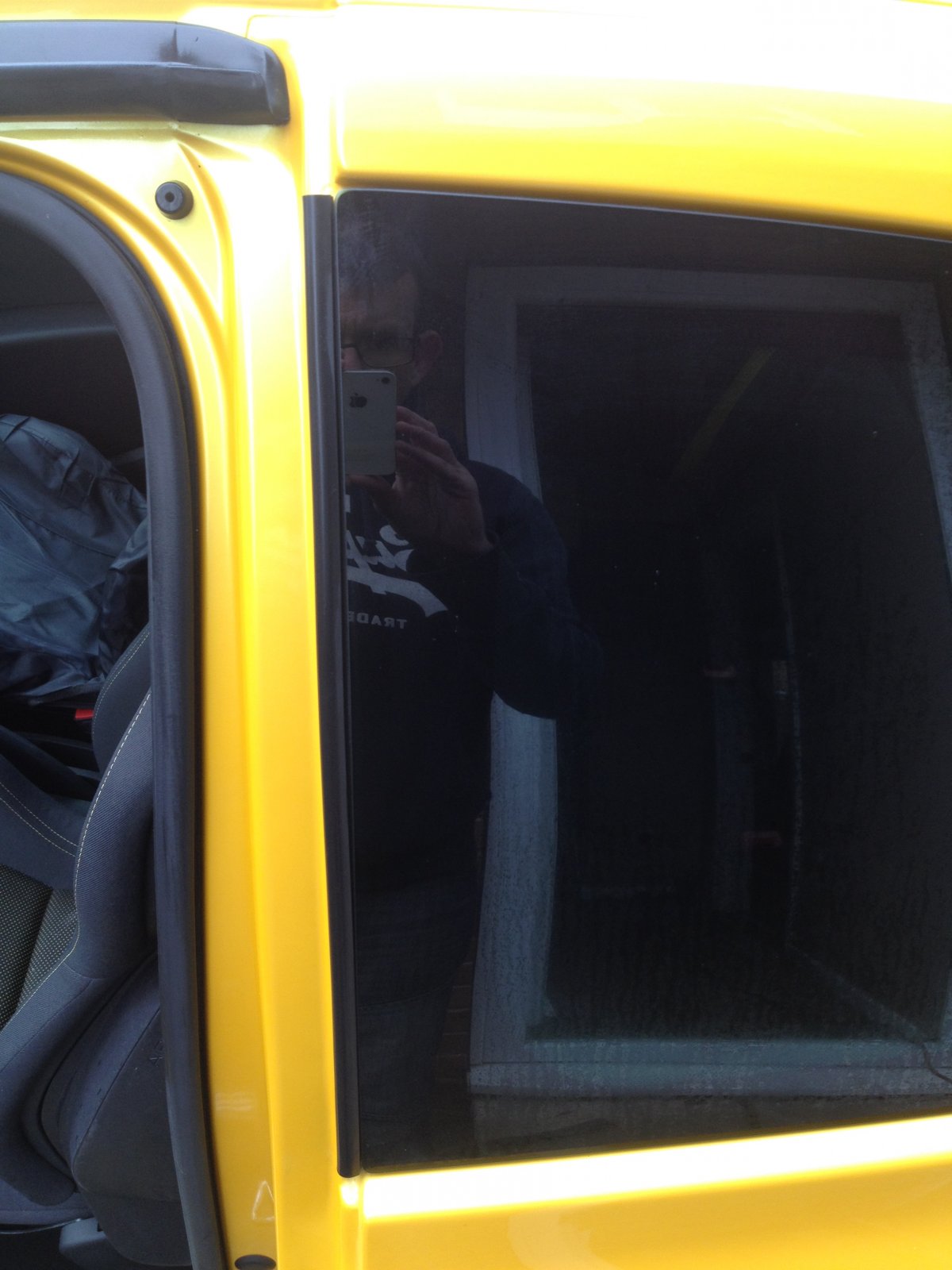

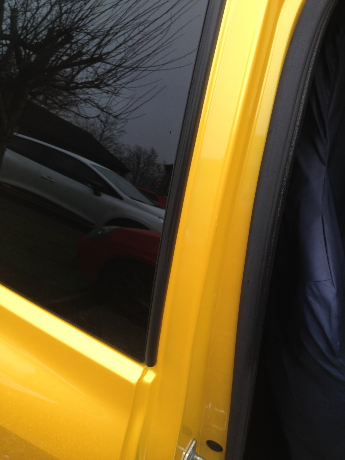

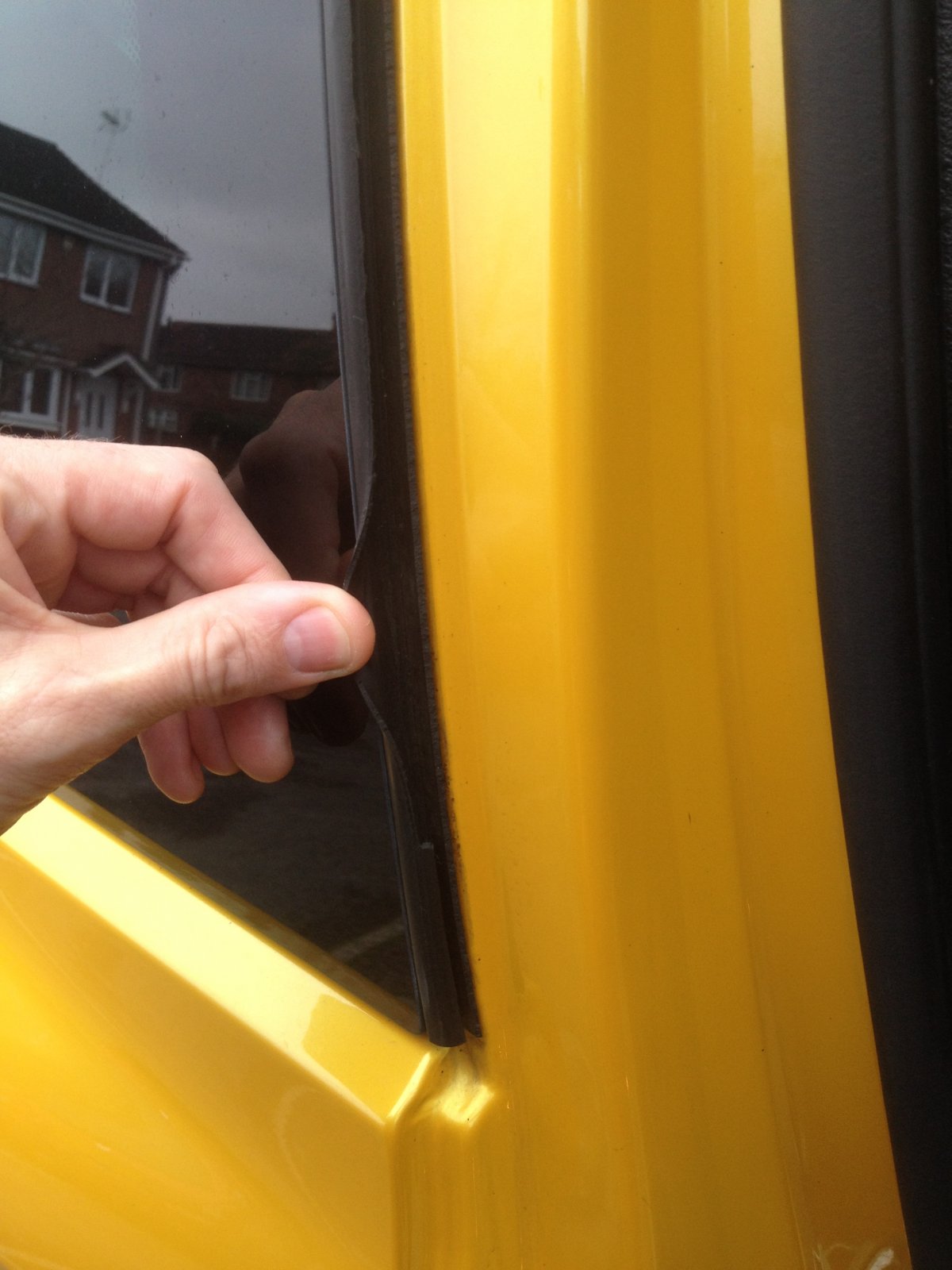

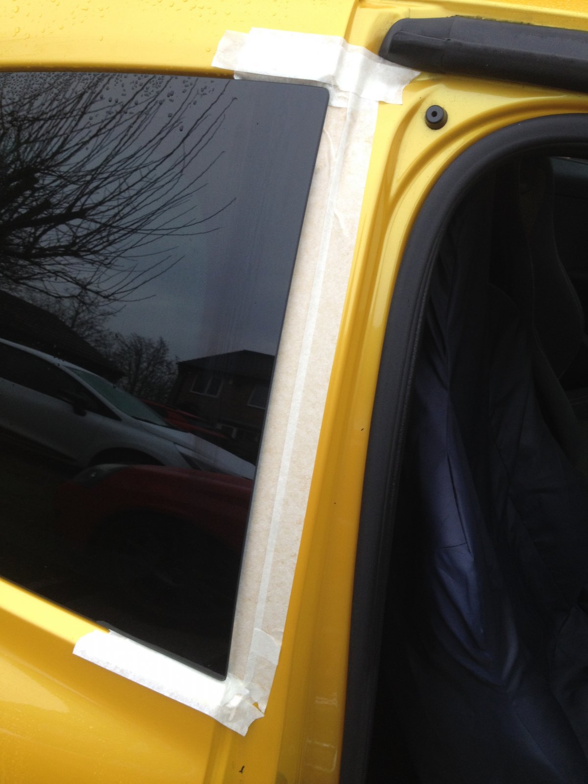

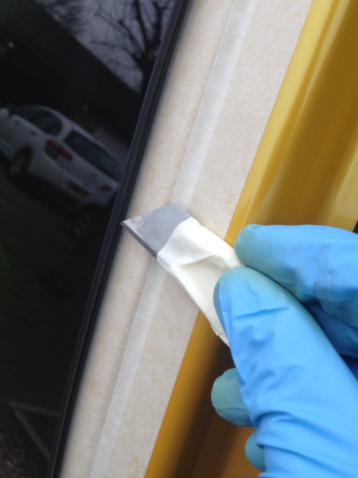

So inspection of the B pillar showed (to my disappointment) a very small colour difference - probably wouldn't see if it you knew it wasn't there but it just wasn't good enough so:
mossyv6
  Trophy,V6,5GT,AG200

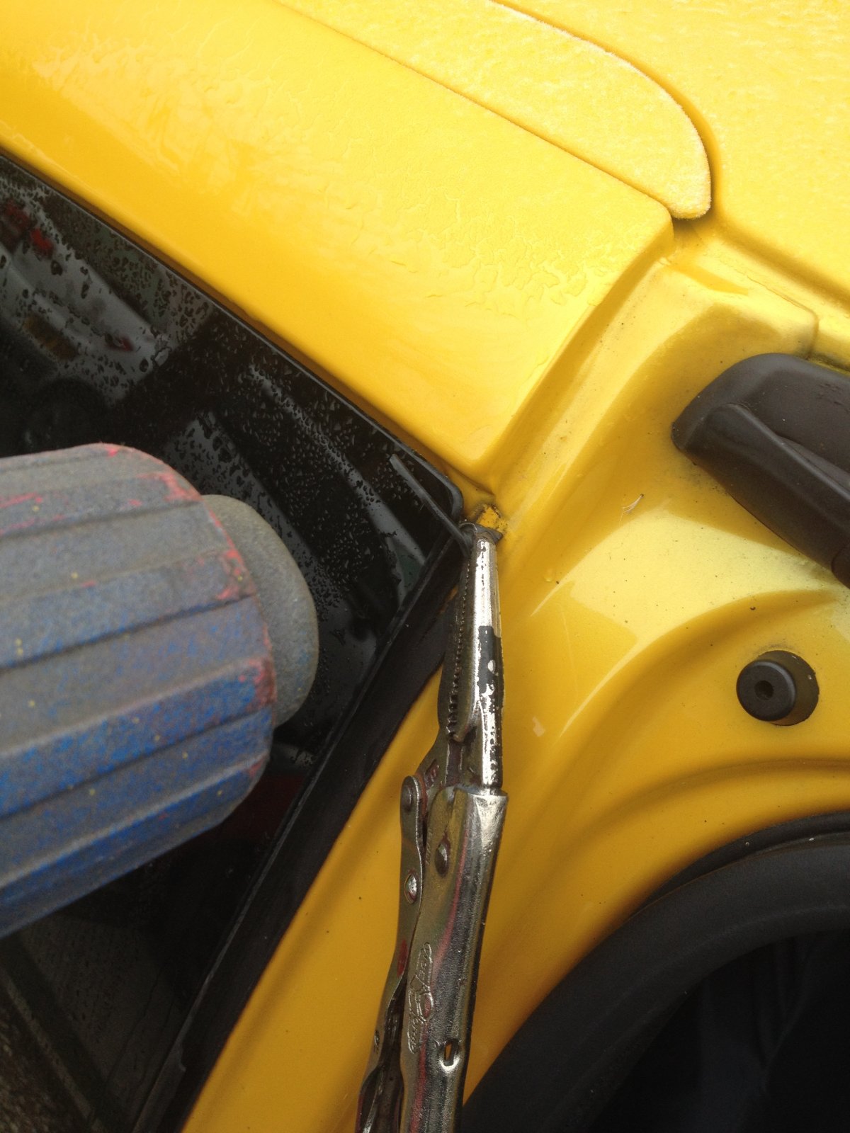

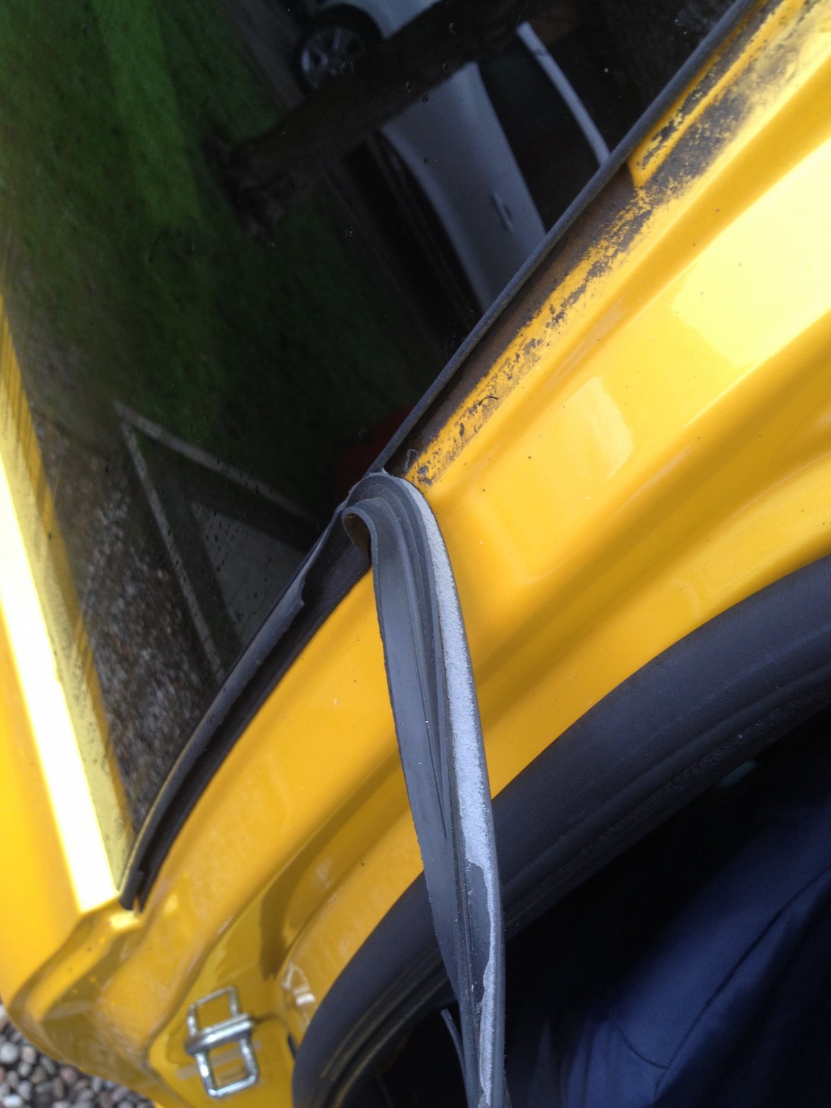

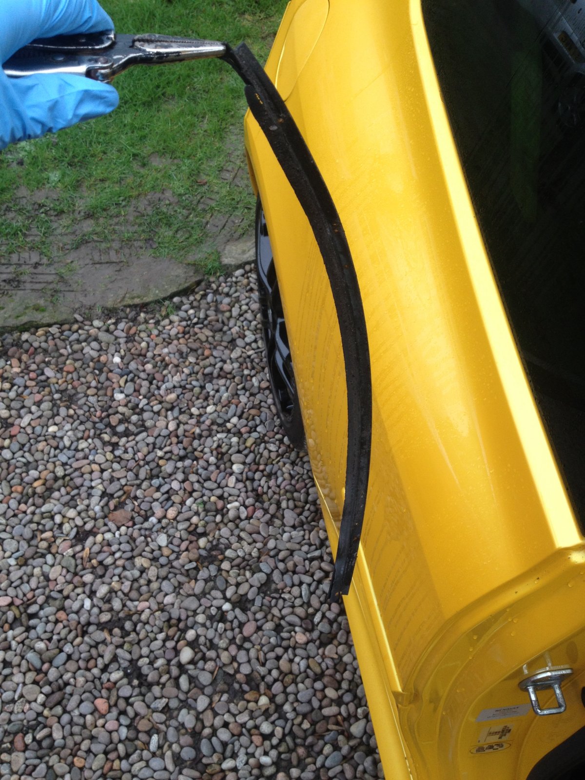

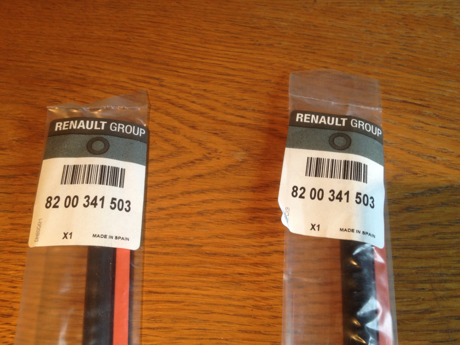

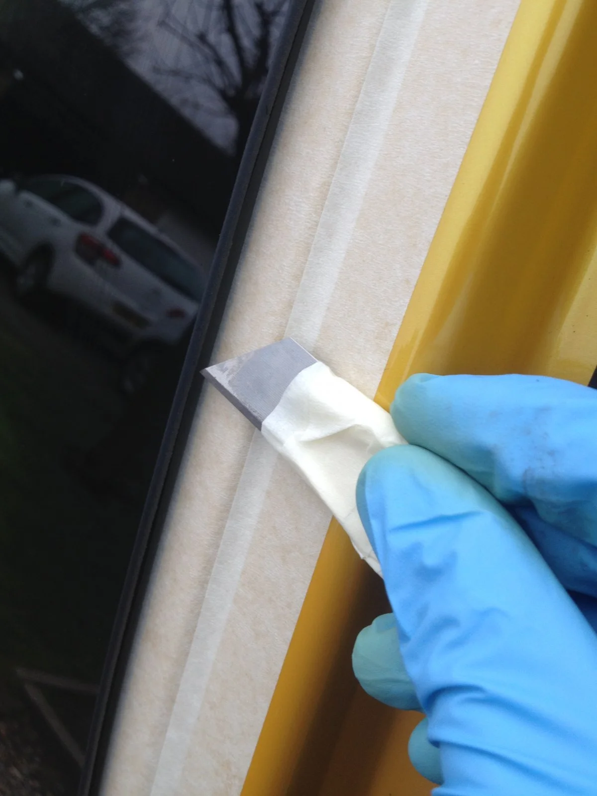

Replacements ready:
Removing old ones:
Cleaned up
Masked up just in case of any mishaps:
Weapo of choice:
Removing the old glue gunk - a right pain to do but has to be done:

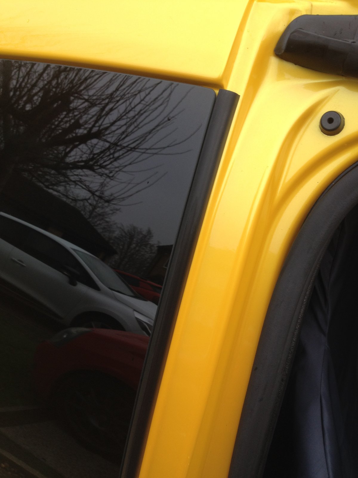

New one fitted :)
Dom_capper
  2012 Renault Clio
They just fall apart after a while mate. No water ingress but it looks pretty unsightly when they flap around.
mossyv6
  Trophy,V6,5GT,AG200
Ahh fair enough, but that still looks a very neat job and looks good, taking the door rubbers etc off really does make the difference to the finish :up:
Thanks mate and yes taking the door trims/seals makes it so much neater and professional. I saw a red 200 at the weekend and they had basically stuck some replacement straight over the originals and looked absolutely shocking!!

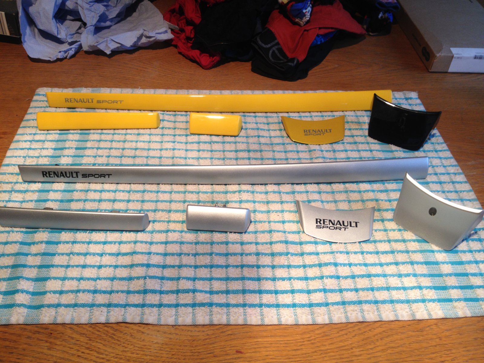

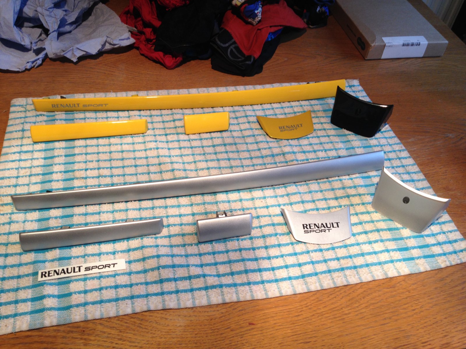

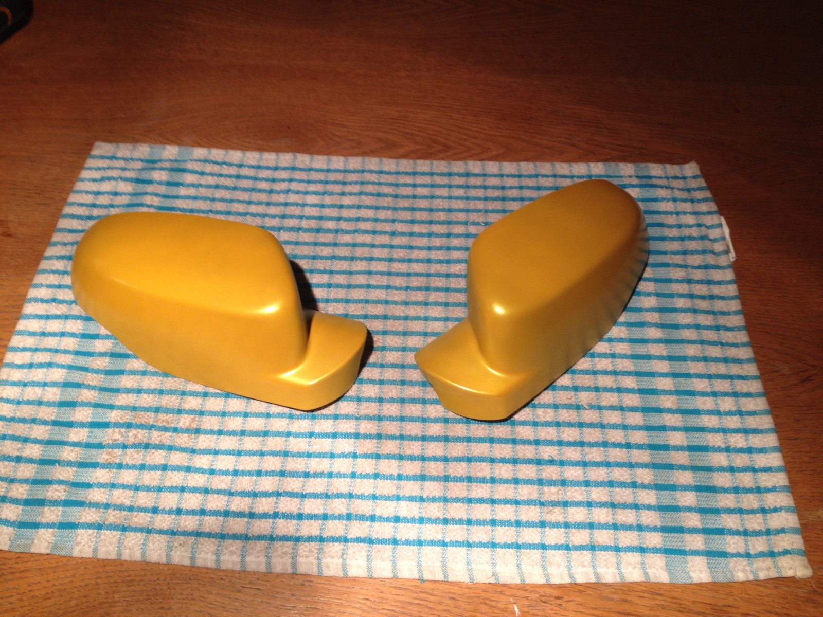

Been doing a bit of spraying again, lol.

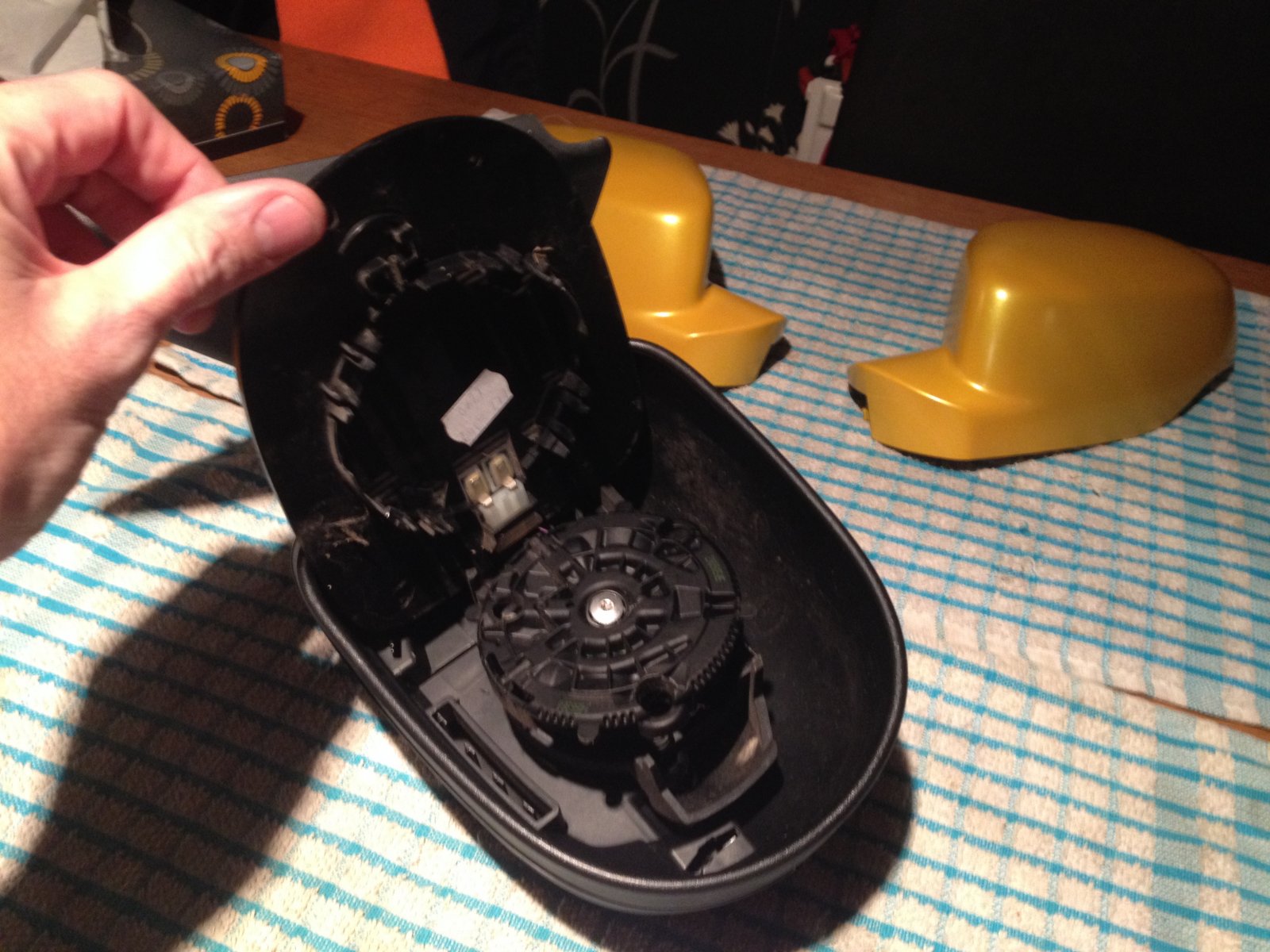

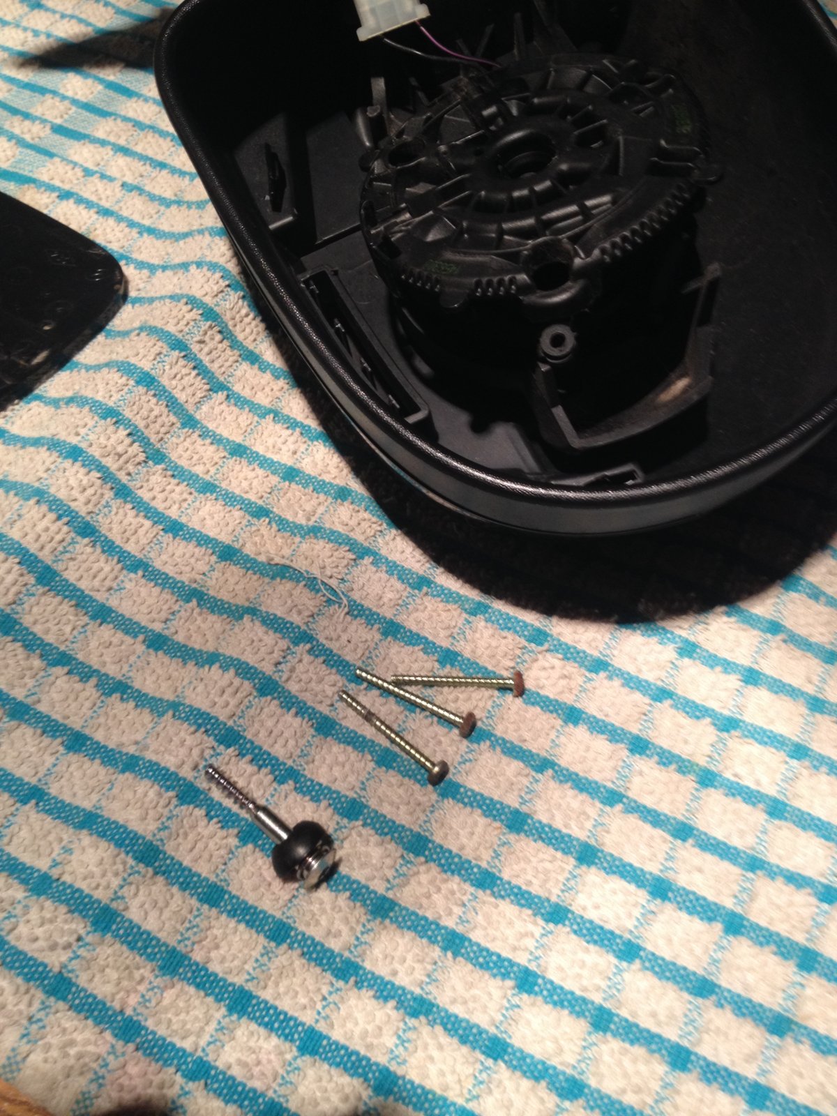

To swap the caps over you have to pop the mirrors out. Release the plug.
Unscrew centre screw and 3 surrounding screws. Release the plug.
And take the centre out.
You can now see the 3 clips that hold the cap on, use a flat screwdriver to simply unclip them allowing the cover to come off.
mossyv6
  Trophy,V6,5GT,AG200
Thats defo a win as far as i'm concerned, they look much better colour coded :cool:
Mirrors look good, the black part at the bottom helps to break it up and make them look oem asvit fits with the other black highlights on the spoiler and arch vents etc.
Thanks I did it on the Alien Green 200 I had and I think it finished the car. Wasn't sure about it on the yellow but I guess when it's all planted and running wider it will all come together.

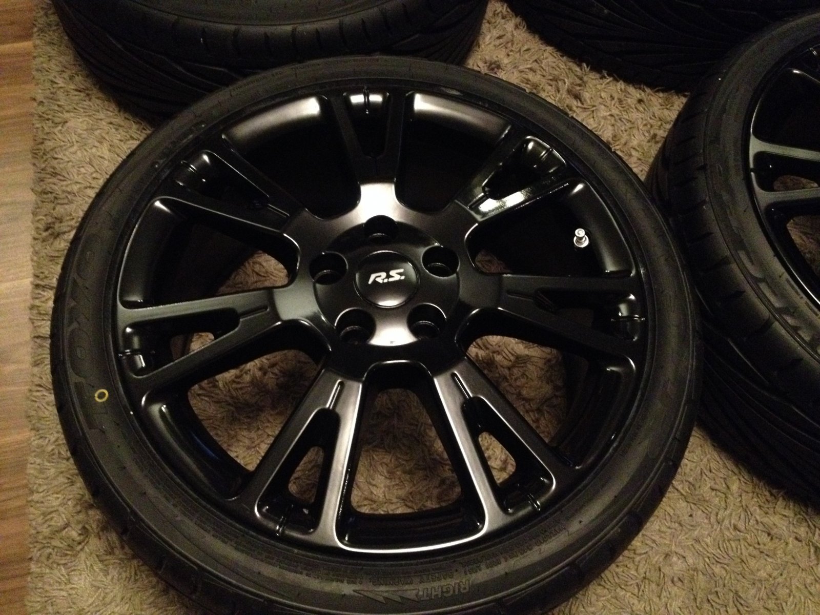

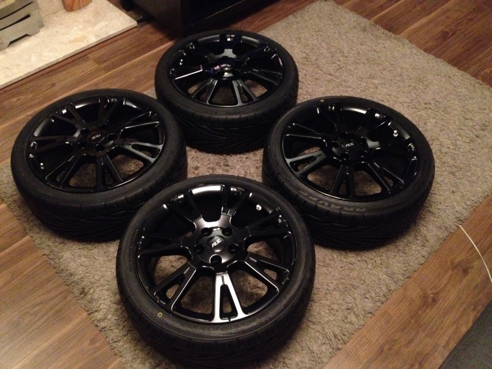

Oh and just finished the wheels - again, lol.
Had the tyres fitted on Monday and the satin look paint was a little lost :( so cracked out the lacquer and brought the shine out.
And yes I said I didn't want to spend all day cleaning them but they do look so much better :)
Also gave the centre caps a coat.

They look 100x better in gloss mate. :up:
