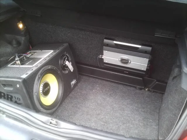

Sorry lads, taken a couple of pictures of what I used, only thing is I've already done it so gonna have to draw out how I did it.
But basically yea the size of the MDF you just need to cut to just bigger than your amp.
And quite a thin bit. Smaller than a cm. I just used a bit I had laying around.

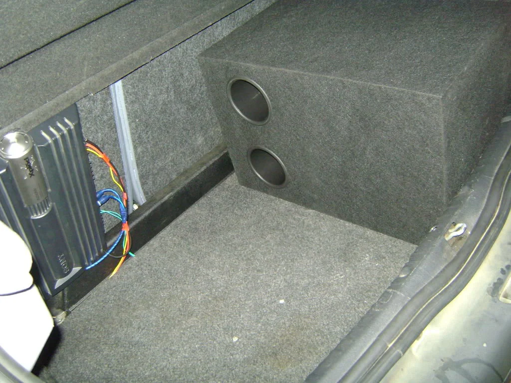

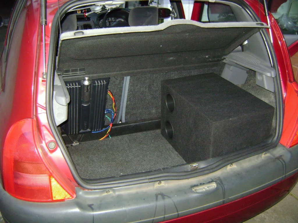

Hi all,
i did the same thing as told above and its working great for me
heres my audio config
Head Unit : pioneer DEH 3500 UBG
Front Speakers : Original one with tweeter and cross over
Rear Speaker : sony XS-GTF1625B
Sub :PIONEER TSW305F
Ampli : Sony XPLOD XM-ZR604 600 Watts
Rear Speakers : JBL GTO 938

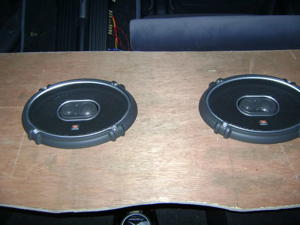

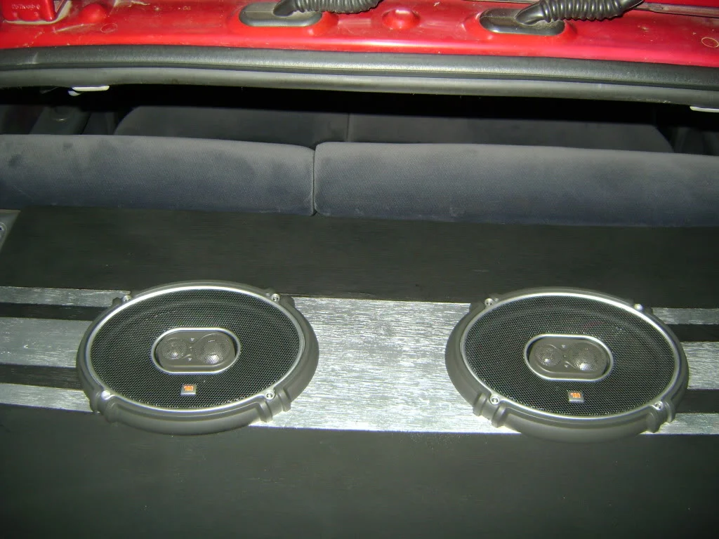

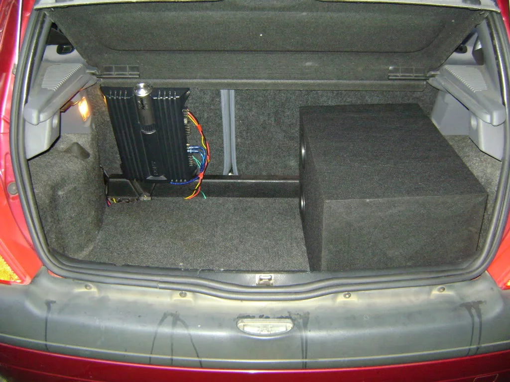

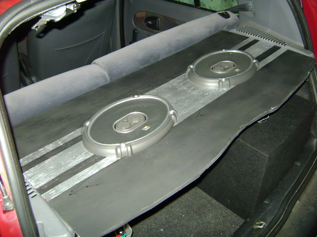

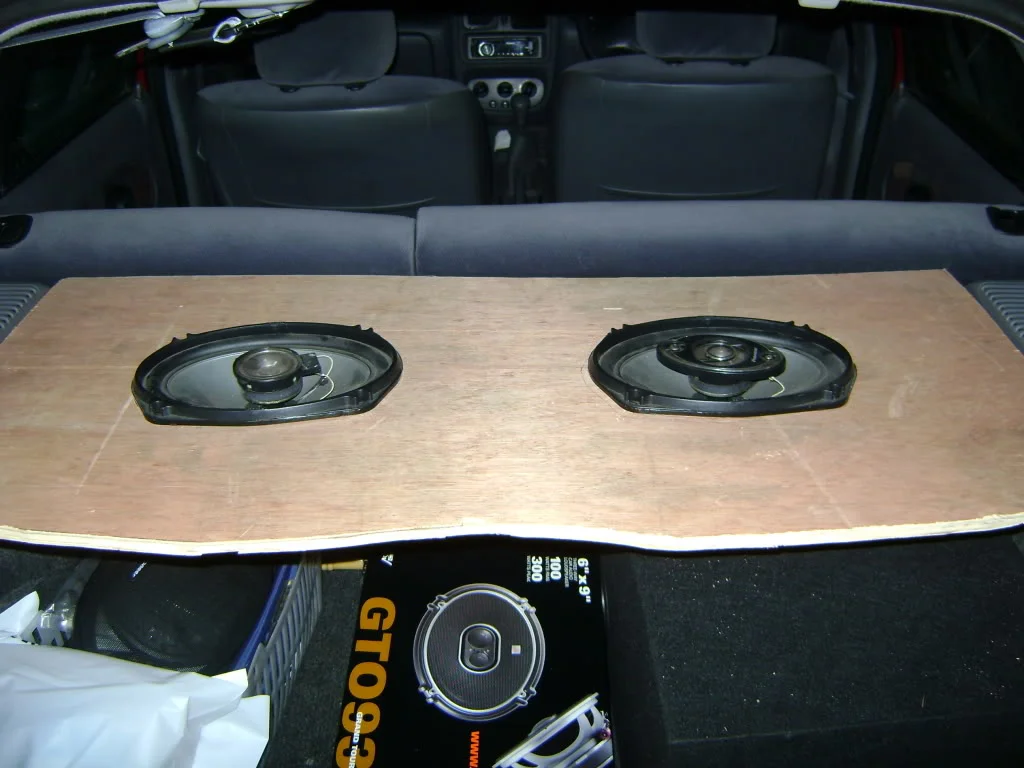

here are some pics
cheers
nethy
Ive done mine now, unzipped the bigger half of the rear seats measured up some mdf and cable tied it to the metal inside. That was for my 4 channel & cap, my bass box is active so didnt have to fit two amps :D. One double 12 box in the boot (just).
