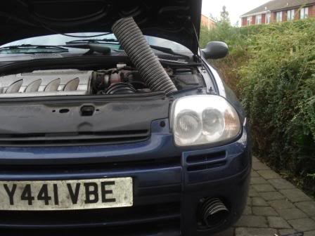

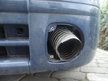

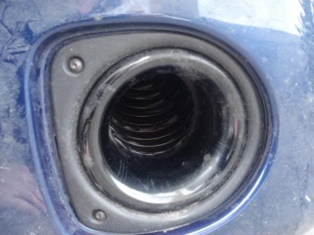

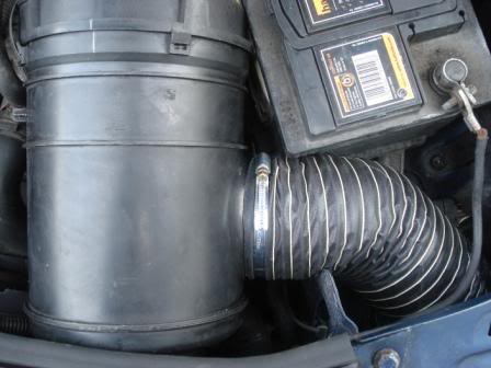

Yesterday i fitted the Espace V6 airbox and ran a 102mm diameter feed from the outlet to the passenger foglight. With the old air filter induction i's on average over the last 2 years see 37-39MPG, pure motorway driving would give me 44-45MPG.
I tripped the meter before heading to work and in the 10 miles of driving it was showing 55MPG! Now in the 2 1/2 ears i've owned the Clio i've never gone over 46MPG, this must show that now i'm directing fresh, cold air to the filter instead of sucking up hot air from the engine bay. I just wondered if anyone noticed or paid any attention to their MPG?
