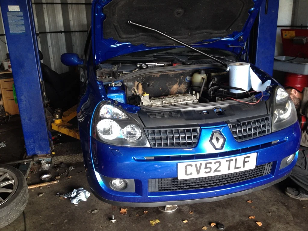

After the last trip to Dan at SJM Automotive, we noticed the cam cover was leaking so booked back in to get that done along with a lower mount and 5th gear syncro and new rear shocks. Sadly the syncro didn't arrive nore did my lower mount but....

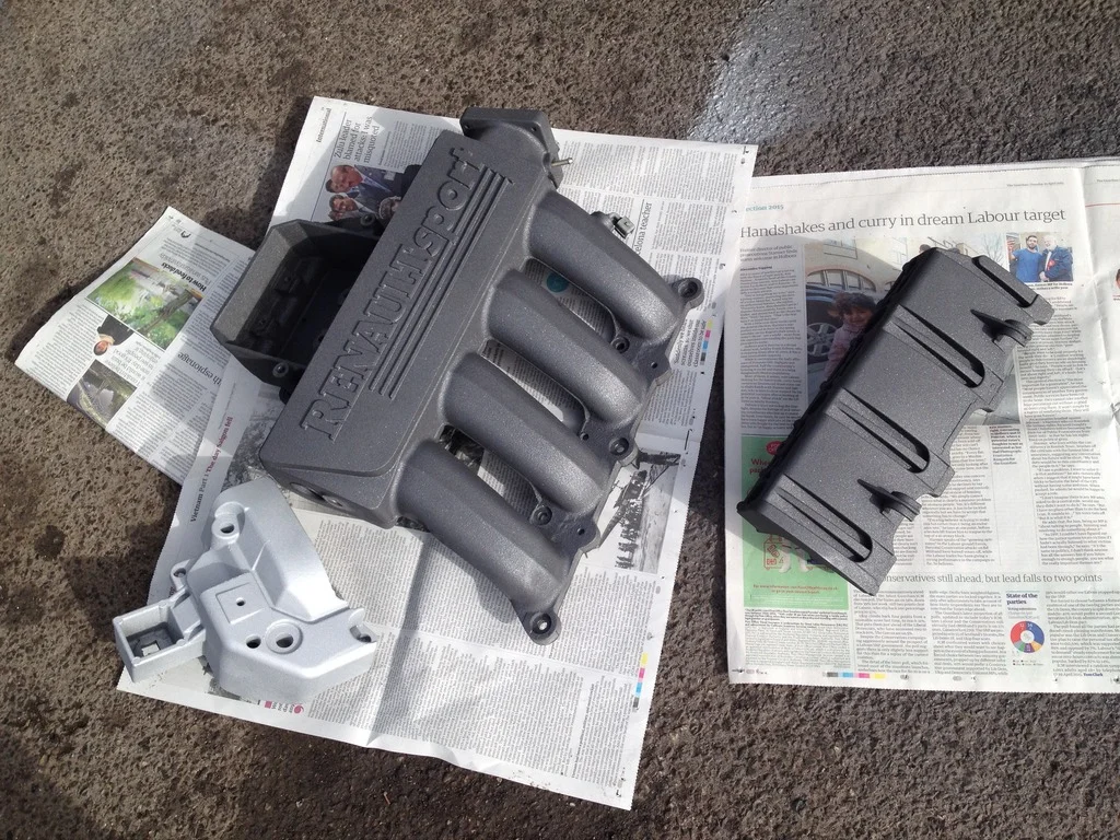

The day started with the engine stripped...which finally gave me the chance to spray some bits up whilst dan cleaned up the cam cover

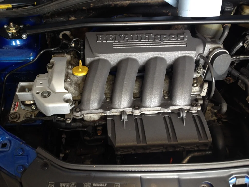

Cam cover freshly sealed with a new timing belt fitted (dephaser has recently been done) inlets refitted

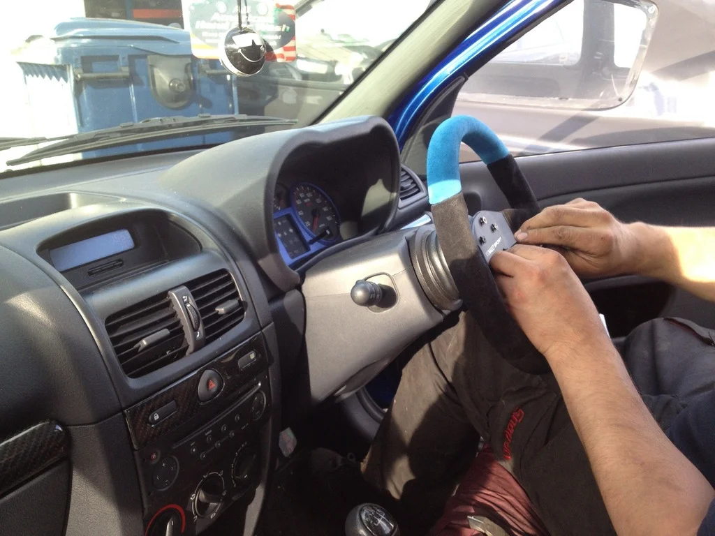

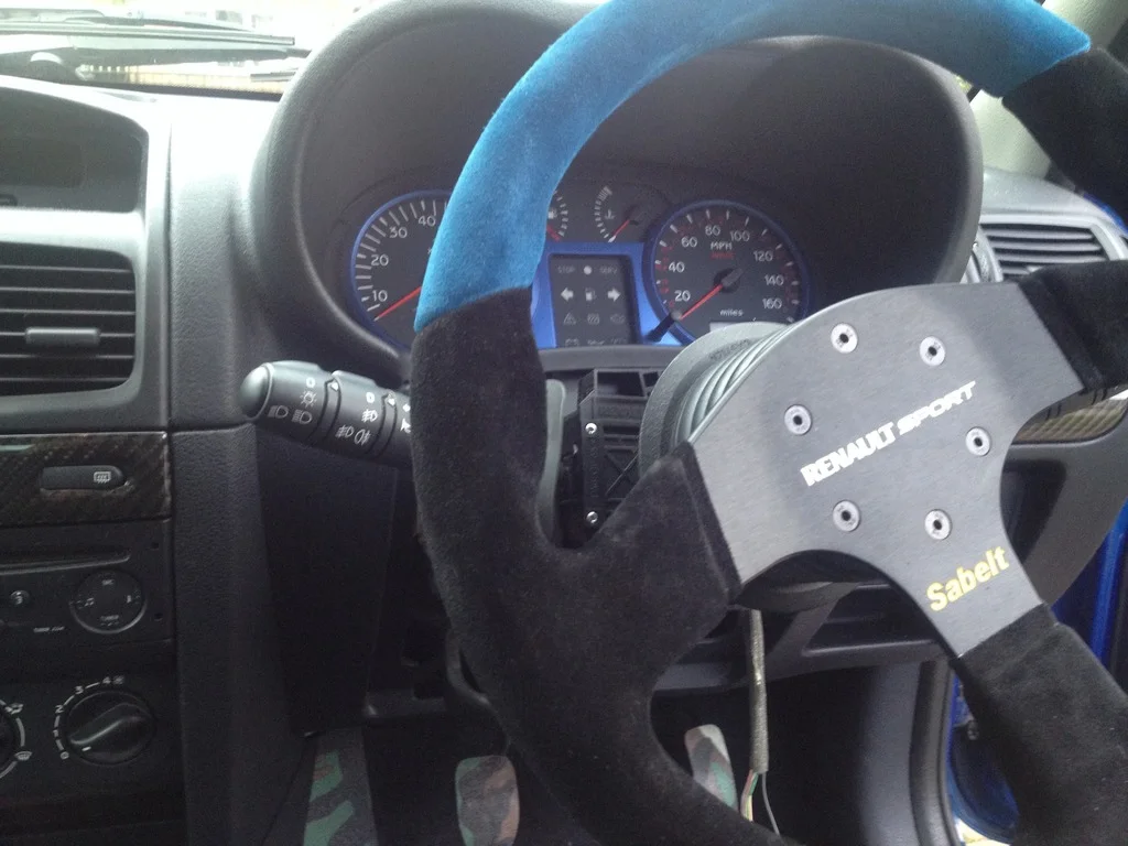

finally got the Sabelt wheel and OMP boss kit fitted....turned out the wrong stalk was supplied with it so...
Sourced one from renbreakers and fitted it at home.

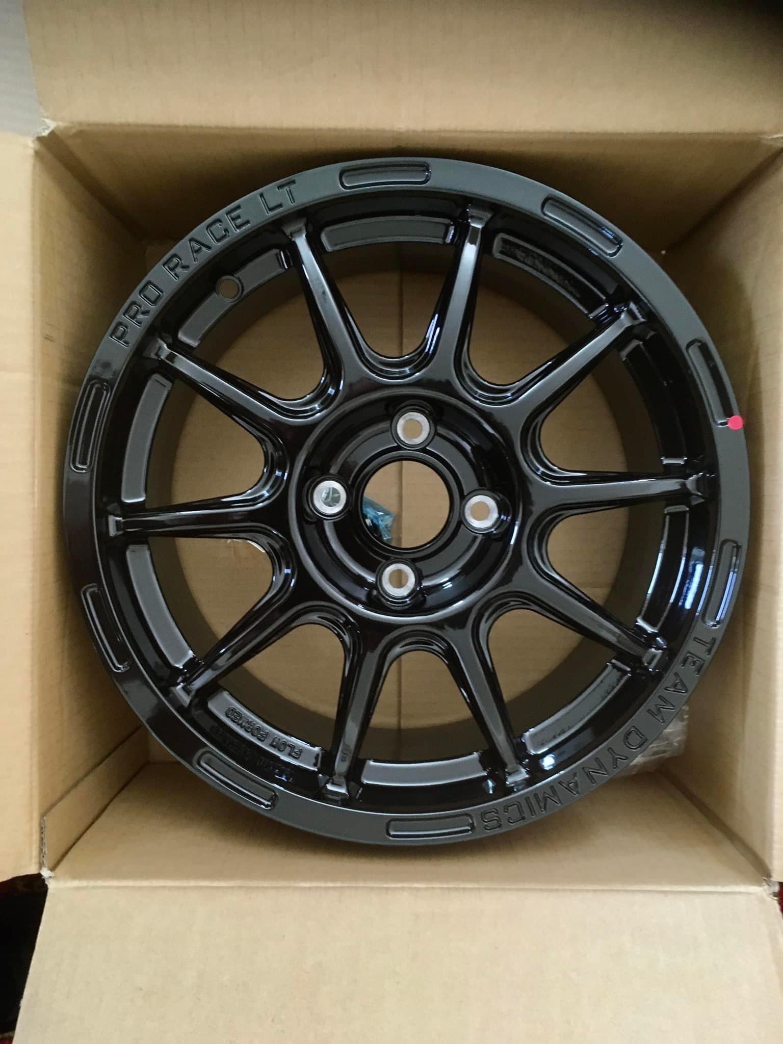

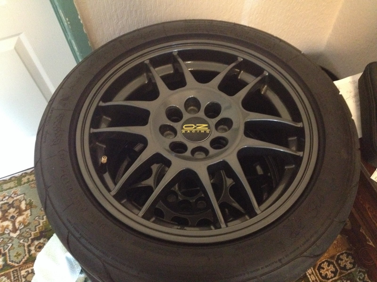

Sadly I didn't get to keep the wheels so they're first on the agenda along shocks and springs.

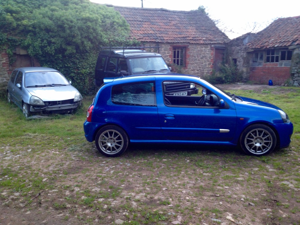

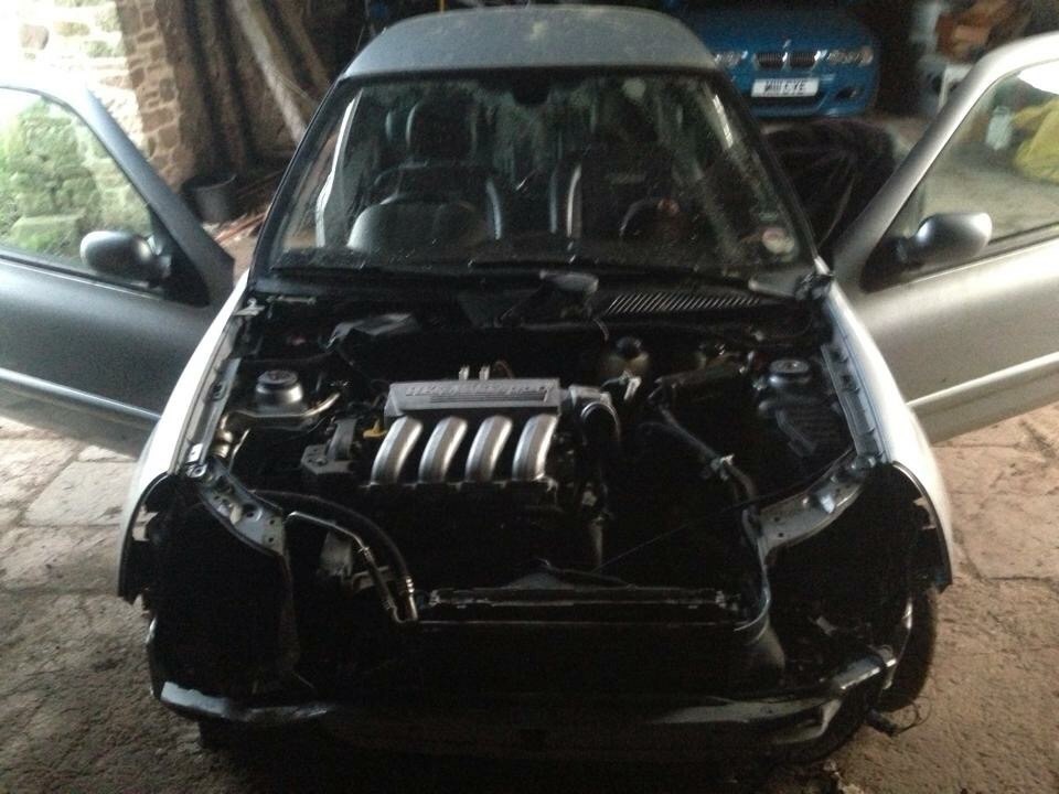

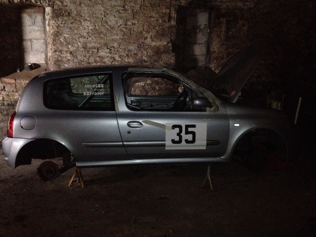

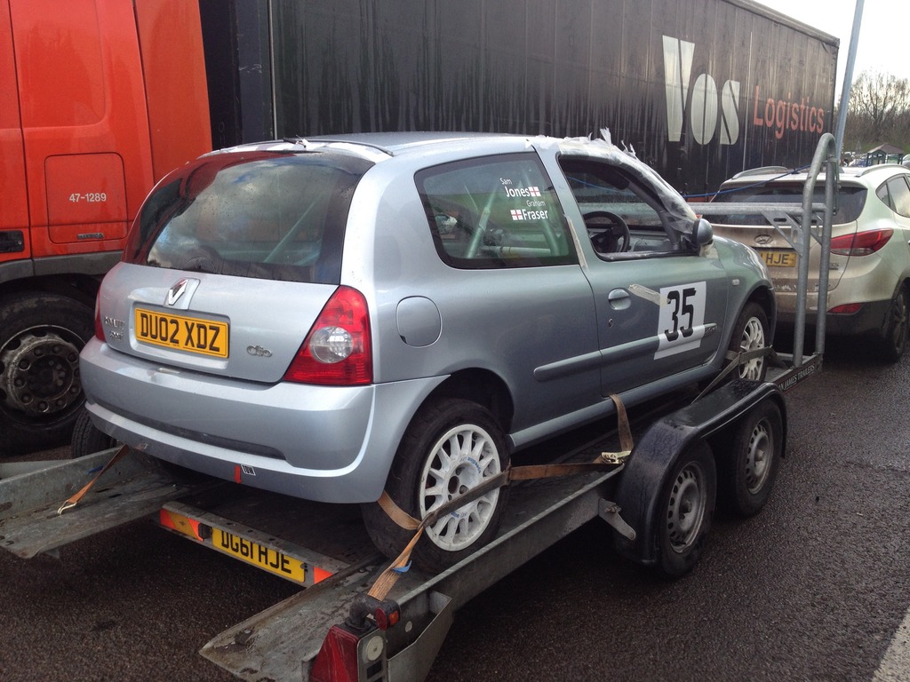

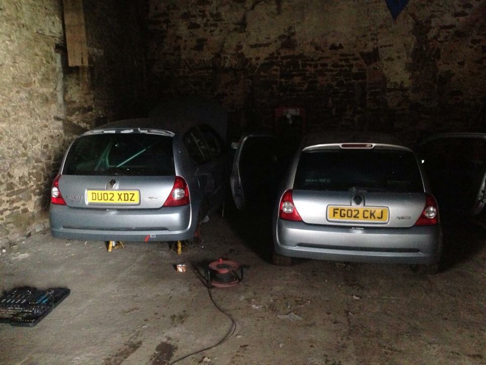

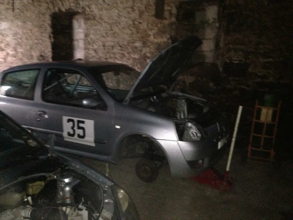

Finally made a start on the track build a few days back. I've got a full donor car luckily so it makes life a little easier...It's my old daily that met it's end. The engine and box are still fine as is all running gear. It was quite well set up, pipercams + matched inlets + K-tec induction, cup shocks + cooksports and a few other goodies.
First job was getting them both in the barn...a lend of a friends 4x4 with a winch and two mins of his time later.
Next up was removing the bonnet, lights and T bar ready to make a start on removing the engine and box. Bumper was already long gone.

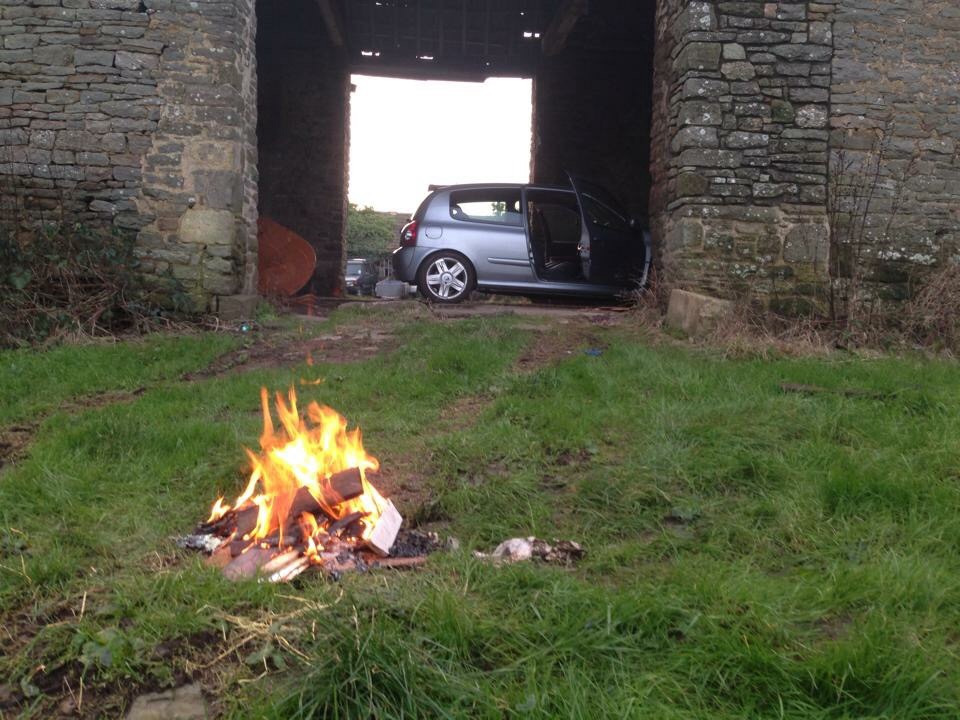

Working in the welsh hills...there's only one way to keep warm!

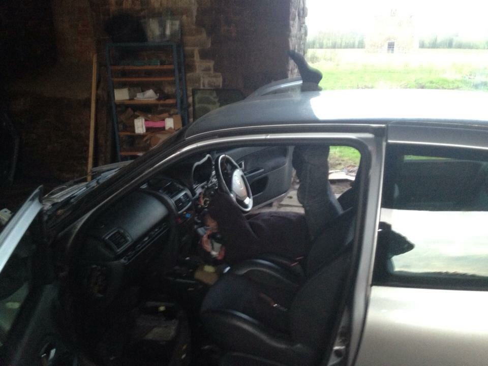

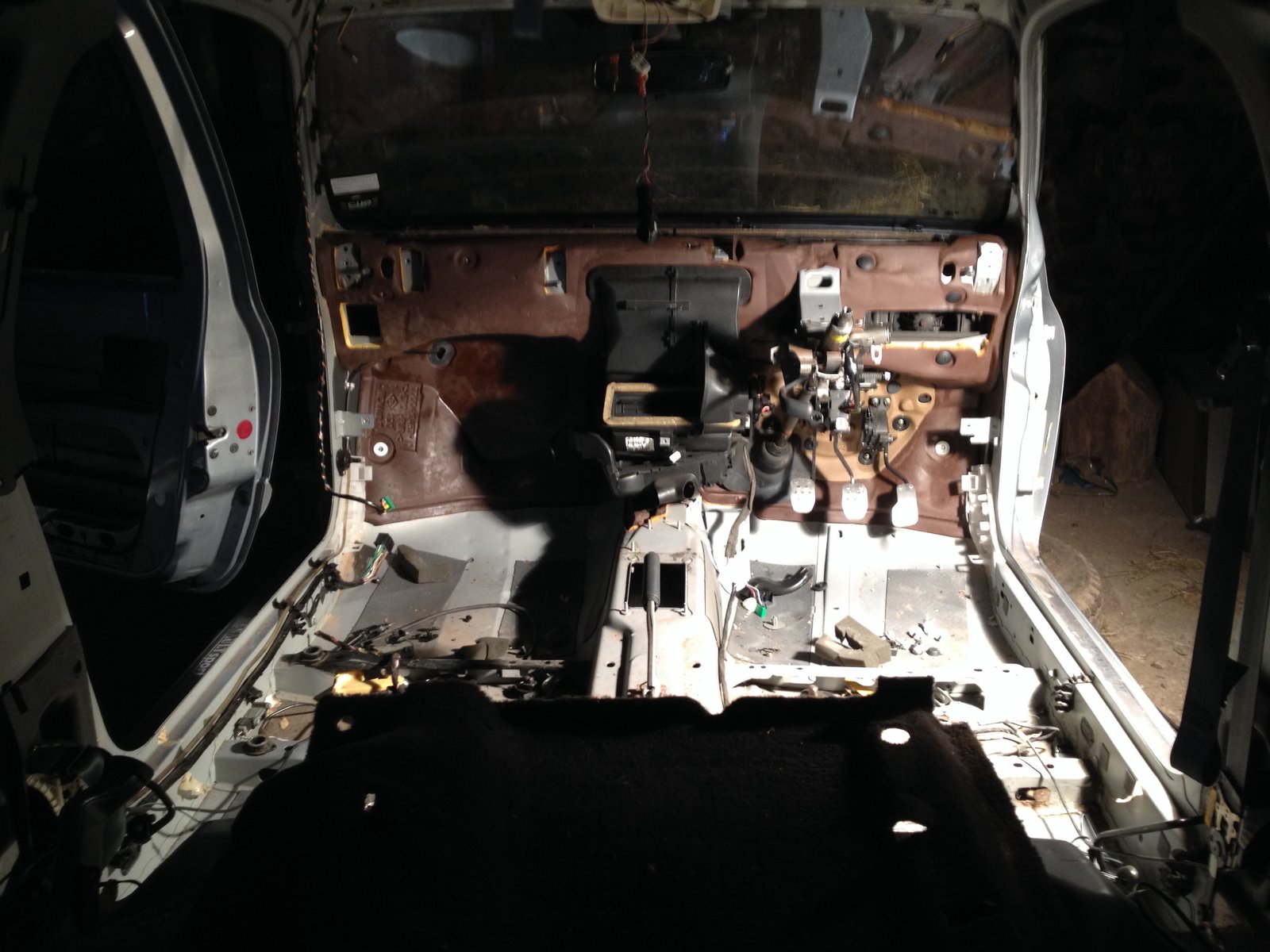

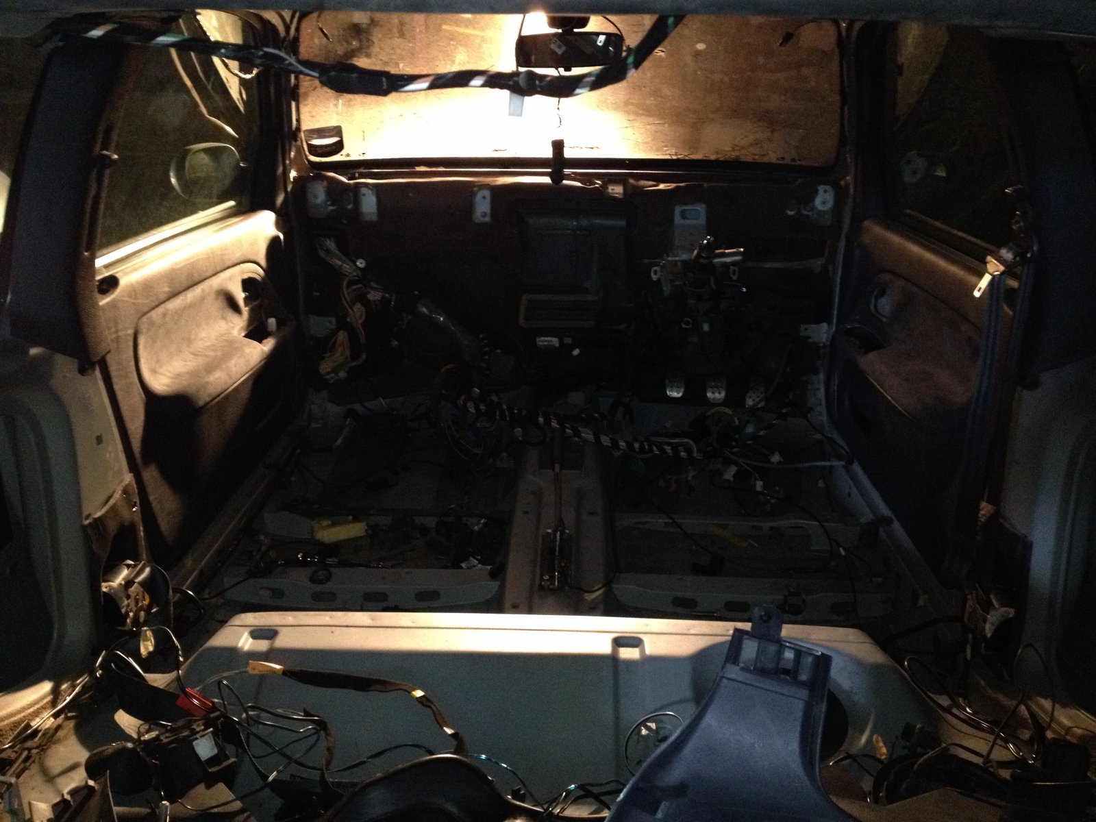

Next step was to strip the the dash out so all the vital bits were ready to go straight in....some bits were a right fiddle. Then came the brick wall for the day. The previous owners must of had a sound system fitted (theres some MB Quart goodies stashed under the dash top) and it's seems to be preventing the sodding dash top from pulling out.
So that was that...rage quit until my new cutting disc arrives!
Big thanks to @Dano' for lending a hand on the interior and snapping a few pics :up:

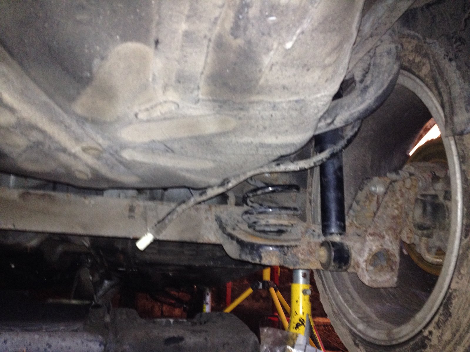

Popped the rear shocks and springs on (cup shocks and cooksports for now) removed the petrol tank from the breaker and popped it underneath for safe keeping.

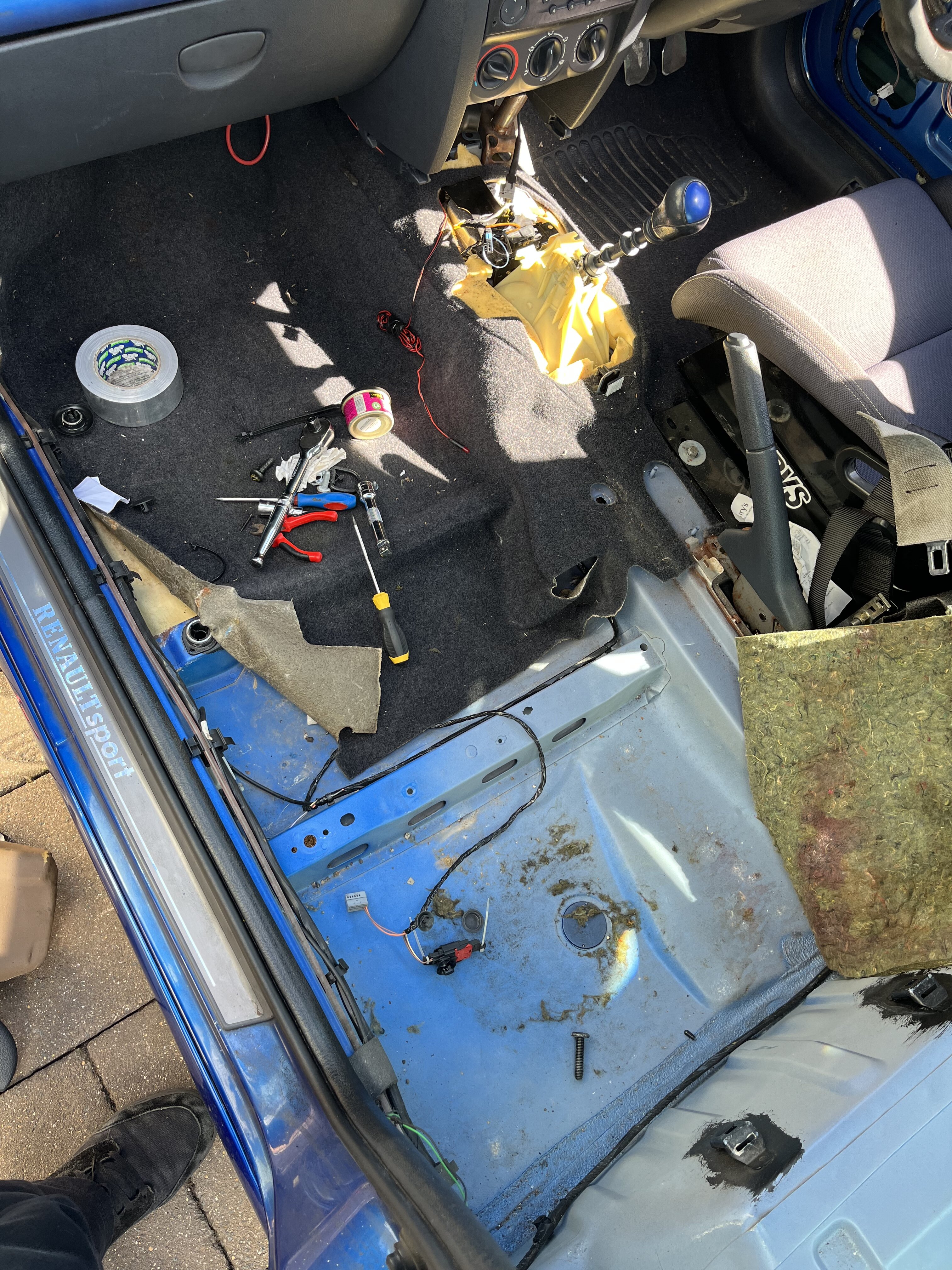

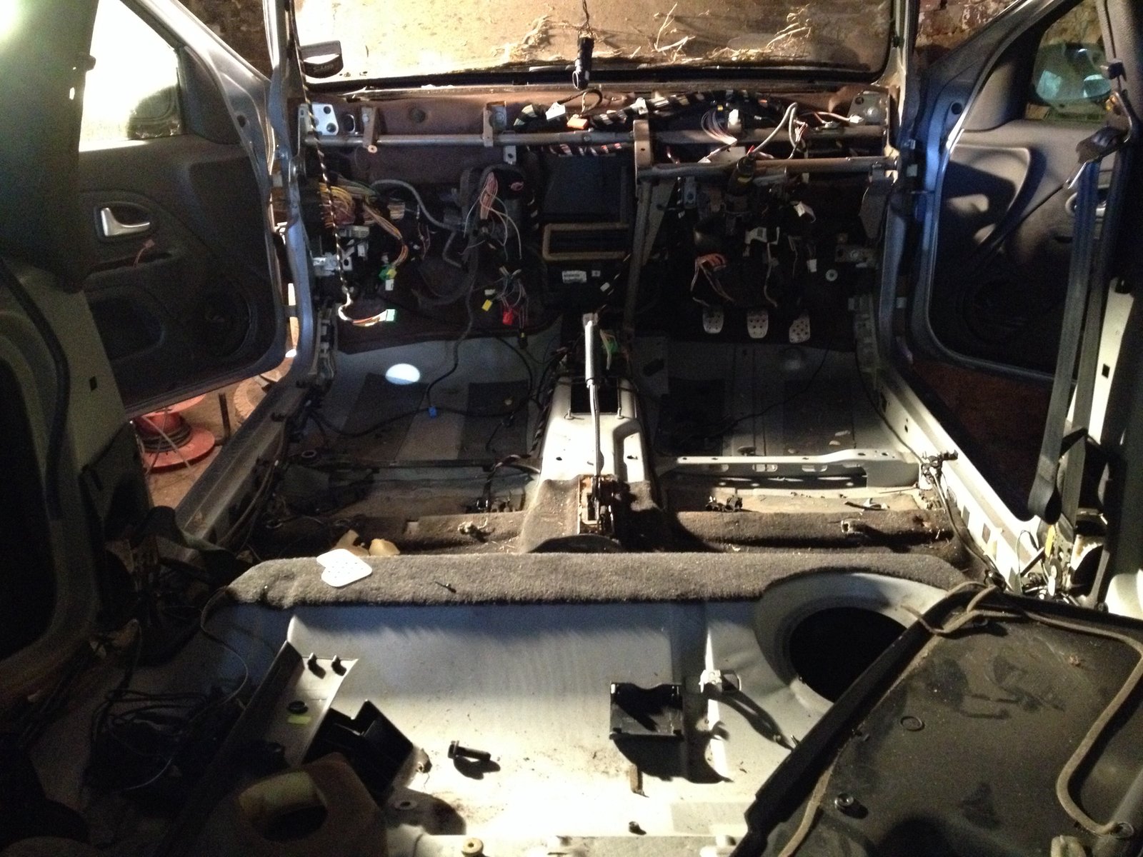

Finally fully removed the dash to get at the wiring loom.

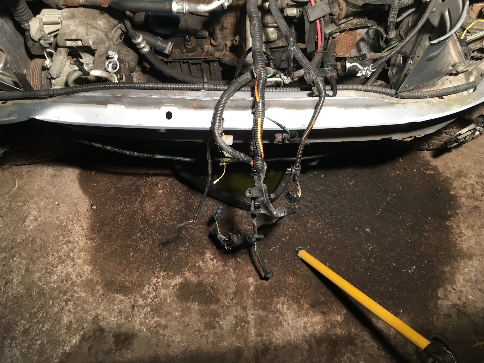

Removed the dash brace and made a start on removing the loom.

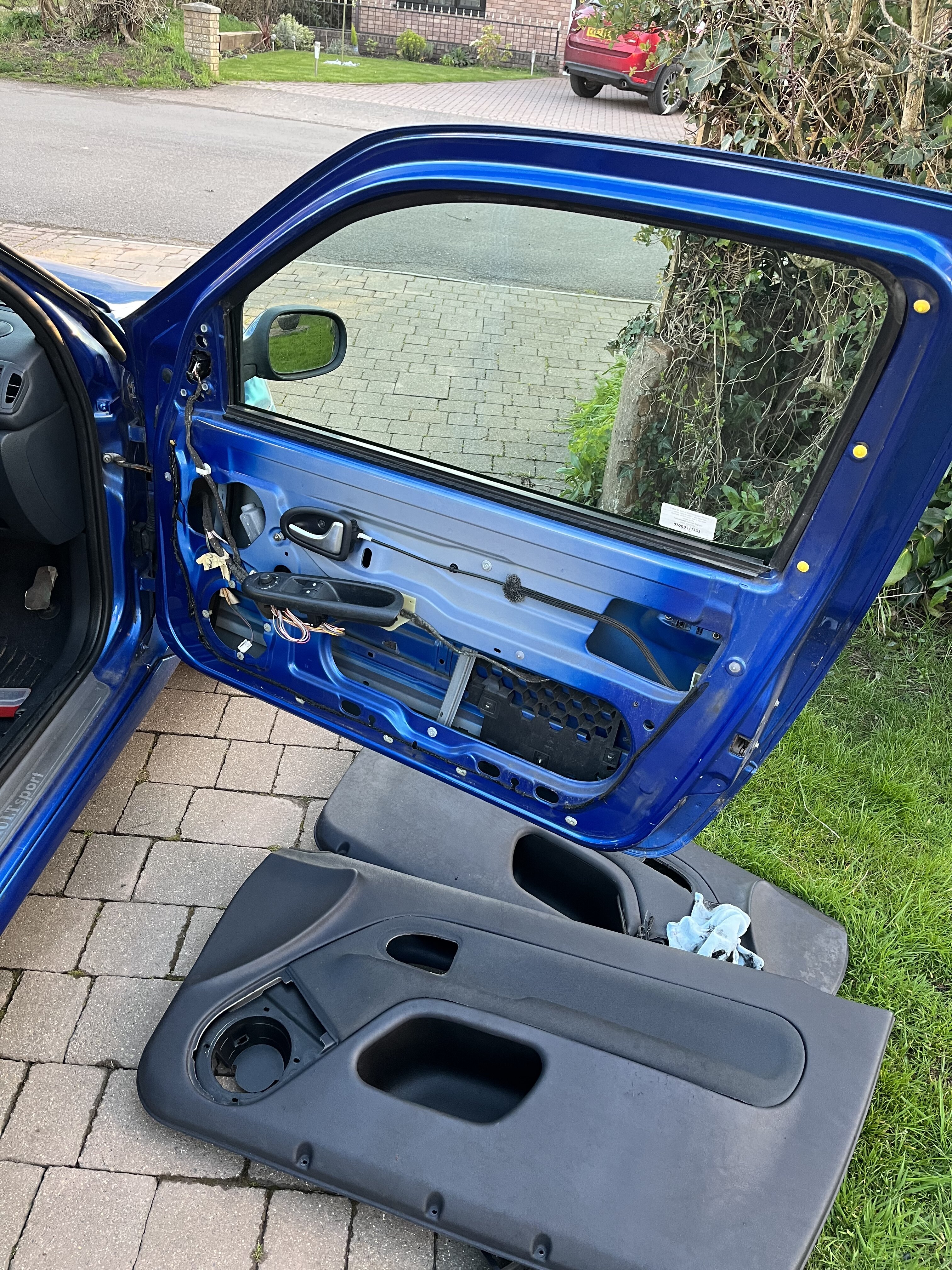

Loom out and removed passenger and drivers door (set aside for spares)

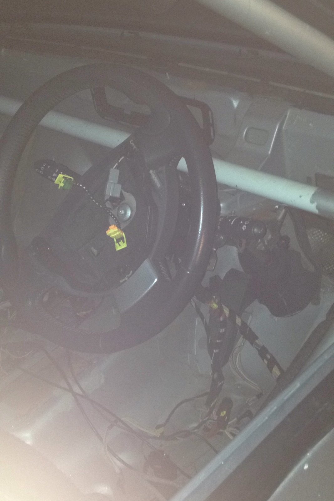

Fitted the steering wheel and stalks from the breaker on to the new shell, laid the loom out ready to fit....took a step back and thought that will do for the day.

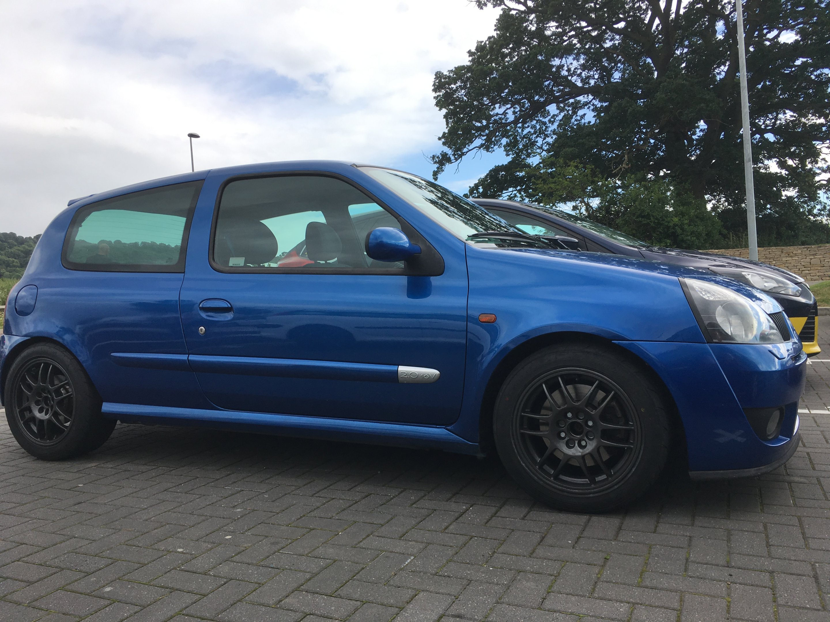

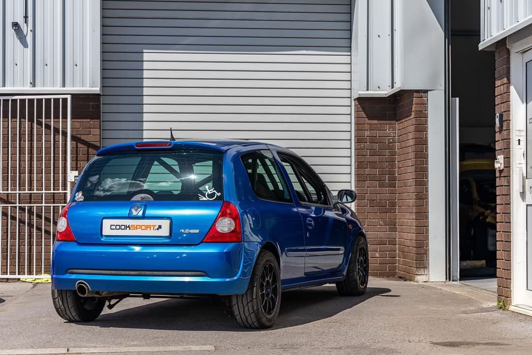

Little update for the cup.

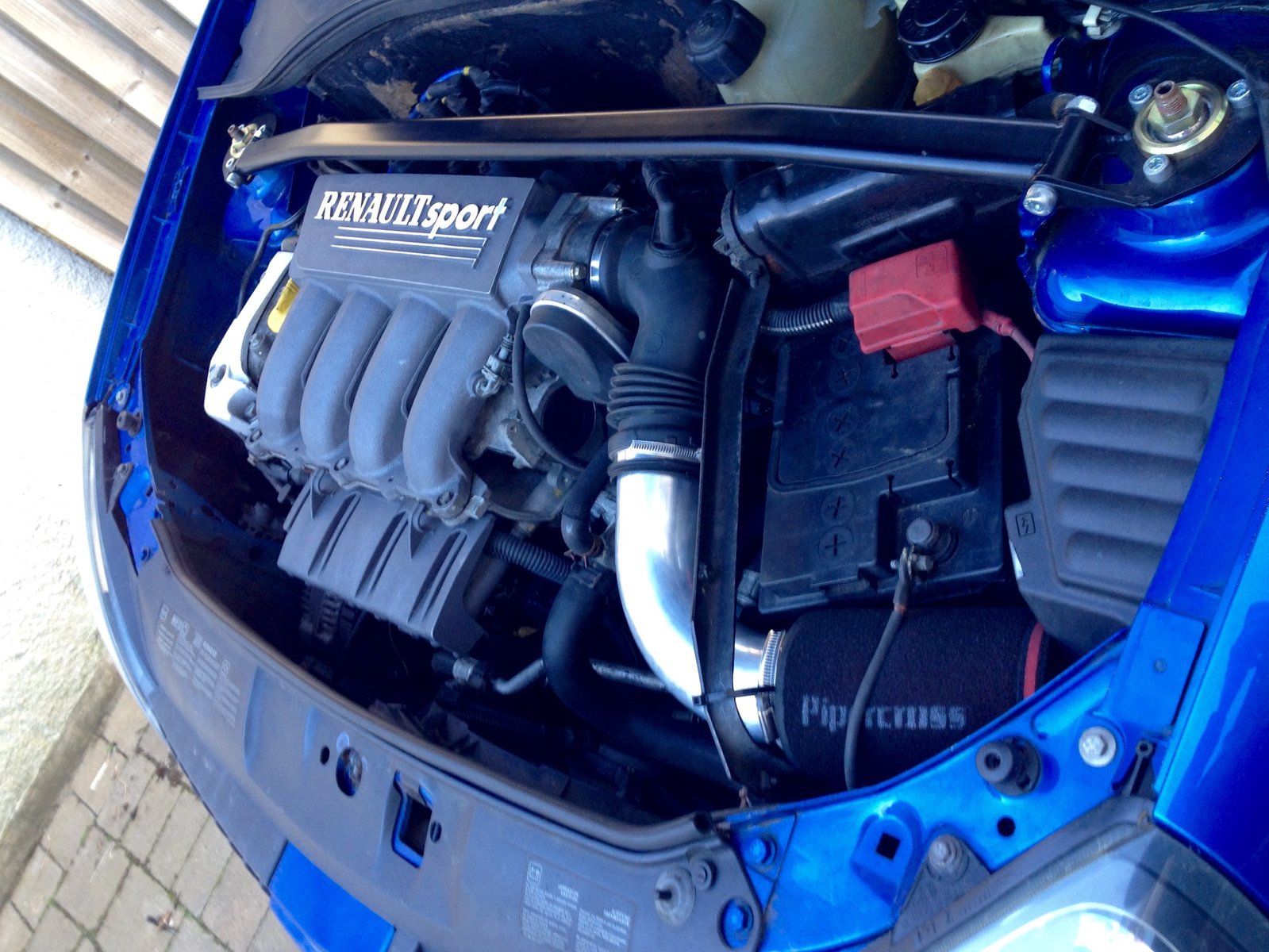

Fitted a fatty induction kit for extra noises.

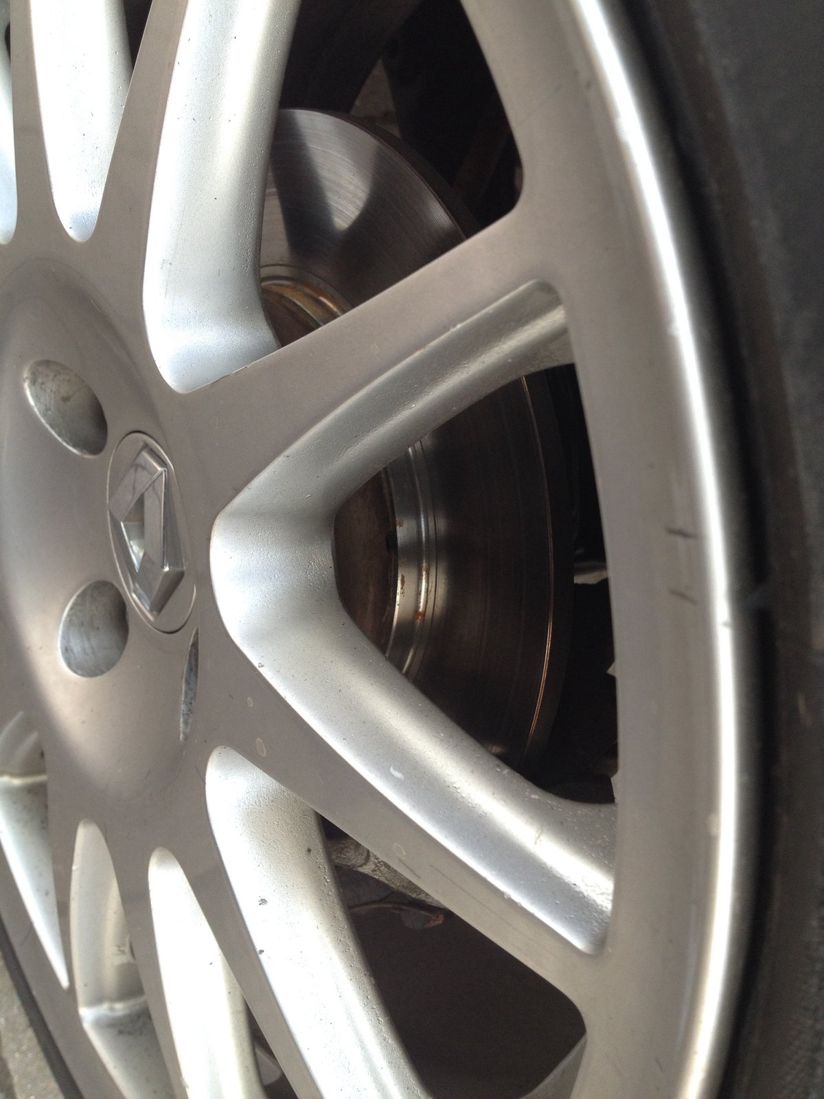

Treated her to some new disks and pads on the back (brembo) front had new wheel bearings, brembo HC discs and mintex 1144 pads.
Sent it for its MOT, perfect score.

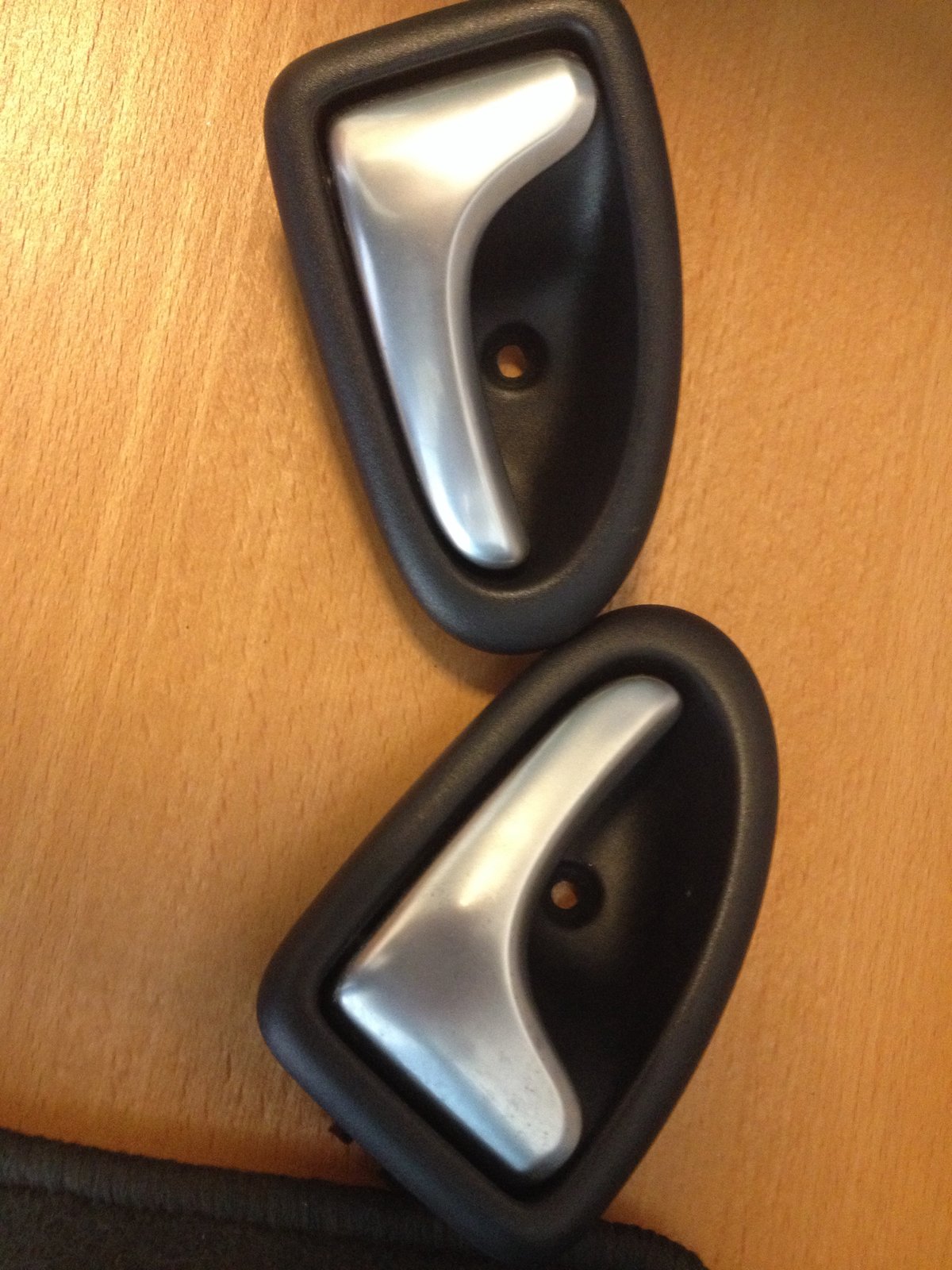

Got some new door handle fixtures as the current ones have split slightly around the securing hex bolt.

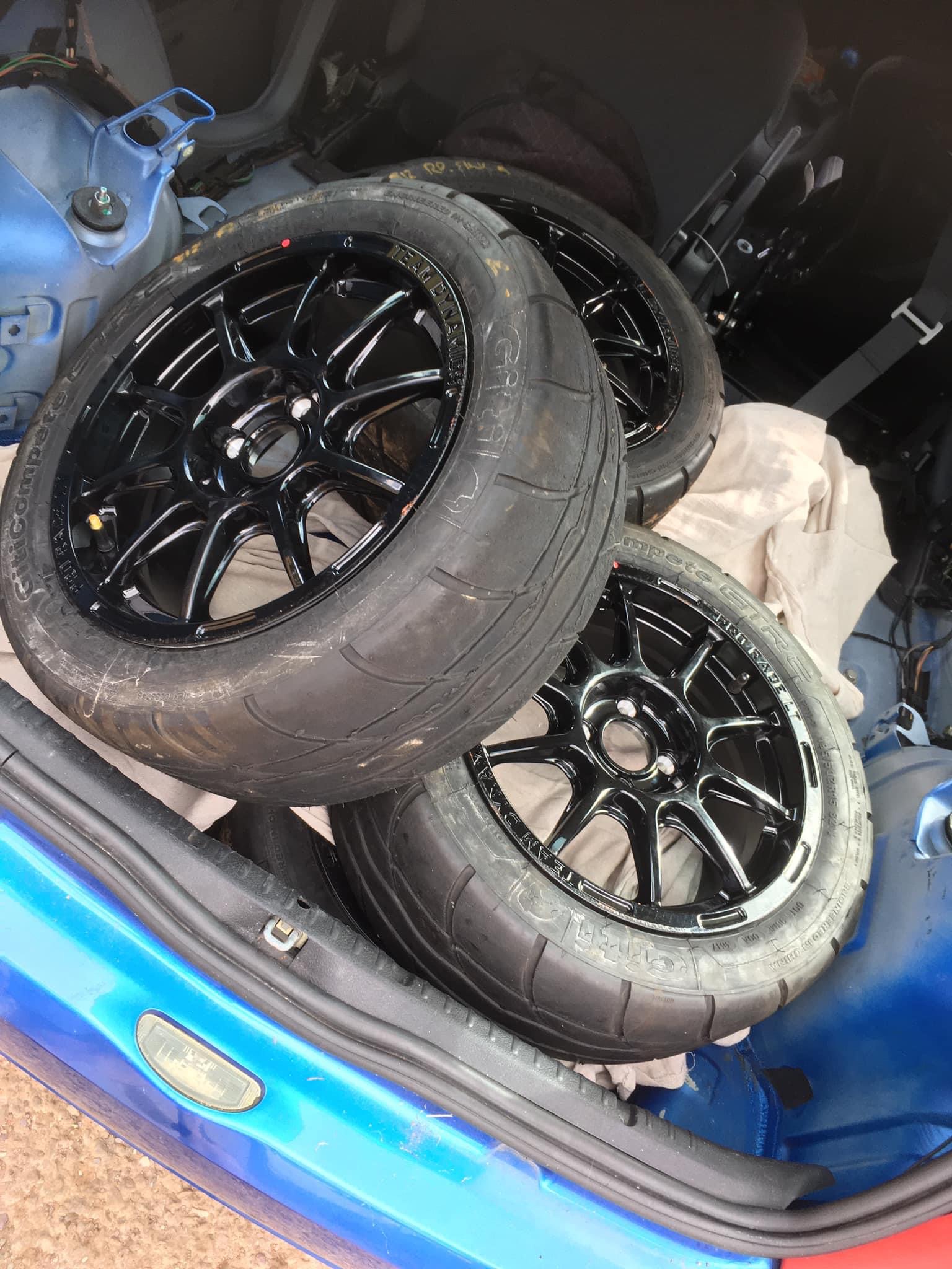

Bought some F1s with ns2r wellies. May well use them on the cup for a bit.

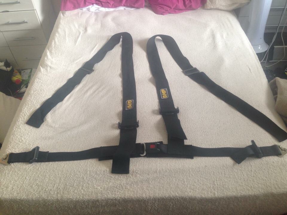

@Dano' donated a set of OMP harnesses, judging by the bed pic I think him and his GF have been using them for sexual purposes, oooer.
Now back off to carry on with the build :up:
Cheeky! The bed is the only "Clear" area in the house at the moment lol :P
Its all starting to take shape matey!
Cheeky! The bed is the only "Clear" area in the house at the moment lol :tongueout:
Cheeky, but knowing you...probably true 😂

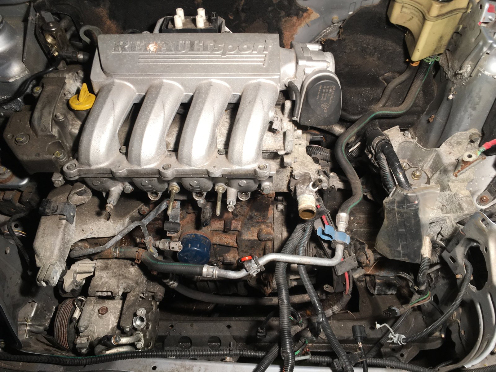

Another brick wall today though, radiator I was planning on using from the breaker is kaput, bottom mounts have rusted off/snapped.
Bolt missing from the lower inlet too with a pretty servere oil leak. Wondering what else I can find/goes wrong. No way's that engine still going to be pushing 196bhp :sweat:😢

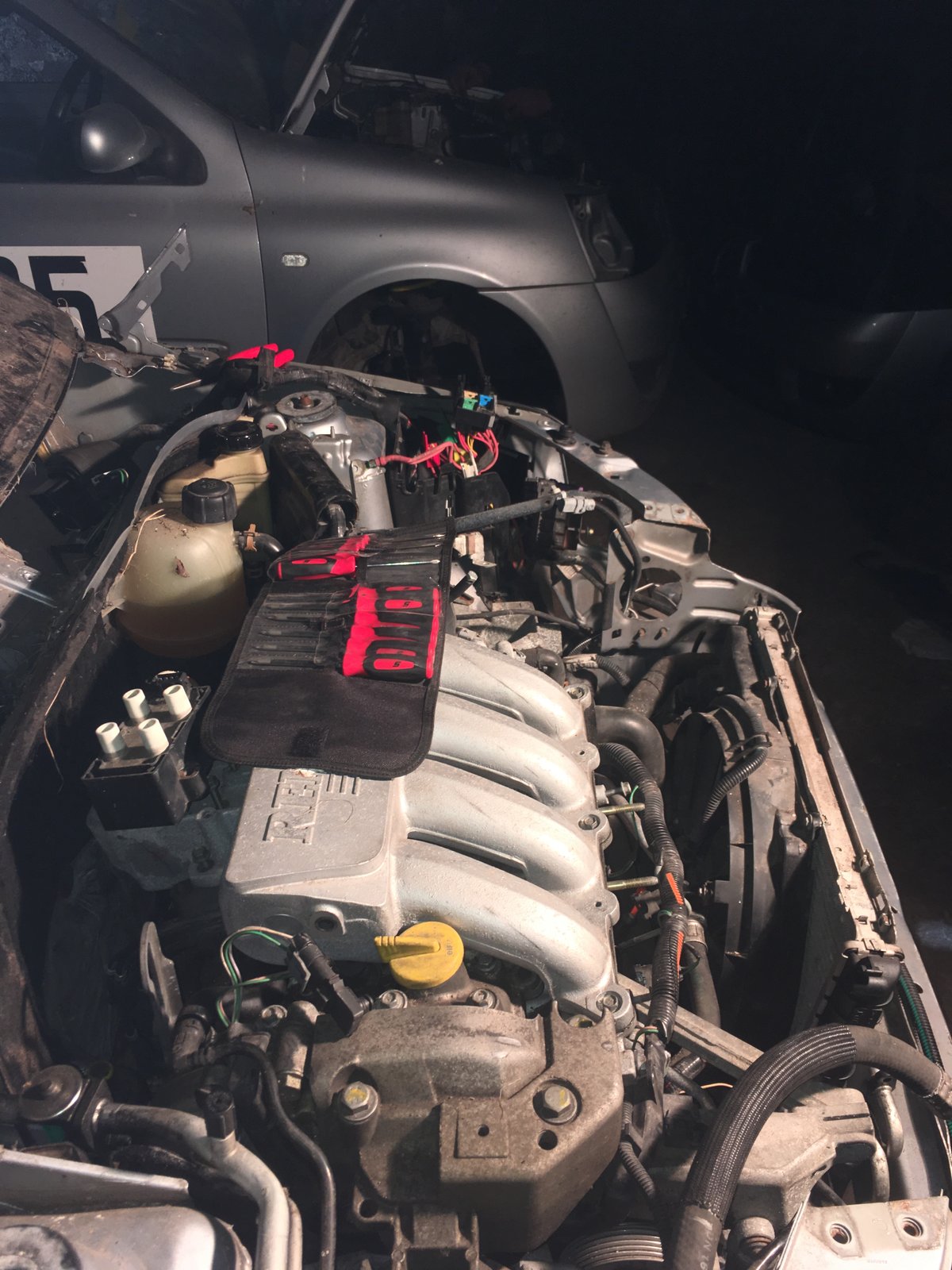

Got around to doing a few more jobs yesterday, radiator/piping removed, ecu removed with most of the wiring loom ready to transfer over. Disconnected the aircon pipes to be pump as that's not needed (will be looking for a cup alternator set up)
Not much left to go now before it's ready to be taken out. How long it lasts is another matter all together.

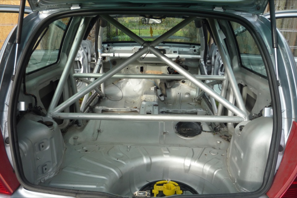

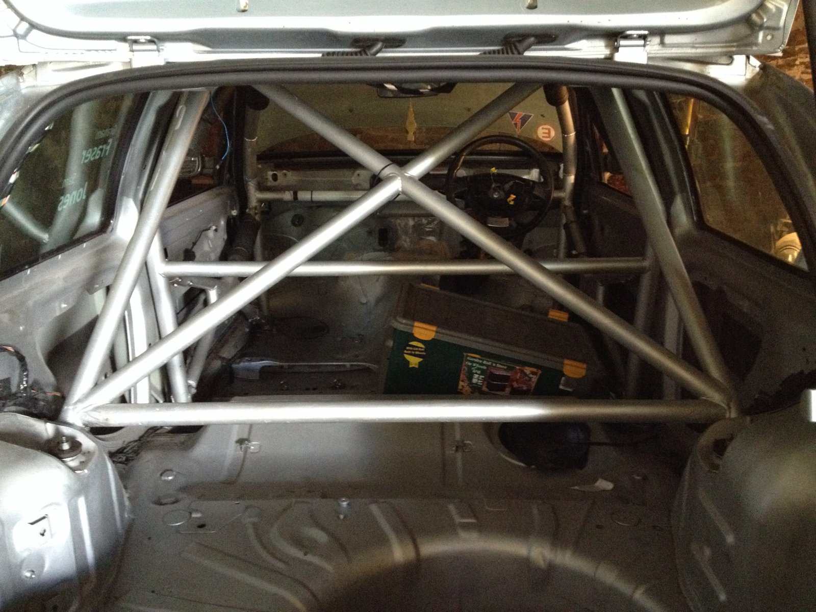

The caged shell kind of sat there rotting away due to personal reasons at the end of 2016, again through 2017 and in to the 2018. Some areas would of required so much attention that I decided it was best to break it, being an ex rally car that had taken a fair bit of abuse in its time, it made much more sense than to push on and sort it all out.

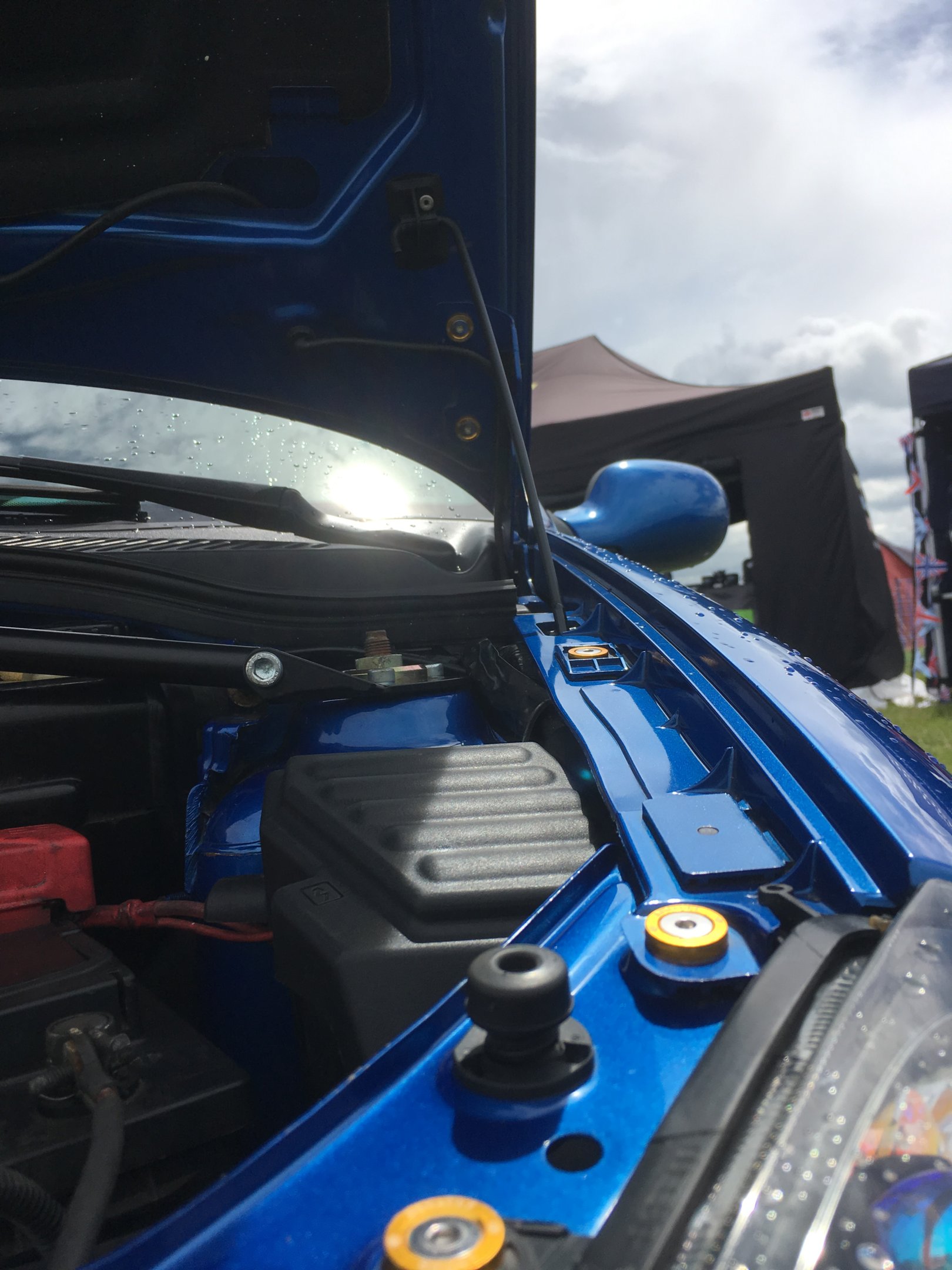

Some fancy bolts and washers under the bonnet for free thanks to bolternatives. Also as much weight stripped out of the back as possible without loosing the wiper mechanism.

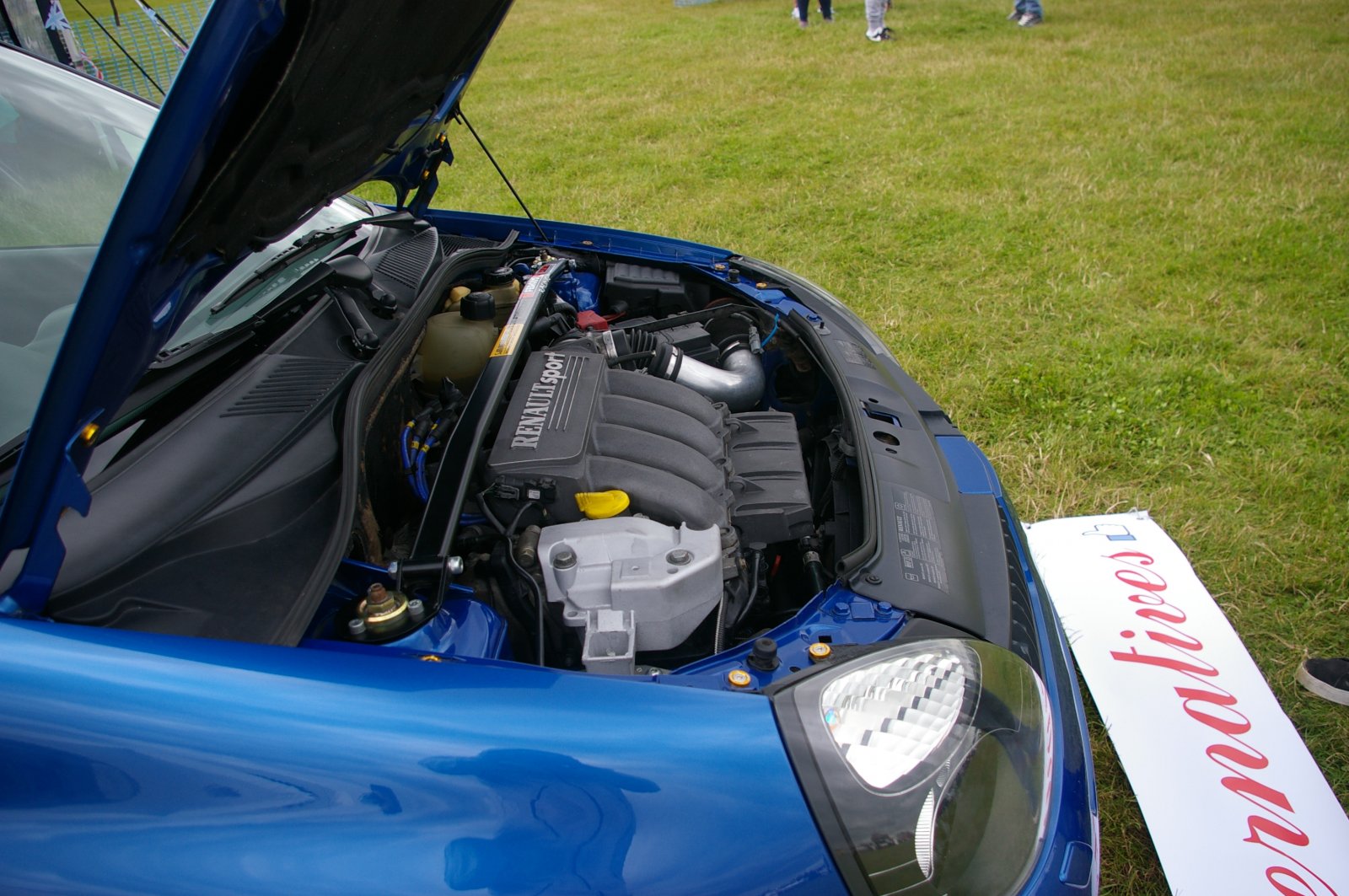

At CSF the cup spent the morning on display for bolternatives to promote and sell his kits, think a fair few sold off the back of it.
In the afternoon it was time for a bit of fun on track, the car performed flawlessly! Seemed the money spent was well worth it more so as the car just pulled and pulled all the way. Felt like the limiter was set to safely/liberally. Did have one “s**t a brick” moment however when I lost the back end I front of an expensive supercharged trophy ? who ever that was...sorry!

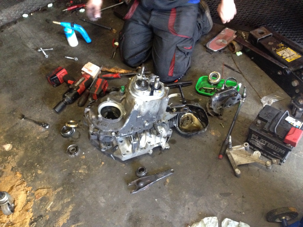

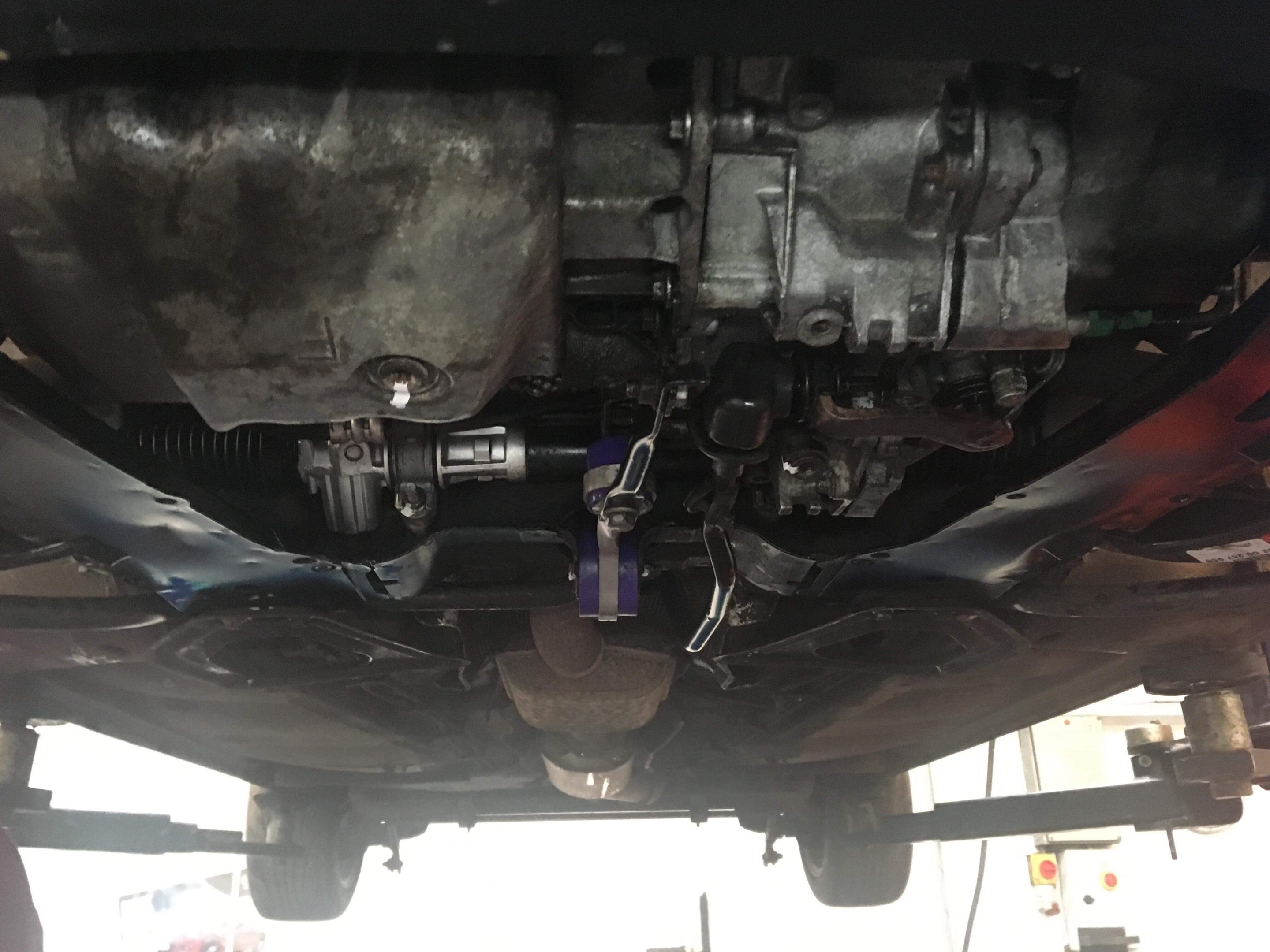

Now, I’d had work carried out by a garage in South Wales. They’d replaced my rear axle in 2017 and I wasn’t convinced it needed doing but, needing the car back for appointments etc I gave the green light. They absolutely f**king mullard the casings for the bushes to the point that the rear axle was becoming increasingly unstable. Utter bellends also ruined my steering rack and replaced it without my knowledge so I got much more than a track rod change, though there was f**k all point as the rack itself that they changed it for was weeping and worn to s**t!
After lots of back and forth with the owner and at points being told he felt like I had a gun to his head (too right I did!) a deal was struck and the car booked in with someone I knew was trusted.

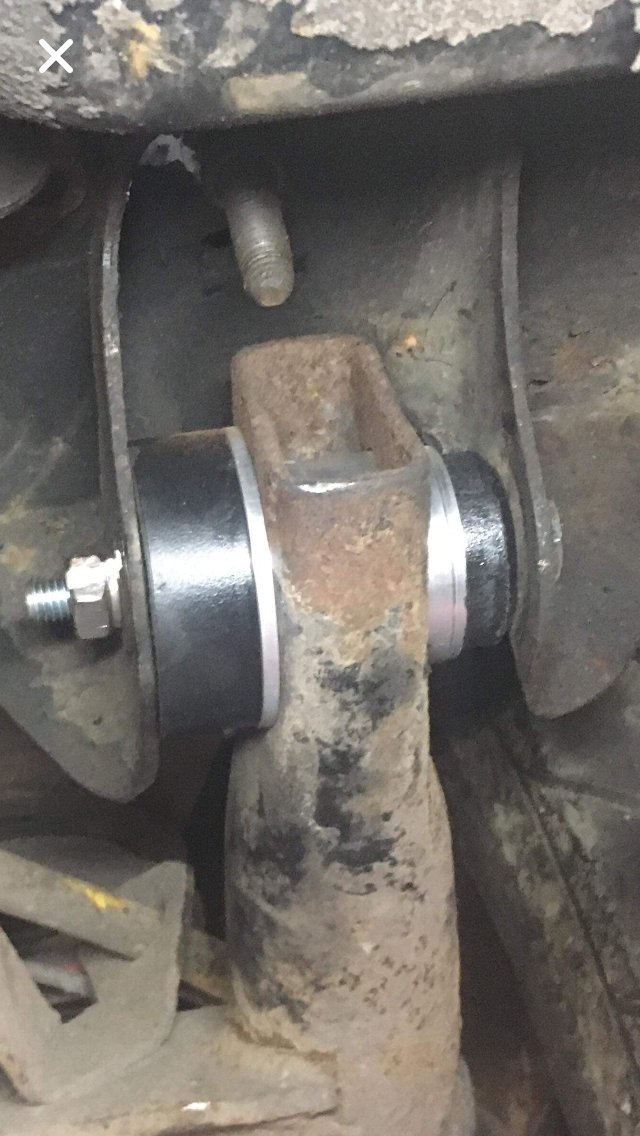

Off came the axle, old bushes came out along with the cases. Replaced with powerflex black series.

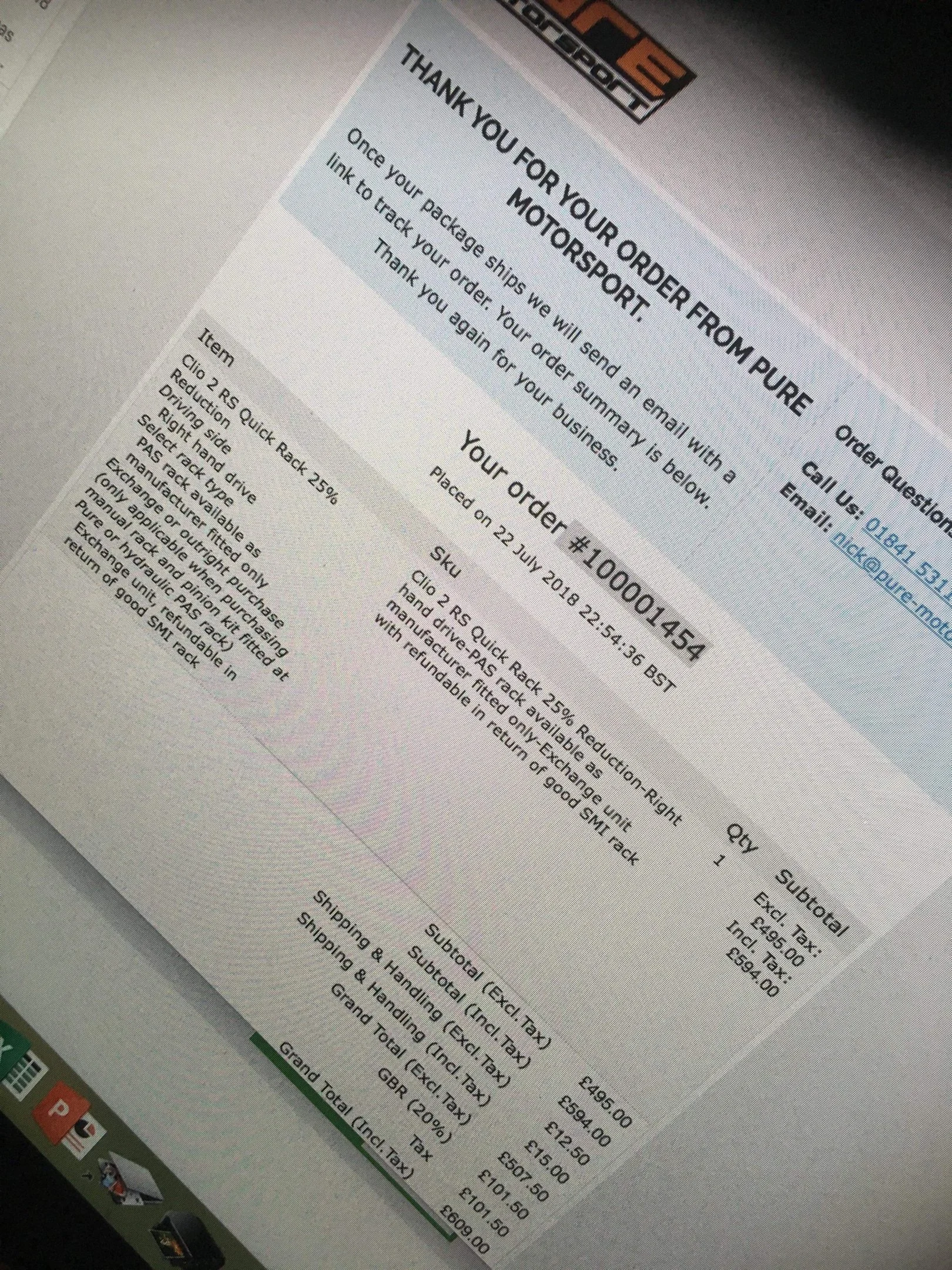

Off came the s**t rack. On went...
..some trickery from Pure motorsport.
At the same time, I had a new dogbone mount fitted with PF purple bushes...new lower arms, powerflex arb bushes. Brembo HC disks with ds1.11 pads front and ds2500 rear.
Clutch kit and cable. Gearbox swap. Fresh inlet gaskets. Full service.
Tracking and geo set up by centre of gravity.

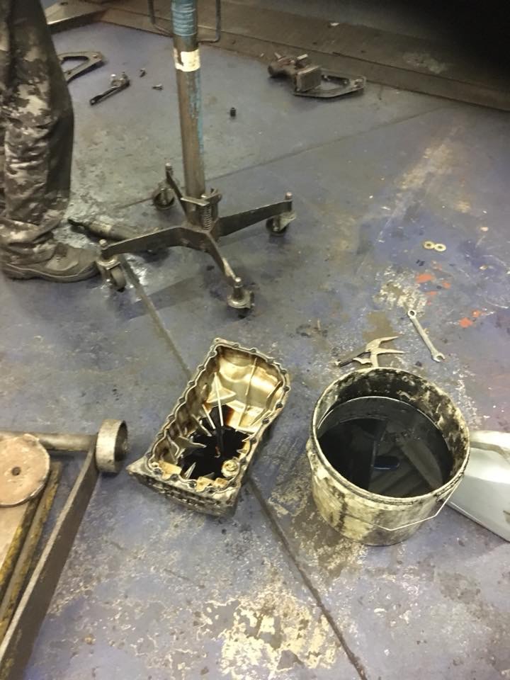

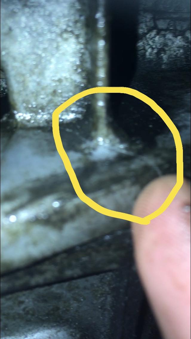

Then, disaster. Days before CSF I noticed oil on the drive, somehow the sump decided to split, I still can’t understand how as this only time the car gets driven hard is at blyton.
So, a quick call was made and plans made to get it sorted so that I could still make it to CSF.

Sump came off and replaced it with a spare and a new gasket. Had the shocks all round replaced at the same time with the eibach sportline springs

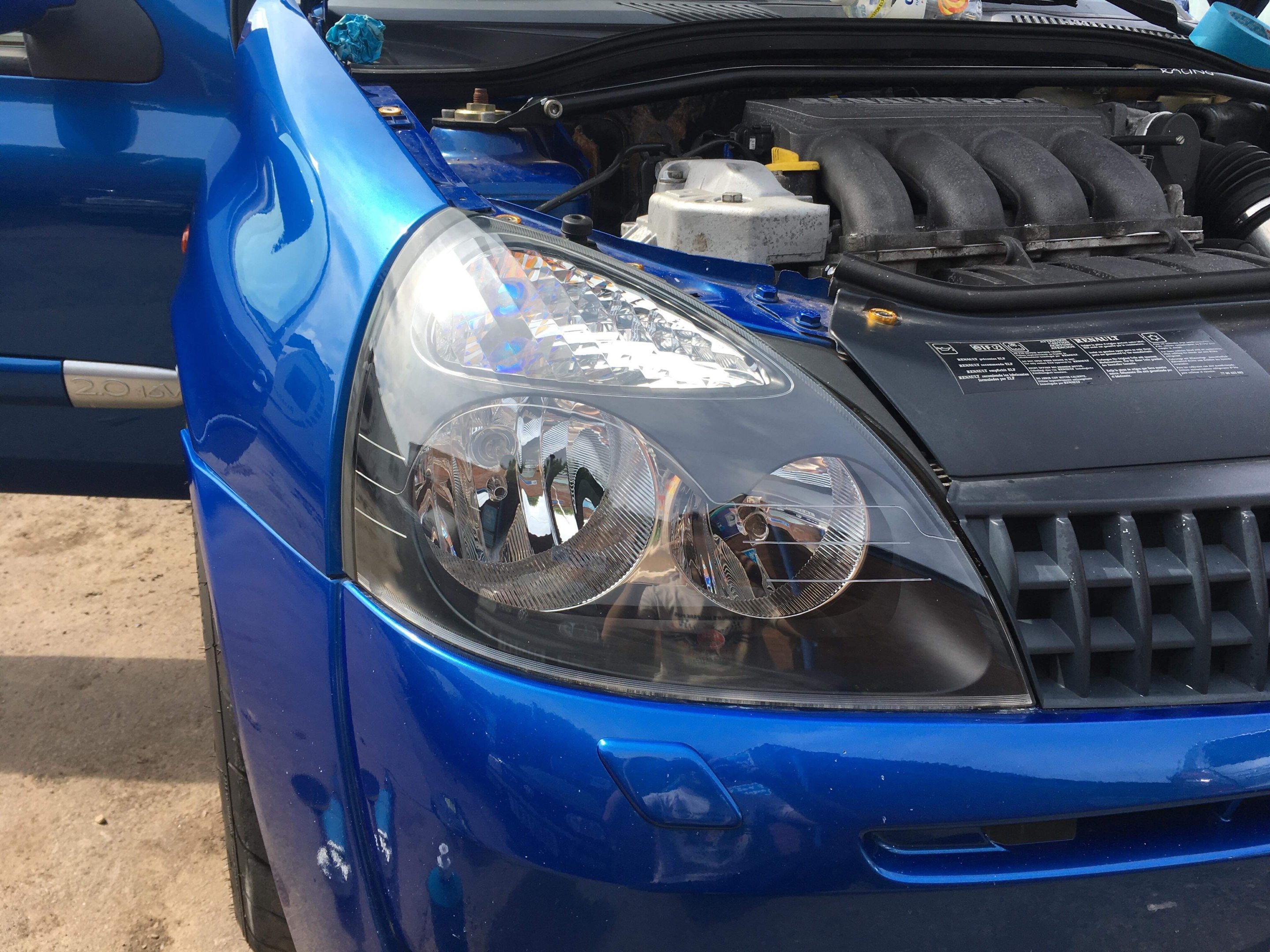

Headlights polished up and the car given a good clean. I could be completely wrong on the order of all this now as the stress levels for myself and the poor lad doing my car was ridiculously high.

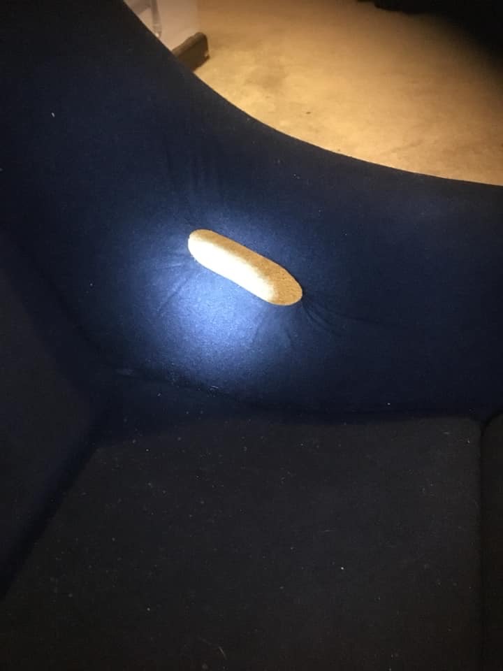

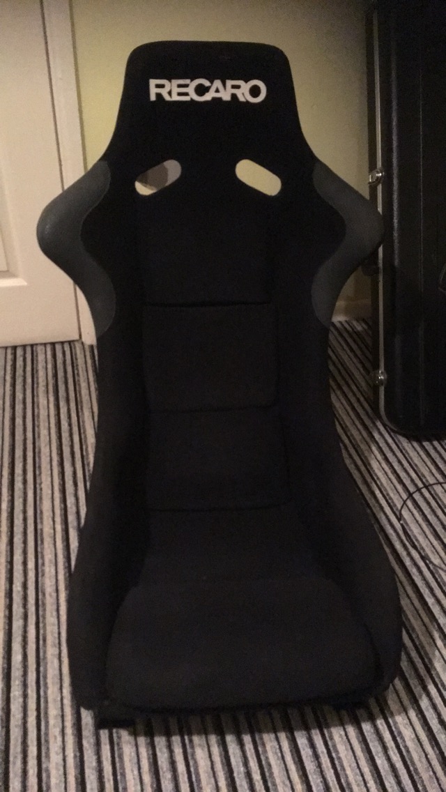

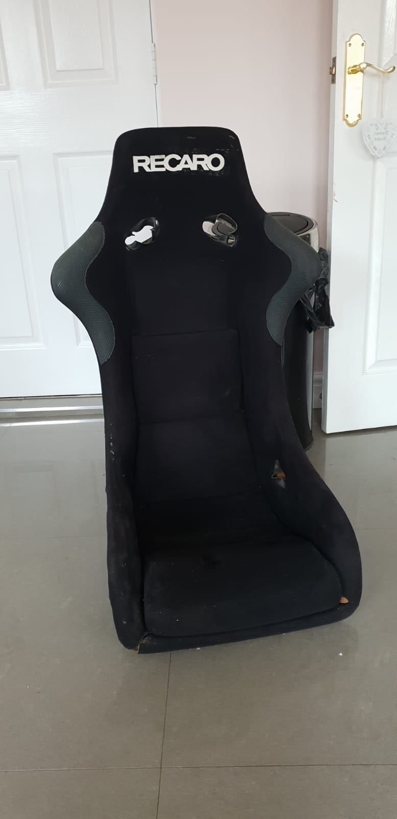

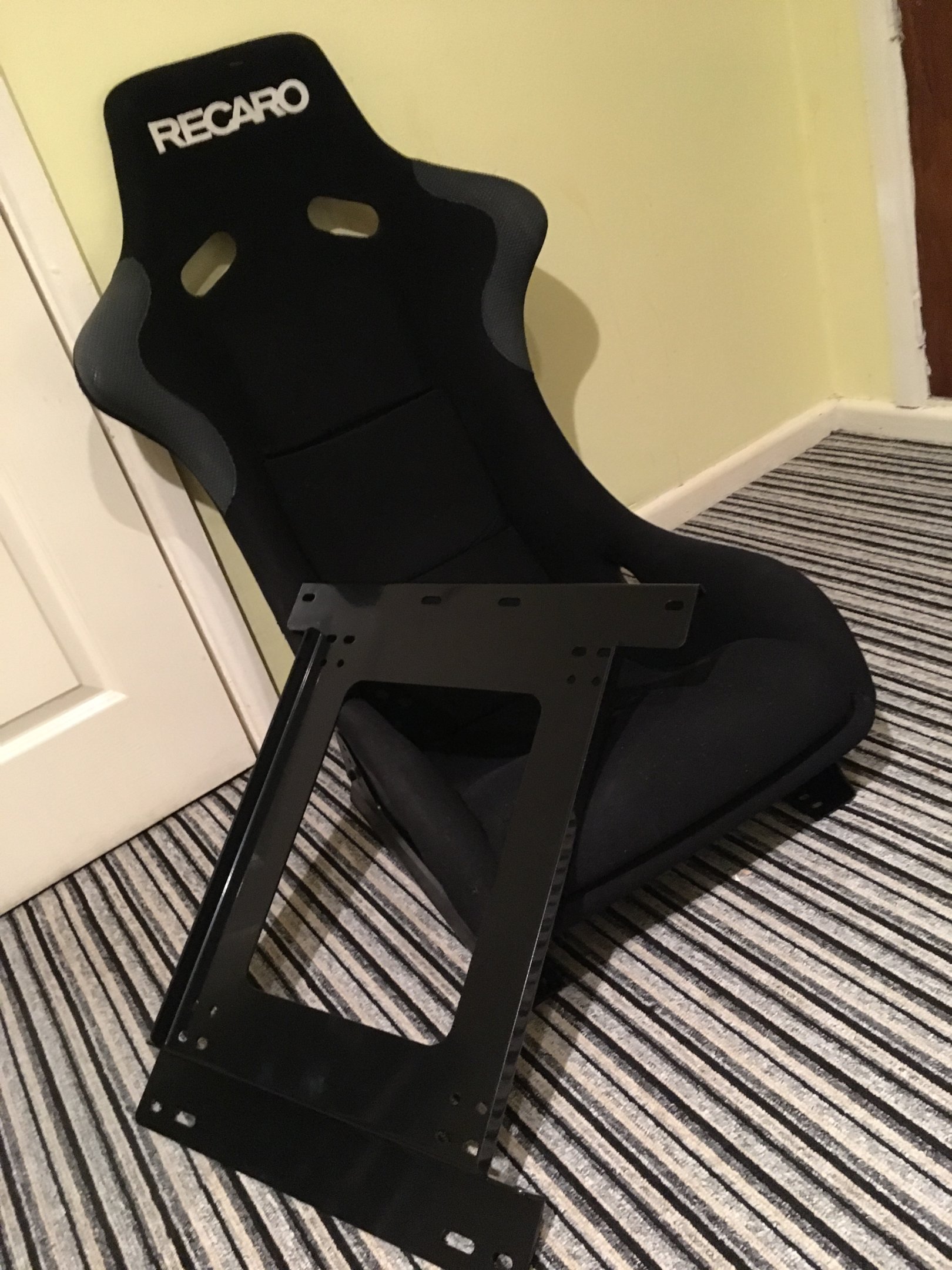

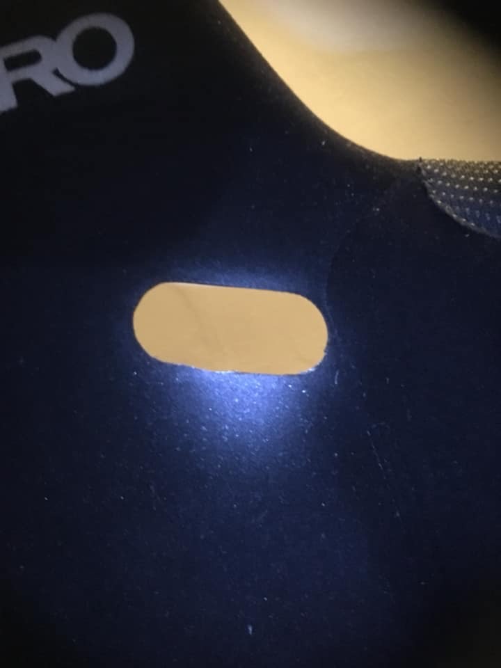

Managed to pick up a bit of a bargain for cup1. Genuine Recaro profischale for less than a round of drinks, it was in a bit of a state so I set about repairing it.

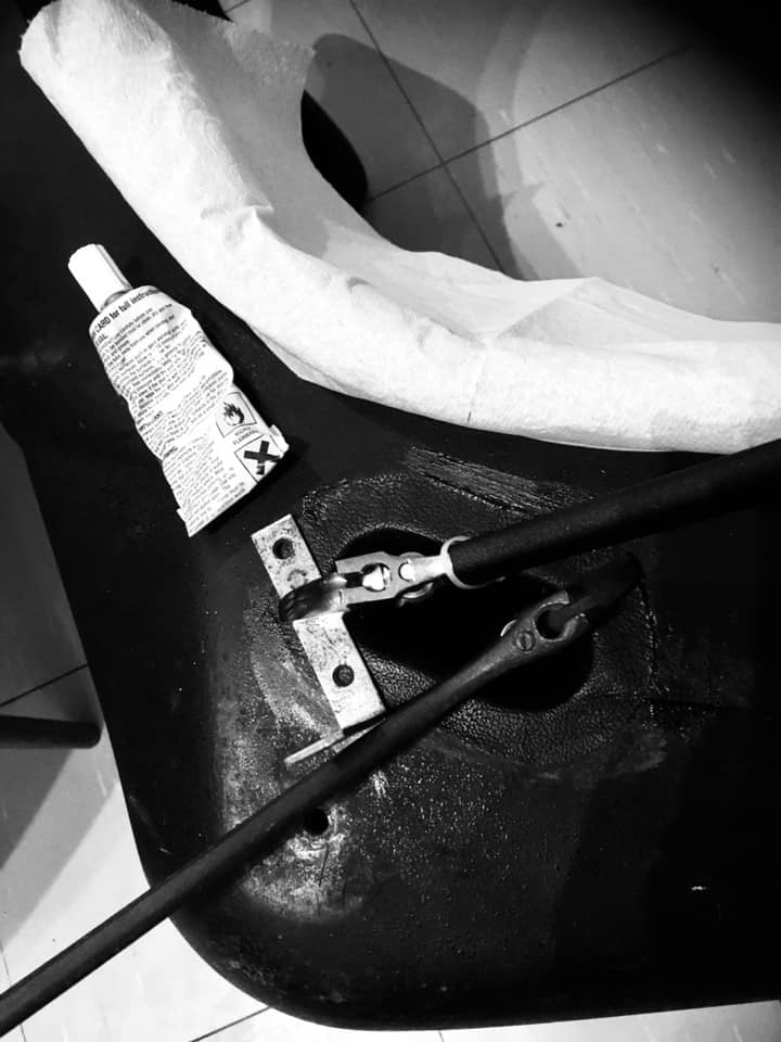

The material had pulled through the belt guides, so first up I had to remove the covers and cushions. Realigned it all the, made sure the material was pulled back through each guide hole in equal measure before clamping them in place and bonding them back to the shell.
Then set about recovering the seat with new side bolsters and side padding.
Made sure the cover lined up neatly all around the edges of the seat and belt guides.
Then set the cover in place with a new spring on the underside that had slightly less tension than the old one to prevent any future issues. The end result being that it now looks near enough new and is ready to fit in the car with an XLow subframe.
Difference is night and day.

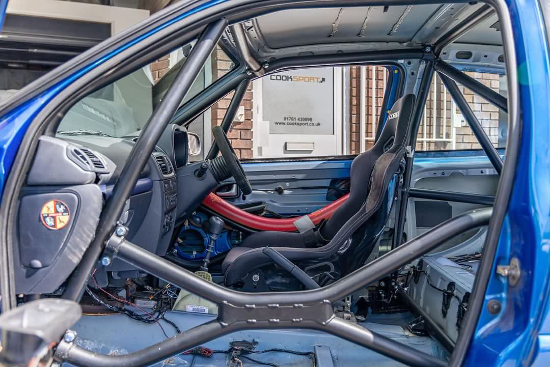

OMP wheel as the novelty of the Sabelt wheel had worn off with the constant worry of it getting dirty.
Renault clutch and clutch cable fitted/replaced.

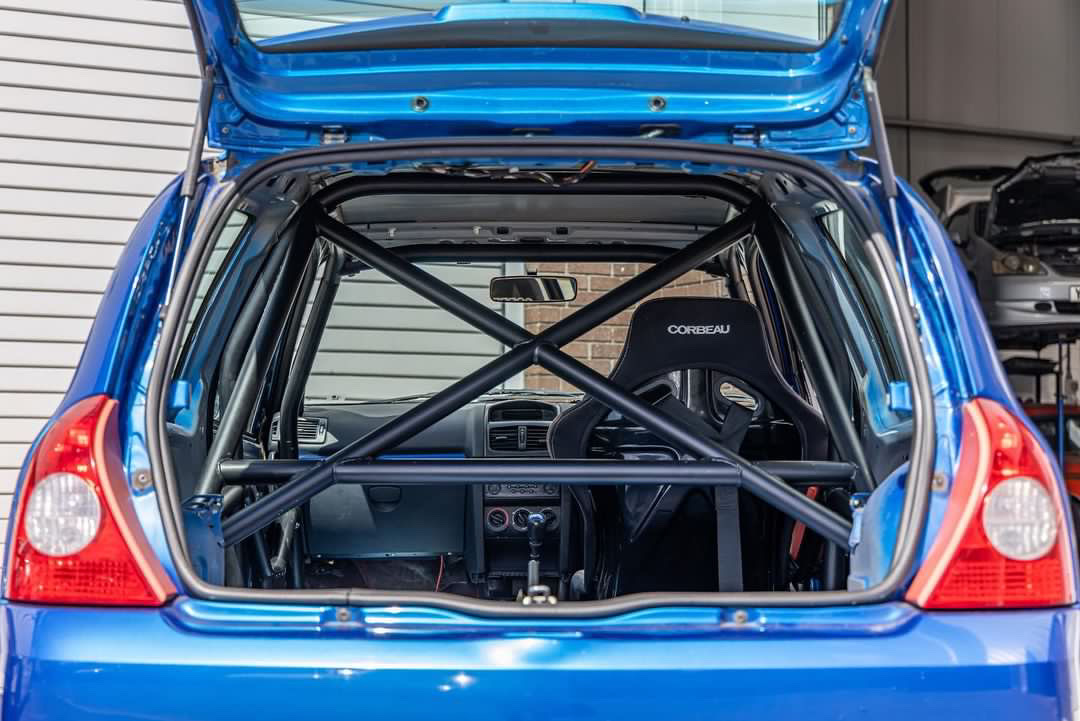

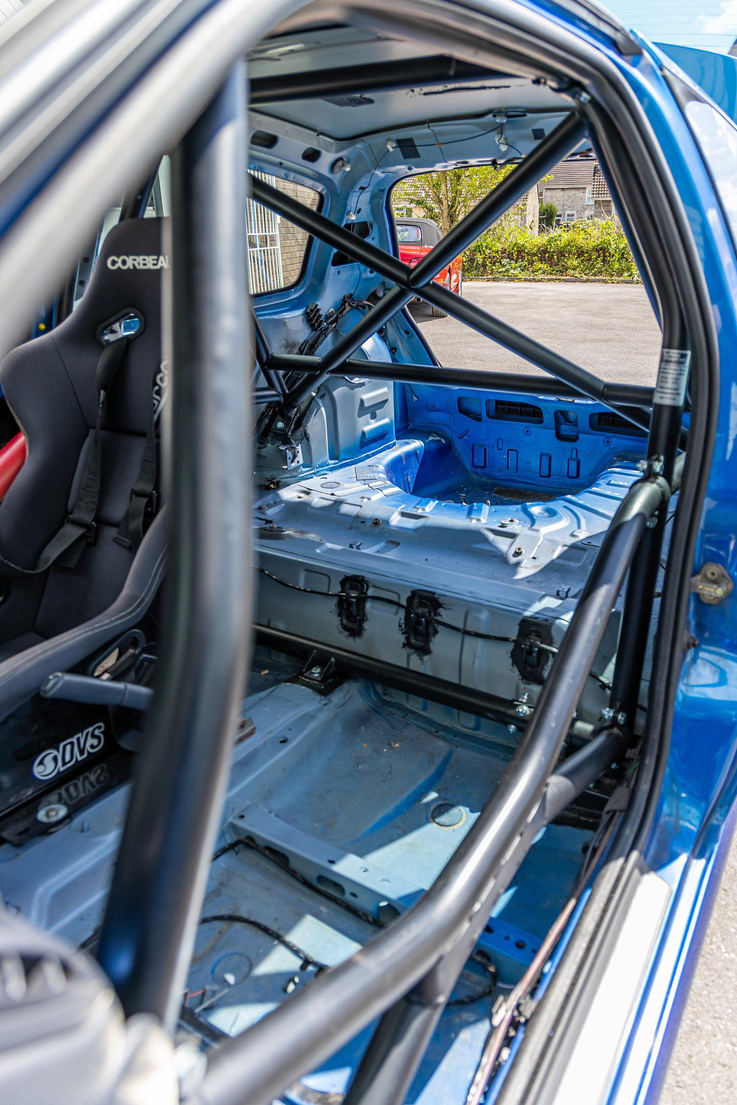

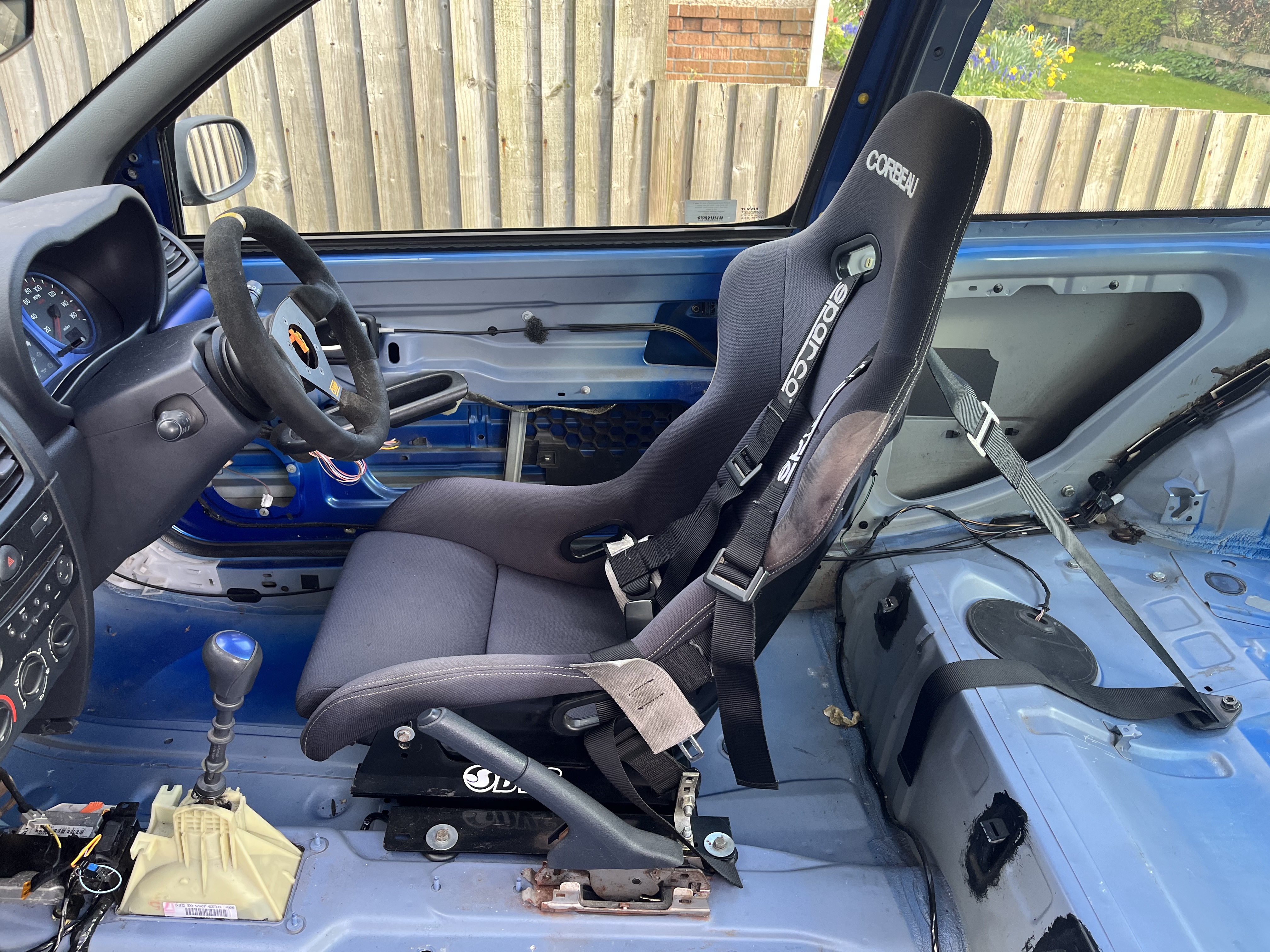

Corbeau Clubsport fitted on a Jon Fonz Xlow subframe with Sparco harness as I sold the Recaro SPG due to it being a tight fit!
Next on the card was investing in a cage and a few other goodies but something else cropped up at the start of 2020.

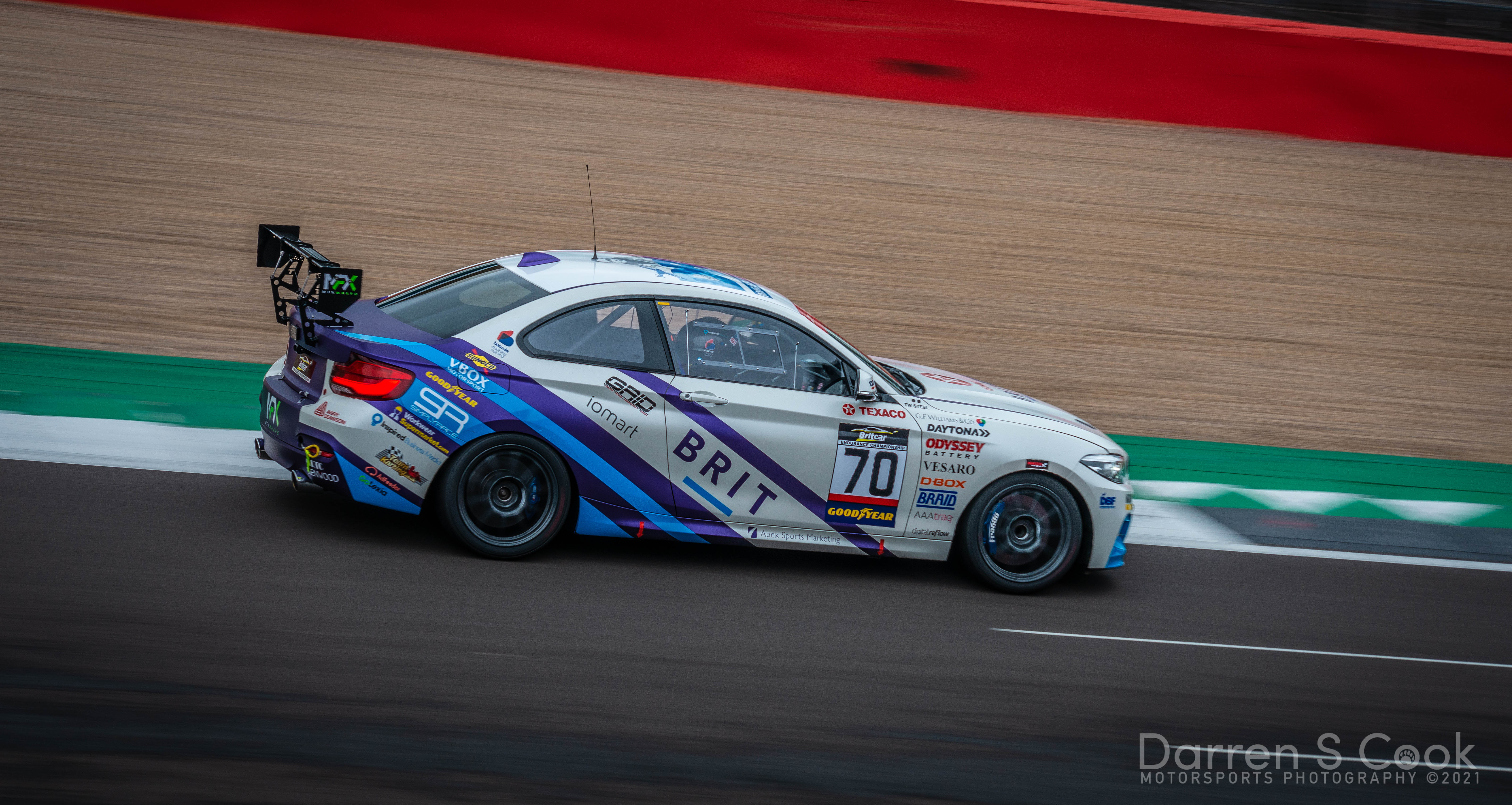

3 podiums and finished P4 in class in the championship. 2020 was a weird season , very empty tracks with no one watching due to covid restrictions. Still had plenty of battles, trading of paint and overall a damn good laugh!
at the start of 2021 I moved from the 1 series in to an M240i, totally different machine with a lot more power, big brakes and a bit of downforce.
This meant a move in classes and a lot to learn in the short period of time we've had for testing. Being one of a handful of disabled drivers in the world of motorsport means the car's also very different in terms of controls. I have a steering wheel fitted that allows me to control the accelerator and brake with my hands, accelerator is on a paddle behind the wheel on the right with the brake on the left, rocker switches fitted on front of the wheel for gear shifts.

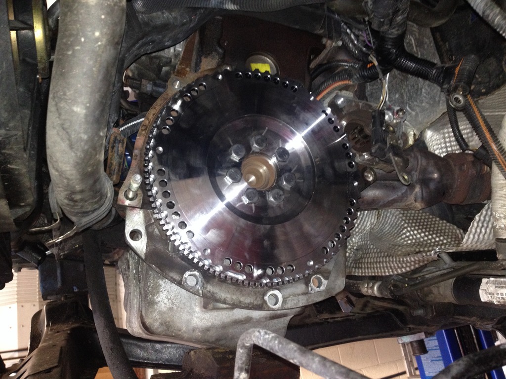

Front main crank seal, clutch and replacement TTV lightweight flywheel.

Set about sorting out the wheels and tyres, a well priced set of Prorace LTs came up on Tweeks so I snapped them up.
Got a set of Giti GTR2s fitted that were going spare.
Took it to Combe with @TRH_Racing for a day on track, was faultless all day and had bags of grip. The brakes are spot on with a really firm pedal feel and the diff has made a massive difference.
Didn’t really have much time left in the year to enjoy it so only really used it for the odd trip to the shops. That meant not getting it finished off fully but it started coming together.

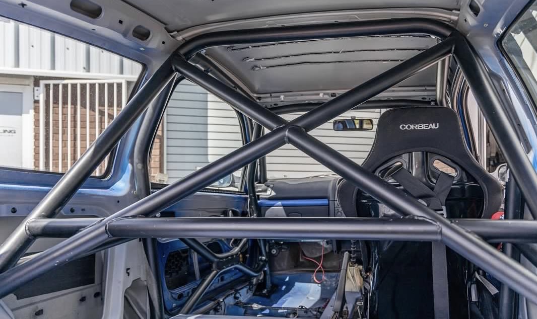

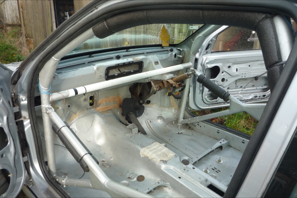

After having the cage sitting around for a while taking up space in the garage I thought it was about time it got fitted.
Had a bit of spare time this month so got plans in to motion to get it installed.
First up was getting the majority of the interior stripped out, luckily that didn’t take too long as the back was already done.

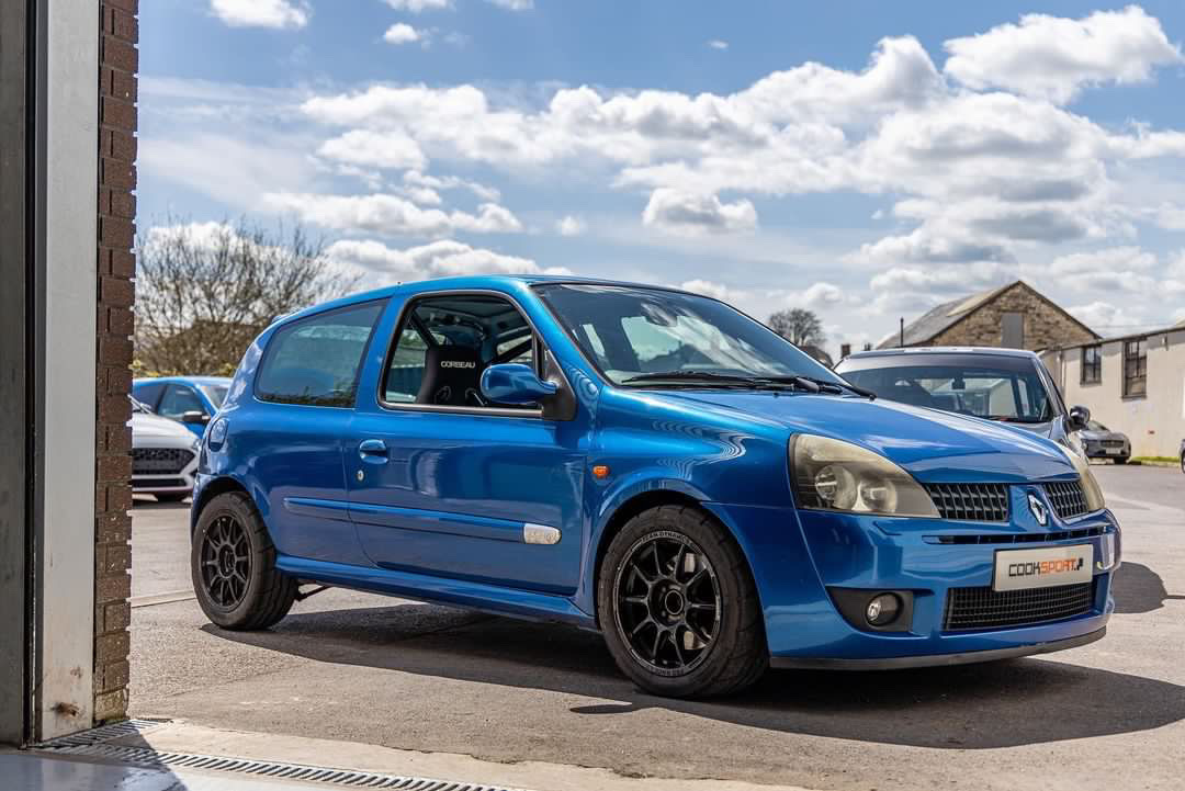

A short trip to Cooksport in the van first to drop the cage off, followed by the car.
Received a call yesterday to say it was ready to collect so dropped my plans and headed on down and picked it up.
The lads also installed a four point OMP harness, couldn’t fault the turn around time and even left with some pics taken by them.
Safe to say it’s finally heading in the right direction. Coilovers and a roll center kit are up next on the list along with a set of door cards.
Until then I’ll make a start on tidying the redundant wiring and smarten the interior up a touch with some paint.
